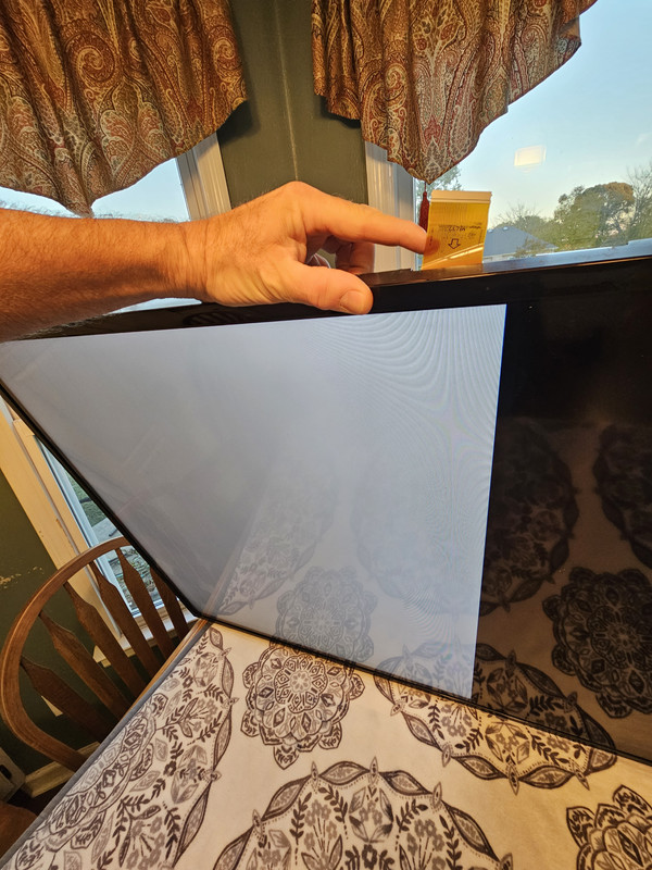

    We had a lightning strike a few days ago really close to my house. My Samsung UN60EH6000 was on when it hit. Afterwards, the TV would not come back on.
    I had repaired this TV a few years back by replacing the T-Con board. (The post I had on this is repair is here.)
    When I turn on the TV, I don't get any start-up melody. The screen just dimly flickers around the edges.

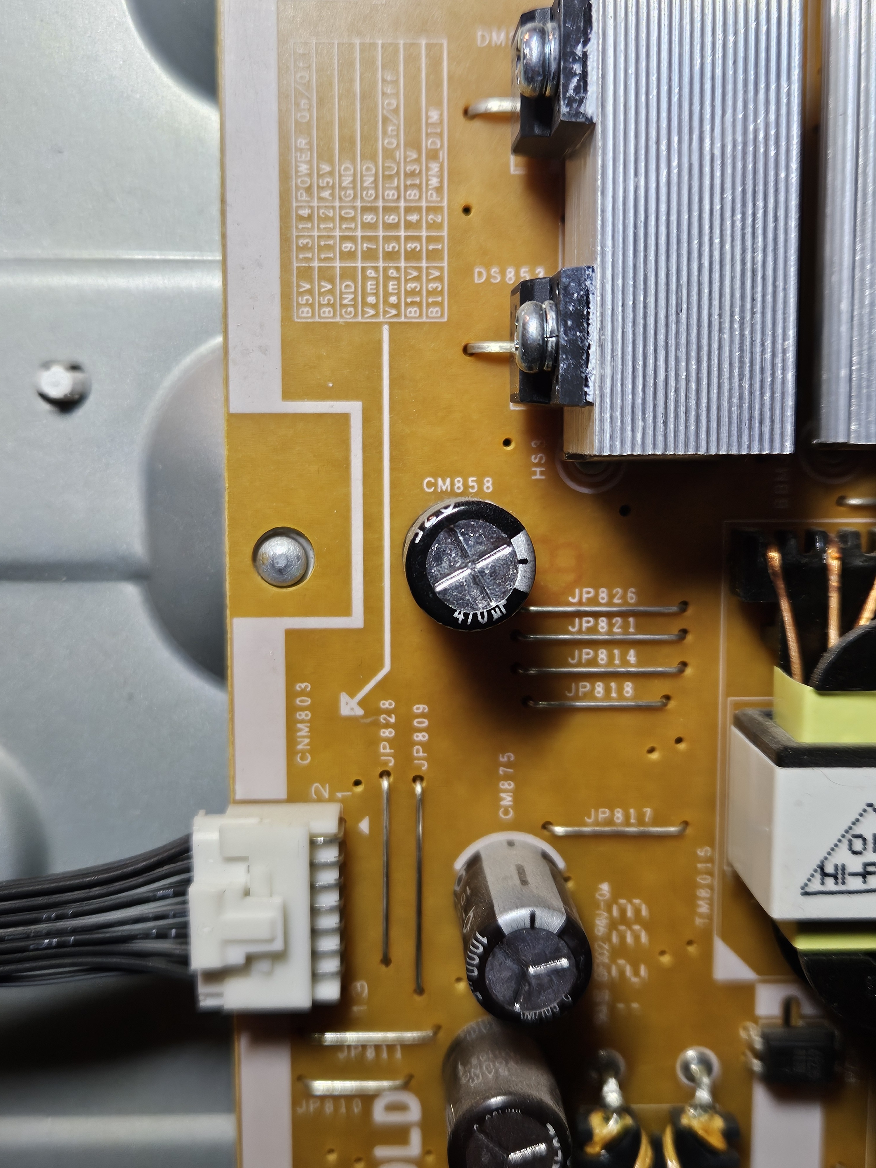

                    I DO NOT have a red standby light and I initially suspected the PS board, but after checking the pins, I thought the PS was good.... maybe not.
                    Below are the values I got along with the values printed on the board.
                    On the power supply board, 14pin connector:
                    1 :12.7 Vdc (PWM_D1M 13v)
                    3 :12.7 (B13V 13v)
                    5 :12.7 (BLU_on/off Vamp)
                    7 :12.7 (GND Vamp)
                    9 :0 (GND)
                    11 :5. (A5v)
                    13 :5. (Power_on/off 5v)

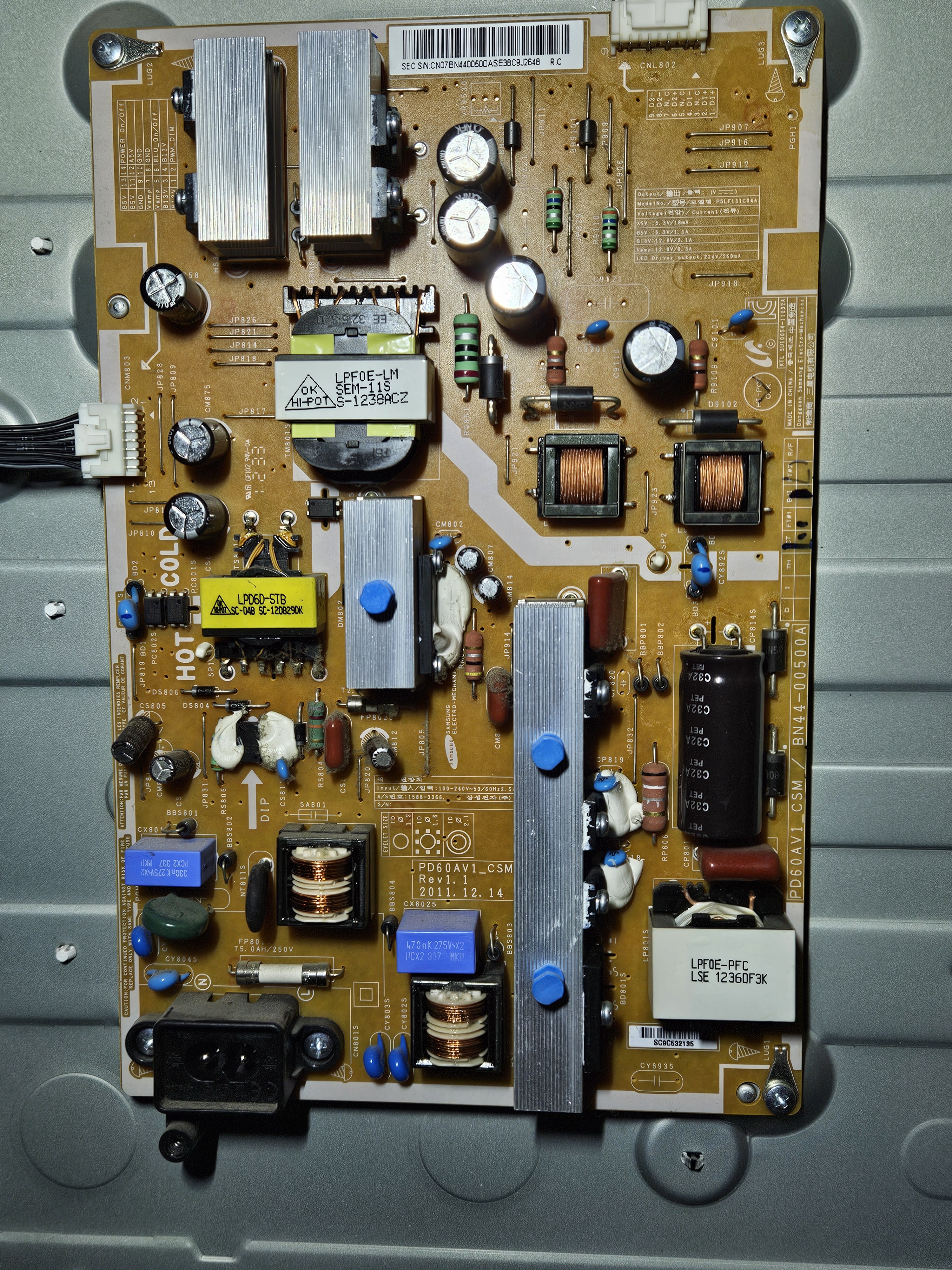

                    Here is a full image of the PS board
Name:	PS_ Connections_1.jpg

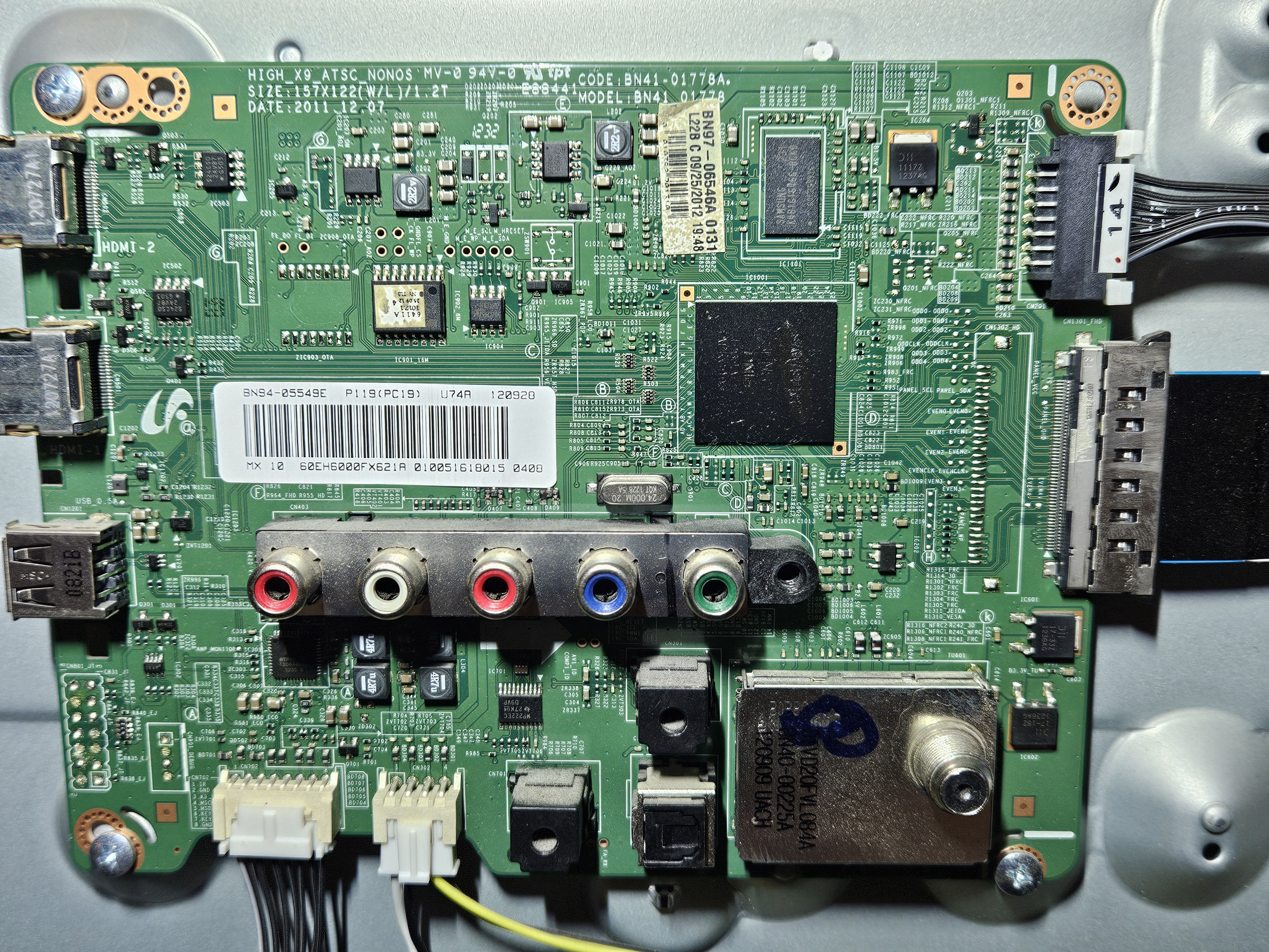

                      Picture of the main board.
Name:	Main Video Board.jpg

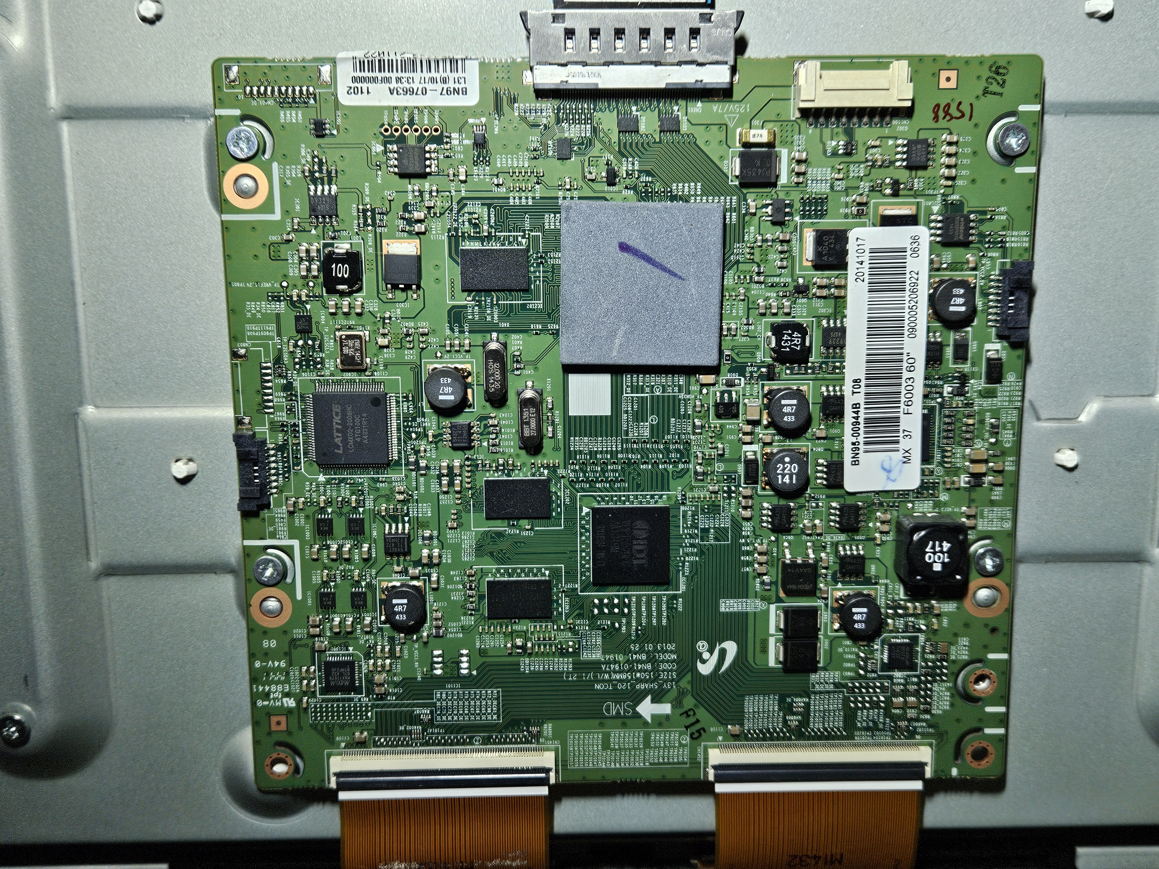

                        Picture of the T-Con Board
Name:	Timing Control Board.jpg

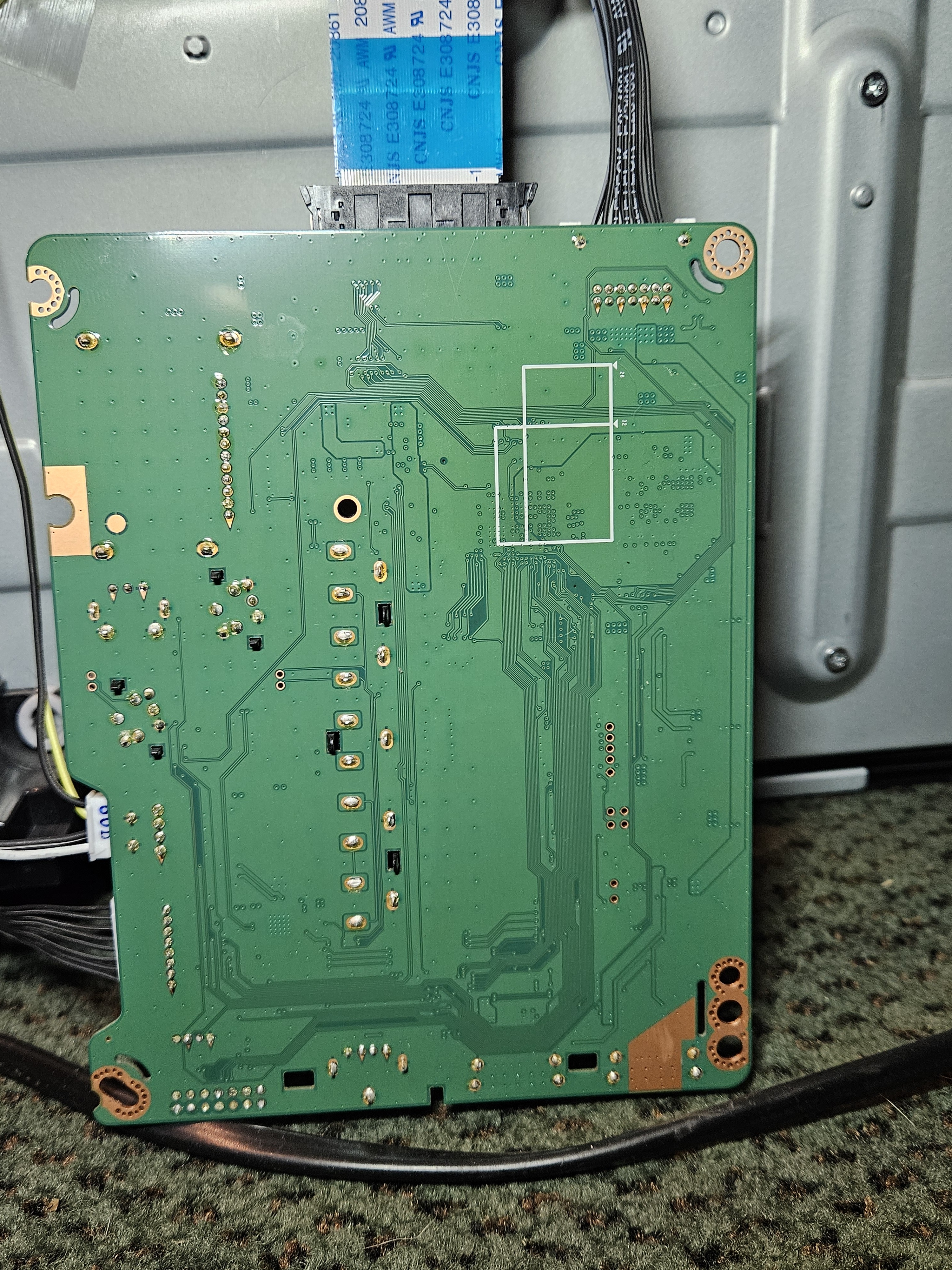

                          i think you must reprogram IC901, first however you must check some tensions, can you photograph the back of main board? Check voltage on ic905 pins, and on every mb coil except those 4 grouped..

                            Here is a picture of the back of the main board. Also the measurements you asked for.
                            Click image for larger version Name:	Back of Main Board.jpg Views:	0 Size:	3.08 MB ID:	3154223
                            Click image for larger version Name:	Main Board Voltage Readings.png Views:	0 Size:	563.0 KB ID:	3154221

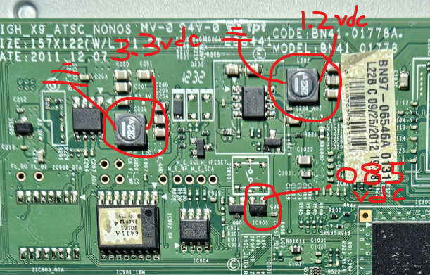

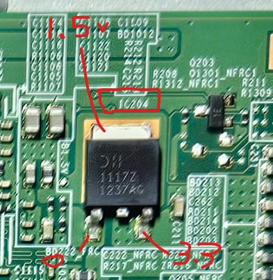

                              Check the regulators IC204 (1,5v on the tab), IC202 (??V), IC206 (3,3v on the tab). This chassis really sucks, the main flash ic is integrated to the SOC!!
                              if regulators appears ok it must be reprogrammed the SPI flash IC..

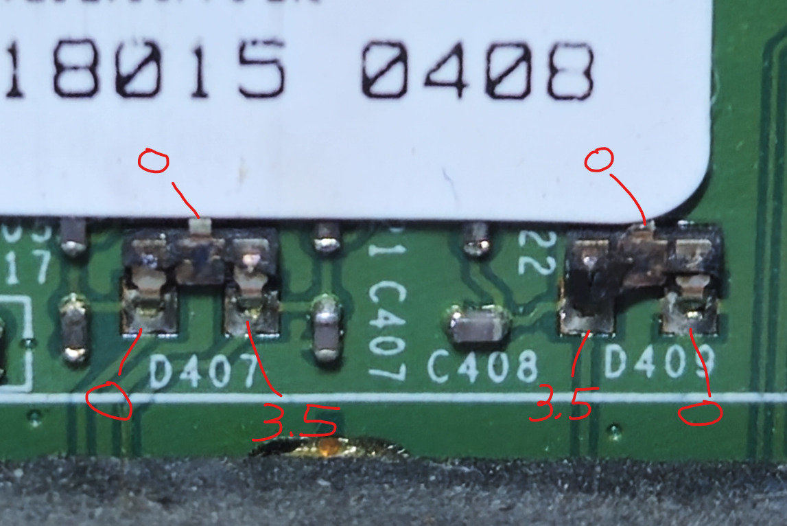

                                Here is what I got when I checked IC202 and IC204. IC 202 was 3.3V on the pin 1. IC204 was 1.5v on the tab. I could not find IC206. If you found IC206, can you point to it on the board?
                                When looking for the IC206, I noticed a couple "Burned" components. These are D407 and D409. I take it these are voltage regulators. Here are the readings I get on them. Are these OK?
                                "IF" I do need a new flash for the IC901, where do I get the file to flash on it?
Name:	D407_D409 Readings.png

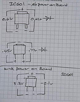

                                  Sorry not IC206 but IC601, to the right bottom, those two are double diodes, check them in diode mode, the ic901 must not be changed but only programmed, i don't have the dump..
                                  • karthur
                                    • Nov 2015
                                    • 150
                                    Do I need to remove the IC601 from the board to test it? Do you think the D407 and D409 are good?
                                    • Davi.p
                                      Hobbist Tech
                                      • Sep 2009
                                      • 4432
                                      • Italy - Milan
                                      1) test as the other ones 2) test them..

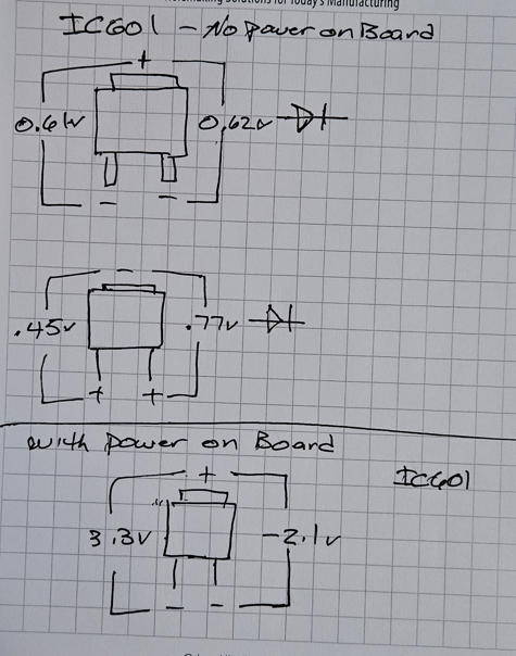

                                        I did check the D407 and D409, but not 100% sure what they should test. They were 0v on one leg and 3.5v on the other (See post #15). I tested IC601 on the board with power on it and without power diode mode. Attached are the results.
Name:	IC602 Readings.png
                                        I also tested some of the other voltage regulators that looked similar in diode mode. The readings were .3 and .6 one one and .5 and .6 on another one. Not really sure if I am doing this right or not.
                                        • Davi.p
                                          Hobbist Tech
                                          • Sep 2009
                                          • 4432
                                          • Italy - Milan
                                          no power on board..
                                          test ic601 as the other ones, thus in volt on the tab, if it's 3,3v is ok, if no short (0v) on the diodes then ic901 reprogram..
