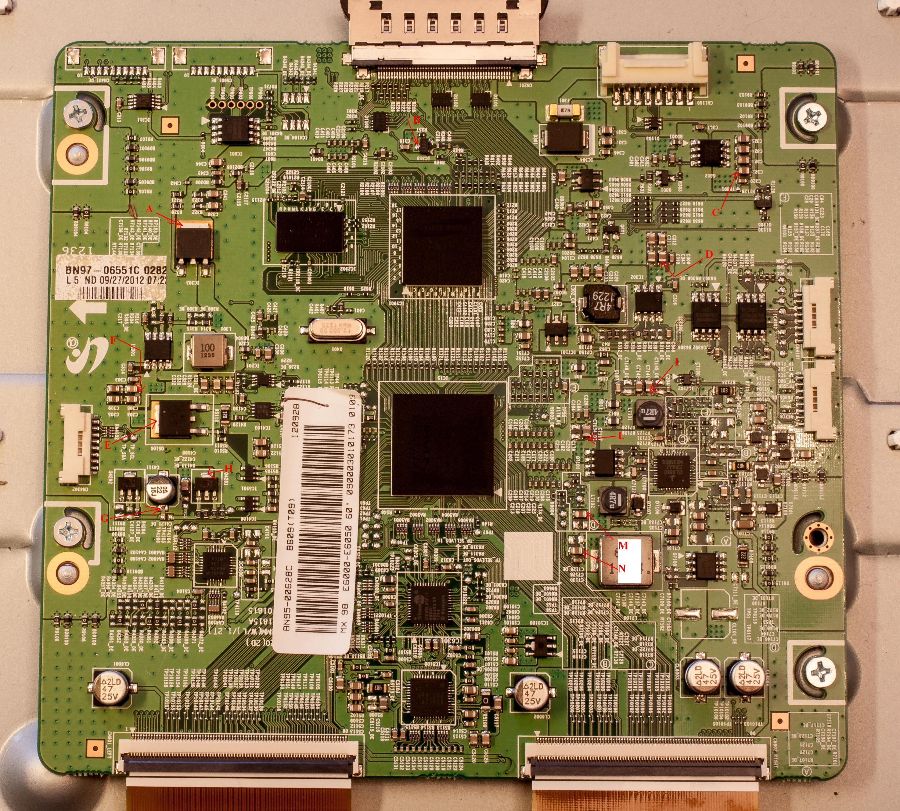

    Here is the picture of the T-Con board.

      Re: Samsung UN60EH6000 Tries to come on, but stops
      Is not Hires photo, what can i see with this?? And also, get only tcon not cables and chassis..
          Here is a high resolution image of the T-Con board (BN95-00628C). This image gets compressed in the translation. I also put a copy of it on my google drive so you can get the full resolution image if you need it.
            Ok i've DL it, now im editing..
              Test all point in volts. I don't see well to what is connected Q7100 apart those 2 elctrolitycs, but if you want test them...
              If some points has a near zero V then them must be retested with output flatcables detached...

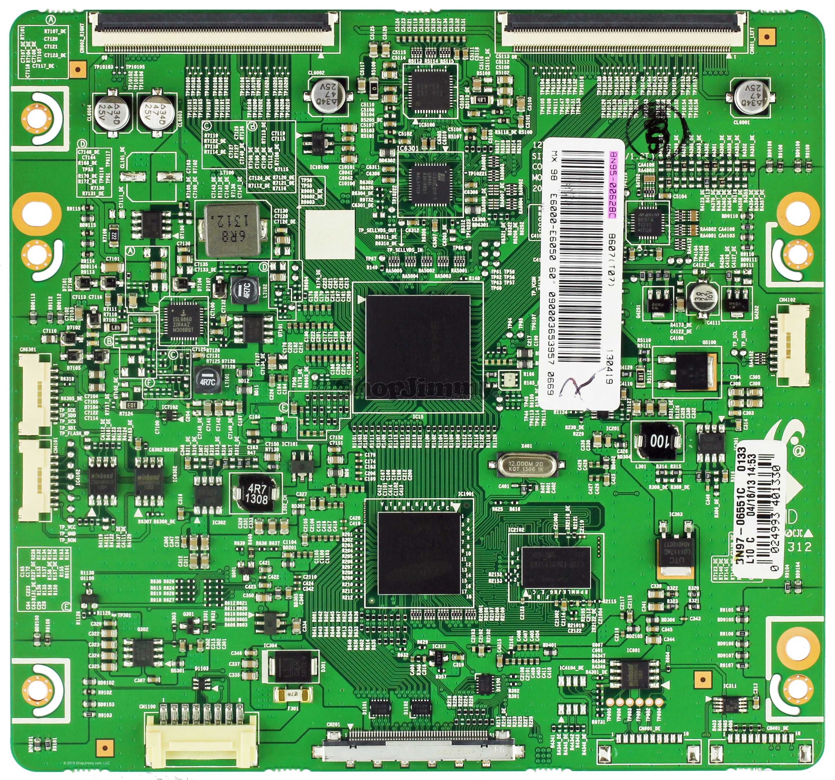

                It looks to be high failure rate T-CON.
                Samsung BN95-00628C (BN97-06551C, BN41-01815A) T-Con Board
                http://www.shopjimmy.com/catalogsear...ung+UN60EH6000
                Notes from SJ:
                PLEASE NOTE: We recommending using one of the following boards as a substitute for this T-con:
                BN96-28943A
                BN96-28944A
                BN95-00944B
                BN95-00944C
                Pictures provided by shopjimmy.
                We have found these boards to have a lower overall failure rate than BN95-00628A, BN95-00628B or BN95-00628C.
                Check the resistance between the two legs of those SMD LYTICS caps (4).
                Report the DC Voltage reading of the ADJ 1117 LDO IC303.
                  To upload pictures click on paperclip, a popup window appears, select the file locations, click upload and wait, when done close window then write the text, click newly on the paperclip and select the pictures to include..
                  Here are the readings with the output cables connected (all readings in dc Volts):
                  A=1.8
                  B=3.3
                  C=12.7
                  D=12.7
                  E=12.7
                  F=12.7
                  G=0
                  H=12.7
                  I=0
                  J= n/a
                  K= n/a
                  L=12.7
                  M=0.7
                  N=12.7
                  For the ones that were close to Zero, I retested with output cables disconnected.
                  G=0
                  I= 0
                  M=0.7
                  I found the Q7100 that you mentioned, but not sure what I need to test there. If I need to check something near Q7100, just let me know what it is.
                  Thanks.

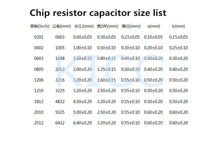

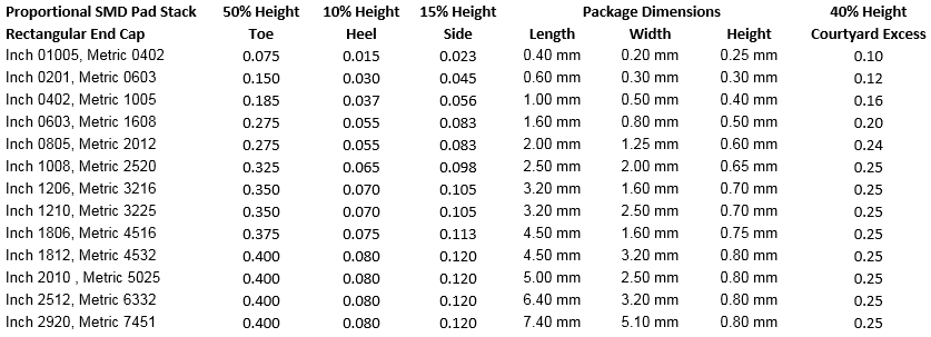

                                      i have a cheap pair of digital calipers and use this guide https://www.pcblibraries.com/forum/s...topic1729.html
                                        Nice charts! But Where in those charts show the capacitence?
