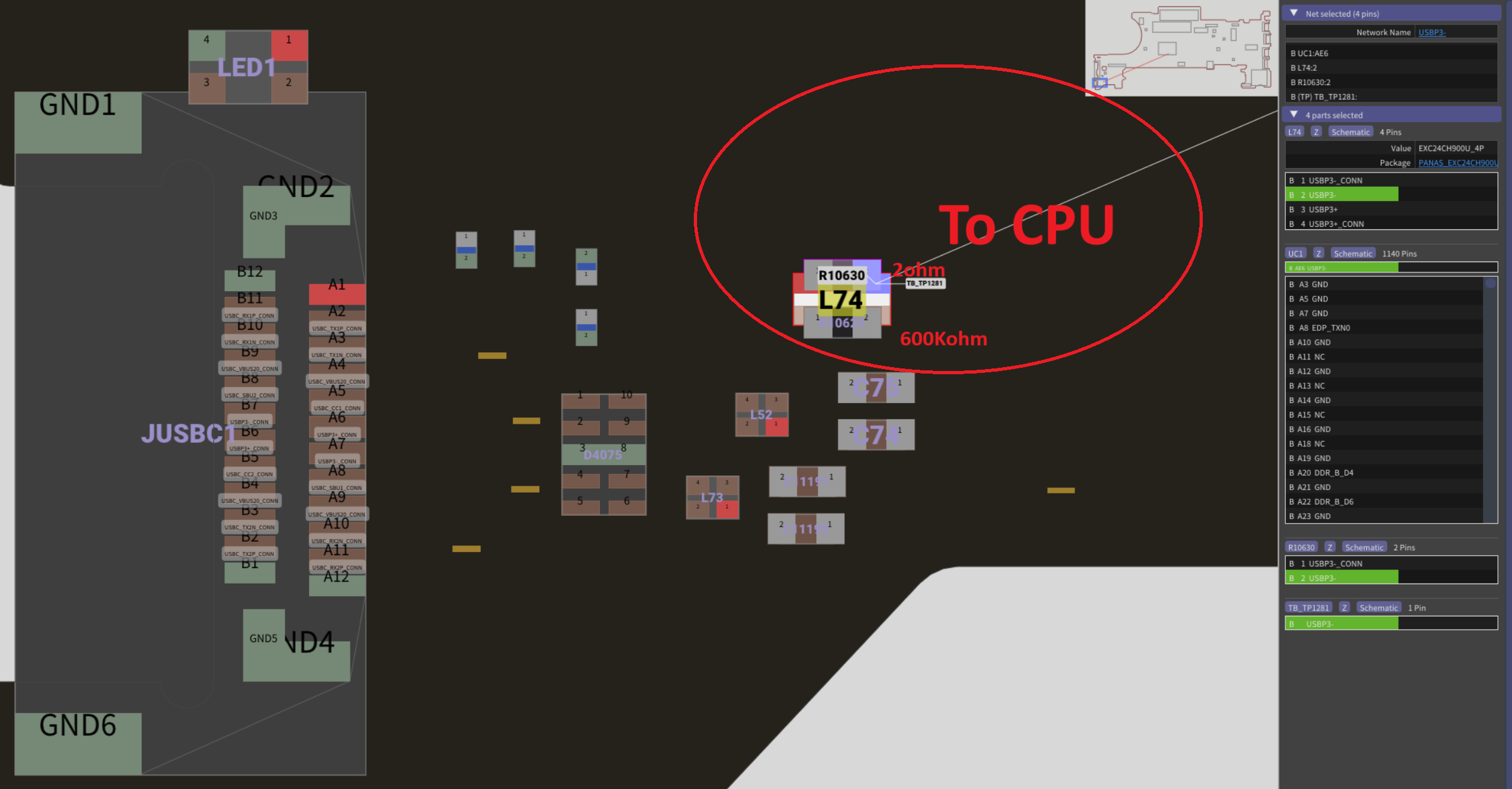

    I finally received 1.8V conversion board and flashed a different BIOS. Still no changes.
    Board - Lenovo A485 NM-B711
    I started to test resistance on USB 2.0 D+ and D- pins. Almost all of them had 0,6Mohm resistance, except D- line going to a USB C port, which had only 2ohm resistance.
    I desoldered the L74 component, but the 2ohm resistance still remained. And the line goes straight to CPU.
    Does that mean the USB 2 controller in CPU is bad?
    But the Web Camera, which is using USB 2.0, still works.

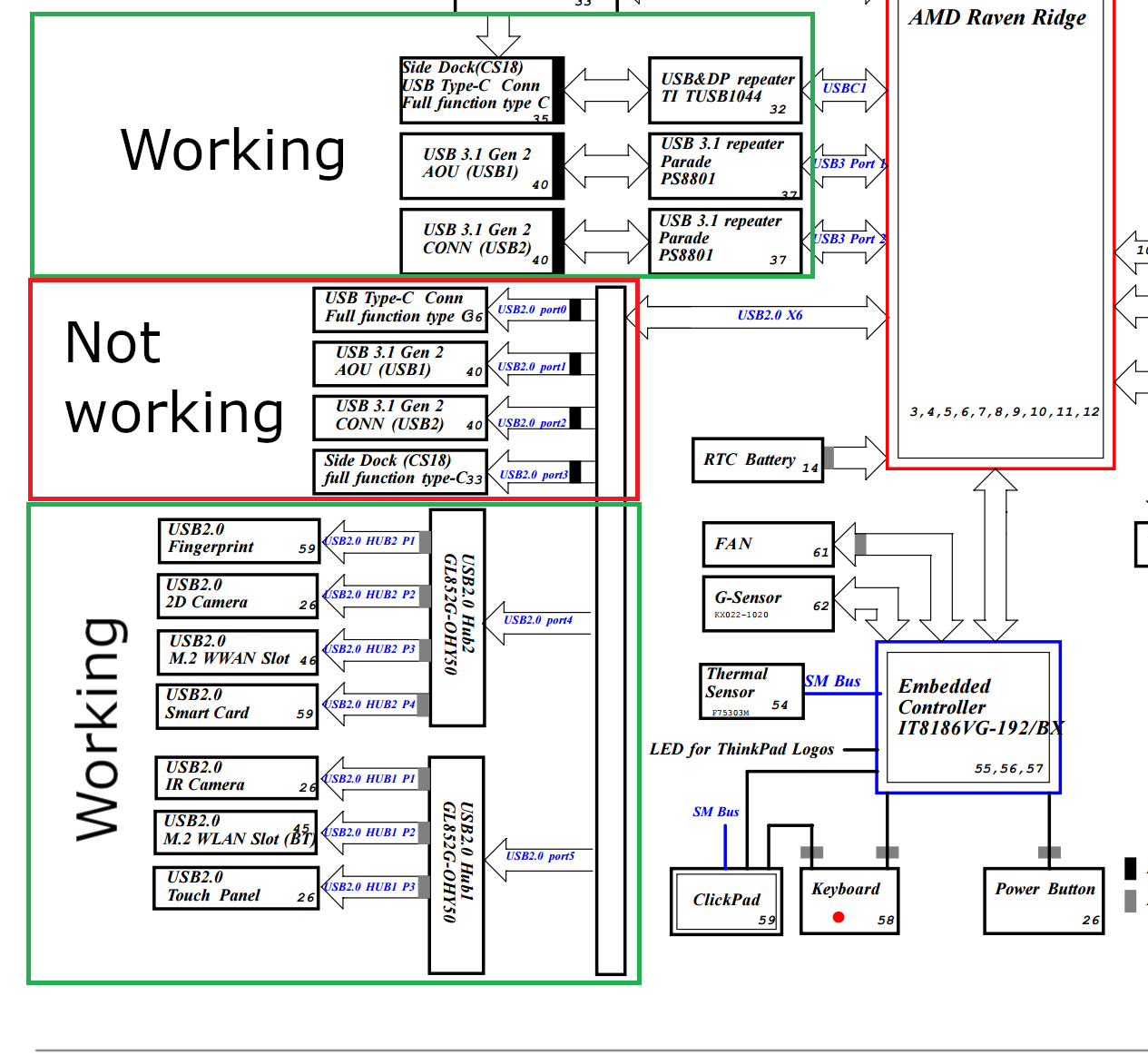

    Any ideas?
    Thank you.

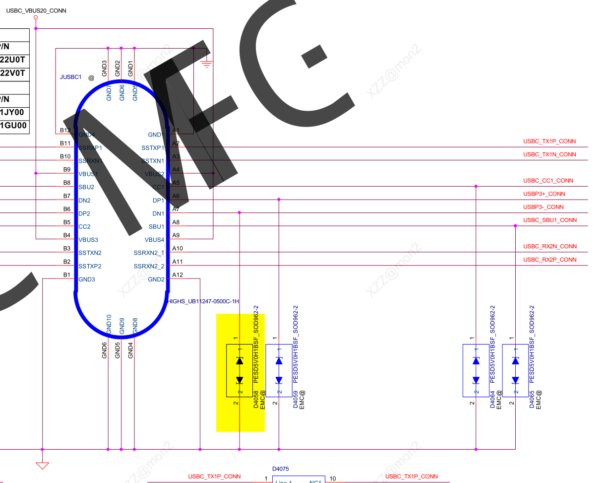

    • mon2
      • Dec 2019
      • 14672
      Flux and carefully remove D4058 off the board. Measure the resistance to ground again after this removal - leave this TVS ESD device off the board.
      < Assuming this part is onboard >
      Update - measure the resistance from the TVS ESD diode to the CPU. Is there a low resistance? This is to confirm that you have truly isolated the connector side from the host side. Aside from the 2 x ESD diodes on the USB connector & L74, the CPU is the host controller so it appears it is damaged (to me).

        Originally posted by mon2
        Thank you for reply.
        Made the measurements:
        D4058 Pin 1 > L74 Pin 1 = 0ohm
        L74 Pin 1 > L74 Pin 2 = O.L
        L74 Pin 2 > GND = 2ohm
        Anyway, I removed the TVS, but still no changes.
        All this started to happen after BIOS update (according to my colleague)
        • Sephir0th
          • Oct 2020
          • 1289
          It's a partially fried chipset. Happens regularly. Possibly reason could be that something faulty was inserted in on of the slots but no clue unfortunately.
          I wouldn't recommend voltage injection here since there is a decent chance that the chipset will blow up.
