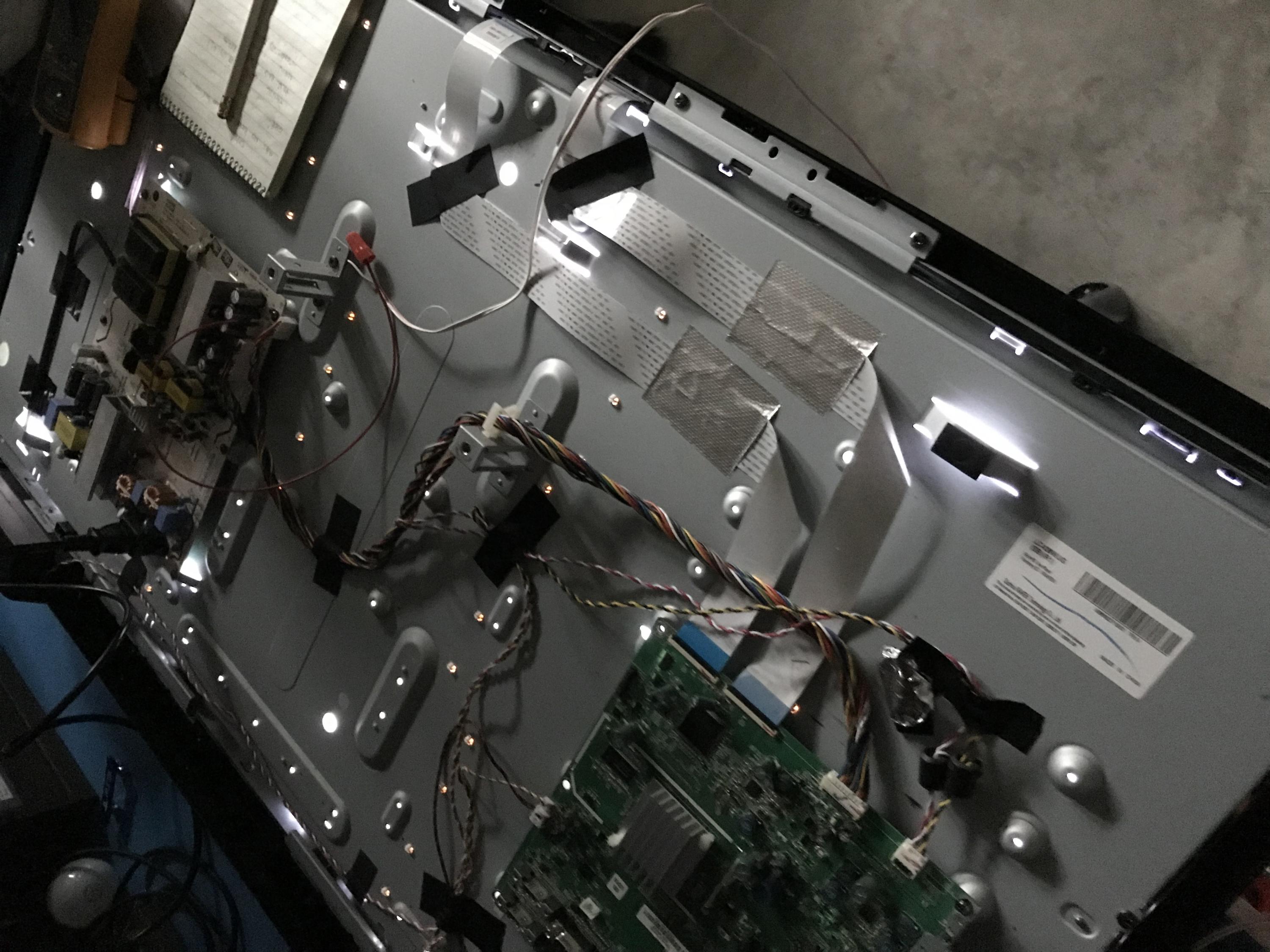

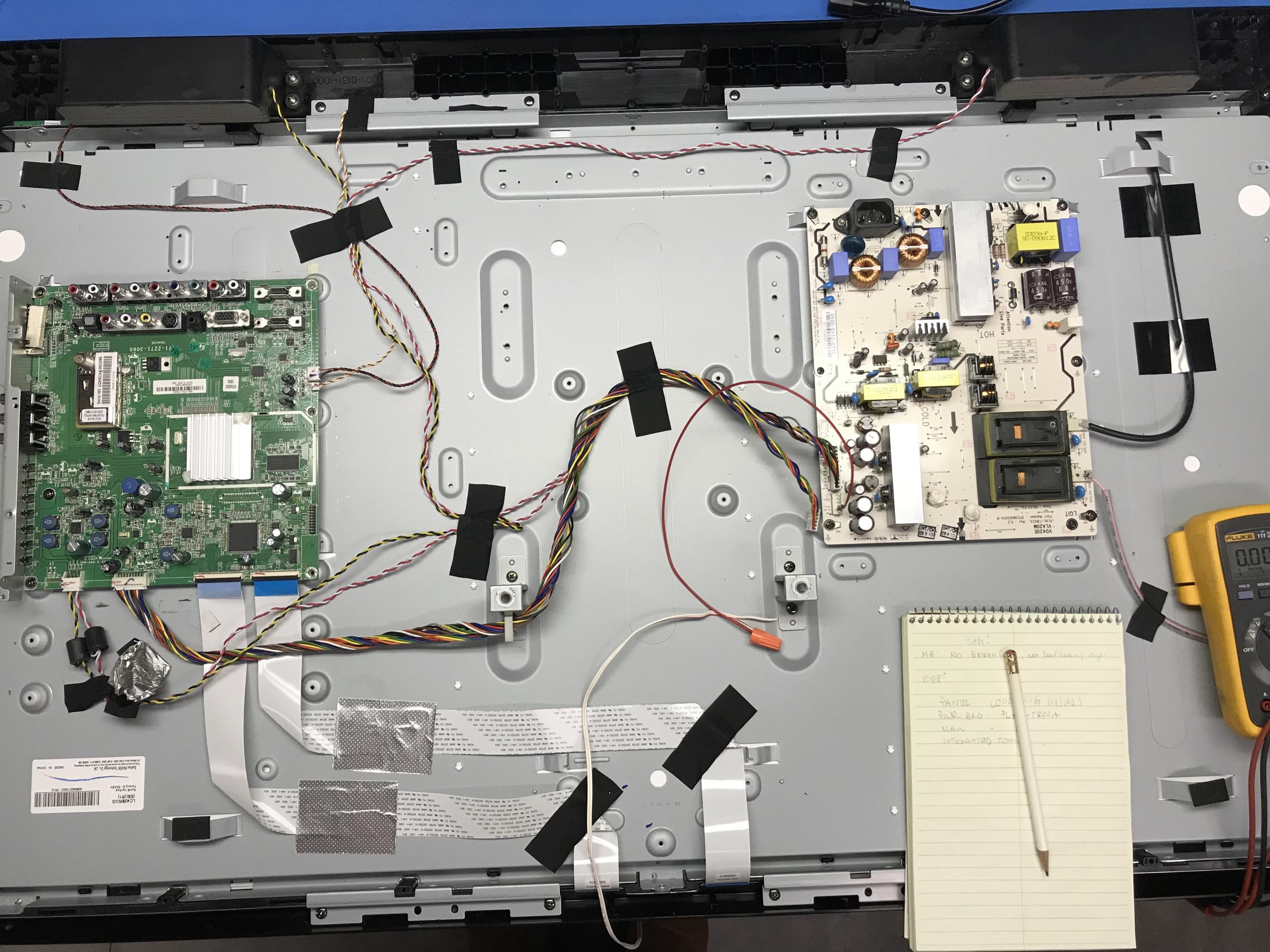

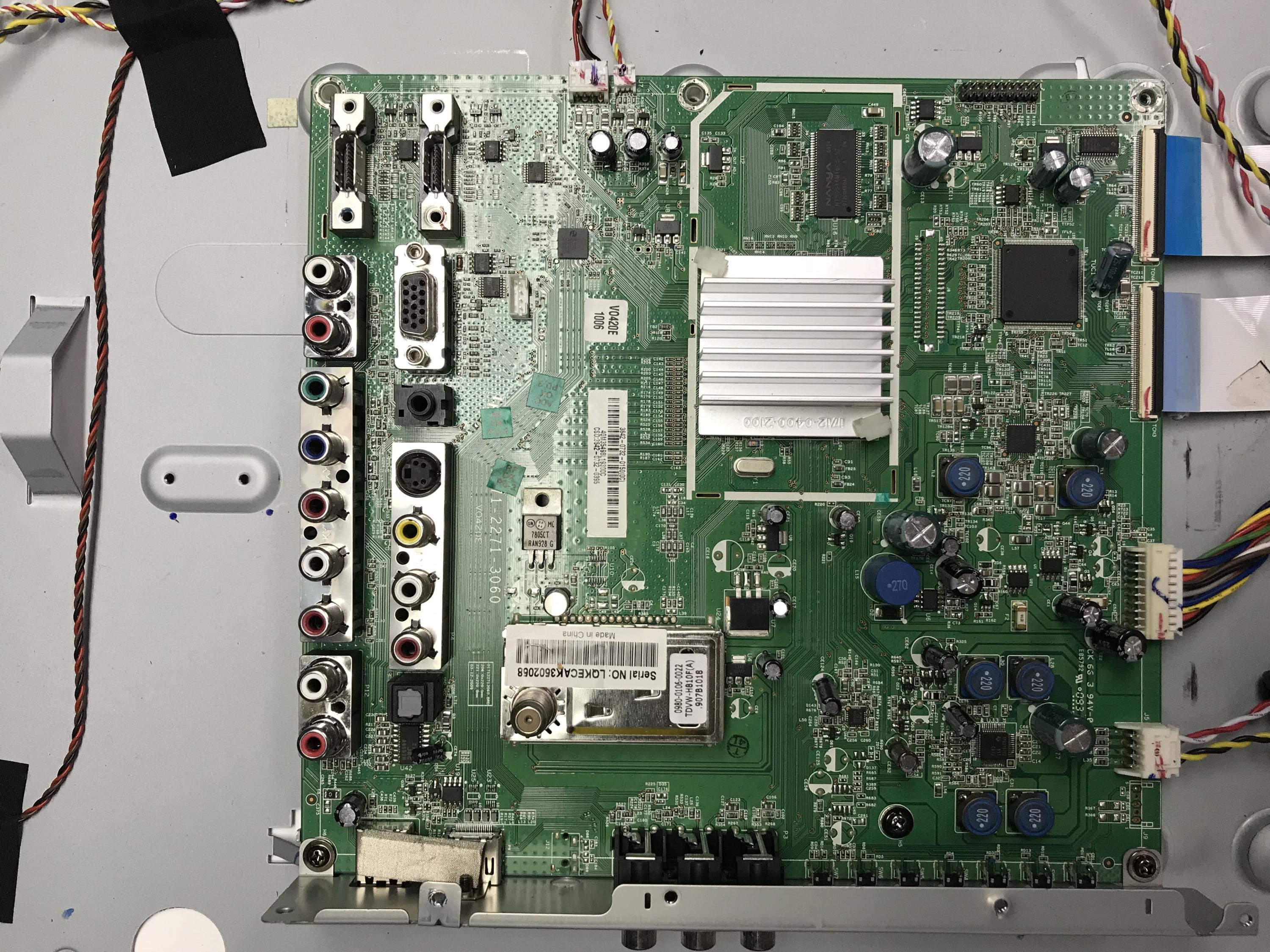

    Good afternoon all -
    I have another TV in hand. This time it's a Vizio VO420E. I picked it up for free the other day. The TV is manufactured in the 2008/2009 time frame.
    Pictures of the boards and an overall view are attached. I checked the voltages on the power board.
    Initial assessment
    - There is some sign of life on the main board, but without schematics, i see that a few caps have 0V on either side, and a couple of LDO's and switching supplies have output voltages. I just don't know if the values are correct.
    - The backlight does not turn on
    - no sign of life with flash light test shining at screen
    - The optical audio out does not illuminate red.
    - The main board fuses near the power connector are okay -
    -- F1 - 5.128V on both sides
    -- F2 - 12.28V on both sides
    Main caps
    +165V across the main caps when off
    +392V across the main caps when the power button is pushed.
    The voltage across the main caps stay steady.

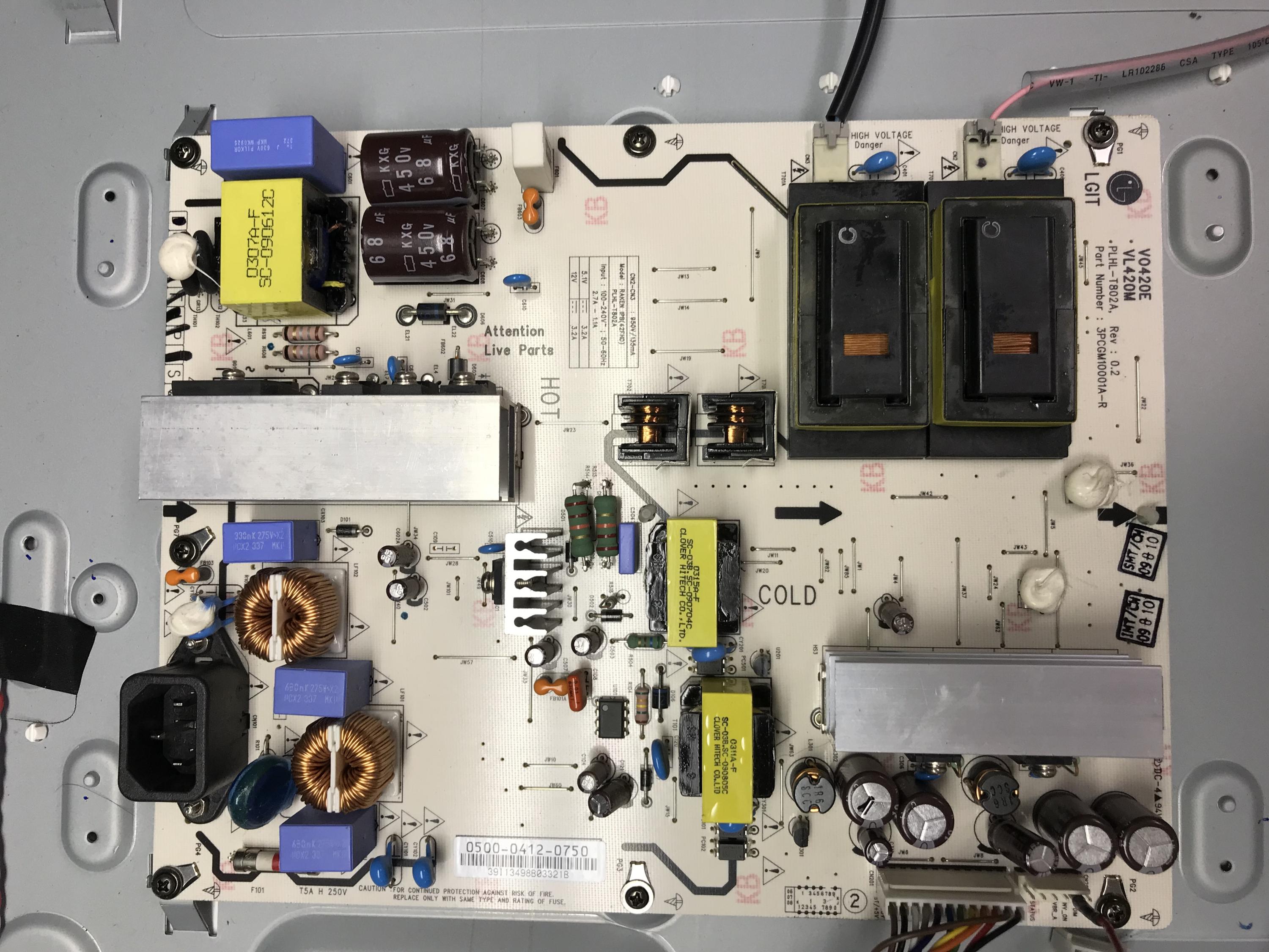

    Power Supply - Connector CN201
    Pin name, actual voltage read
    ON/OFF, 0V (when off), 3.166V (when on)
    +12, 12.27V
    +12, 12.27V
    +12, 12.27V
    GND, 0V
    GND, 0V
    GND, 0V
    GND, 0V
    GND, 0V
    ST/+5V, 5.194V
    ST/+5V, 5.194V
    ST/+5V, 5.194V
    Power Supply - Connector CN202
    DIM, 0V
    INV_ON, 0V
    VBR_A, 0V
    No Connect
    Status, 0V
    No connect
    Tests
    - I was able to force the backlight on by removing the cable from connector CN202, and hooking up an external power supply to the INV_ON signal when the TV is ON.
    - The backlights glow - at least the back lights work.
    - I disconnected the ribbon cables between the main board and the integrated T-CON, no change in behavior.
    - It appears that the main board is not running yet.

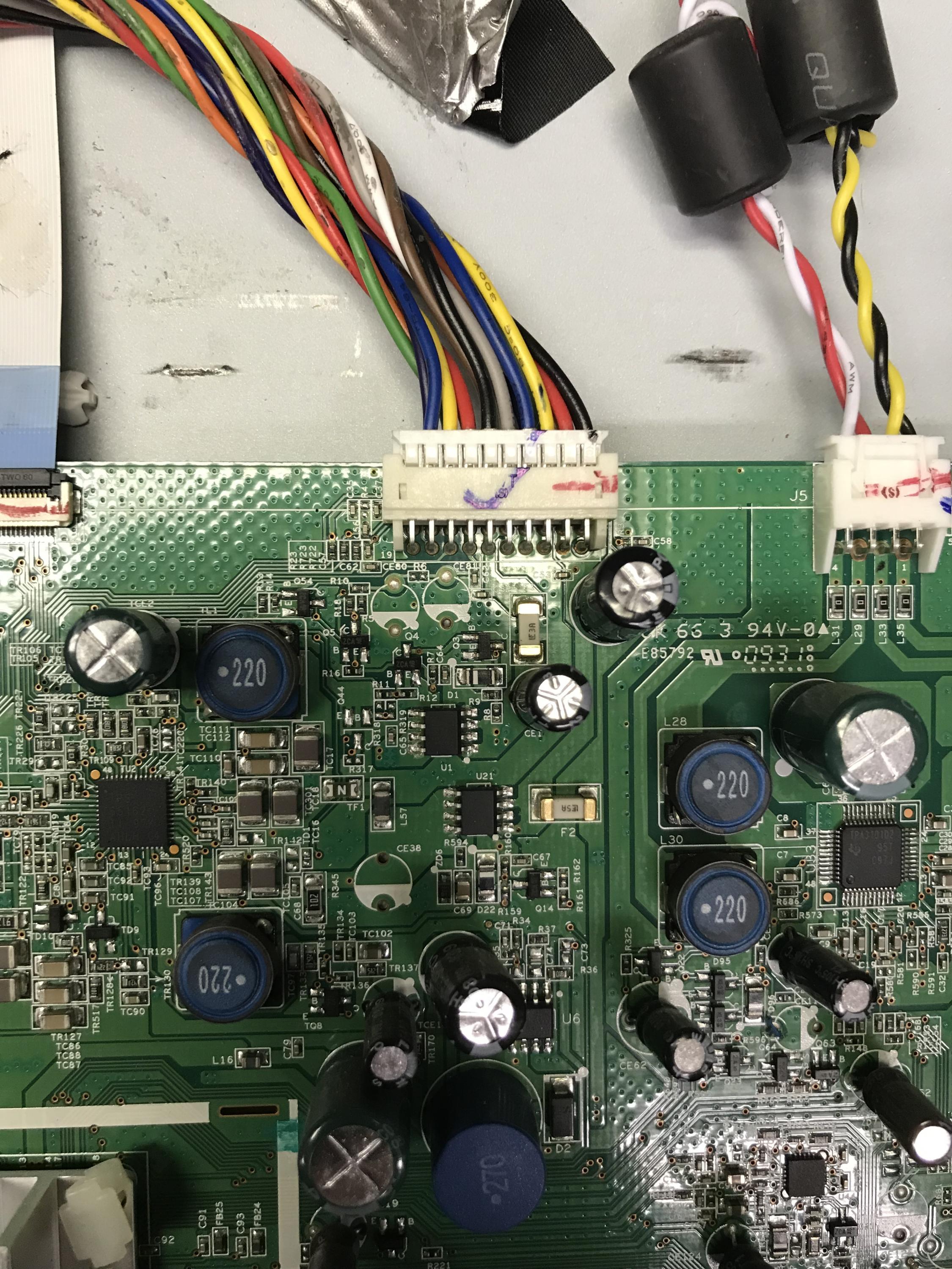

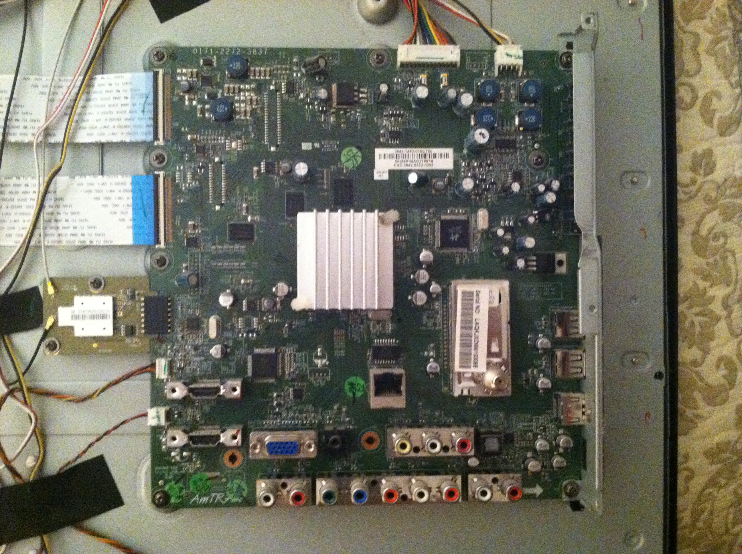

    Re: Vizio VO420E - INV_ON signal stays low
    you main board is only half working. ps/on is present, but bl/on is missing.
    a schematic is normally impossible to find foe main boards unfortunately.
    you can try and trace the bl/on pin backwards from the connector and hopefully find the bad component, but mains are hard to find faults on.
    have you checked all of your ldo regulators?

        @attainteddragon - Yes, here are the LDO voltages that I have found along with the markings on the package:
        Pin orientations are looked at from "left-to-right" with the tab "up"/"north". I can't find a datasheet for the part marked L243 / G1117.
        U11 - 7805CT
        Pin 1 - 12V
        Pin 2 - 0V
        Pin 3 - 5V
        Tab - 0V
        U4 - L243 G1117
        Pin 1 - 5.162V
        Pin 2 - 3.29V
        Pin 3 - 2.046V
        Tab - 3.3V
        U7 - 1084
        Pin 1 - 2.065
        Pin 2 - N/C, short pin
        Pin 3 - 5.147
        Tab - 3.3V
        U9 - L243 G1117
        Pin 1 - 1.259V
        Pin 2 - 2.506V
        Pin 3 - 5.142V
        Tab - 2.506V
        U8 - L243 G1117 - I think this one looks suspect.
        Pin 1 - 0V
        Pin 2 - 1.250V
        Pin 3 - 3.3V
        Tab - 1.250V
        U2 - L243 G1117
        Pin 1 - 2.045V
        Pin 2 - 3.288V
        Pin 3 - 5.137V
        Tab - 3.288V
        U4 - L243 G1117
        Pin 1 - 1.372V
        Pin 2 - 2.619V
        Pin 3 - 5.140V
        Tab - 2.619V
        TU31 - I think it says EH13A / 925N05 - no voltage
        Pin 1 - 0V
        Pin 2 - 0V
        Pin 3 - 0V
        Tab - 0V
        U21 - 4953 is what i can make out.
        Looks like a dual channel P-FET like a Vishay Si4953
        Pins 1 and 3 are the source
        Pins 2 and 4 are the gate
        Pins 5-8 are the drain.
        Pin 1 - 12.25V
        Pin 2 - 11.97V
        Pin 3 - 12.25V
        Pin 4 - 11.97V
        Pin 5 - 0V
        Pin 6 - 0V
        Pin 7 - 0V
        Pin 8 - 0V
        U1 - 4953 is what i can make out.
        Pin 1 - 5.163V
        Pin 2 - 0V
        Pin 3 - 5.163V
        Pin 4 - 0V
        Pin 5 - 5.147V
        Pin 6 - 5.147V
        Pin 7 - 5.147V
        Pin 8 - 5.147V

              I attached an up close photo of the power input area with the two FETs.
              I'm a little rusty on my P-FET logic. The pin out of U21 () has the Source on Pins 1 & 3, the Gate on pins 2 & 4, and the drain on pins 5-8.
              The Gate should be controlled by the microcontroller. I haven't followed the traces for the Gate back to where they originate, but i would imagine that the source and gate should be both 12V.
              If anything, if the Gate is "high" i should see a voltage expressed on the drain side and it should be close to the Source side, correct?
              -Thomas
              I'm a hardware engineer focused on networking equipment for my day job. I void warranties and fix consumer electronics for fun.
                This is P-CH so the GATE Voltage will have to be at least 3~4VDC < than the Source pin Voltage for this P-CH MOSFET to be on.
                I would not worrying about this MOSFET right since you have multiple command signal problems.

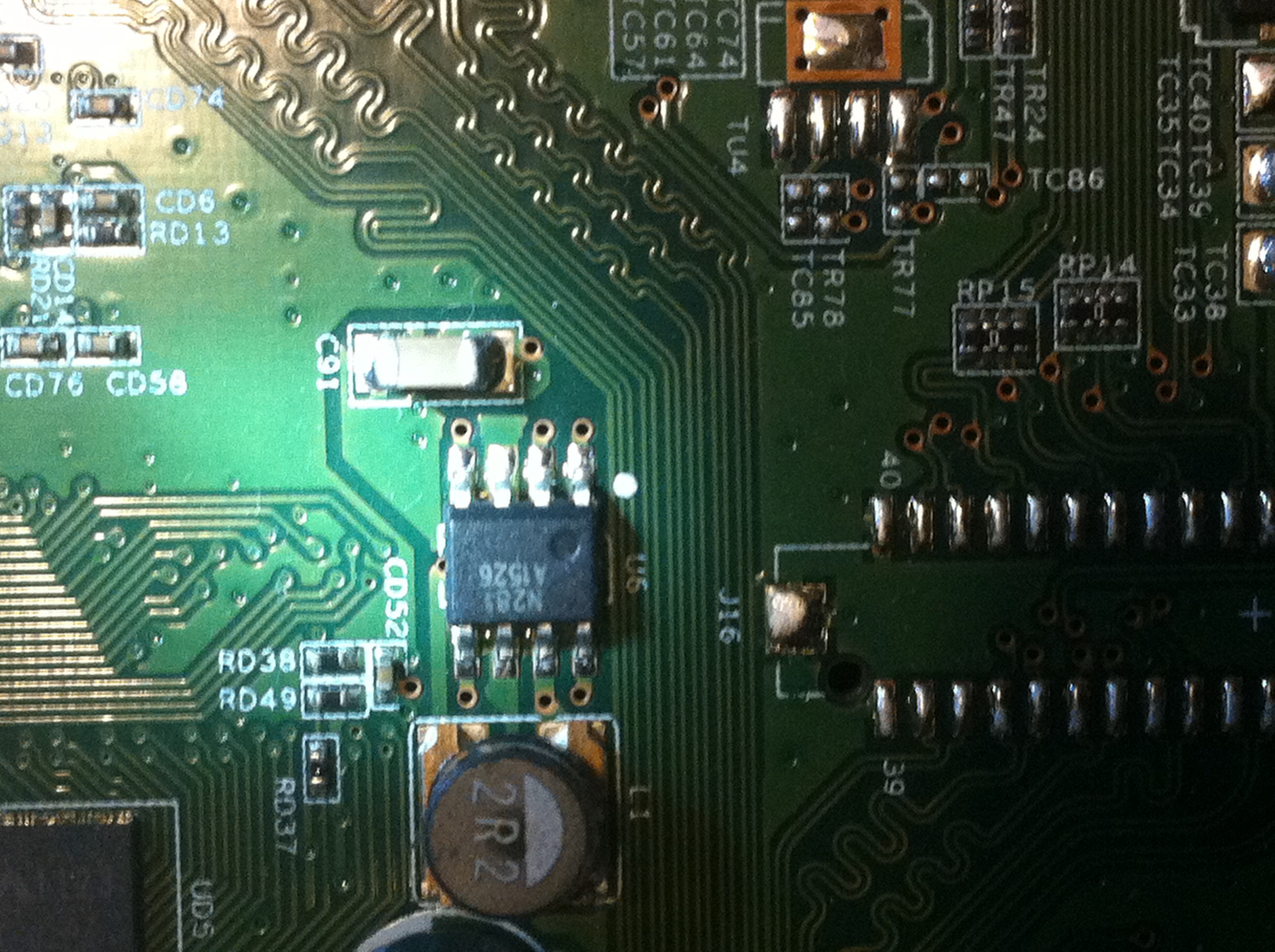

                          Need a little help here... i've been looking for a similar thread but can't find anything.....
                          I have a Vizio , model number E3DB420VX, and the mother board number is 3642-1462-0150(7b).
                          After looking and researching on the internet for the last two days it seems that all arrows point to the EEPROM CHIP.. however i can't find the location of the chip and nowhere on the internet is it listed.... question is, IS it on this motherboard or is it integrated like the emachine computers of old.... yes i'm that old. If someone can point out what the location number might be that would be awesome. The only station numbers i have seen that remotely look like eeproms are U2,6,8,10. All others look like something else. I've contacted shopjimmy and anybody else listed and they told me to come here. So here i am. I appreciate all suggestions...
                            On mine, the eeprom is on the back of the main board.
                            What are the markings on the parts you identified? Pictures or a line by line breakdown would be helpful. Look at eBay for other potential sources.
                              part eeprom marking will have 24........ or 25......... on it.
                                All EPROMs I have seen are 8 pin and there are like 5 of them in various sizes .... I'll try to post this pic I took with my phone ... I'll take better ones tonight an see if that helps
                                      It is a smart tv.... A and all the locations for EPROMs they "look" fine no burns or swelling ... Is it a programming issue ? And if I can't find the correct programmed EEPROM then buy a new board ?
                                        The only one I see that has a 20's number is this one ...... N28
