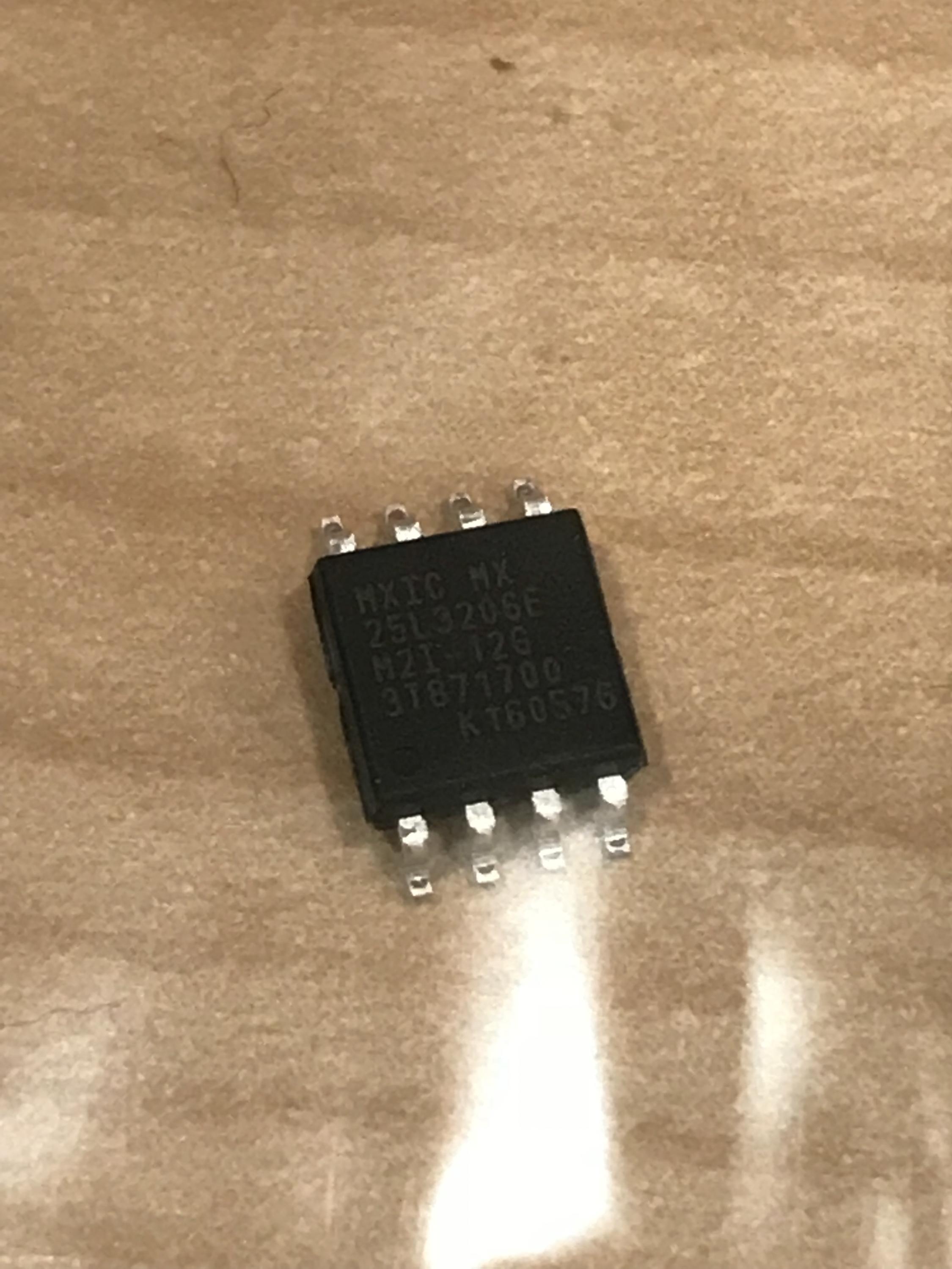

      OP here. I received the EEPROM last week. Just finally going through my mail box as I was on vacation last week.
      The replacement kit comes with 5x LDOs and the EEPROM. The markings are shown in the attached image - looks like a 32Mb (4 MB) SPI flash device. I'm going to dump the EEPROM contents at work on Monday and post it to this thread and the EEPROM dump thread for future reference.
      I'll install the EEPROM Monday evening after I have a known good backup copy.
      Markings are as follows:
      Code:
      MXIC MX
      25L3206E
      M2I-12G
      3T871700
      KT60576
      The blank part can be found here: https://www.digikey.com/products/en?...5L3206EM2I-12G

        The EEPROM dump from the replacement part is attached. I also posted this into the EEPROM dump thread.

              just replaced the SPI Flash. Confirmed fixed. Tv boots.
