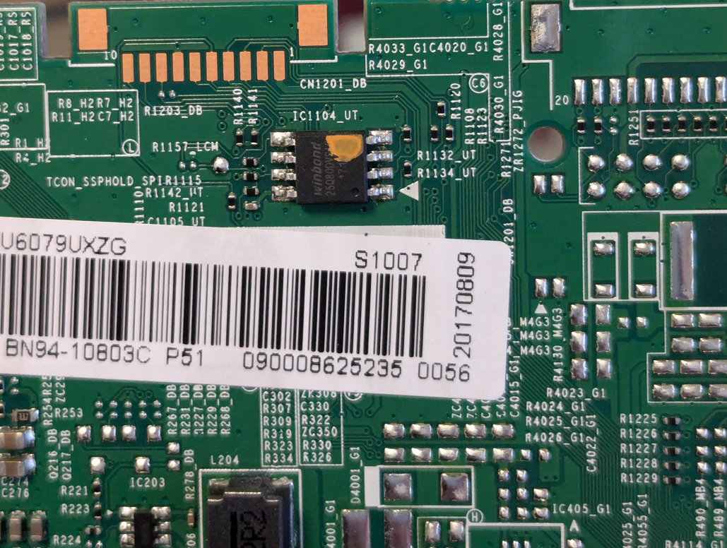

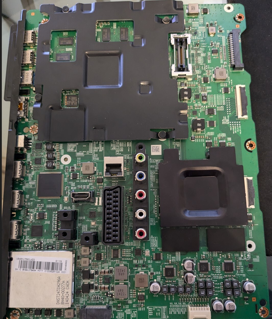

                                  I have a Samsung UE65KU6099UXZG with no standby LED. Voltages on Motherboard are fine (5V, 3,3V, 1,8V). Here is the EEPROM dump. Maybe it is bad?

                                    #1777
                                    This dump has nothing to do with standby, this spi flash belongs to T-con, look for spi flash 25Q40 on the board.

                                      #1778
                                      Here is the SPI dump. Thanks for your help.

                                        #1779
                                        This dump is ok, working.

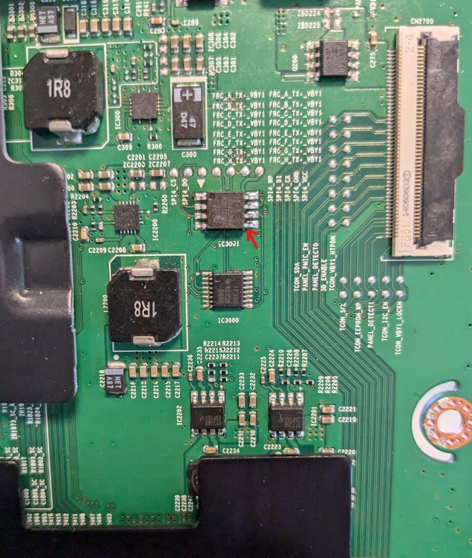

                                          #1780
                                          Here is a dump of a Samsung UE48HU7590: Board is HU8500 BN41-02257B. TV starts for 1 second with "Smart TV" logo and then turns off screen. No reboot loop. Maybe you can find here a defect in the SPI EEProm. I added the second EEProm which is behind the little black heatsink as well in the ZIP.
