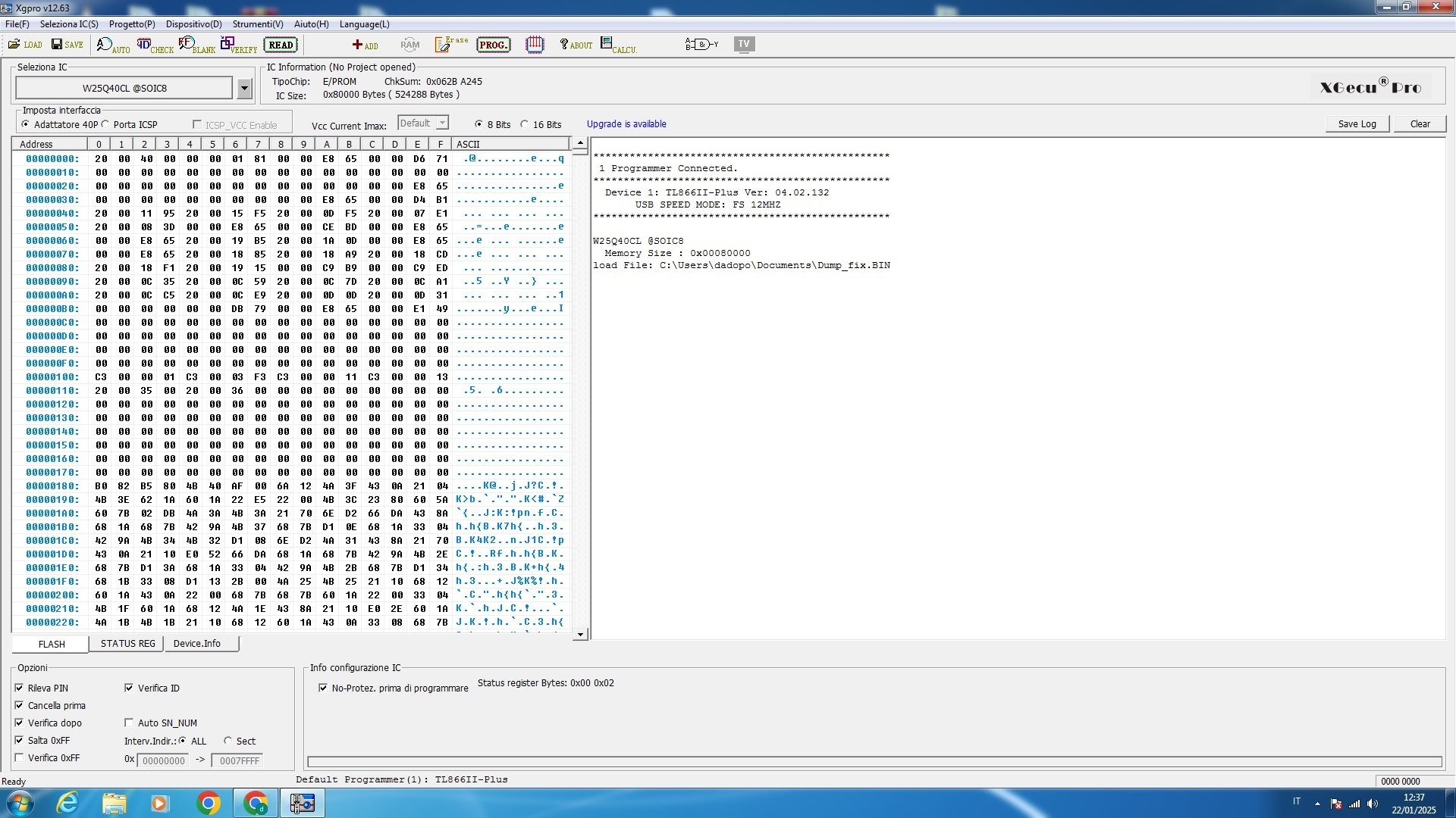

                                Good morning, I would need a good dump file for my samsung ue40mu6400uxzt, I attach the original dump.
                                Thanks in advance to anyone who can help me​
                                  Try your good dump file for your TV.
                                  Don't forget to set and write the status register (0x88, 0x42) after writing the corrected dump.

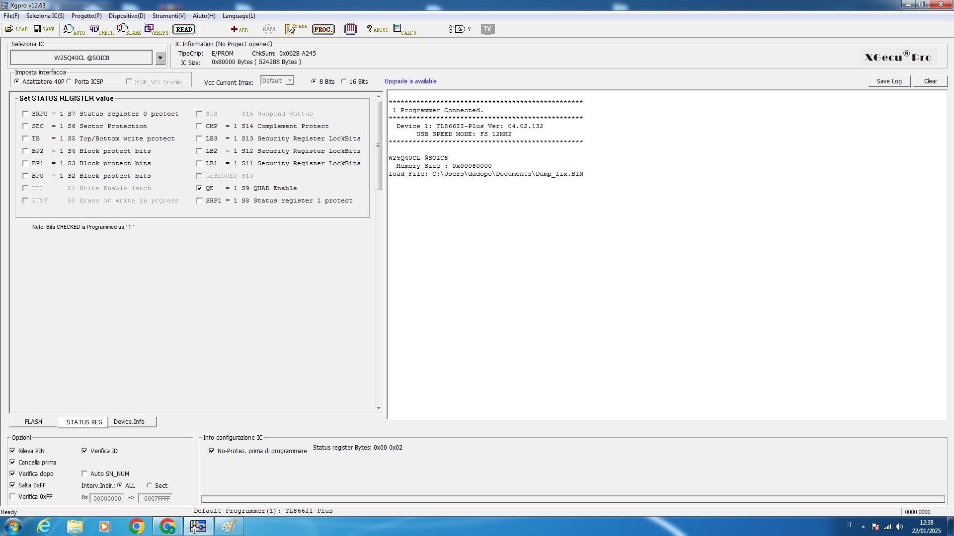

                                    #1857
                                    Thank you for your time, but where I change the status register I attach images of my programming software, thanks again

                                      #1858
                                      Like this.

                                        #1859
                                        Thanks, I tried now the led lights up, flashes 3 times and then turns off, I have to check the mosfets on the board, thanks for everything
