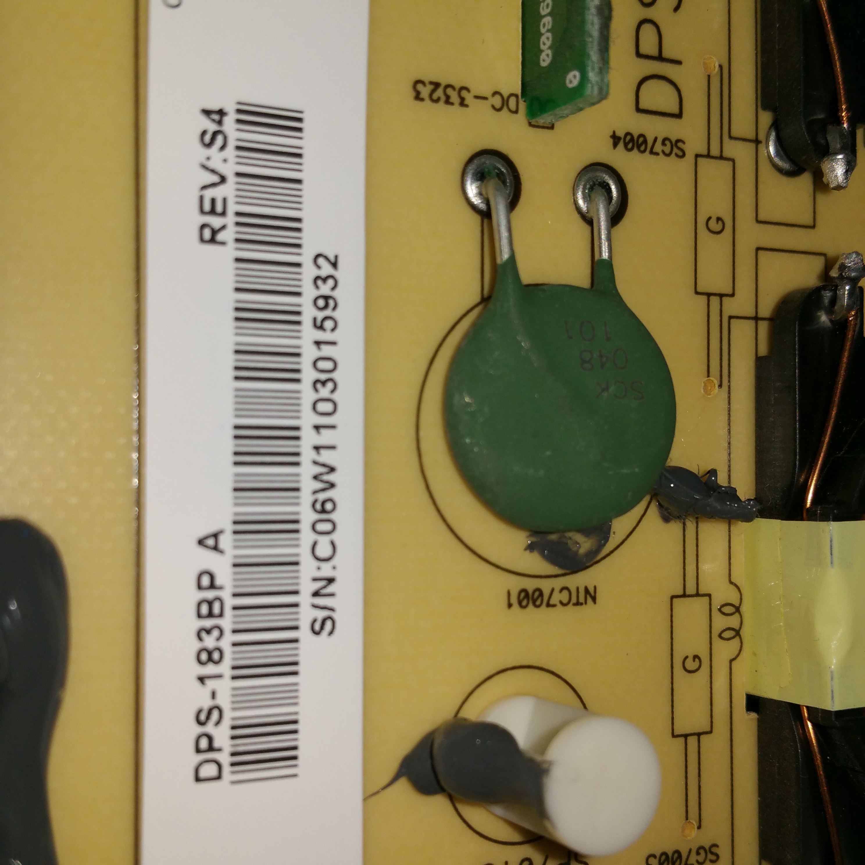

                  Re: Sharp Aquos LC-60LE830U One Long One Short
                  What power supply does this tv have? DPS- ....
                      Here's the panel and power supply model numbers
                              I got the 46LE830U with only 5V. Tried new mainboard , same situation. I already looked at the leds , visibly they look ok. They are as Dick Barton said , 4 strips.
                              Do you have any voltages at all on the PS? I only got 5V on the secondary side on the connector going to the mainboard and 340V / 13V on the primary side. I have no voltages on the driver circuit at all , can be a defective ic on the mainboard?
