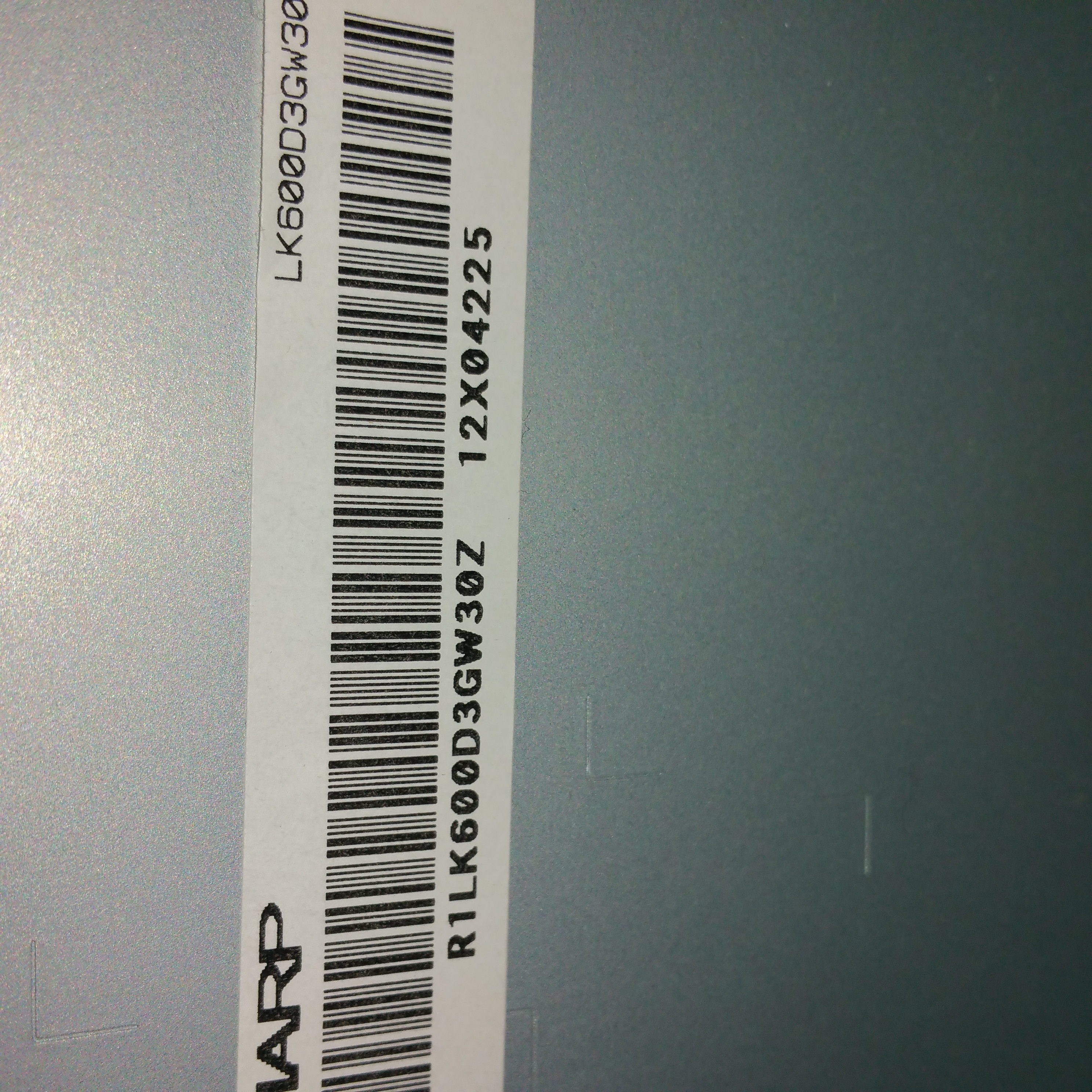

          Does anyone know what the led arrangement and quantity are in this unit ? It has four pairs of wires but i'd like to get an idea of the voltage I can throw at them. Nothing printed on the power supply.
            Re: Sharp Aquos LC-60LE830U One Long One Short
            This is where LED tester comes in handy.
            May be the LCD panel spec sheet will tell you, what is the model number of the panel? It has four set of strings base on four drivers circuit I can see on the board.
            Panel is LK600D3GW30Z??? I cannot locate spec sheet for the panel.
                      Here's the panel and power supply model numbers
