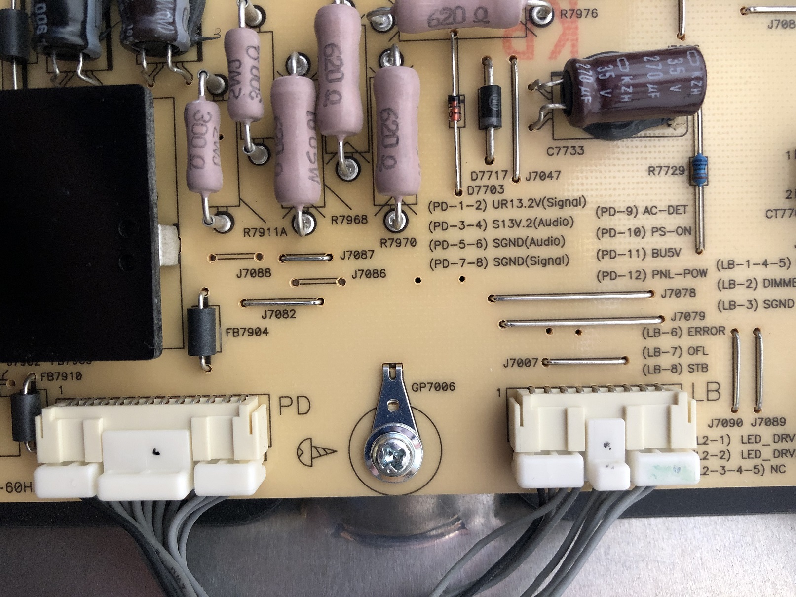

    I measured voltage on PD connector pins with power turned on, after boomerang signal is up and with all connectors plugged into the power card (I dit not remove something at this time).
    PD-1 - UR13.2V (SIGNAL) : 0V
    PD-2 - UR13.2V (SIGNAL) : 0V
    PD-3 - S13.2V (AUDIO) : 0V
    PD-4 - S13.2V (AUDIO) : 0V
    PD-5 - SGND (AUDIO) : 0V
    PD-6 - SGND (AUDIO) : 0V
    PD-7 - SGND (SIGNAL) : 0V
    PD-8 - SGND (SIGNAL) : 0V
    PD-9 - AC-DET : 0V
    PD-10 - PS-ON : 0V
    PD-11 - BU5V : 4,99V
    PD-12 - PNL-POW : 0,09V

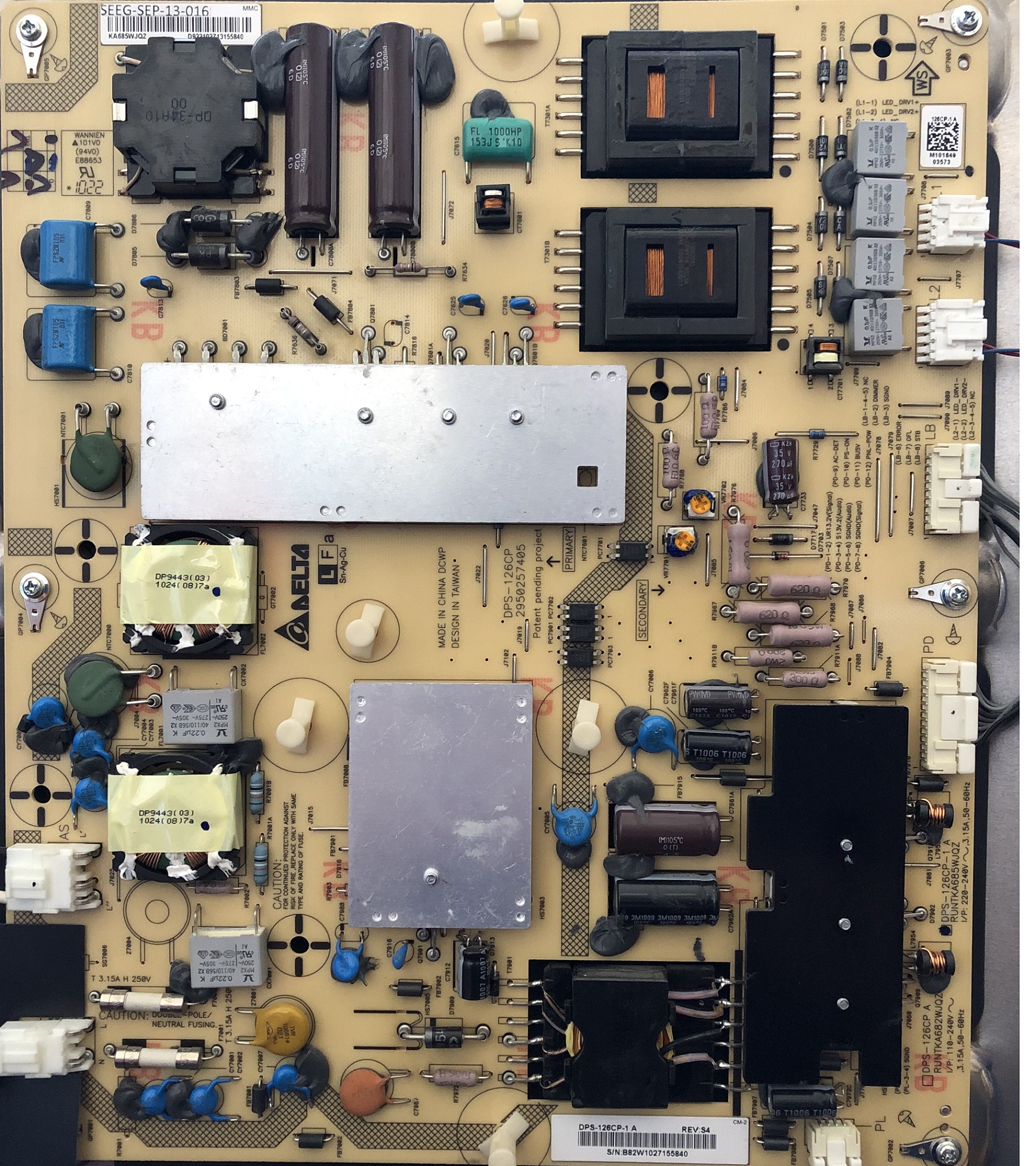

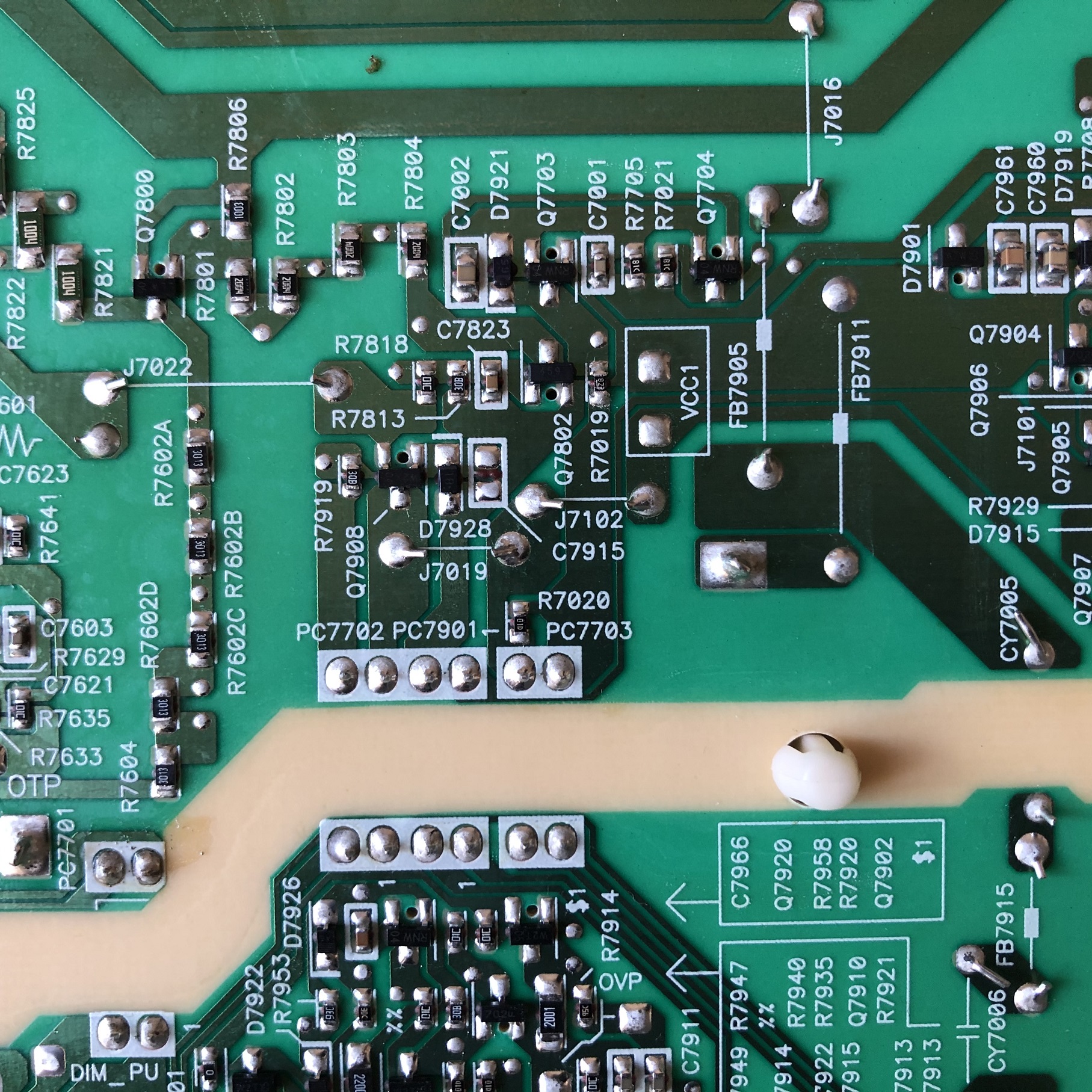

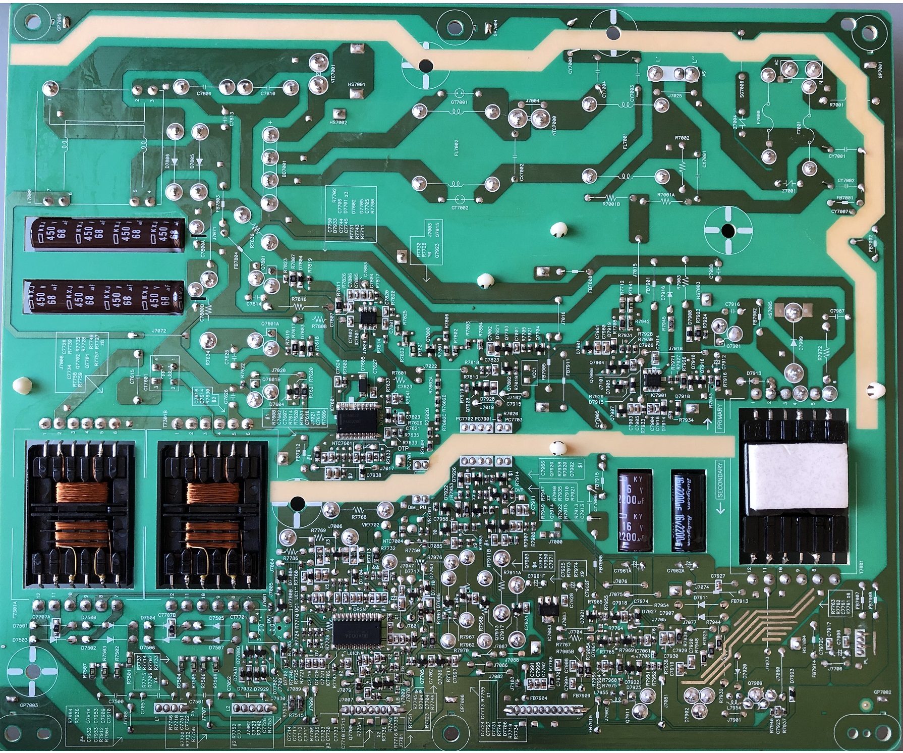

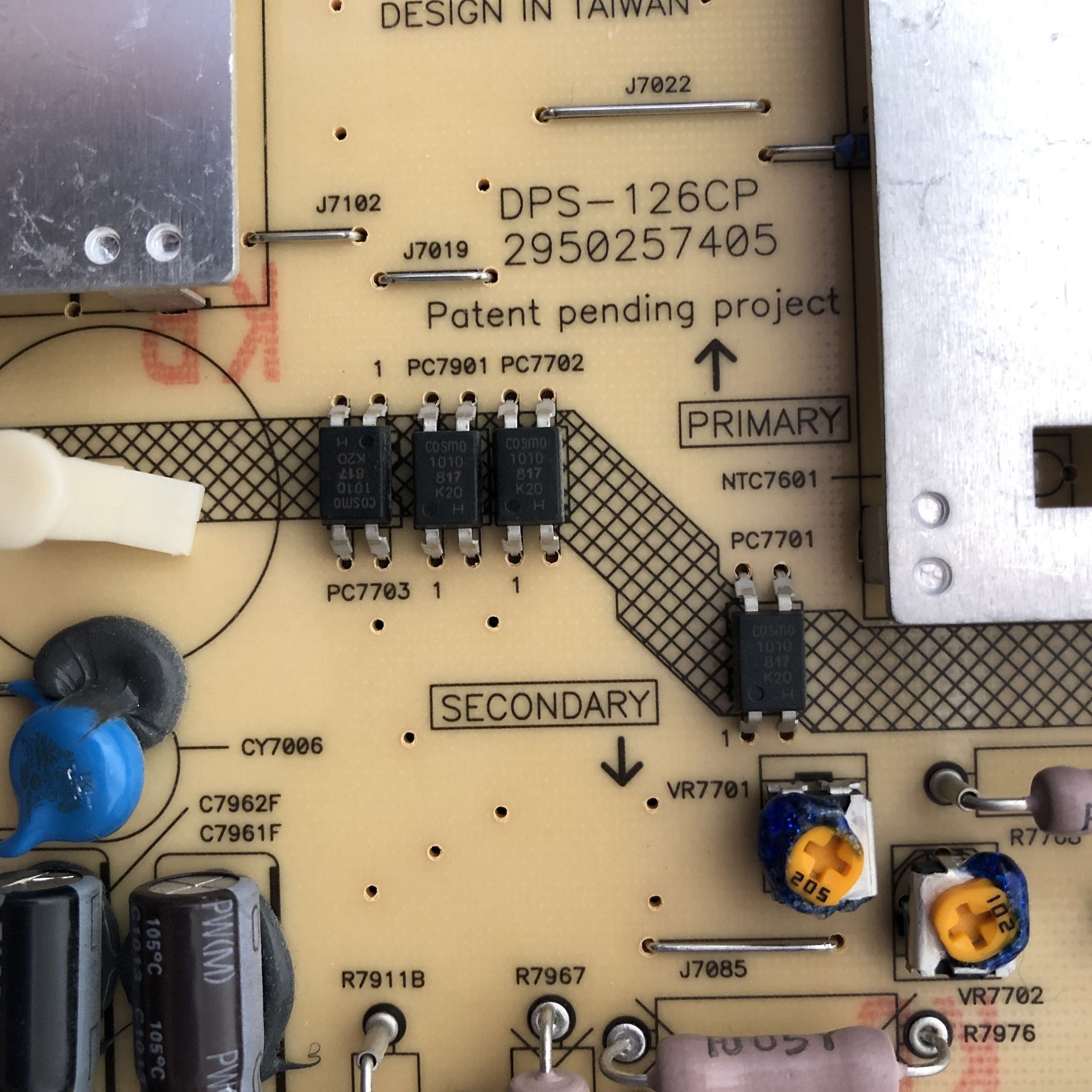

      Re: Sharp Aquos LC-40LE810E - 2 long, 1 short
      Hello Budm,
      First, thank you for your help.
      My board is a "DPS-126CP-1 A"
      I attach 5 pictures : Power card (face & back), focus on optos (face & back) and focus on PD connector if needed
      The reference written on optos is : COSMO 1010 817 K20 H
      On a famous chineese webstore, I see this reference : COSMO 1010 817C K10101C DIP4 COSMO1010-817 DIP-4
      Is that the same component ?
      Not easy to find on a european website, so I think I will wait for weeks before having them...
          Thank you Budm,
          I am not sure of what I can purchase as a component.
          The reference written on the 4 optos is : COSMO 1010 817 K20 H
          As per the datasheet:
          - COSMO 1010 817 is the main reference
          - K20 is the year and month code (I think year and month of production)
          - H is normally the CTR (Current Transfer Ratio)
          BUT... H is not described in the datasheet (only A, B, C, D and E).
          In different vendors, I have not seen any "H" value
          Do you know if I can buy these components:
          - https://fr.aliexpress.com/item/32829933915.html
          - https://fr.aliexpress.com/item/32953604592.html
          Thank you in advance for your advice
              I recieved new optos with reference cosmo 1010 817 I12 C.
              As I didn’t know which opto had to be changed, I changed the 4 optos on the card.
              Now my TV is working well !!
              Many thanks to budm for your help.
