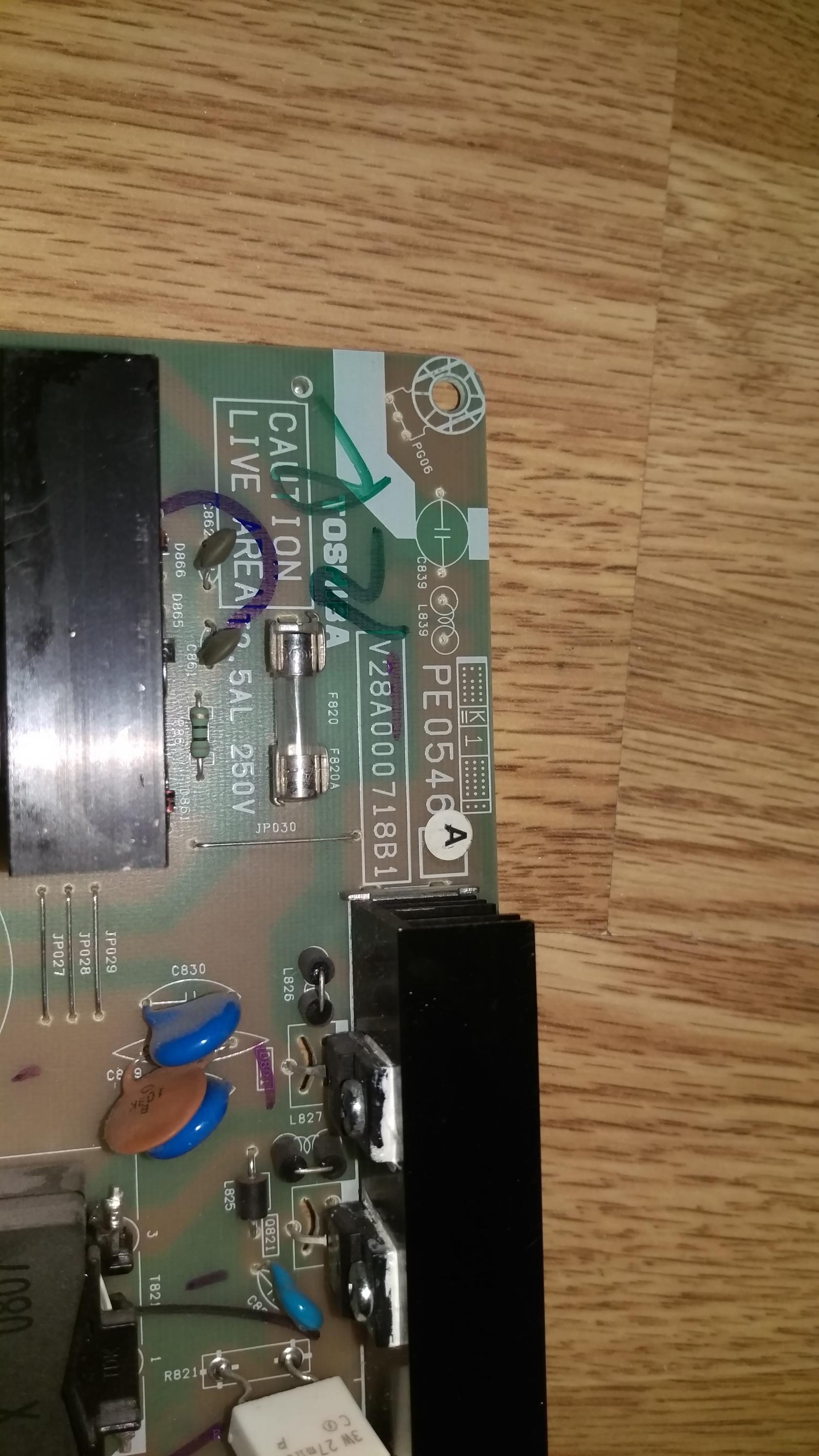

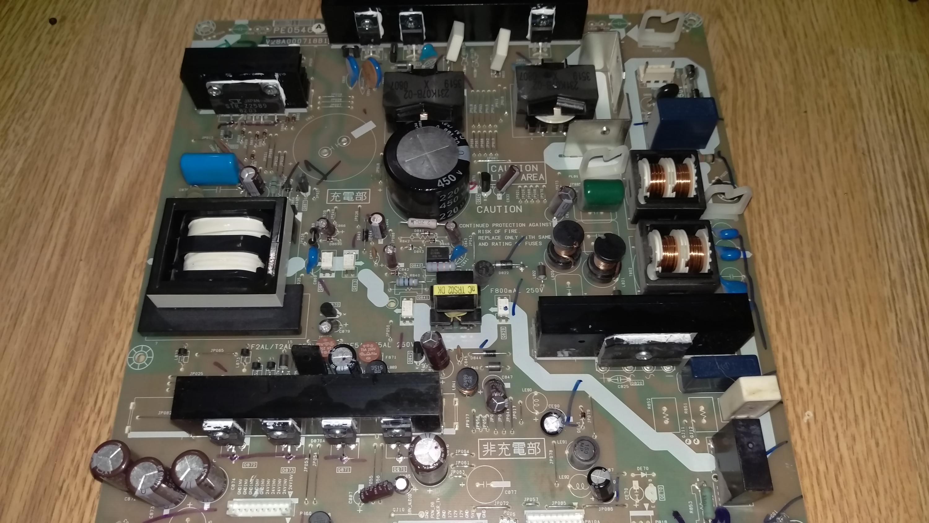

          1) We have not seen the pictures of YOUR board yet. Your Power supply board P/N????

                      Whoa, I didn't plug anything in, no one told me to. Sorry for making you worry not my intention. I've been reading and double checking that manual and feeling like an idiot. I'm going to hang it up for now though, it's gonna be a long week at work.
                      I was actually reading the meter right, I incorrectly assumed that the reading would be close to the uf on the capacitor. I guess I misunderstood. It actually just kept going up infinitly like a good capacitor should.
                      Currently trying to upload pictures. My board is the PE0546A version.
                      I feel bad about worrying you never my intention, I am so grateful for everyone too. I will try to get back to this board later in the week. I bet it's that switch. NEVER plugging anything in while I have the top off unless I know I'm safe.

                          That's the one, I just uploaded pictures. See post 90 plz.

                              Now post pictures of your board so we can HELP YOU

                                I done did, they are on 90. It won't let me upload from my gallery , and I already buttoned her up for the night sorry.
                                Maybe I should have started out with pictures. I gurssI have been assuming too much lately. This TV used about 3-4 boards in its lifetime. I'm not gonna lie I am seriously thinking about replacing mine but I wanna try a and figure that relay out SR81 I believe. I feel like I've caused a few headaches believe me that was not what I set out to do here. I blame Tampatec he makes it look too easy.
