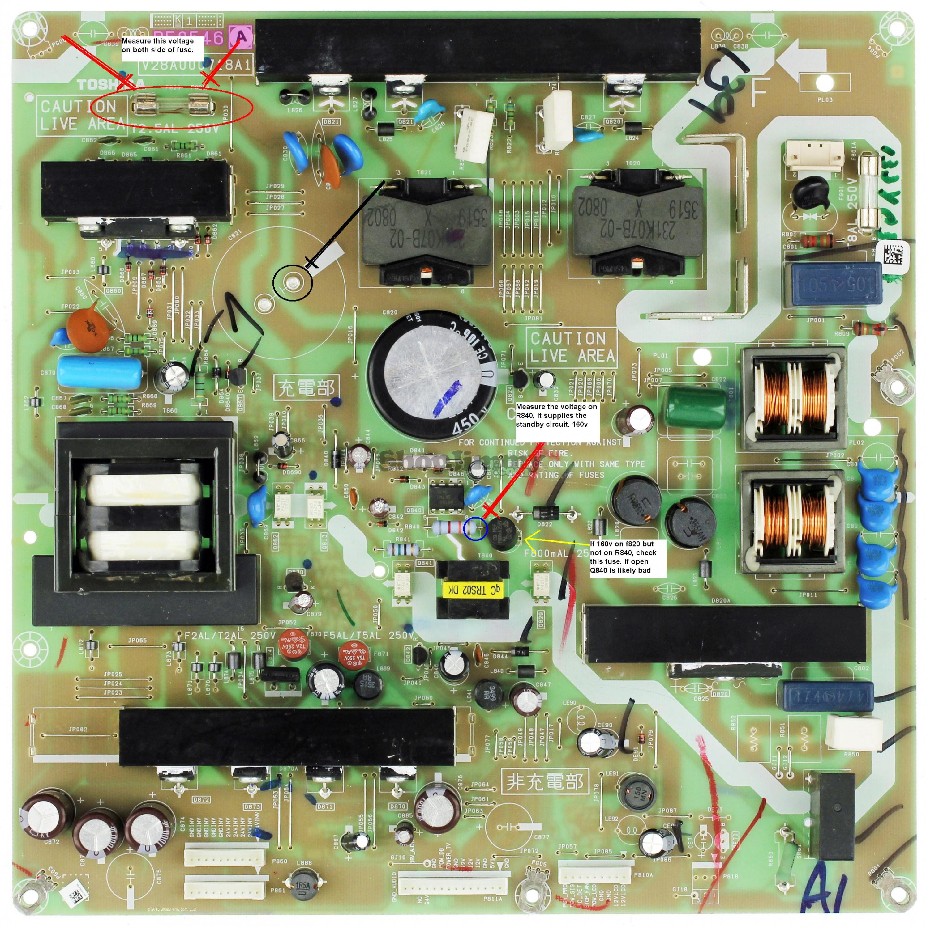

Toshiba 42rv530u wont power on

      We should have started with the basics, that's checking voltages at the powersupply connector/s, p860, p810A and P811A, check the second video below, has a demo.
      I did it like this guy showed me, and everything checked out OK. That was 3 days ago. https://youtu.be/ttrSsgkI5TE
      The switching relay is what I'm betting on is bad. There is no clicking noise when I turn it on. I want to try and check the other components like y'all said to do too. I feel like I can get a better understanding of what I'm doing if I follow your instructions.

        So you are saying all these Voltages below on all those connectors are OK as they should be?
        POW_DB
        POWER_TV
        POW_PRO
        POW_SIG
        AC_DET
        POW_LCD
        12V_LCD
        12V
        5V1
        18V_AUDIO
        24V
        Can you tell us what those Voltages are?

          Good evening, I am testing my Toshiba power supply board also. The TV will not turn on or give me a red light for standby volts. It reads 115 Volts on the power cord when plugged in. Both fuses are good and the bridge rectifier gives me 400-700 ohms when I test it. The only thing I think it could be at this point is the large cap in the middle, it is a nichicon 220uf at 450v. It is slightly bulged but hard to tell honestly because of its size.
          There are also two other caps that have what to appear to be either brown dots or marks made with a marker on them. One is at the C876 position and one is at the C878 position.
          Any help would be appreciated. I admit I am inexperienced, and I may have overlooked something. However, this situation has me scratching my head.

            You need to follow testing procedures in order, with meter on correct settings, do the test in buds post #103, he can guide you thru it, IMPORTANT in troubleshooting to test in order, that's how you eliminate things and narrow it down to whats wrong.

              The only way for the relay to turn on (CLICK) is if the +24 volt circuit is working. For the +24 volts to work it needs a min. of +160 volts on F820 fuse. This is so ____ easy to check, On the top of the board, look for the location where C821 would normaly be. place the black probe on the silver rivit near the white square, place the red probe on the fuse F820, check both side of the fuse, IS THERE 160 VOLTS THERE????
              This 160 volts is also REQUIERD for the standby 5.1 to work.
              If there is NO 160 volts on that cap C820/C821 either the main fuse F801 is bad or R850 is open

                Ok, I finally have time to work on the TV again. Would it be acceptable to use a power strip/surge protector to plug the TV into? The closest gfci is in my kitchen, I can use the one in my garage too though. Safety is a lot cheaper than a trip to the hospital... or worse.
                  This 160 volts is also REQUIERD for the standby 5.1 to work. If there is NO 160 volts on that cap C820/C821 either the main fuse F801 is bad or R850 is open
                  Checking continuity gives me 258v on both sides of the fuse when I put the black probe on c821 negative. When black probe is on positive I get 0v. Did I have it on the correct setting. Board is unplugged.

                    When I test black probe goes to ground, and red goes to each position? All the while on continuity?

                      Connect all the boards back up on the tv turn the tv on put the multi meter on dc volts put the black probe on a ground a mounting screw etc then use the red probe too test each voltage in turn let us know what the voltages are ie ps-on 5v
                      bl-on 5v etc etc

                        After plugging everything back in, screwing in a ground screw in, setting my meter to 20v I got the following results.
                        POW_DB = 0V
                        POWER_TV = 0V
                        POW_PRO = peaked at 1.7V and trickled down irregularly.
                        POW_SIG = 0V
                        AC_DET = 0V
                        POW_LCD =0V
                        12V_LCD = 0V
                        12V = 0V
                        5V1 = 2.56V and trickled down irregularly.
                        18V_AUDIO = 0V
                        24V = 0V
                        After checking R850 I have concluded that the OL and 1. Reading are equivalent? Correct me if I am wrong? I believe that means that R850 is indeed open.
                        (I am aware that the boards are not matching but I used the principles he described to check Everything that he checked.)
                          I do not understand why you keeping using the word continuity when checking the Voltage. Is the meter set to CONTINUITY mode or what?
                          258V is no way correct since there is no circuit that will generate 258V DC on the main filter cap. Are you sure the meter is good and being used correctly? Right now we are getting so many wrong DATA per your reported readings which is not helping at all, this thread is getting way to long for me and we are not getting any where with it due to wrong data.
                          Buy a new board and try it out if it fixes the problem or not.
