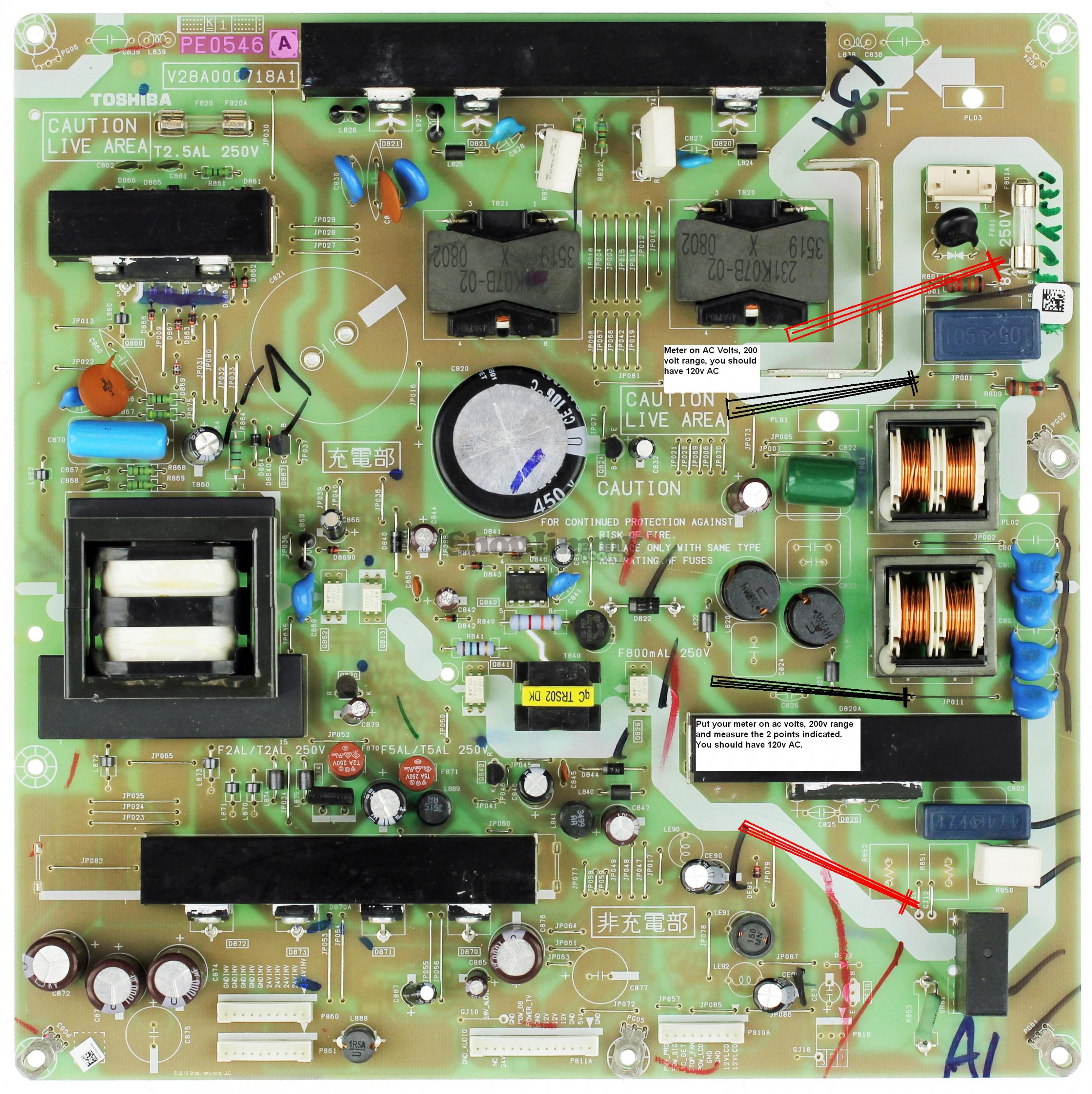

      Here are 2 points to measure with the tv pluged in. don't wory about the power button.
      Put your meter to read AC volts, (NOT DC VOLTS) and on the 200 volt ac range.
      Step1
      Measure the ac voltage between JP001 (jumper wire) and F801 fuse. you should measure around 120 volts AC
      Step2
      measure the AC volts between JP011 (jumper wire) and GJ12 (jumper wire)
      You should also measure 120 volts AC
      IF you measure 120 volts in Step1 but NOT in step2
      You know what is bad?

        Is JP011 supposed to be JP001? In your picture it looks that way sorry if I am mistaken. JP001 to F801 = 121 V. JP001 to GJ12 = 20V.
        Does that mean that there is something wrong at GJ12?

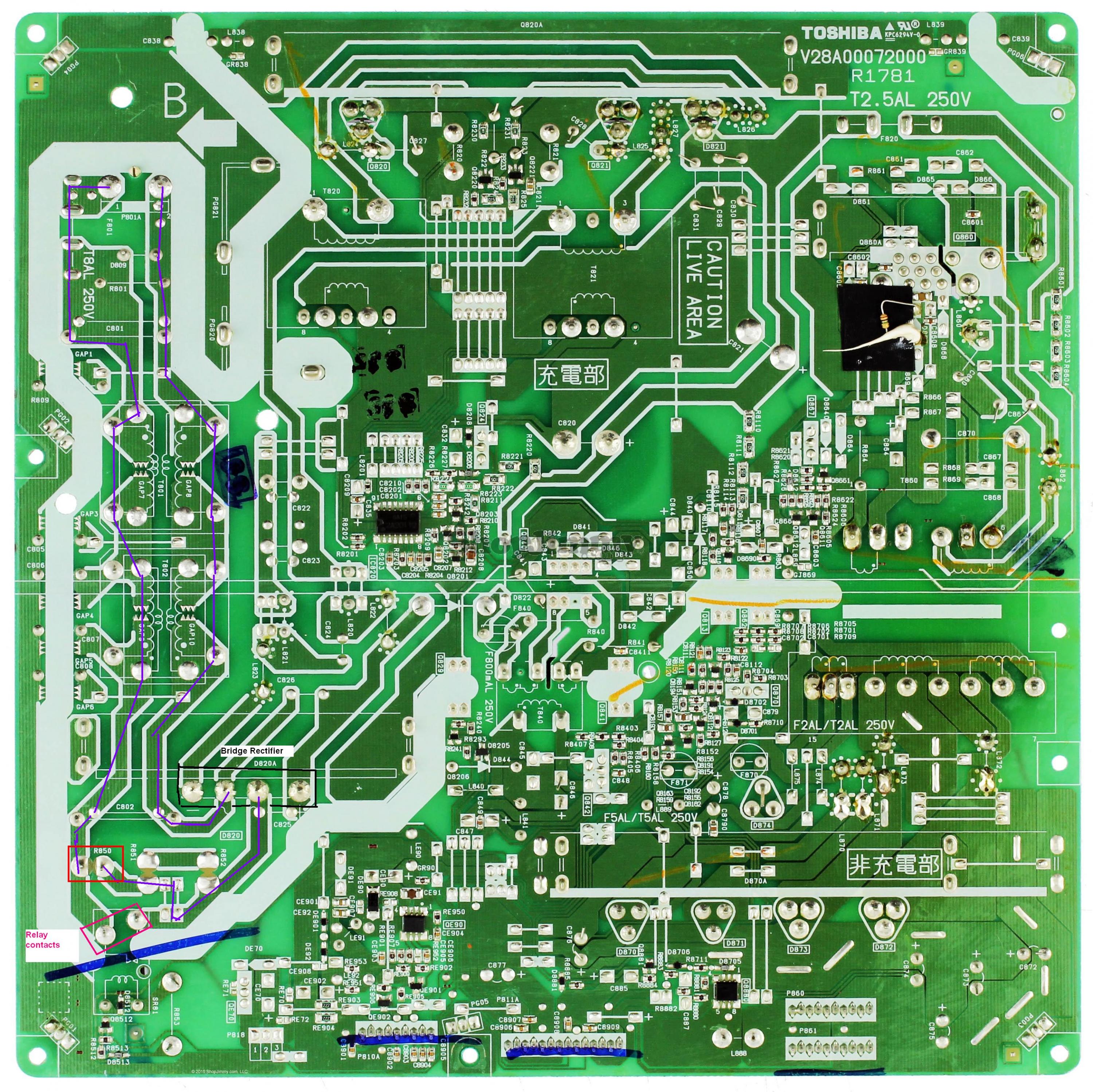

          Re: Toshiba 42rv530u wont power on
          I gave you a picture!!! the first place to measure is JP001 and the F801 fuse
          NEXT measure between JP011 and GJ12
          So you measure JP001 to F801 = 121 volts. That is GOOD
          when you measure between JP001 OR JP011 (they are on the same line) and GJ12 you get 20v (way too low) and what is that square white thing near GJ12... could it be... R850???
          In this picture I marked the path the AC takes from the cord to the bridge rectifier.
          Note where R850 is in that path and note where the relay contacts are also.
                  There are 4 connections to unsolder the SR81 relay. two for the contacts and two for the coil. There are no tabs holding it in, it is soldered in.
                  What are the numbers on the relay?
                  It should be a 12 volt relay, here are digikey pt# others have used.
                  SR81, 255-3350-ND Relay 12v 5amp
                  R850, TWW5J2R0E-ND 2ohm 5w resistor
                  The original resistor is 1.8Ω 5watt but is hard to find (unless ordered from ebay/China) so a 2Ω 5 watt is used which is perfectly fine.
