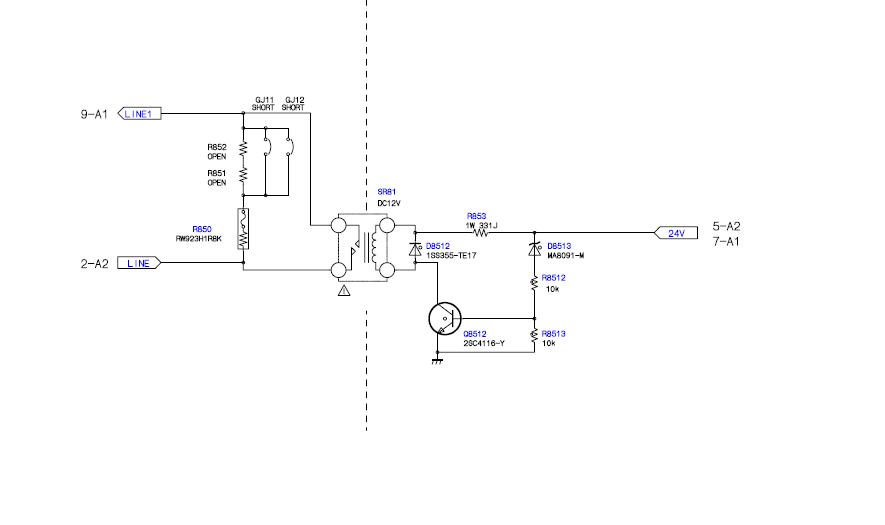

    Ok, so if I am understanding everything correctly. SR81 seems to be the main suspect here. I will check all 4 pins next.
    Also, everytime I check R850 all I get is 0 ohms. I know I should get 1.8 though. I will more than likely unsolder it and check it to be sure. If that's wrong correct me, there may be a trick that I haven't learned yet, or just poor technique on my part.

      Originally posted by R_J
      It is not going to be the lagre cap, many times they look bulged but it is just the plastic top that is bulged a bit, if you can press it flat the cap is very likely ok.
      If R850 is open it is caused by bad contacts on relay SR81 in standby low current flows through the resistor, when the tv is turned on the relay shorts the resistor so the higher current bypasses the resistor, If the relay contacts are bad, as in open, ALL the current flows through the resistor, it heats up and opens its internal fuse.
      This is a very common problem
      Ok, looks like he needs to replace SR81.
          You don't need to unsolder R850, if it is good it would read close to a short (1.8Ω) , the relay should be replaced or taken apart and at least clean the contacts (this cant be checked with your ohm meter)
          SR81 has 4 pins, two are for the coil and 2 are the contacts, the 230Ω is likely the coil resistance.

                      To check the resistor you put your meter in ohms, in the lowest range and place the probes across R850. It should produce the same reading as if you connected the probes together. The reading should be near 0 (actually 1.8Ω)
                      If the resistor R850 is open it is because the relay contacts are bad. The contacts are burnt. The problem is not with the relay's coil
                      Because the resistor is open you will not have any standby voltage.

                          0 Ohm = Resistor has NOT gone open circuit.

                                      So now the resistor R850 is NOT open? If it measure 0Ω then your fault is somwhere else
                                      with power OFF, check the rsistance of the fuses F820 & F840.
                                      If you feel comfortable working on this with power applied...
                                      Measure the DC voltage accross C820 (220uf/450v) If there IS voltage is it 160v or closer to 400v?
                                      Keeping your negative probe on the (-) of C820, check the voltage on both sides of the fuses, F820 & F840. IS there voltage on both sides of these fuses
