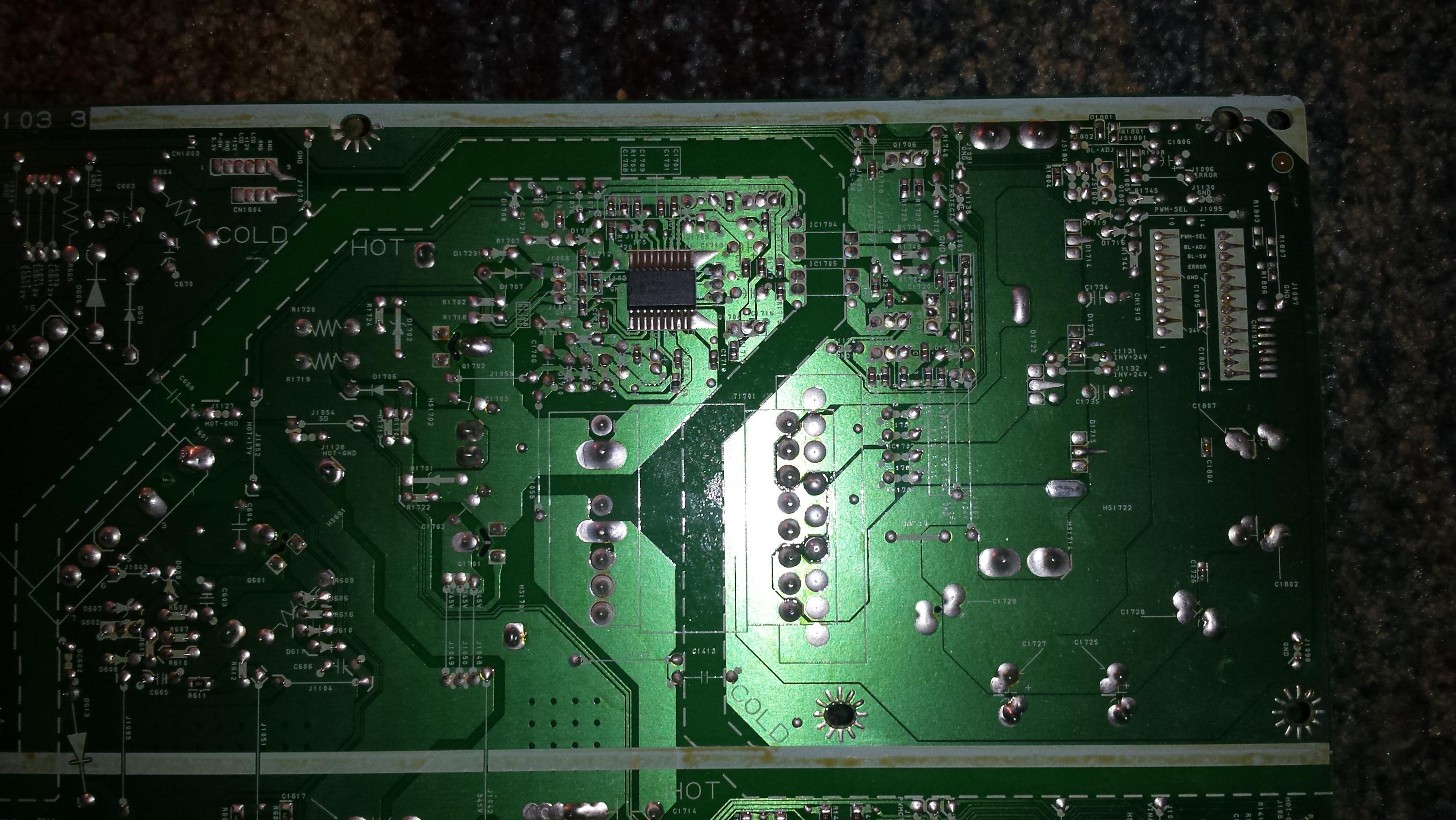

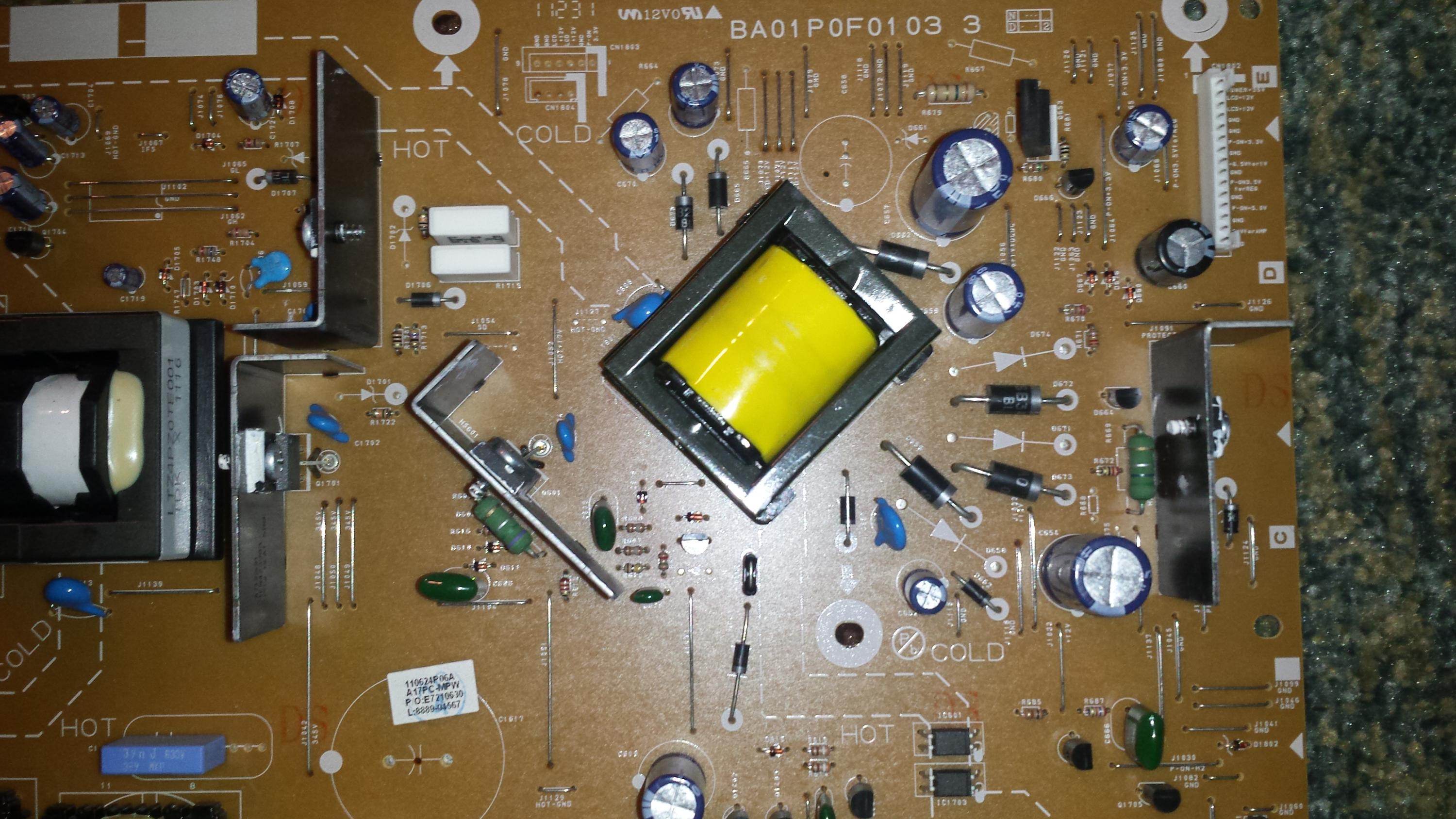

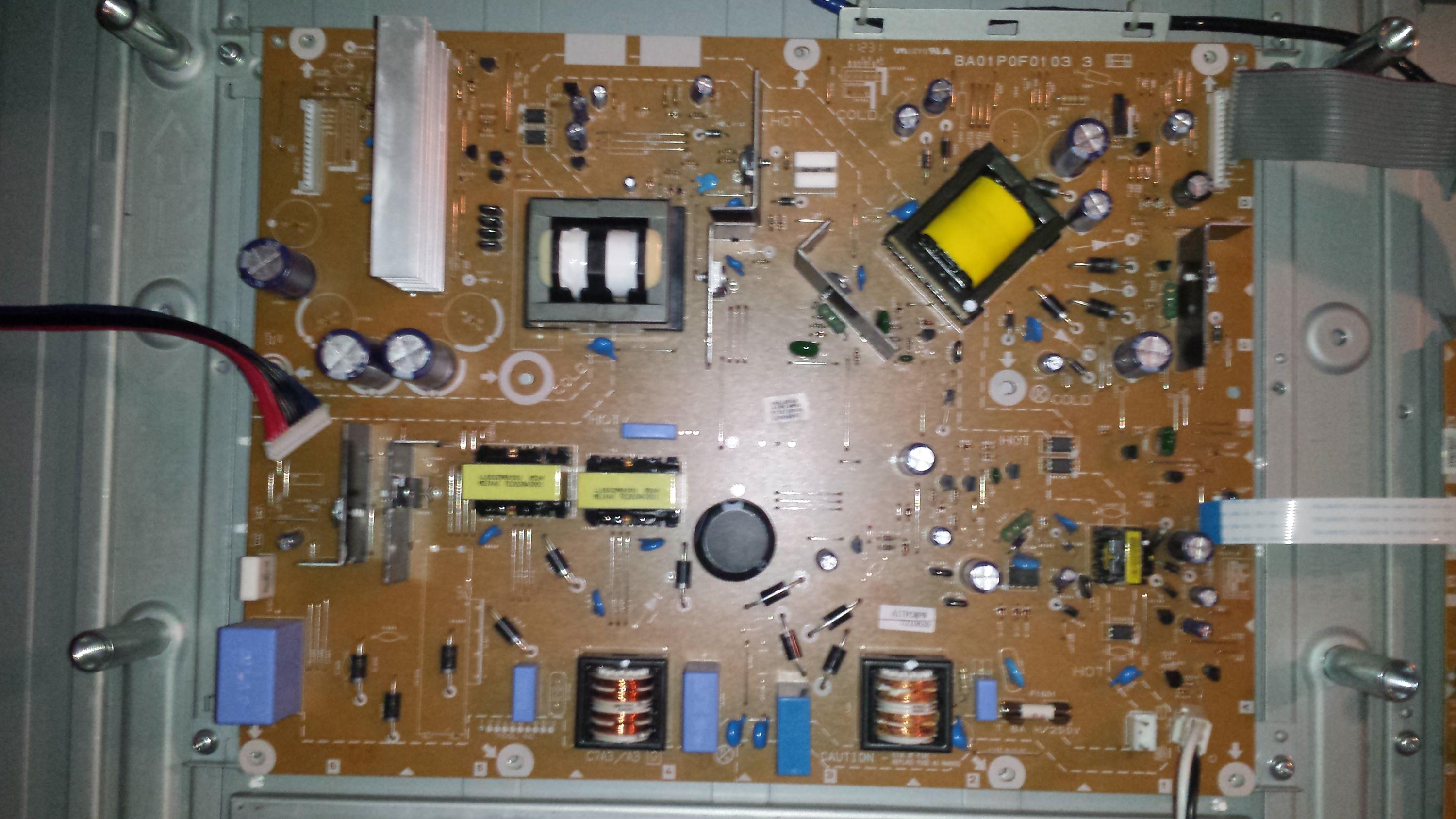

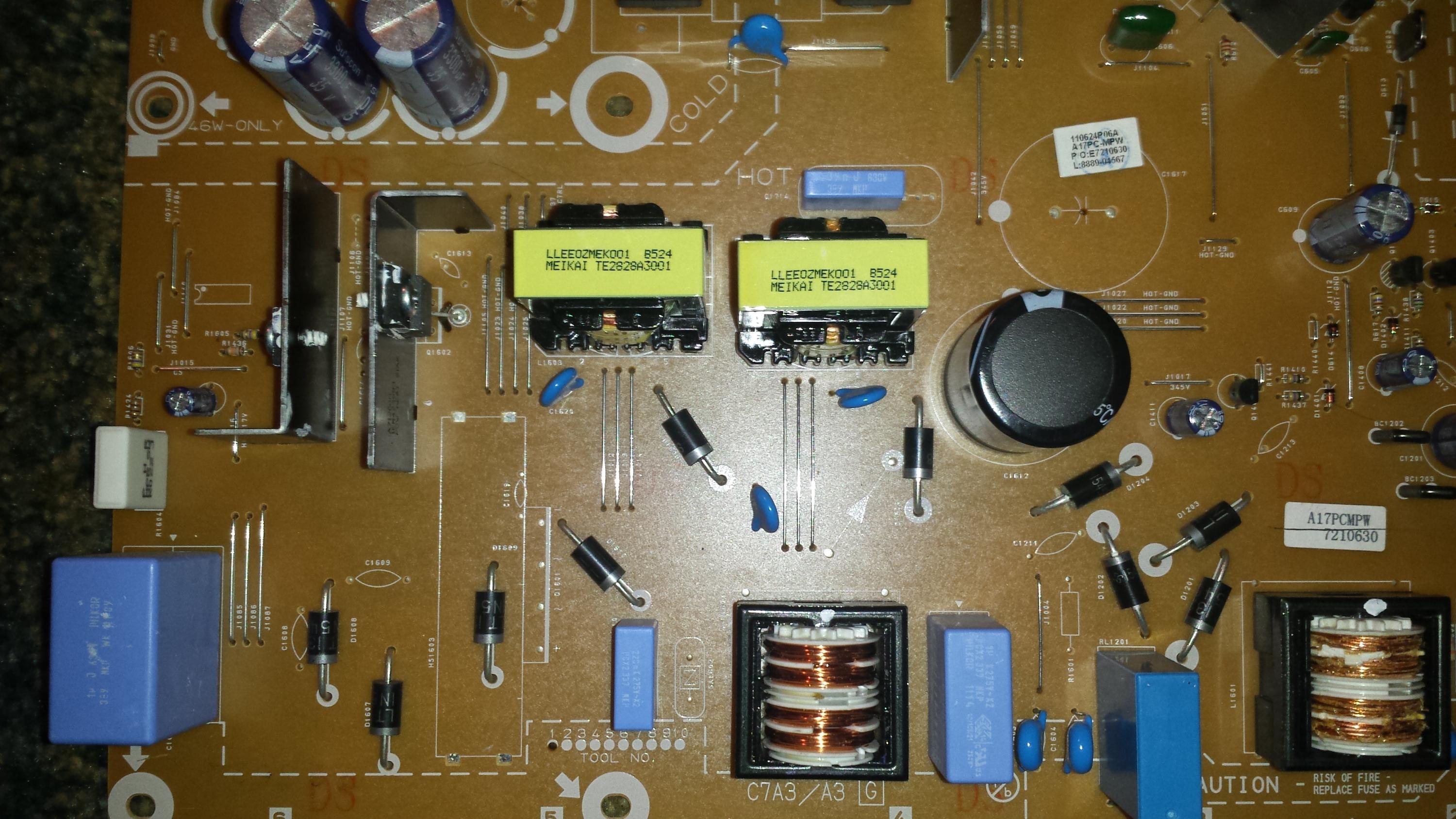

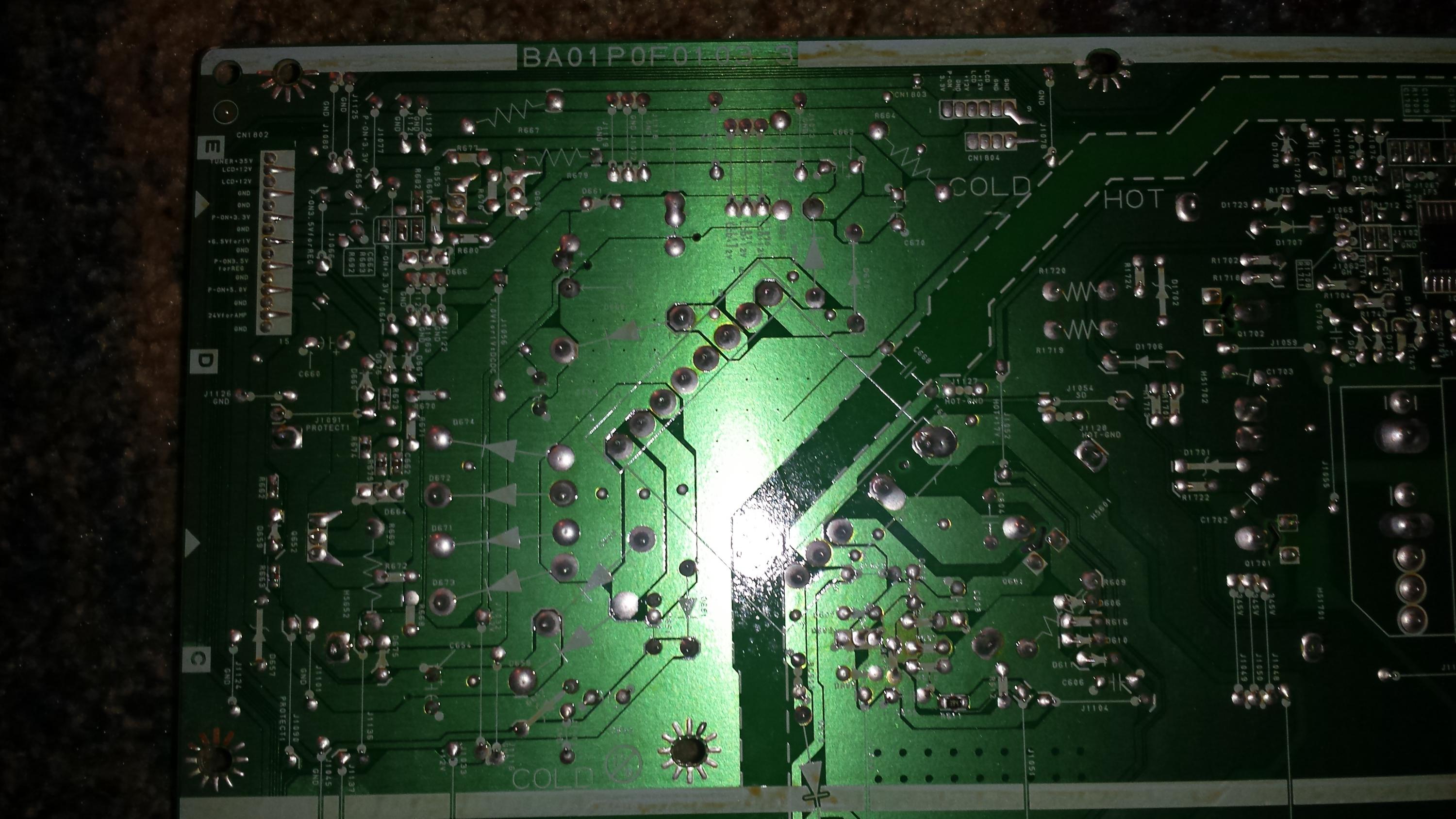

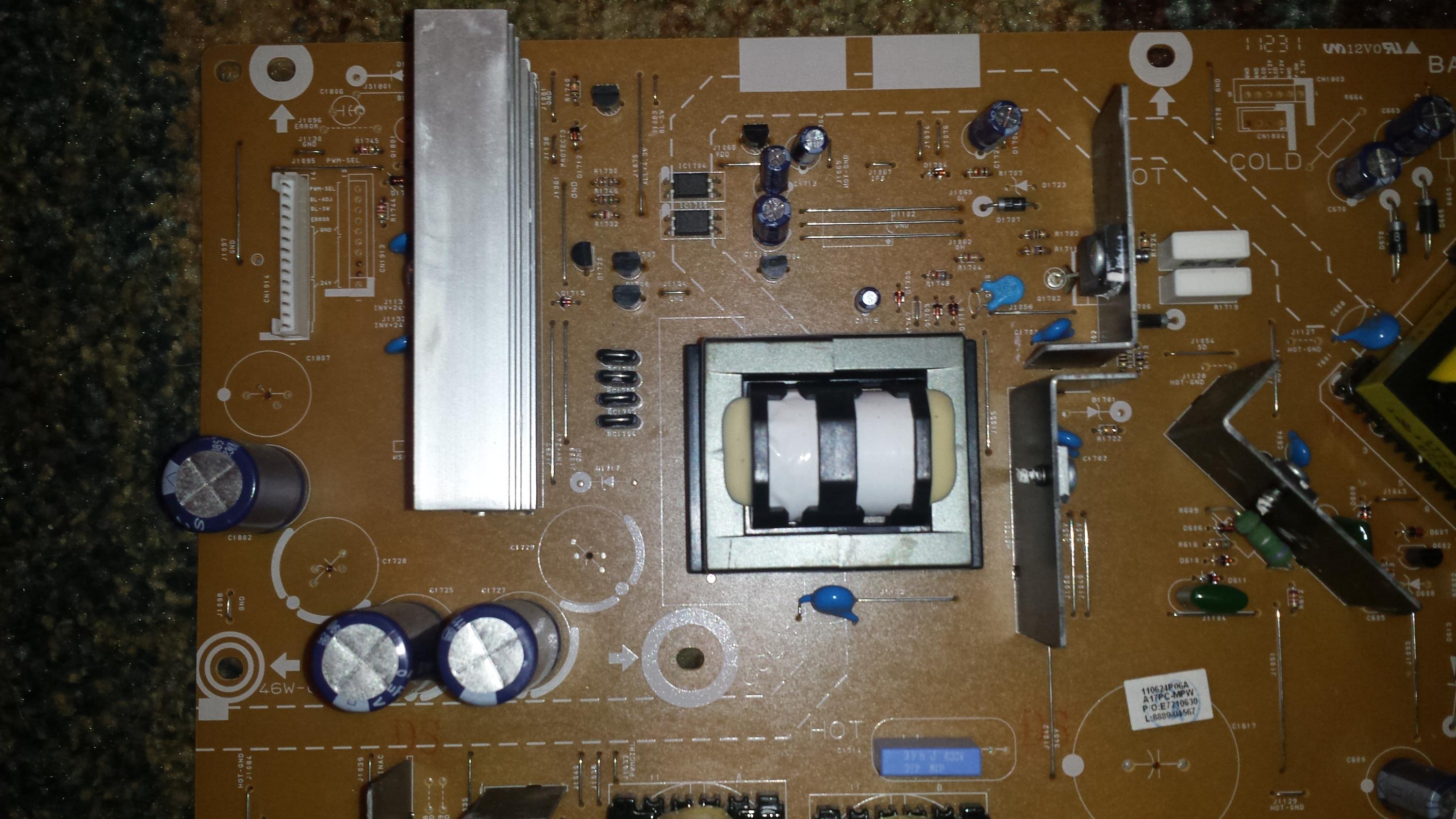

    So i found this tv on the side of the road, and have repaired everything i have identified to be nonfunctional. I'm looking for suggestions on what to try next, i have attached a video below which explains everything in more detail. If you have any suggestions or help whatsoever please post it, I have checked this forum and various other sites but still need some assistance.
    https://www.youtube.com/watch?v=PyiBtmWuzQk
    Re: Emerson LC401EM2F no standby light or power

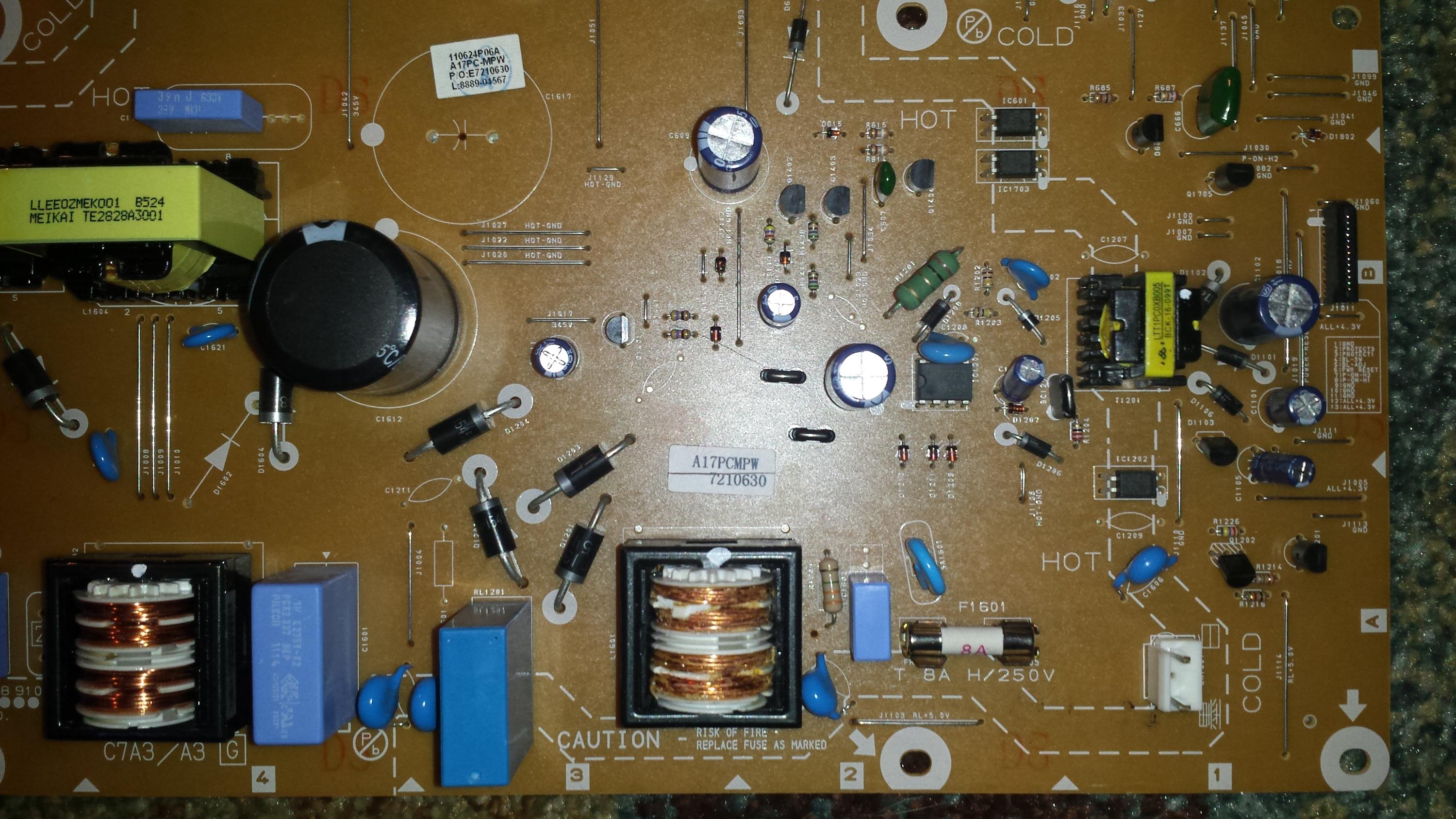

    Please upload good clear straight shot pictures of the that power supply board top and bottom side, and the pictures of the whole backside of the TV so we can see all the boards, that will be a start.
    BTW, are these the exact match of your boards? It also has repair kit for the power supply board.
    http://www.shopjimmy.com/catalogsear...rson+LC401EM2F

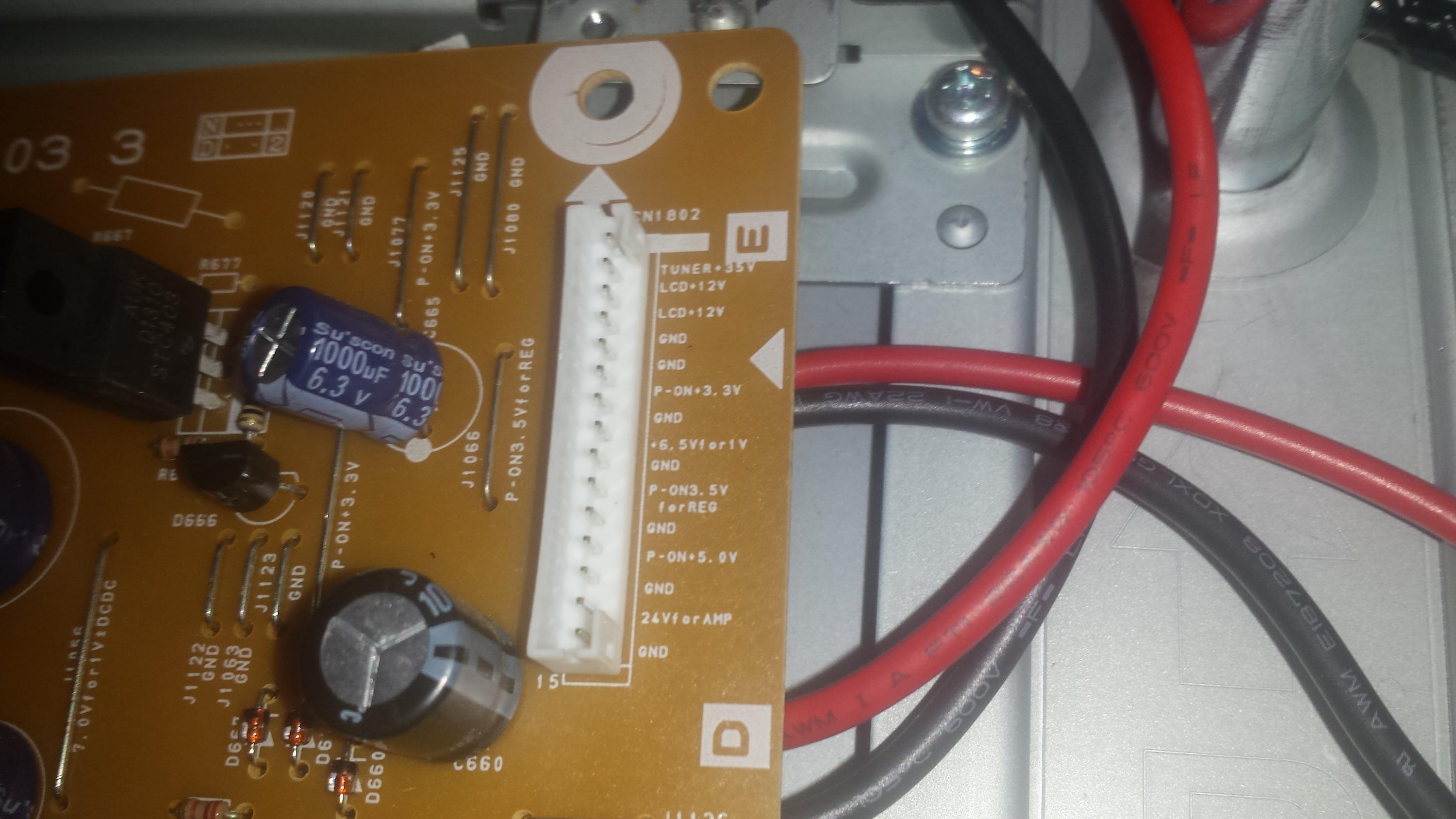

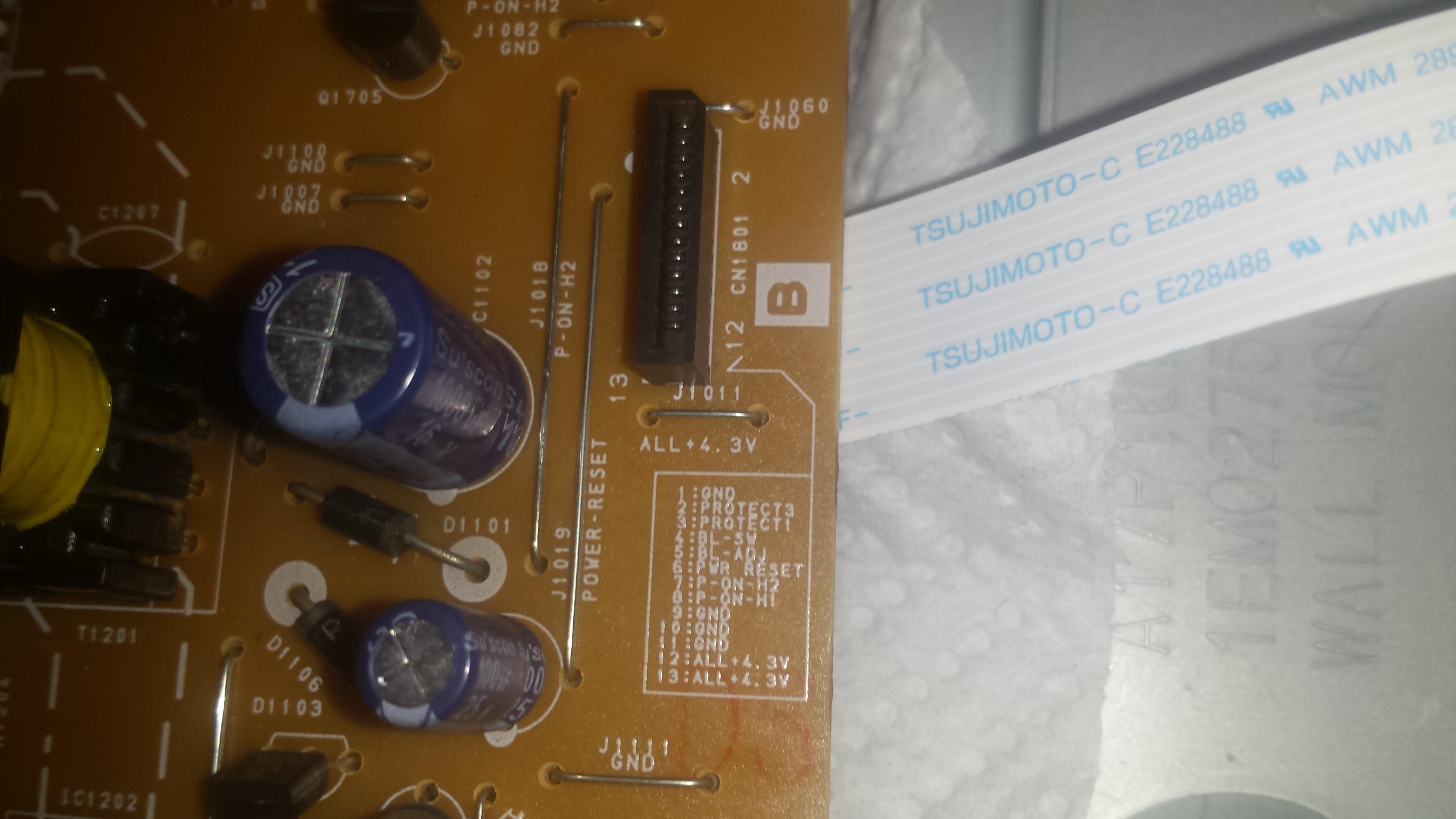

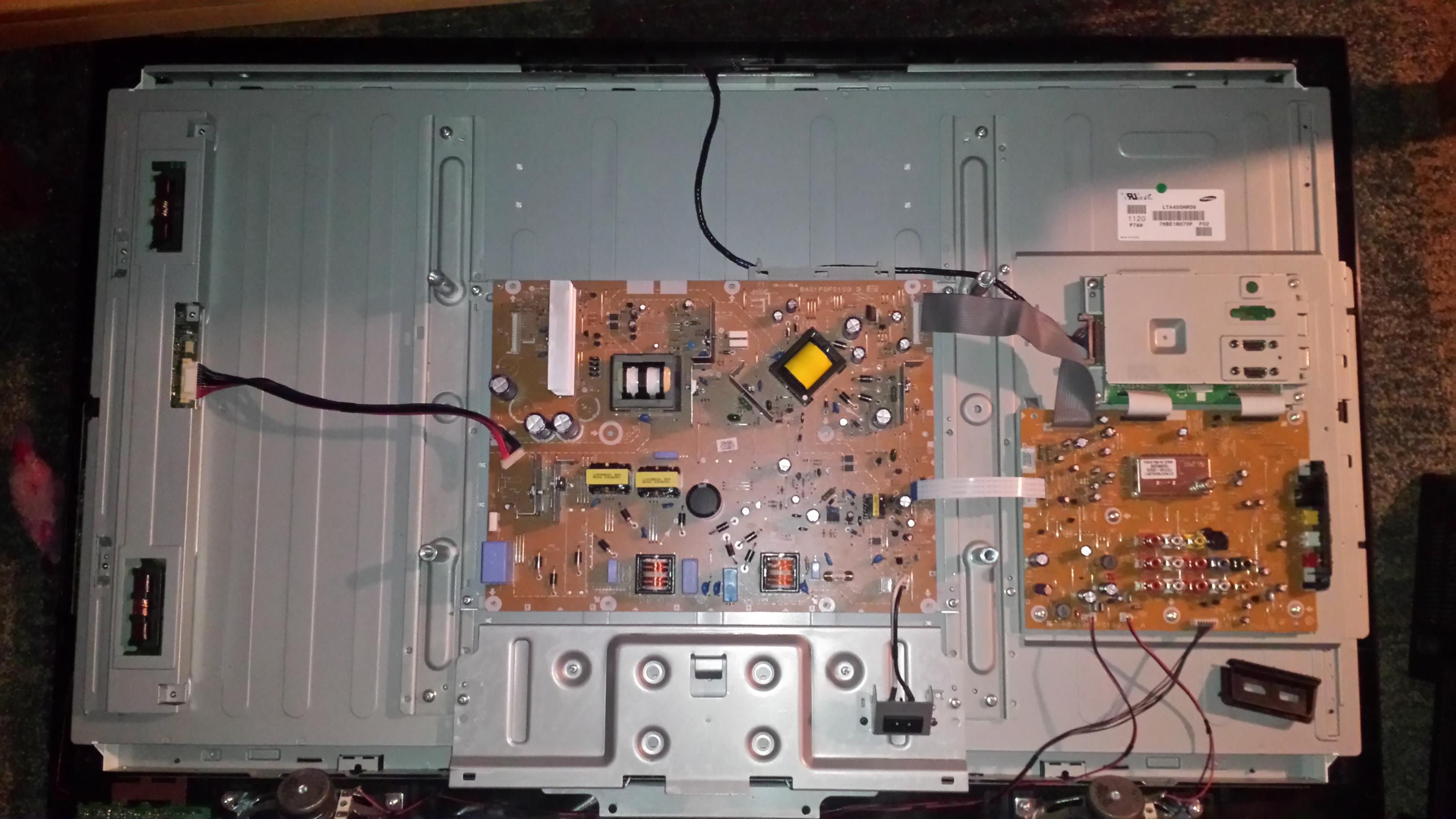

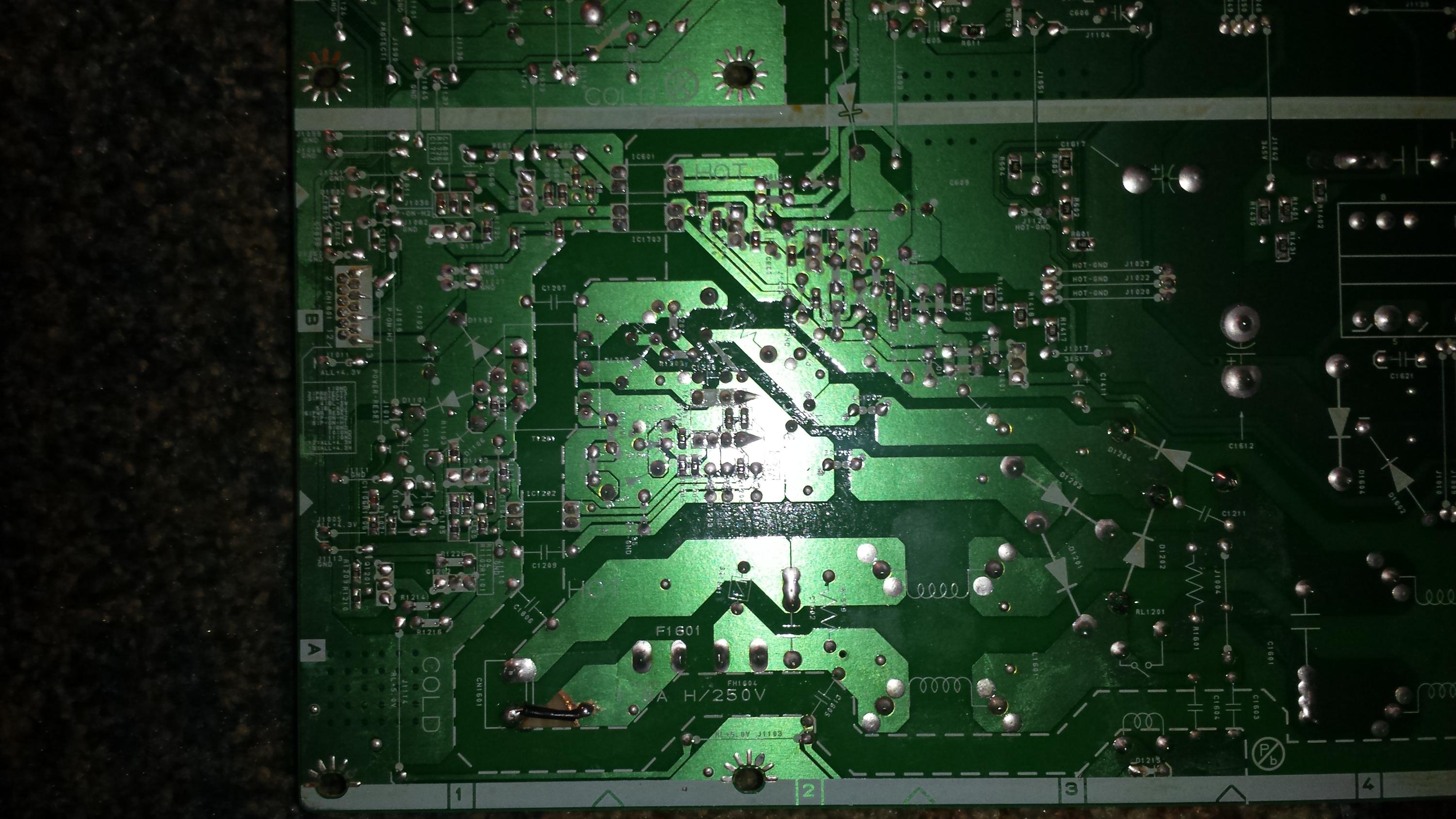

      Thanks for the reply. Yes, the link you provided is the same as my board. Also here are some pictures, if you need a closer shot of anything in particular let me know.
      http://imgur.com/a/itSgD

        We're those shots clear enough?
          I did not have a chance to download the pictures and study them yet.
            Unplug everything from the power supply. Plug it into the outlet and measure the voltage on the main filter capacitor in the primary. Use both of your leads on that capacitor while measuring. Then there are 2 sets of ribbon cables going from the power supply to the main board. With the power supply plugged in measure all the DC voltages on those pins and post them with the pin out name.
                    Can you read the voltage using your meter probes connected to each pin. Red to "+ " and Black to "-" across capacitor C1612.
                    You also need to check all the diodes using your meter set to diode mode.
                    Also check the white ceramic fuse, number I cannot read.
                    If there is an ON/OFF switch on the set then check that too.

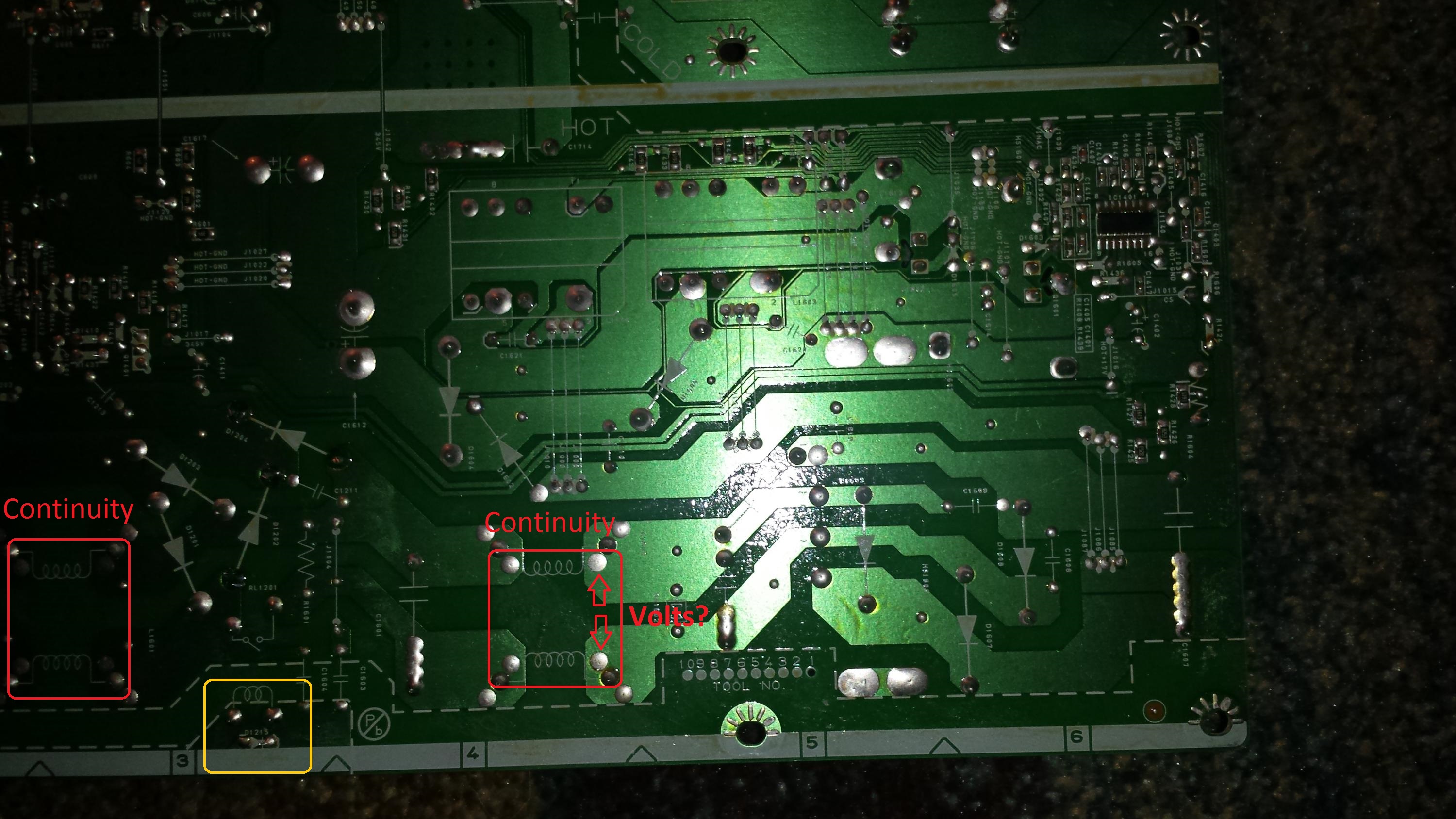

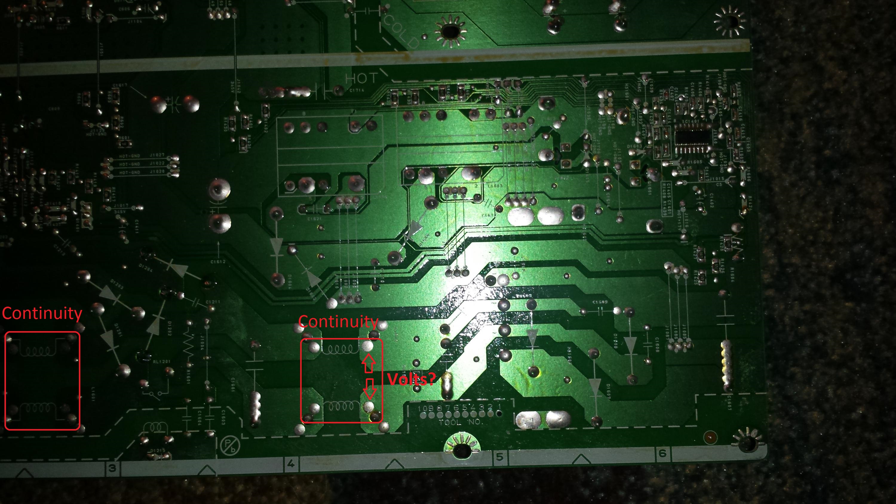

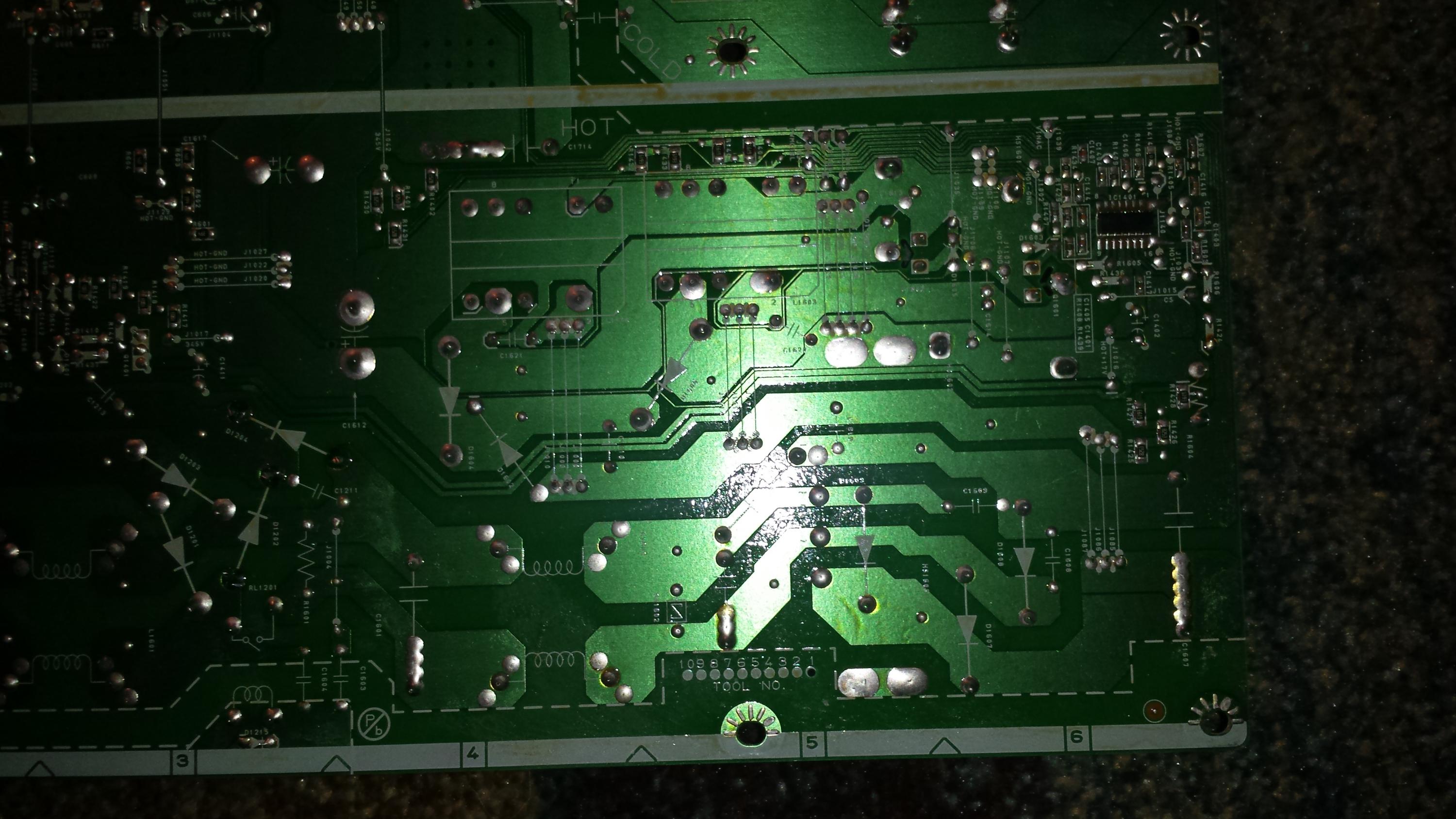

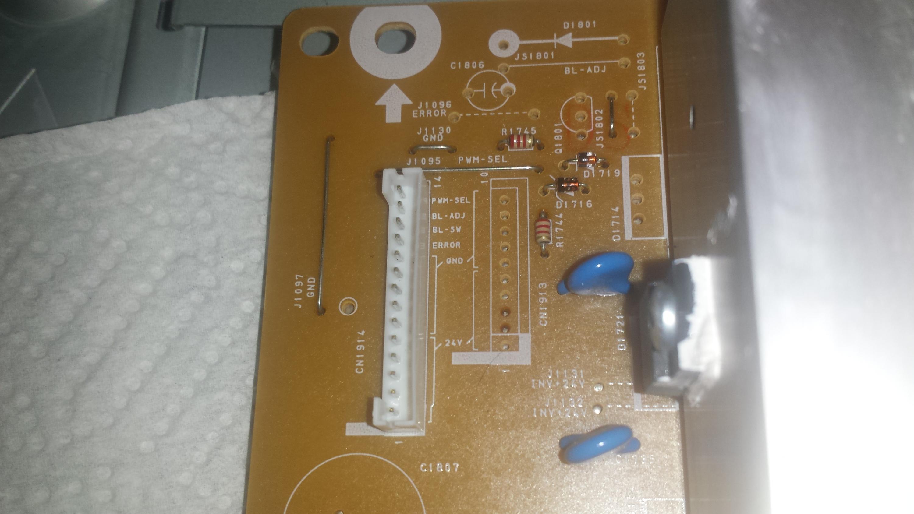

                          Here are the pictures
                            Can you check the continuity of the two transformers highlighted within the red boxes using your ohm meter and then measure what ac voltage you have across the points indicated by the arrows.
                                All points circled have continuity, the 2 points tested for voltage read 119.0~ volts
                                  Well that's something positive. Sothe PSU does has mains input voltage. So now to find the capacitor holding the rectified ac. Will look at your photo's to find it.
                                    In the yellow box shown, can you lift one end of the diode and test it and then measure the coil resistance of the relay.
                                        Ignore that test for now.
                                        You said you had 119V ac from the earlier measurement. There are 4 diodes that rectify the AC and apply it as DC to the capacitor C1612.
                                        Measure once again across C1612, one probe on either pin with meter set to => 600V DC.
