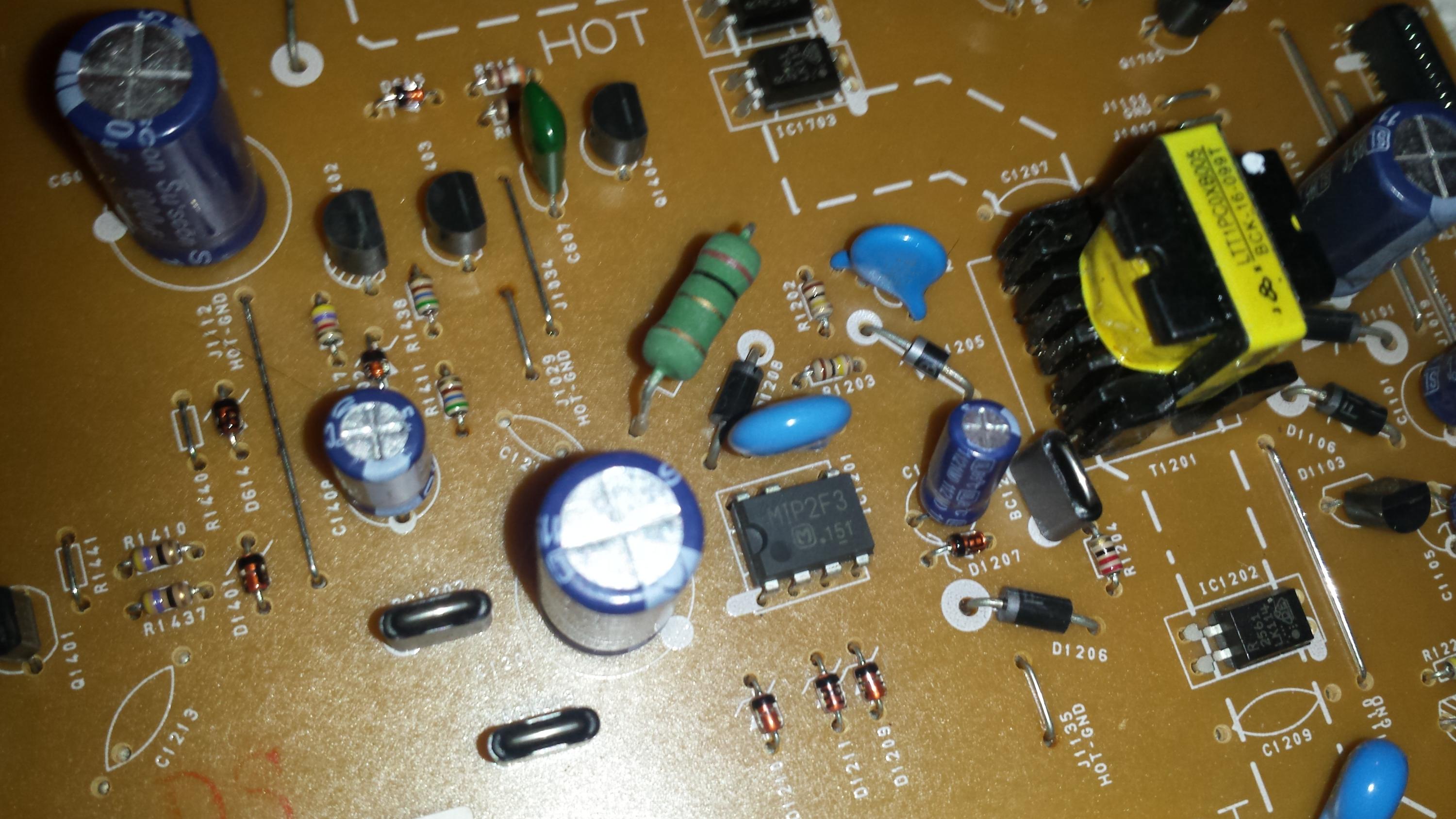

    Originally posted by Beef_Ramen
    Ok I'm understanding it more now.
    I thought I would mention this before I continue, when checking the dc voltage on the main filter capacitor, it's only reading out 1.90~V with both probes on each lead. That's already a problem right?
    Not convinced on that yet. I think you measured that big capacitor in AC mode. Before the bridge rectifier is AC, after that everything is measured in DC. That big cap should have roughly 170V DC on it.

      I also find it odd that there is mains being applied to the rectifiers but no DC on the cap.

        You said you had 119V ac from the earlier measurement. There are 4 diodes that rectify the AC and apply it as DC to the capacitor C1612.
        Measure once again across C1612, one probe on either pin with meter set to => 600V DC.
        I have an innova 3320, it auto ranges since there's no fine tuning options. But yeah ill probe one lead from the capacitor and probe the diodes and see what I get

              If you trace out the board layout you will see that you have two sets of the bridge rectifier circuits, you will see that you are not going to have any DC on the main filter cap C1612 until the power supply board gets the PS-ON signal from the main board to turn on the power relay RL1201 which will then supplies 120VAC to the bridge rectifier diodes D1607, 1608, 1609, 1610.
              D1201, 1202, 1203, 1204 are for the standby power supply feeding filter cap C1201 to run STBY SMPS IC 1201.
              It is the Standby power supply section that you need to get it running first.

                Nice on Budm. I couldn't trace the circuit with the photo's provided.

                  Yes, the pictures have lots of glares so it was not easy to trace.
                  PCBA P/N per sticker is A17PC-MPW.
                  PCB P/M BA01P0F0103-3

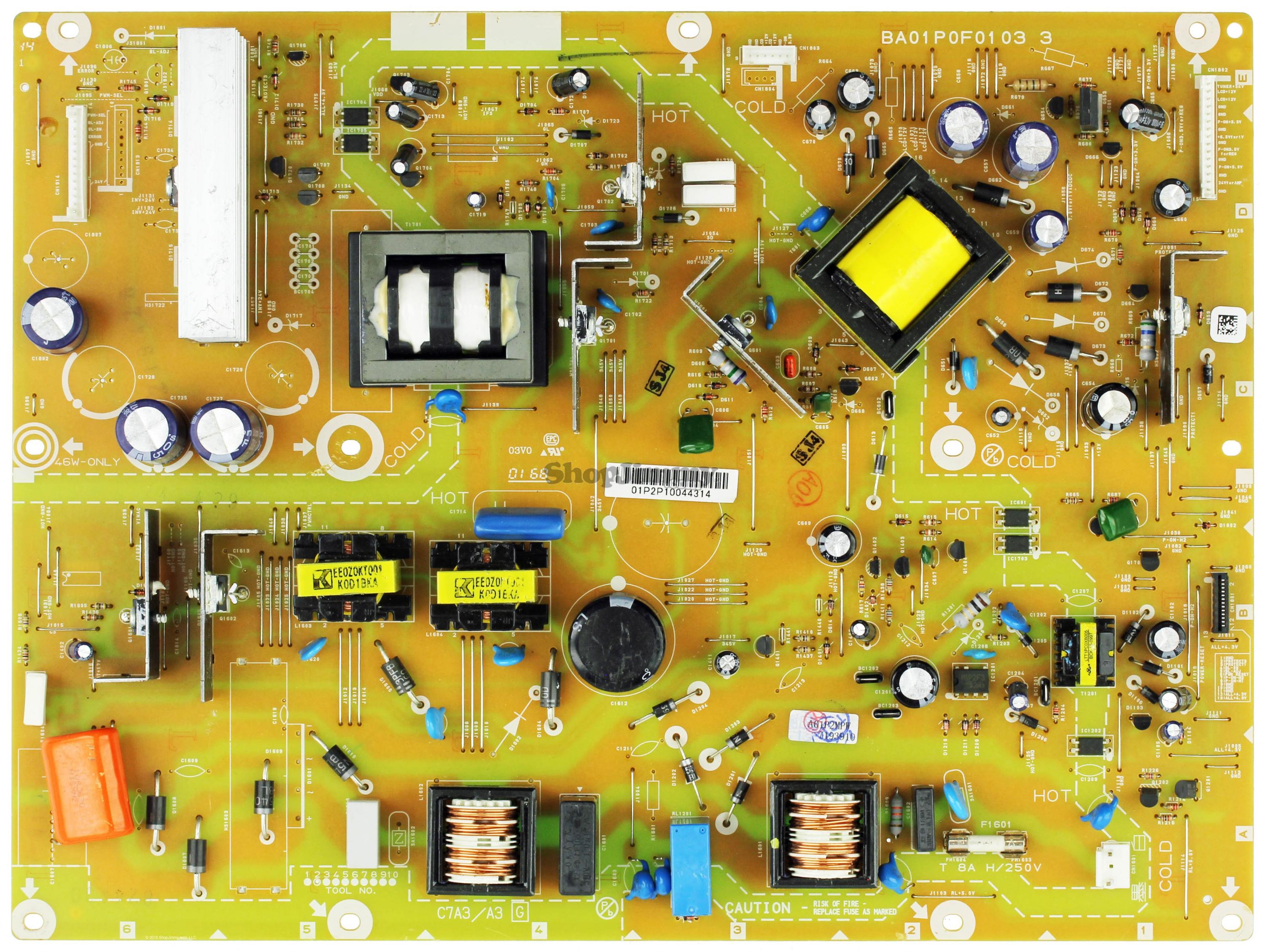

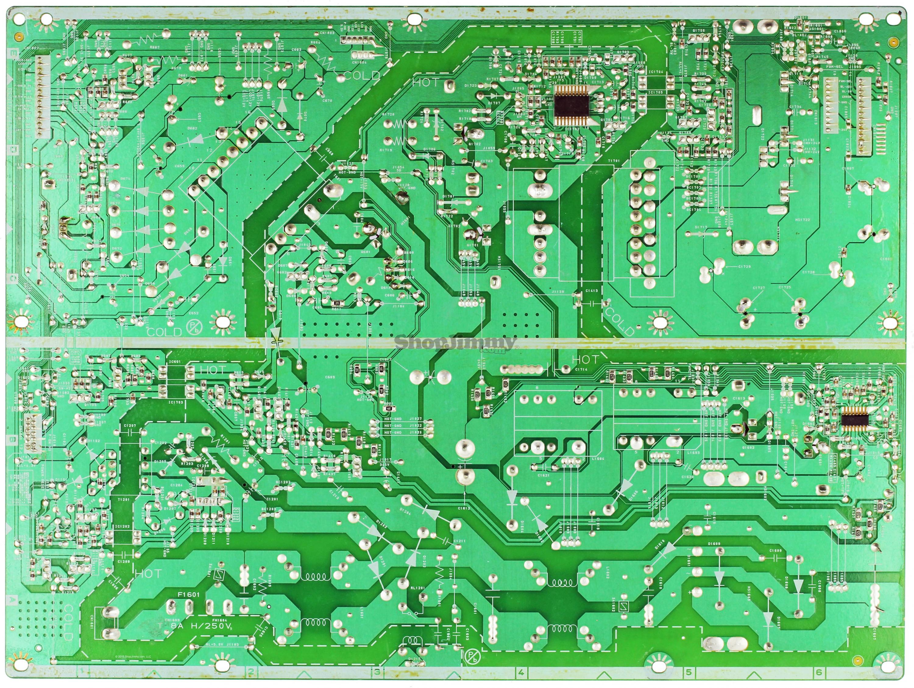

                                OK, you need to check the fusible resistor R1201 fusible resistor which feeds the main DCV to the SMPS IC1201 (we need P/N of this IC as well) to see if the resistor is OK, looks to be 1 Ohm resistor.
                                The pcitures attached is the closest one I can find at SJ, there are many PCBA using this PCB BA01P0F0103-3, your PCBA is A17PCMPW.
                                BA01P0F0103-3
                                Pictures provided by shopjimmy.

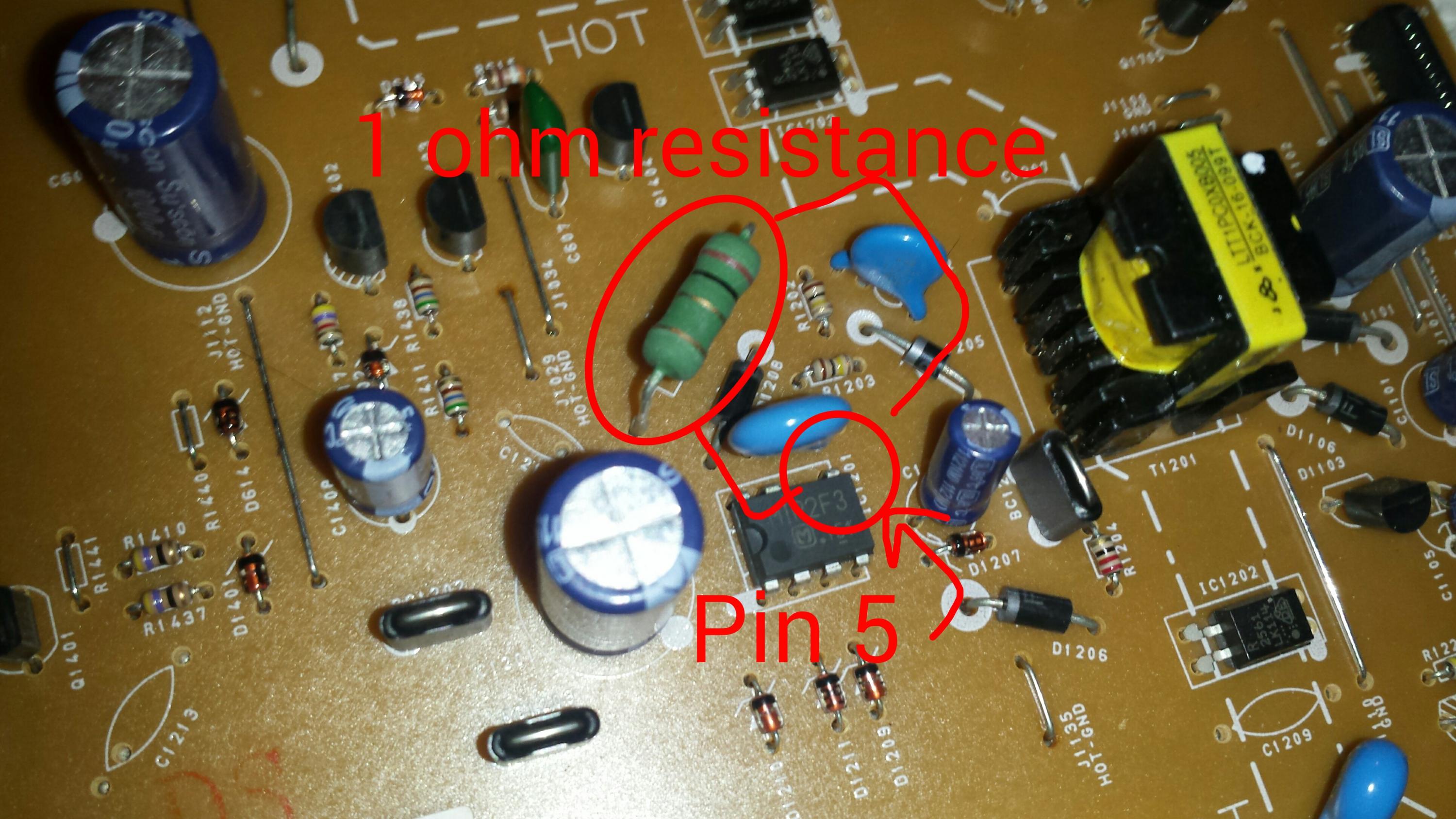

                                  Ok that resistor gives me 1 ohm resistance and has continuity with pin 5 of the IC chip

                                    whats the part number of the ic so we can look at a data sheet.
                                    • Beef_Ramen
                                      • May 2016
                                      • 22
                                      • US
                                      #38
                                      Re: Emerson LC401EM2F no standby light or power
                                      It's IC201, MIP2F3

                                        Check what voltage you get on pin 4 (VCC) of that IC.
