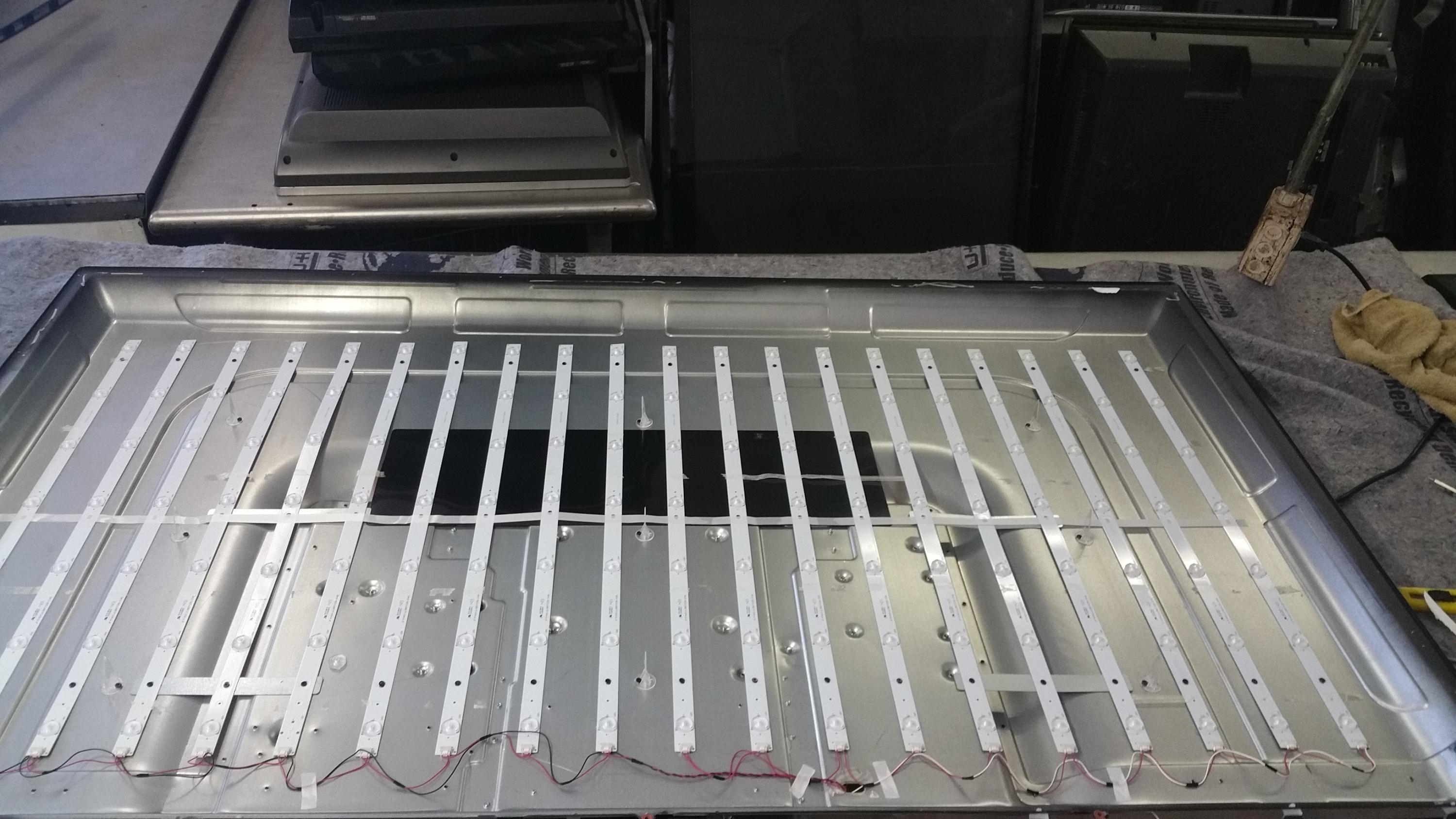

                                        I just got a 65" LED in that I am going to tackle this week.. I hate working on LEDs on such a big panel...
                                        • Michale32086
                                          • Nov 2011
                                          • 1453
                                          #120
                                          Re: Post The Led Backlights Your Fixing Here.
                                          I have to say... Replacing bad LED strips is THE most rewarding repair job I do...
                                          Practically anyone can replace a board. The skill for THAT comes in the diagnosis.....
                                          But to take a 65" or 70" monster, break it down to the bare LED strips, replace the bad ones, and reassemble it all without breaking the panel or ripping the tab bonds?? That requires some real skill and finesse..
                                          I always have a smile on my face when I power up a big LED TV and see it working perfectly..
                                          Of course, they can hear me yell all the way to Timbuktu when I crack a panel or rip a tab bond. hehe
                                          But yea.. Successfully replacing LED strips is, by far, the most rewarding..
