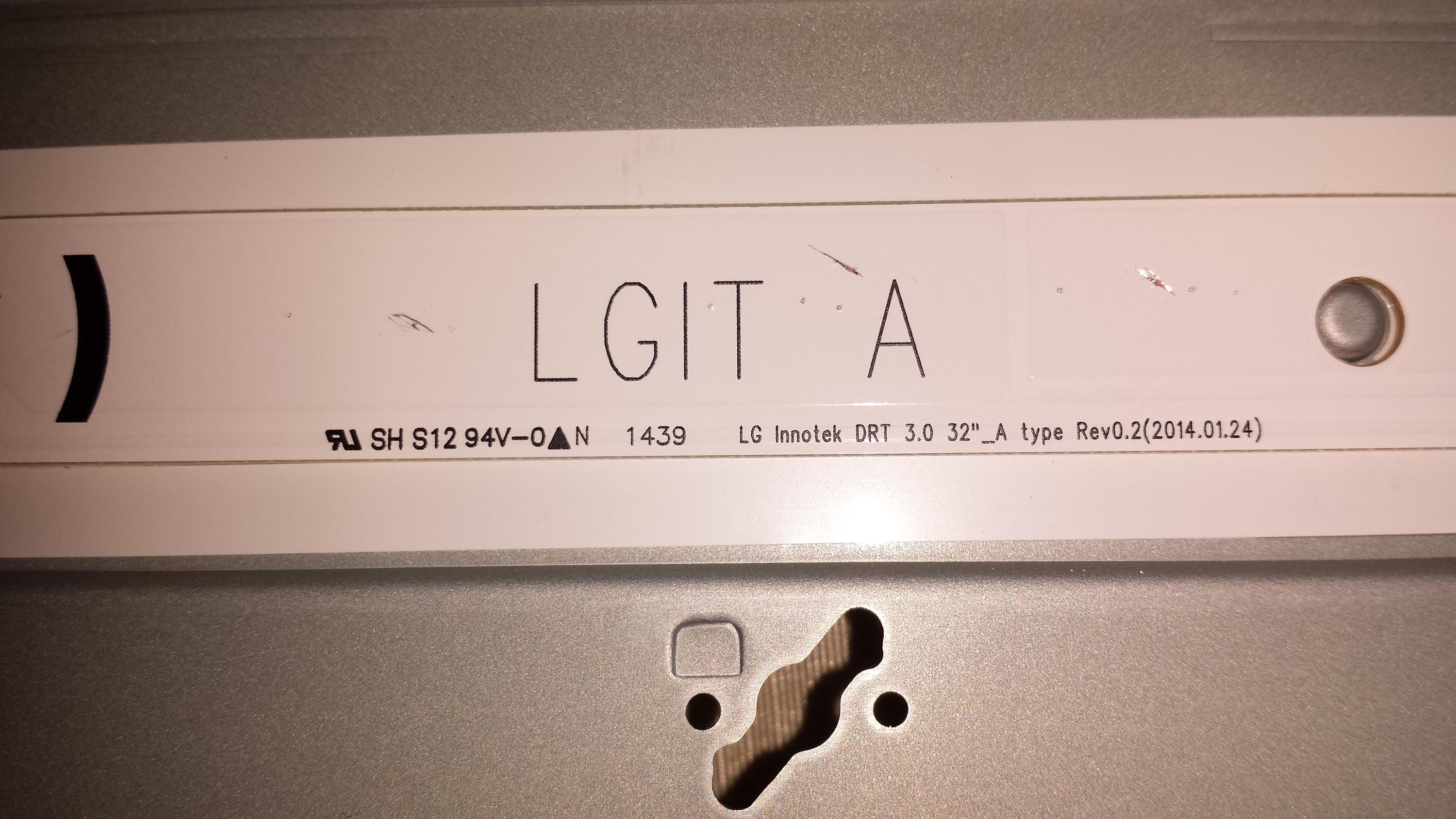

            well what a load of crap these LG led tvs are becoming LG 32LB550B no backlight
            screen type "Heesung HC320DXN-VHHR2-51XX" / SHARP
            they have massive lenses on them look like bi-focals lol i have had to pop each lens off out of the 18 leds only 2 work the 16 faulty ones are o/c s/c or read hi this is gonna be fun to do ??
            Does anyone know what leds they use and where to get replacments please thanks

                  If they are the large LG lens Type they will not light with meter in diode mode? they run at 5.5-6.00 v you meter will put out under 3.00v in diode mode. if you have a 9v battery testing in pairs will show a glow from each pair. ebay item 252492958756 lens type C, I have some new strips also for 32" Flocko
                        they are the large lens type and lit with my fluke meter well glowed lol

                              They may not be the right ones for your set, what part numbers are on your strips
                                #75
                                Re: Post The Led Backlights Your Fixing Here.
                                hi Flocko they have LGIT A LGIT B LGIT C on them
                                not even a year old i just found out lol

                                      what about something like this?
                                      https://ru.aliexpress.com/item/50pcs...08.4.29.cPZHb4
                                        #79
                                        Originally posted by vinceroger69 View Post
                                        thanks Vince i was looking at them but theyre 6v not 5v maybe last longer ?
                                          #80
                                          well flocko says
                                          so if this was my set i would probs take a chance.
