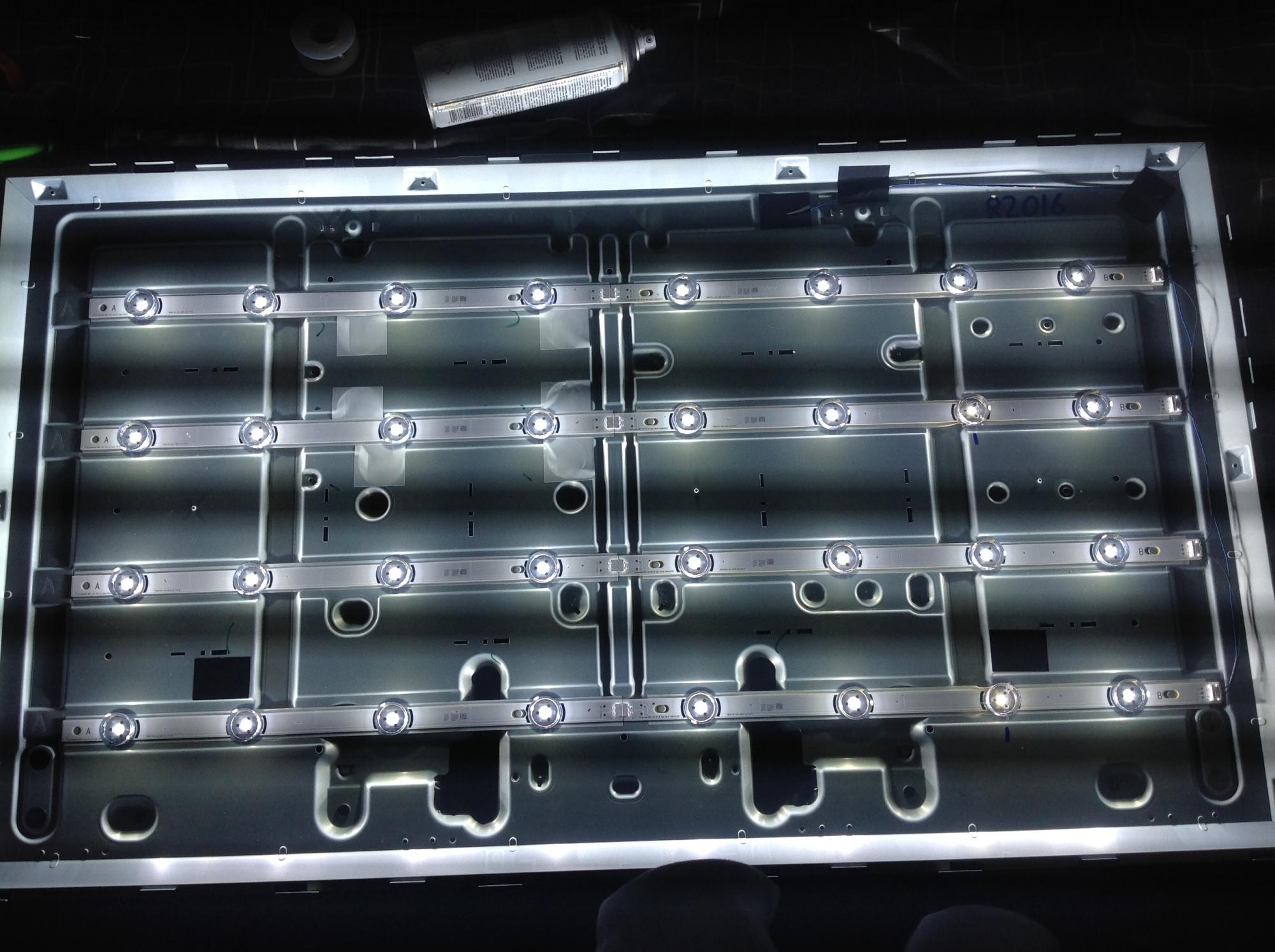

                  This week, LG 42LB5500 TV powering up, No backlight, image visible using torch, found one failed open led, replaced with one removed from smashed screen set, tv now working.
                  getting good now at removing and replacing these leds, i use air station
                  collecting two tvs today samsung and LG both led powering up with cracked screens, £10 each, why am I buying, easy to get the led strips from them

                    Too many for me to count lol, did a 47" Lg this week no bl, 1 open 3 shorted. Apart from that it's the only one this week for me with Leds.

                                  Thanks to the help of this forum and some videoes of Mrreeceyburger on youtube I succesfully replaced 4 smd diodes with a heatgun on a Panasonic TX-L42B6E tv (according to customer a little more than two years old).
                                  The backlight was made by LG with a total of 50 diodes on strips.
                                  The rectangular diodes I used I bought from Aliexpress.com:
                                  Product: EVERLIGHT LED 3030 lamp beads 1W LCD TV Backlight Lamp beads 3V cool white With Zener Pressure 30cps
                                  http://www.aliexpress.com/item/LED-3...8.0.104.S7FGQf
                                  The diodes had reversed anode/cathode comparing to the original diodes.
                                  The failed diodes was spread out and after replacement I could not see any lightspots or the like on the screen during my tests.
                                  I charged 1400SEK and left only 1 month of guarantee because of the likelihood of more failing diodes.

                                          Lg 42LB550 uses 5v type Leds with huge lenses, two open circuit oddly enough. Replaced with equivalents and stuck lenses on with hot glue set sorted and the image on the Lcd is nice and set the Bl to 30 and Lcd brightness to 60
