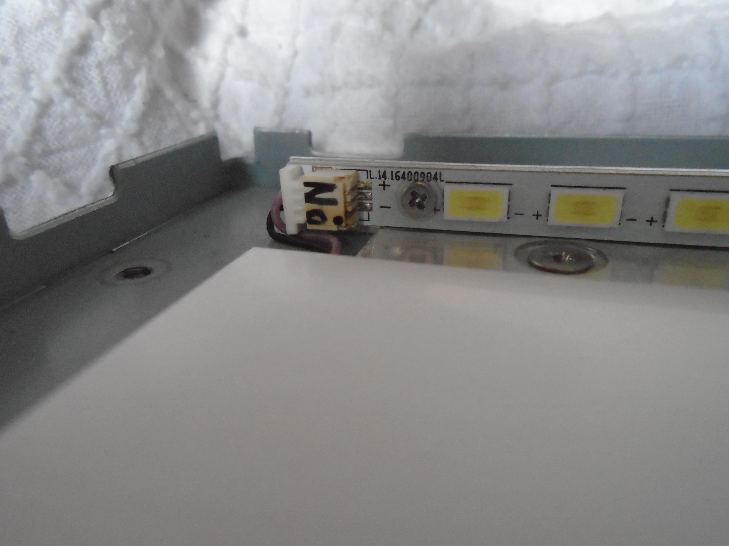

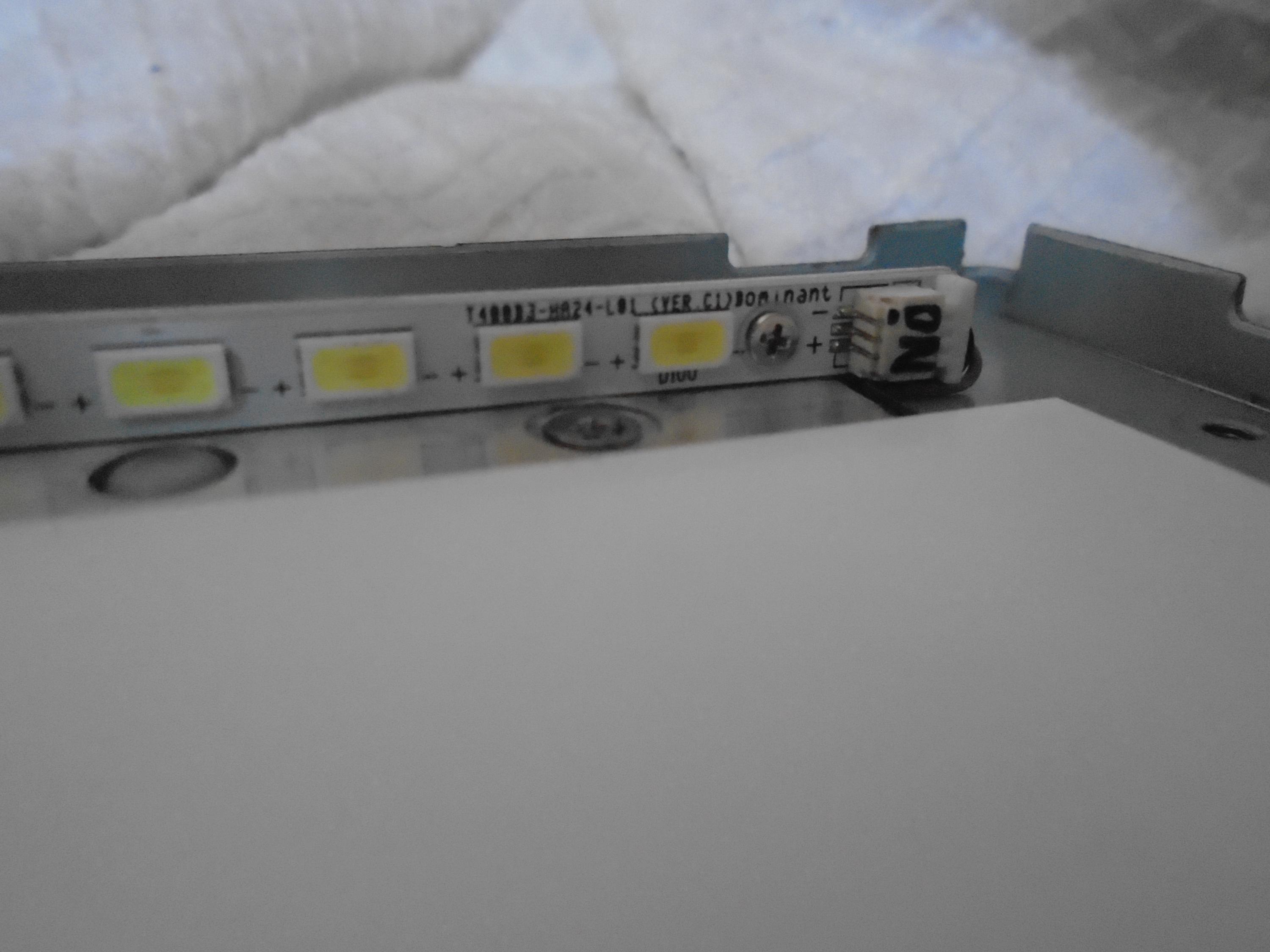

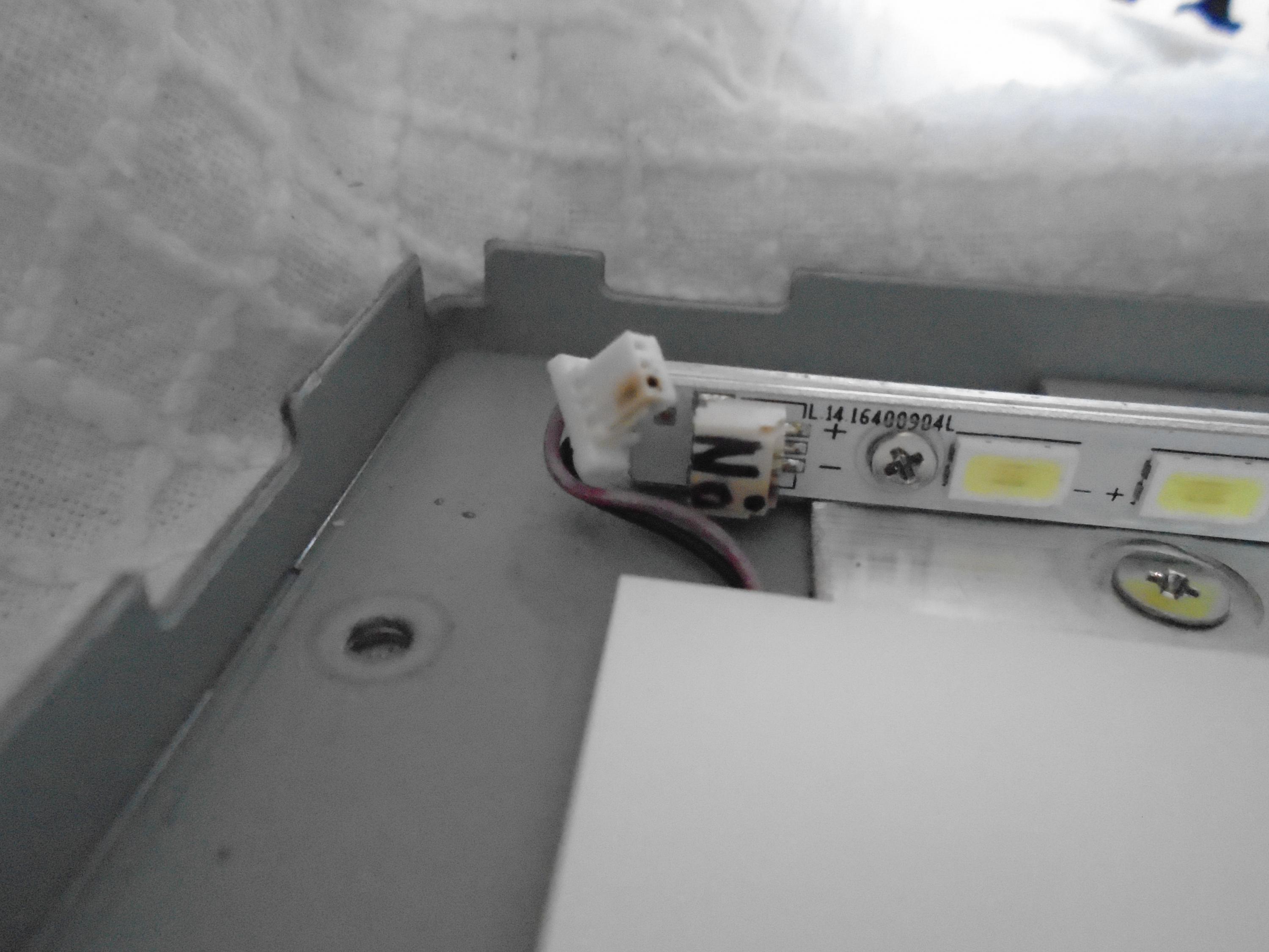

        Re: Post The Led Backlights Your Fixing Here.
        Classic Crap Bush le-40gb01-c no backlights psu was working fine
        took screen apart and found this... nice and brown hmmmm
        took off sockets and plugs and hard wired them in now all working and on test
          Sad that they cannot use good connector that can handle <0.5A
            the feed wires were so thin theyre about the same thickness as a single lvds cable lol i think it was a samsung copy screen had a samsung tcon and screen driver board that runs along the screen but i couldnt see samsung on the back of the panel

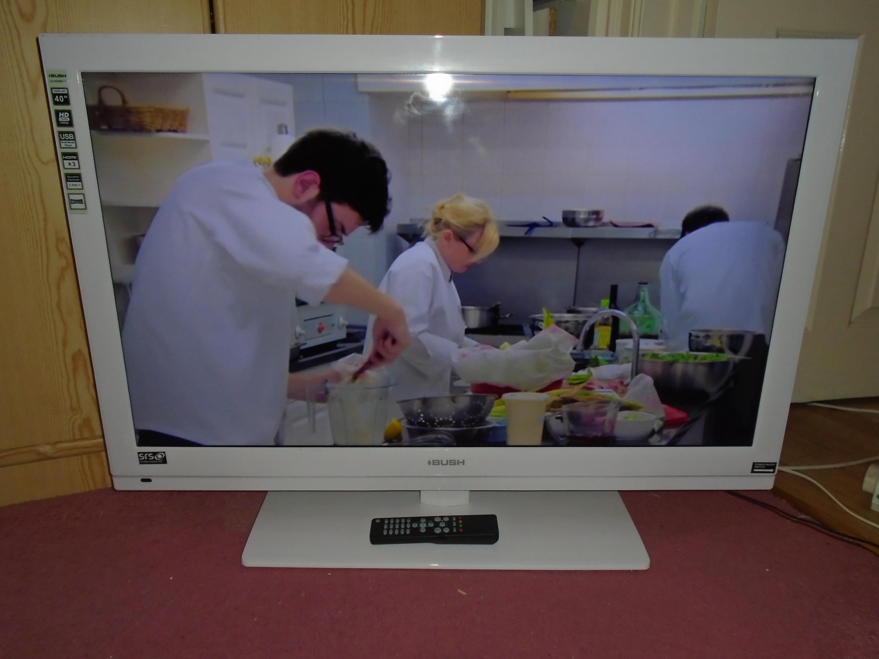

                        Hitachi 32HXC01UB
                        Spliced single replacement LED into upper faulty array, reassembled and under test.
                        Reset LED backlight to LOW
                        Dynamic Contrast to High
                        5349 Hours on clock,set is 2 years old

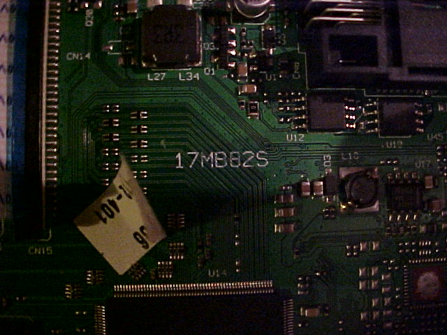

                                        #39
                                        Just found the Motherboard Code which was lurking under one of the lables!
                                        Its a 17MB82S
                                        • ReeceyBurger123
                                          Never Give Up !
                                          • May 2014
                                          • 7325
                                          • Britain
                                          #40
                                          Ok so now download the core update and run it. Have you watched my MB82 core update video ?
