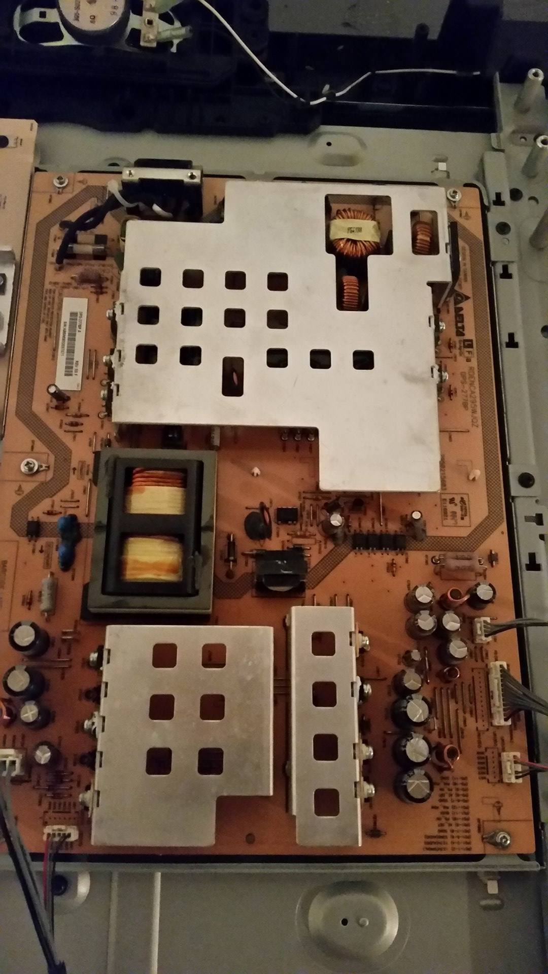

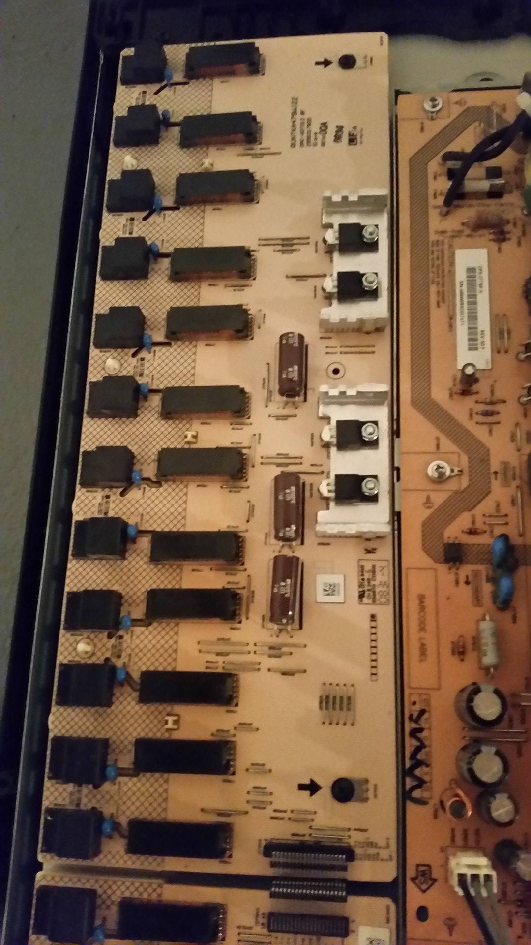

    I took indiviual pictures of each Inverter board and the PSU board then a pic of the whole back.

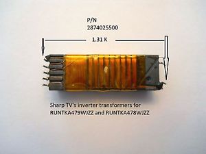

                    Re: Sharp LC-52D85U Won't turn on
                    Originally posted by birdboy385
                    sorry for the late response. Um my knowledge of measuring this sort of thing is very minimal. forgive my inexperience but no idea what that means lol.
                    Look at picture,I circled the legs of the coil which you need to check resistance between.
                    Write down the resistance from all coils,they should be within 10% of each other.
                    btw,parts are cheap for this tv.:
                    http://www.shopjimmy.com/catalogsear...harp+LC-52D85U

                      My inverter boards are different than that. not sure where you're actually ahving me check to map to my own board.
                      • birdboy385
                        • Nov 2015
                        • 145
                        #31
                        here's what mine look like
                        • birdboy385
                          • Nov 2015
                          • 145
                          #32
                          Yeah i really don't know how to translate the board you showed with mine.

                            Can you post a picture of the reverse side of the board in post #31
                            • birdboy385
                              • Nov 2015
                              • 145
                              #34
                              both boards are shown in the original post. showing the other angle.

                                  Can you measure all your inverter transformers and see that they all match.

                                    i'm not getting any reading when measuring those legs. i have my multimeter set to 500v Since i read the reading should be over 1KV IDK if my multimeter just idn't powerful enough to read thjat
                                      #38
                                      The picture of the transformer pins are on the BOTTOM view so you have to look at it from top view perspective which will be opposite.
                                      ' i have my multimeter set to 500v'
                                      BTW, we are reading resistance not Voltage!
                                      NO POWER to the unit.
                                      • vinceroger69
                                        • Mar 2012
                                        • 6714
                                        • uk
                                        #39
                                        These need to be measured in ohms resitance Not dc volts so leave the tv unplugged and take the readings so we can see if you have any issues.
                                        Last edited by vinceroger69; 04-29-2016, 03:39 PM. Reason: budm beat me to my reply
                                        • birdboy385
                                          • Nov 2015
                                          • 145
                                          #40
                                          lol i realized as soon as i posted that i'm like...wow i has the dumb today.These are the readings that im getting
                                          800
                                          800
                                          763
                                          768
                                          768
                                          768
                                          770
                                          Can't get a reading from the 8th one
                                          775
                                          765
                                          775
                                          775
                                          So probably safe to say that (i beleive that's the master board that has 12 transformers and the slave has 10) there is one bad transformer on the master. i'm going to read the slave now and report back
