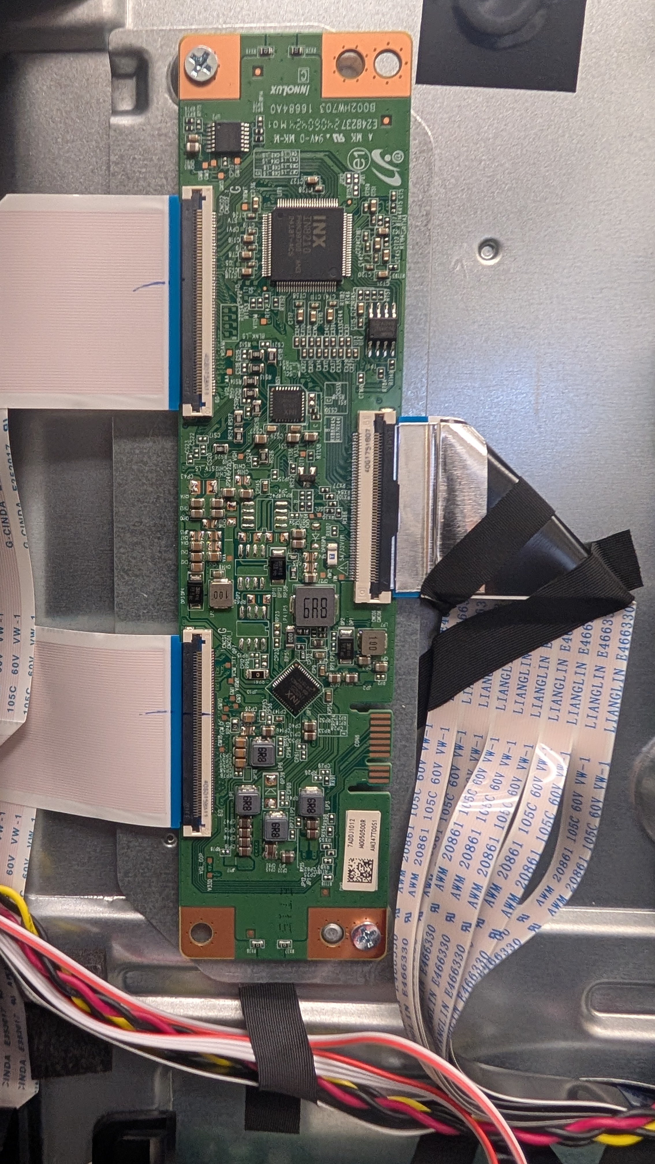

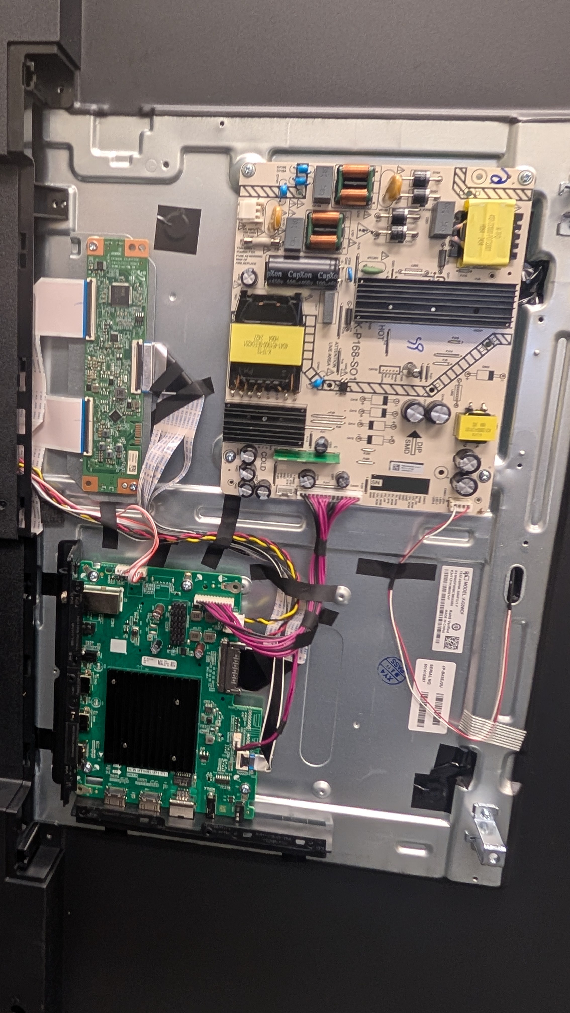

Sharp TV/Display, wont turn on. Brand new, used for maybe 30 minutes. Possibly heard pop then set went dead. I took a look at the boards, no visual damage to boards. The led power indicator is ON, remote will not turn on. I verified that backlights do come on when powered with separate power supply/LED tester. I also

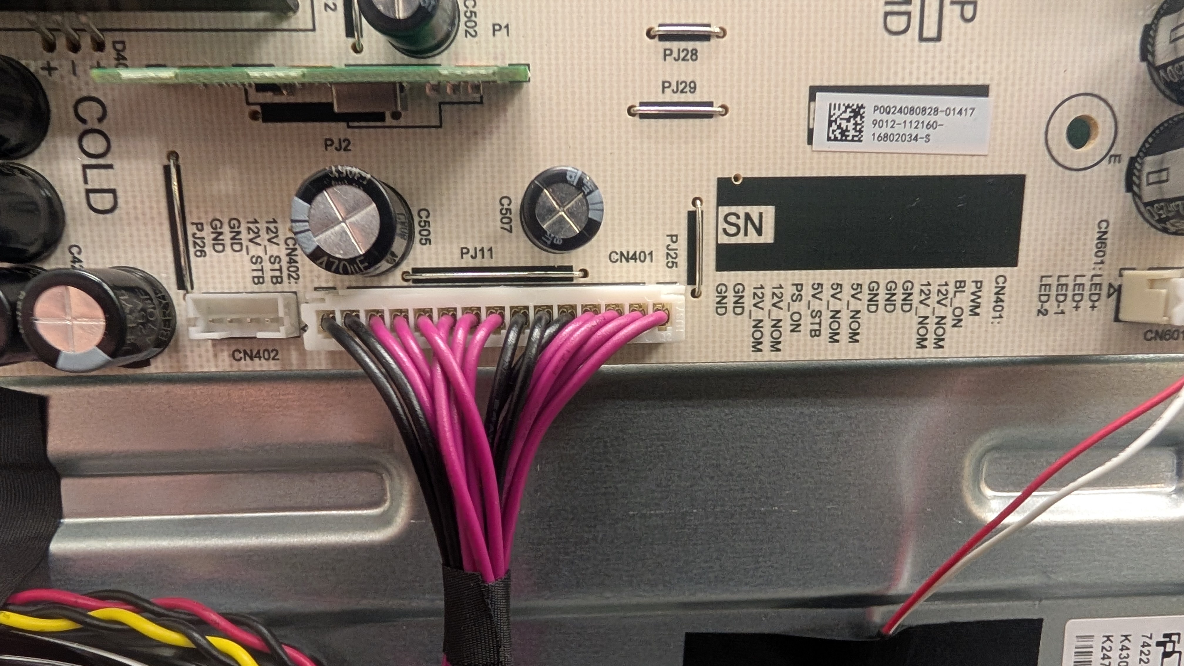

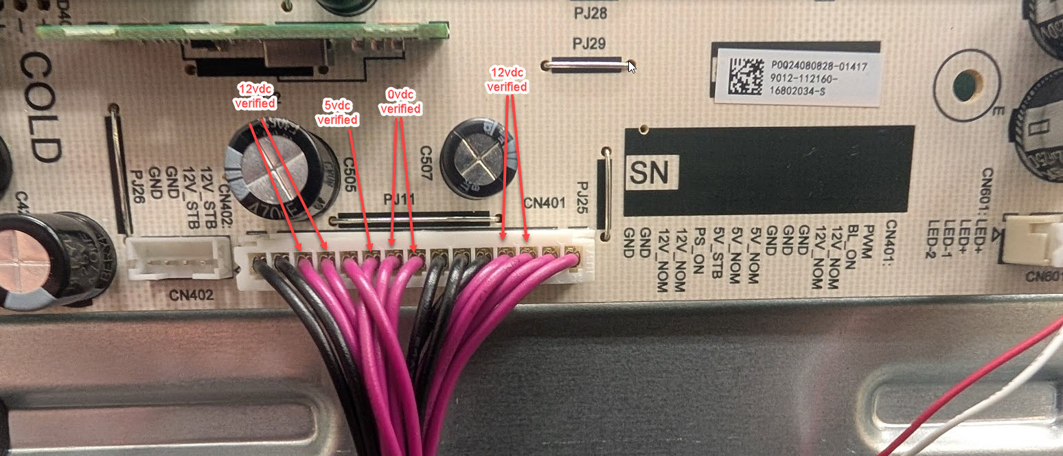

Try unhooking cable from powerboard to mainboard and check all the pins on there standby, ps-on, 12 v etc. For tv safety do all connect and disconnect of cable with tv unplugged from power.Comment
ok, so are you saying to remove power, disconnect cable from powerboard to mainboard and then reapply power and check the pins on the powerboard? Sorry if that's a dumb question. Thanks!
Here is what I measured after removing the power board/main board cable, then applying power.1 PhotoComment

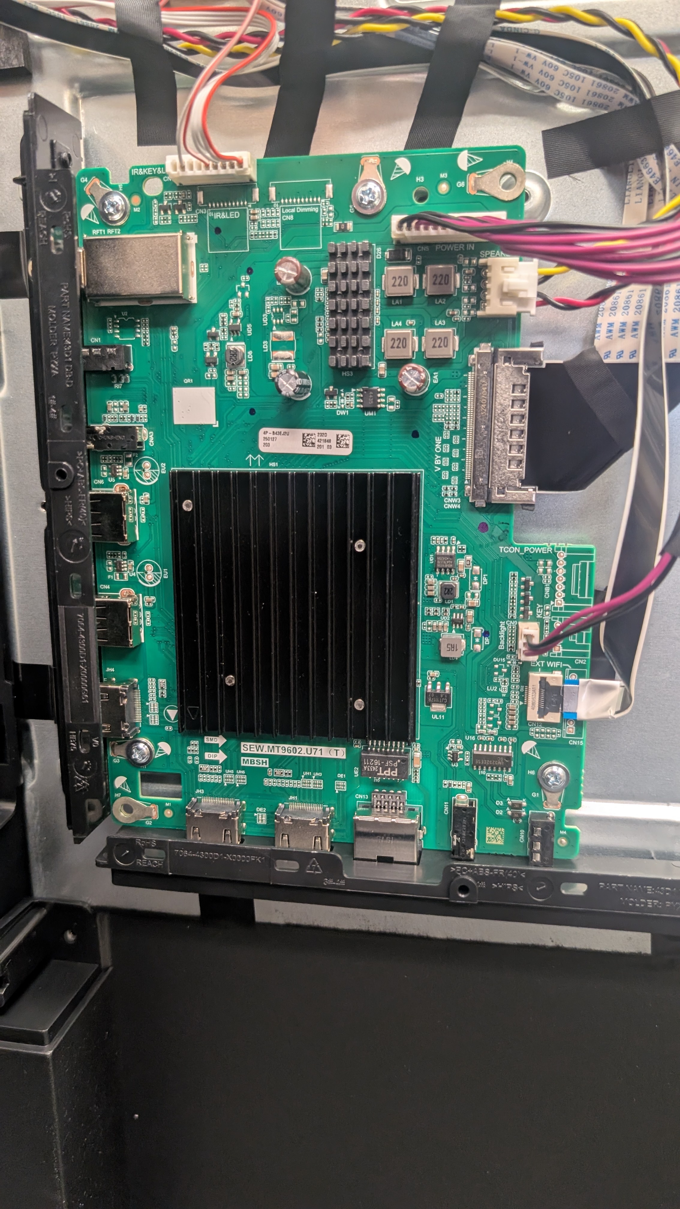

Ok, my best guess is a mainboard issue, seems like the mainboard is dragging down your standby voltage, with it unhooked your standby voltage is correct.Comment
Im unsure what the "standalone" test is. Can someone please give me some guidance with that? Or any other ideas if they have some?

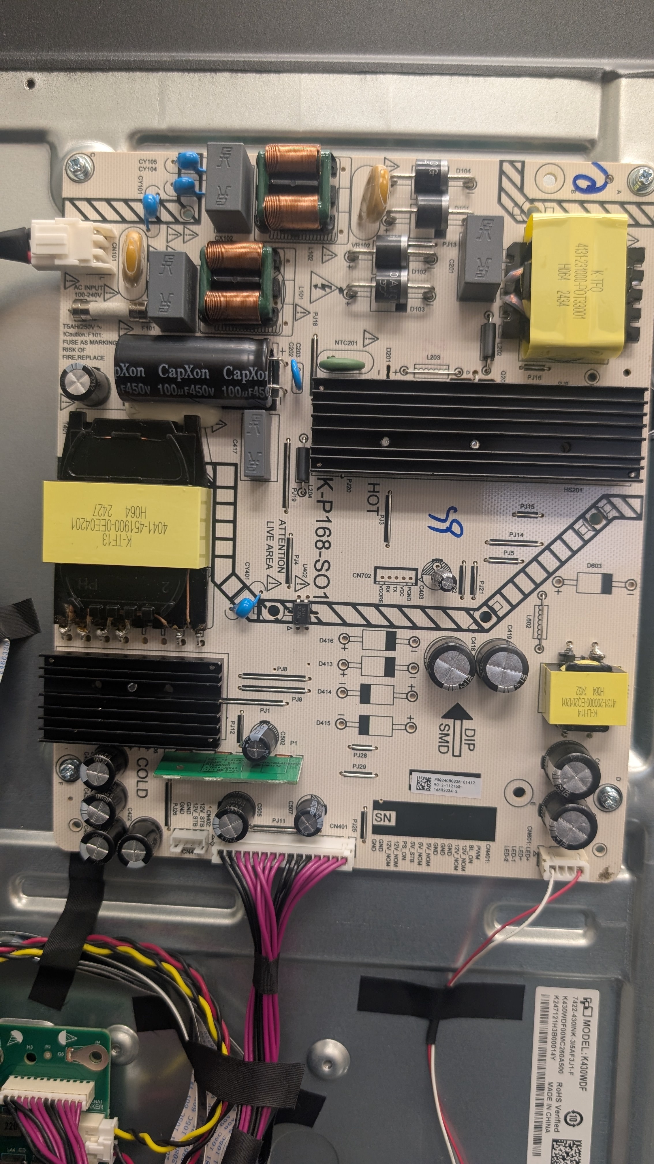

I replaced the main board with one from shopjimmy.com. Still having same issue. Returning main board back to shopjimmy.comComment
Ok, Must be the powerboard, when you hear a pop it can be a component blowing up. If it's a capacitor the damage is usually visible. Might be a clue on underside of board, maybe a burn mark or something and you can check over the solder joints while there. Maybe check the electrolytic caps while there, in ohm mode. Thinking they should be in the K ohms not low. First thing I usually start checking is on the top side of board with all the diodes, resistors and transistors/transistors are labeled starting with a Q. If you can, post a good focused picture of the underside. Good news is they cost a lot less than mainboards.Comment
The first one looks like a match to me. BUT the board is not exactly the same so I don't know if that matters. If any doubt you can reach out to them by message to confirm a match: https://www.ebay.com/sch/i.html?_nkw...Desc=0&_sop=15Last edited by nomoresonys; 10-11-2025, 02:03 AM.Comment
Some others are more familiar and can explain better. here is an example, I believe this is your exact board. Notice how the part numbers on the white sticker match, in this case the numbers on the second and third row match. Not sure if the third row has to be exact or not but it looks like the first row will be different but that is alright: https://www.ebay.com/itm/27678571012...Bk9SR4rriaW6ZgComment
I'm also a little curious if any of those other boards with just the part number on the second row of the sticker matching would work in this situation, is a good question yes?Comment
