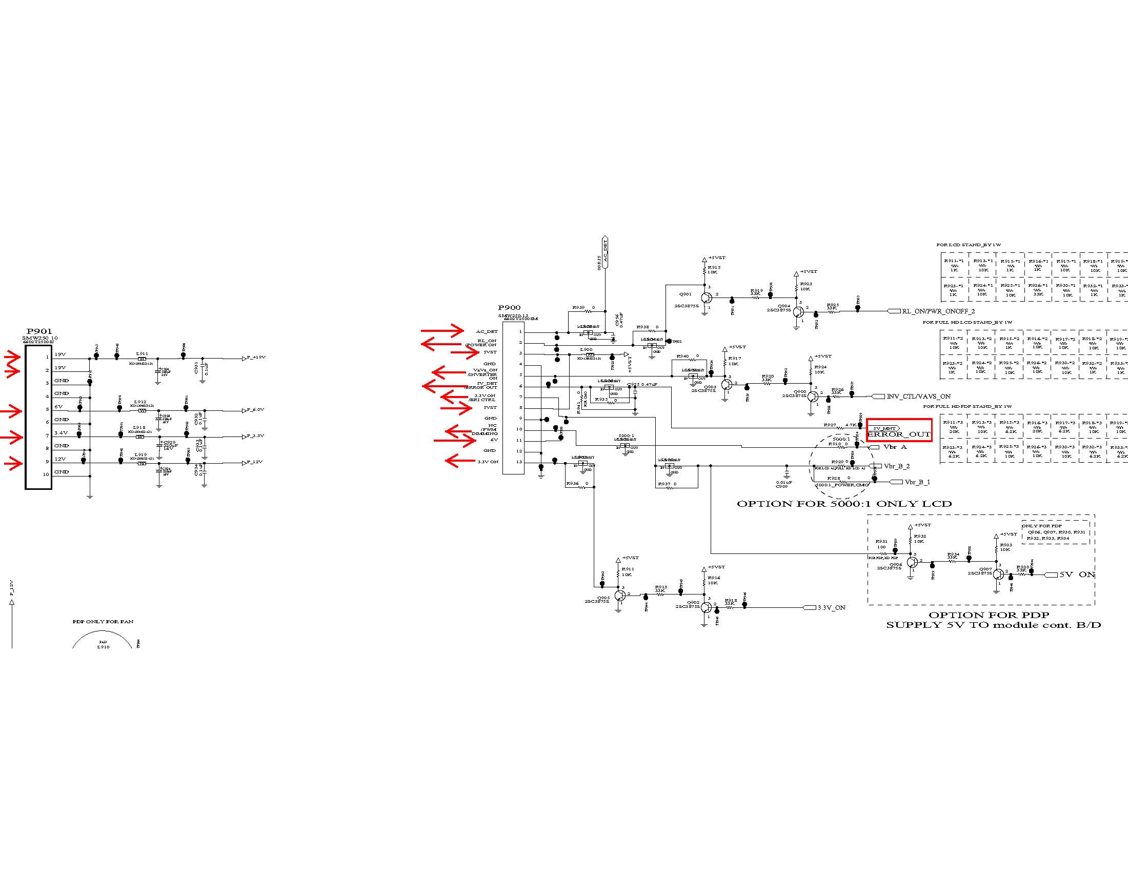

                          Re: Lg 42lf65 flashing red green light
                          Replaced all the caps last night. Then plugged TV in this morning and worked fine. Turned it of and then wouldn't turn back on. Just have green light.
                          Leave it unplugged for ten mins the turns bk on. And again not bk on.
                            can you check on the connectors the voltages when the sets in the working on condition and when the set is in the fault off condition please can you post the voltages and by the side of the connectors its usually printed what each pin voltages etc are.
                              acd = 5v 5v
                              pwr =2.8v 2.8v
                              st 5v = 5v 5v
                              gnd
                              inv ctrl = 4.5v 0v
                              error = 5v 0v
                              burst dim = 3.4v 3.4v
                              st5v = 5v 5v
                              g
                              a-dim = 1.6v 3.4
                              6.5v = 6.5v 6.5v
                              Gnd
                              3.4 on = 3.4 1.3v
                              first v reading is when the screens on, 2nd is when it wont turn bk on
                              hope this helps
                                other plug
                                19v
                                19v
                                g
                                g
                                6.5
                                g
                                3.4
                                g
                                12v
                                only the top 2 19v stay same, bottom 3 are 0v when tv wont turn on
                                  #36
                                  inv ctrl = 4.5v 0v: 0V = no backlights on command from the main board.
                                  3.4 on = 3.4 1.3v (not sure what this one is. Is that what is labeled on the pin '3.4V ON'?)
                                  "other plug
                                  19v
                                  19v
                                  g
                                  g
                                  6.5
                                  g
                                  3.4
                                  g
                                  12v
                                  So the 6.5V, 3.4V, and the 12V are not there when it does not work?
                                  • Ice203
                                    • May 2015
                                    • 99
                                    • Uk
                                    #37
                                    Yes that's correct. 3.4v on. Is what's marked next to it.
                                    And the 6.5v 3.4v and 12v don't work when TV won't turn on.
                                    Hope this means something to u. Cos I not got a clue.
                                      OK, try downloading these service manuals:
                                        thxs had a read but still no closer in finding out how to repair, dont want to change boards as im sure they r fixable
                                          #40
                                          OK, I looked at the diagram of the power connectors on the main board, it looks like the main board is the problem due to the missing output signals going to the power supply board.
