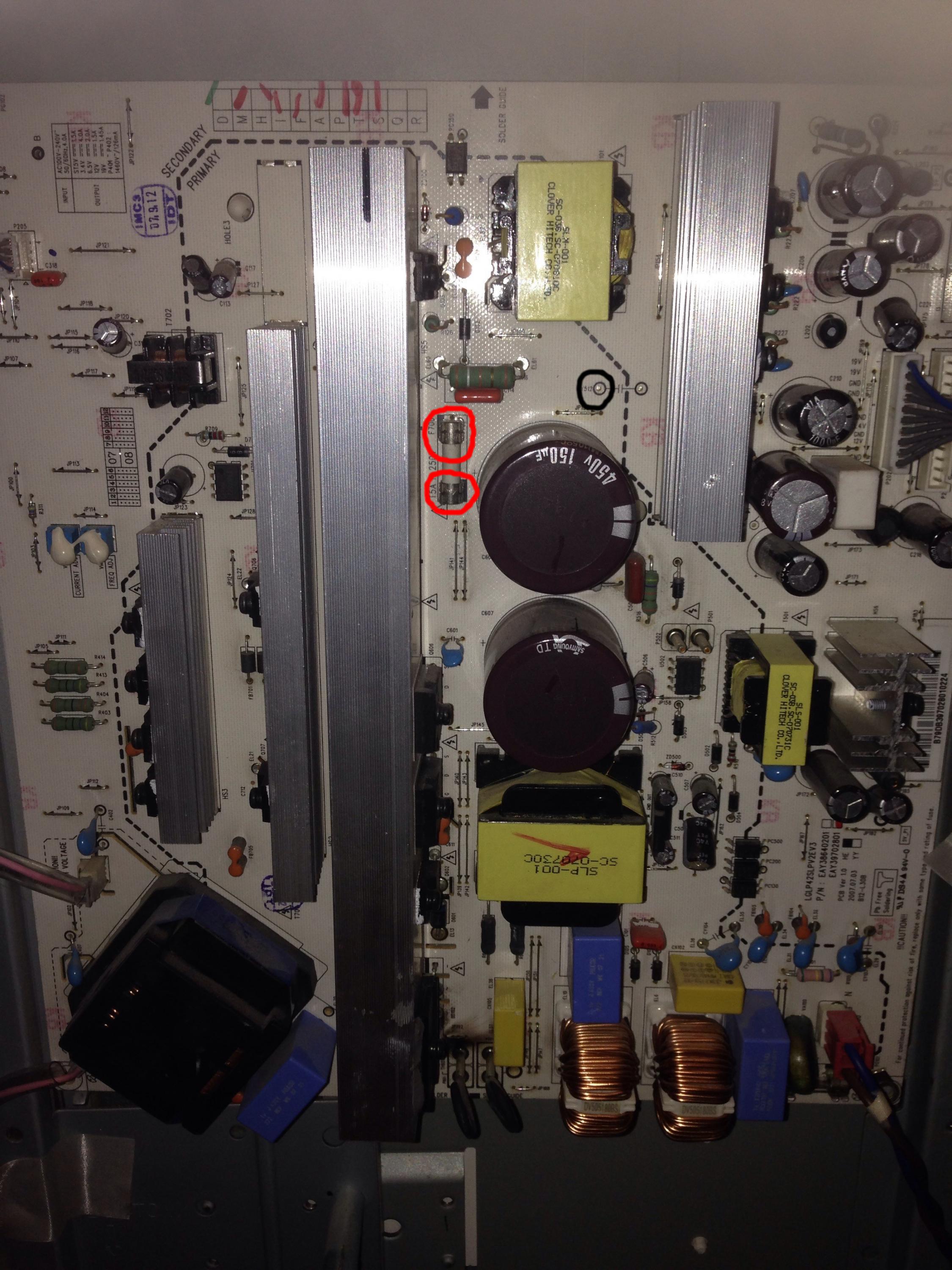

              Re: Lg 42lf65 flashing red green light
              Is that fuse near the big 450V caps OK?
                  Ok, measure volts DC from each red point to the black recessed solder point, you may find you need to solder a wire to this point to make an accurate measurement. Use highest DC range. Expect around 380-400V when the power supply PWR signal is high (>2V)
                  Caution: High voltage! Do not touch any part of the primary side which you are testing while it is powered on! Discharge 450V caps before soldering. I recommend someone should watch you whenever you do primary side/high voltage testing.
                      Getting 874 at those points
                        Check again, as that is definitely not correct.
                        If still high: Check meter is on DC range, and check meter battery is fresh.
                          What a noob. Had on wrong setting. Can tell I'm new to this.
                          This time I got 397.
                            Good, that's correct then. PFC circuit is working (boosting 320VDC to 397VDC) and power board is registering power on signal from main board.
