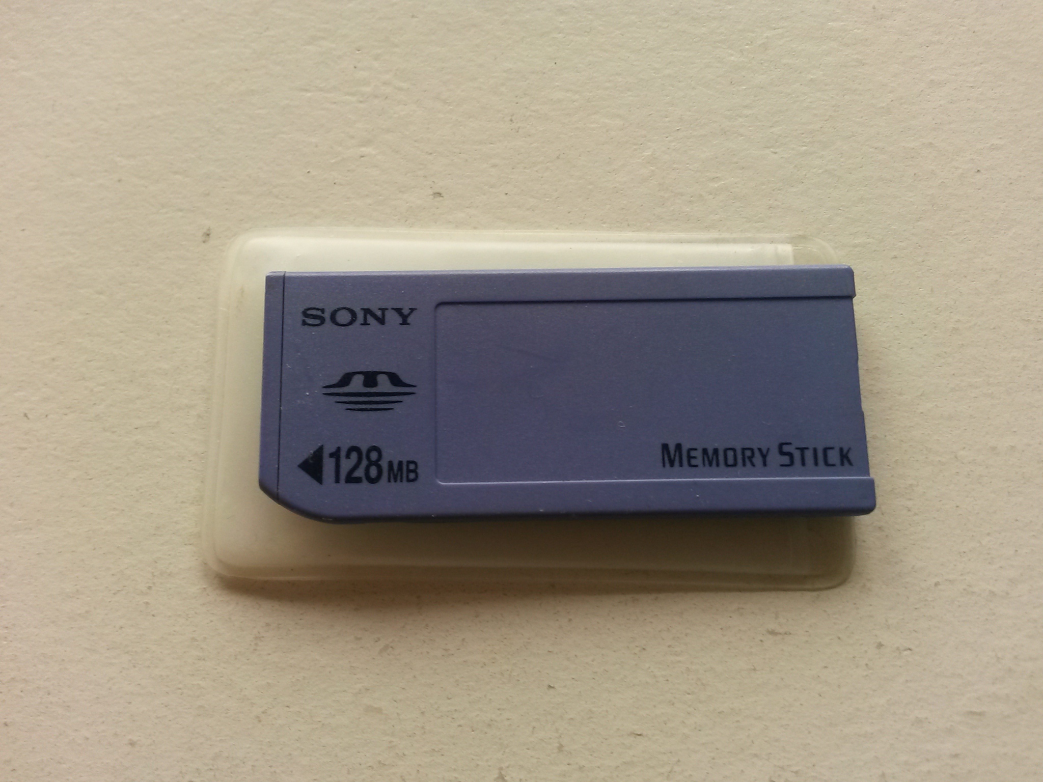

                                • cheeky2
                                  • Dec 2012
                                  • 337
                                  • uk
                                  Re: Sony KDL 40v5810 - No picture, no backlight, no sound; relay clicks, green LED
                                  Originally posted by HESC
                                  Hi, Several years later on from posts above I discovered same problem with my Sony KDL 40v5810 TV. Downloaded files and followed instructions from Dang (thank you so much)....used a sony camera to format memory stick. Was expecting the tv to 'boot' from the memory stick when switched on but nothing is happening ....it doesn't appear to be recognising that the mem stick is there.
                                  Does anyone have any suggestions as to what might be wrong please?
                                  Btw I don't see the MSTK_PRO.IND file as indicated in 2-4 of the instrutions, but assuming that's because I'm not using a 'PRO' memory stick? Do I *have* to?
                                  SO disappointed with Sony for withdrawing support on this....the hardware is as 'good as new' (TV repair man has told me all the components are working fine) but looking like I might have to dump the entire tv because I can't get a fix for a little bit of software...unless some superhero out there can help me out ;-)
                                  It will not work if you have a Pro as I have tried before (these sticks are too fast , don't bother getting an adaptor as also will not work. The reason you are not seeing MSTK_PRO.IND is that you will need to enable viewing of system files (which is normally hidden in Windows) so that you do not tamper or delete them for obvious reasons!
                                  • HESC
                                    • Mar 2023
                                    • 2
                                    Many thanks for responses....good to know that there are at least two superheros out there ;-)
                                    The memory stick (well it's a 'card' rather than a stick) was newly bought so that suggests it is a PRO maybe? I will attempt to unhide the system files to check...if it is, then evidently that is likely to be the issue (and it being shown in the instructions is actually rather unhelpful!).
                                    If it isn't I'll attempt to obtain an older card ....but because it needs to be a sony mem card in order to fit in a sony digital camera for formatting (I've tried using a multi card reader - it doesn't work), I'm thinking that's going to be tricky.
                                    Will post to say if gets fixed. Thanks again.

                                      • cheeky2
                                        • Dec 2012
                                        • 337
                                        • uk
                                        This is the type of memory stick you require. I don't think they did anything larger than a 128MB in this style. Using anything else will not work if it is larger than a 128MB!
                                        I have tried and only managed to do it when I saw a cheap Sony camera with memory sticks which I keep for this type of situation! I have a a 128MB, 64MB and a 16MB!
