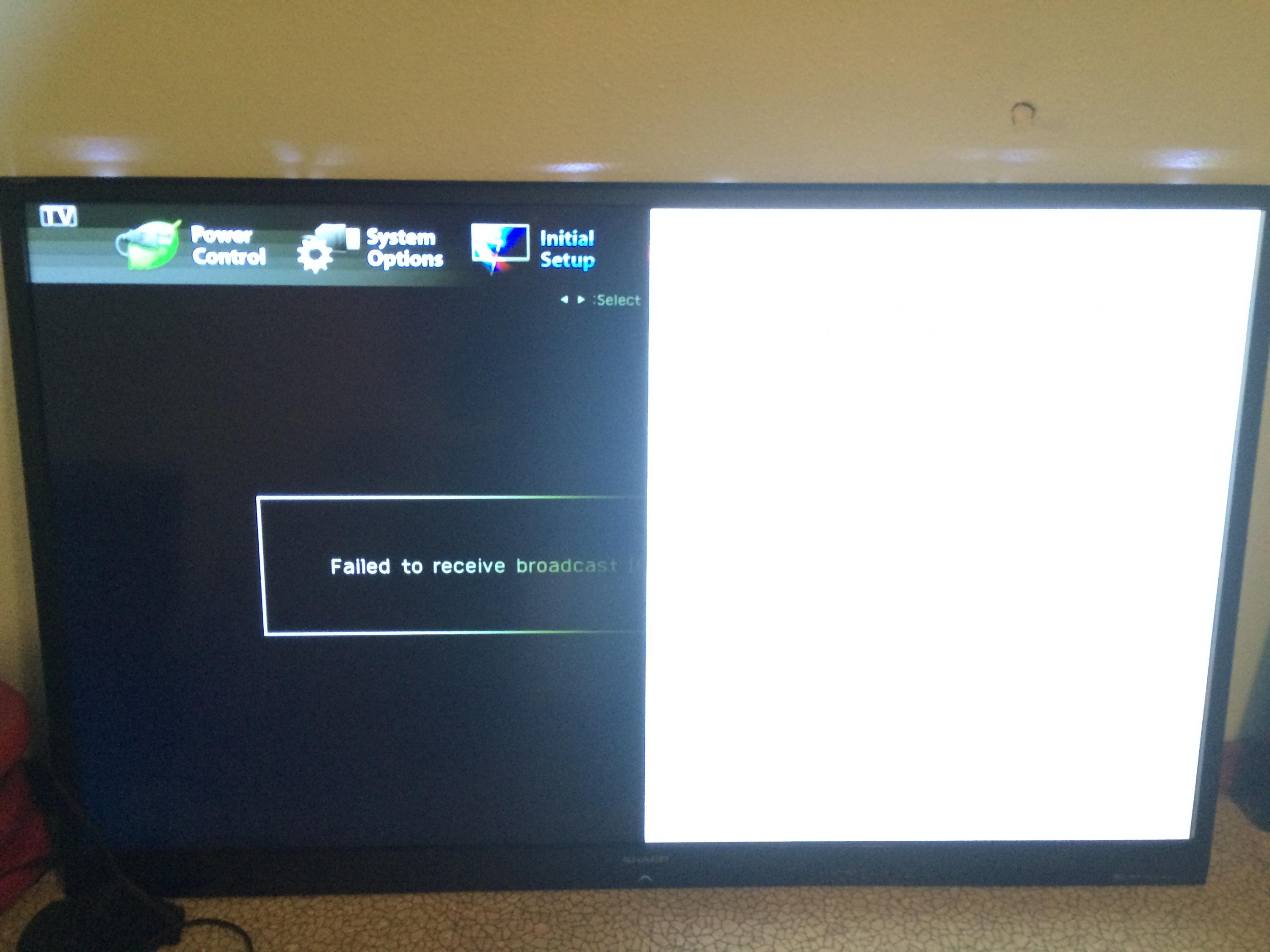

                                hi, I have a LC-60LE640U with 2 short and 5 long blink code
                                I get no backlight or imagae
                                I get a good picture on the left side with just left tcon cable connected
                                No backlight or image when just the right tcon cable connected.
                                No Visable blown caps, or burn marks on powerboard
                                6v at all four backlight power wires
                                Is 6v right??

                                  Re: Sharp AQUOS LC-60LE633U--Power light flashing 5 times fast and then 2 slow flashe
                                  This with the right tcon cable disconnected. Same side that is all white
                                    for the 60" you can do the same as the 70",rip the bad tabs off....
                                    Read up on the 70" model first!!!!!!!!!
                                      what happens when you do a similar thing for the other side?
                                      oops... didn't read the previous post about this side... sorry. As suggested, look at some of the 70 in posts on dealing with side tabs. The difference in the set is that there are no side boards as the tabs run to a type of flex "board" down to the bottom boards. If you look closely at the bottom corner of each side, you should see where there is a connection to the bottom boards. You can try your "test" again keeping the tcon fully connected, but disconnect at the corner. You should get a "full picture" on your set when you disconnect the right corner.
                                      The reason for doing the test at the corners is to isolate the problem strictly to the side tabs as opposed to a possible problem with the lower / bottom boards as there have been posts of people finding a fixable issue with the bottom boards that given similar problem appearances.
                                        Thanks a bunch guys, I i have read alot on the 70" model. just wasnt sure if it applied to the 60"
                                        No need to yell martino. Gezzzzzz ehhhhh.
                                        Much appreciated Budwich
