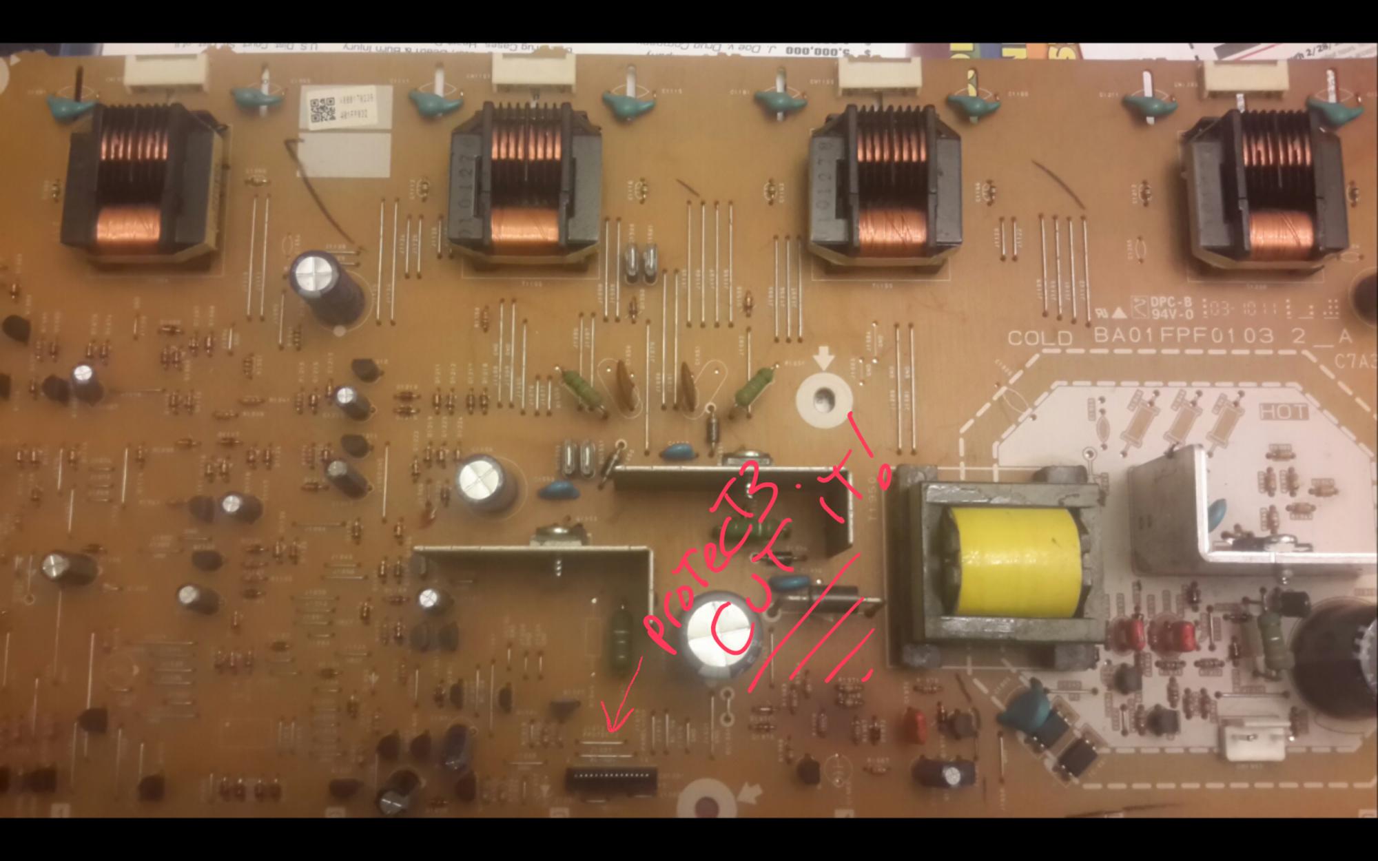

      Did you ever figure this out timmy? I have the exact same issue (and symptoms). I replaced the inverter board with no love.

        Exact issue and symptoms as timmy. If you still need help (or anyone else) let me know. I was able to get my TV going for zero dollars. Can post pics if need be....

          That would be great. I still haven't gotten it fixed. Pic's would be even better.

            #45
            Re: emerson 32" lc320em1
            Hi timmy, your gonna thank me at the simplicity of this. Cut the wire jumper protect3 on the inverter board (see pic I attached). No worries, if you ever need to reconnect you can simply solder the gap. After cutting the tv should power on and stay on. There is an error in the protection circuit. Please post back your results..... Rog
            • timmypeeps
              • Jan 2015
              • 26
              #46
              Thank you thank you thank you. I know it's not the right way but as long as it doesn't catch fire it's all good. I was going to use it for target practice this weekend. But I will have to find something else to shoot at. Thanks again big ups to you

                #47
                I've seen this done on other brands too, I bet this would fix a whole lot of tvs, don't know if it's a design flaw or if the jumper is really doing anything, anyone know exactly what it's suppose to do?
                  #48
                  It is not design flaw, it bypass safety shutdown circuit. Do it at your own risk and never sell or give that TV away without putting the safety back in place.

                      #50
                      I stopped jumpering the protect circuits on TVs after I got a melted transformer on a 15" LCD. I imagine much worse could happen with bigger TV/transformer.

                        #51
                        Thats not a fix,its a time bomb waiting to explode.

                                        #59
                                        I've tried this, but there is no image displaying on my tv even thought the power light is on.
