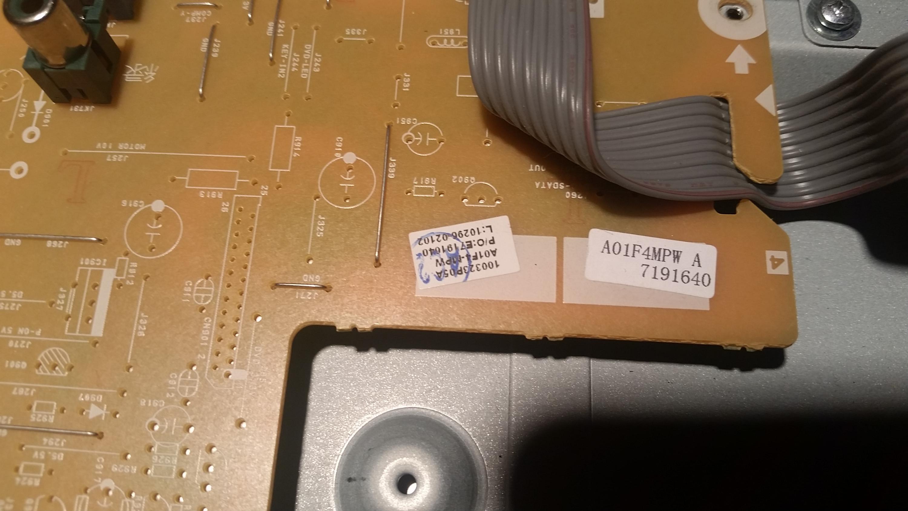

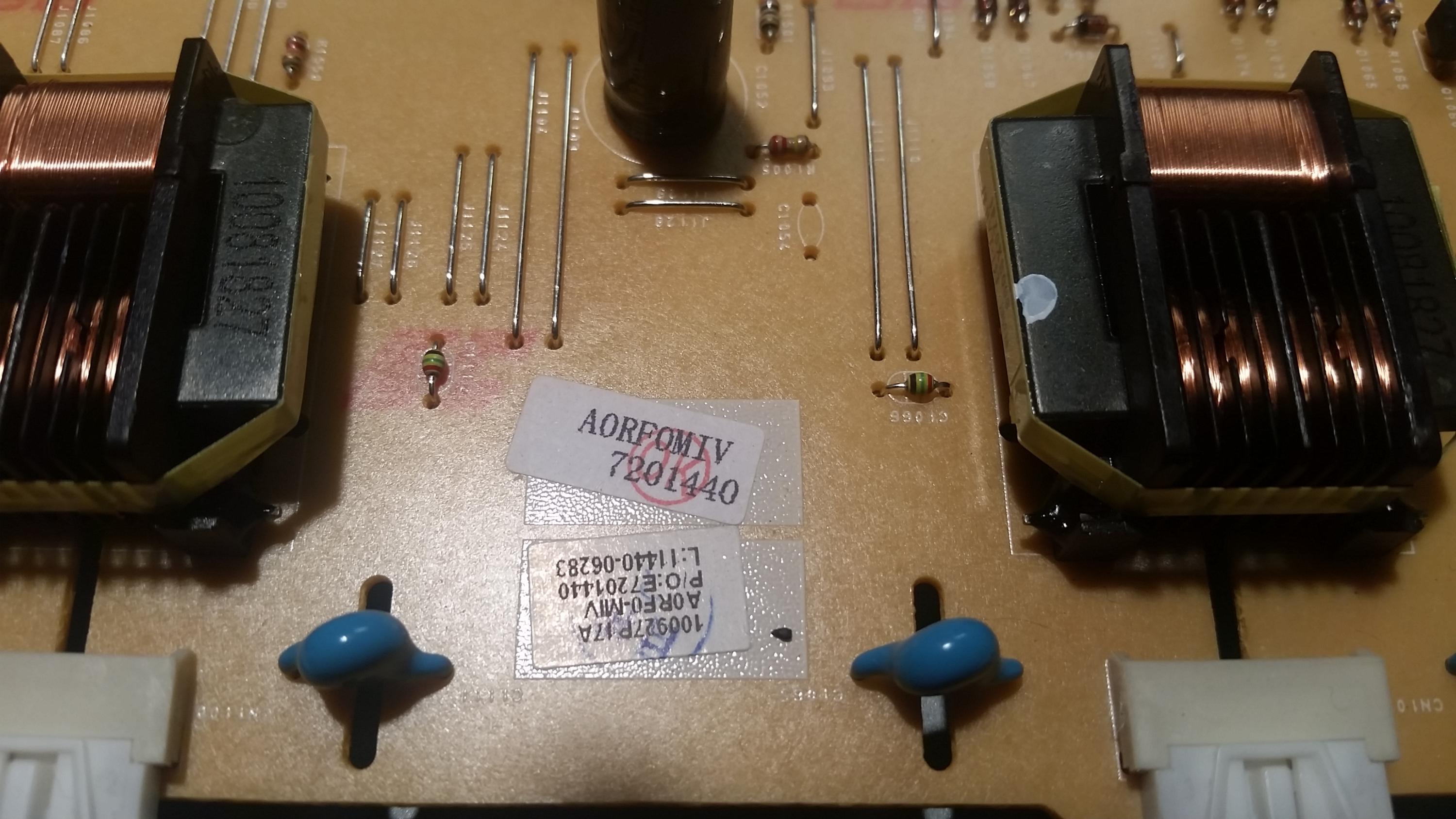

                            Need pics and P/N's of your boards. I have one of these that has the PSU/Backlight inverter all in one.
                            There were numerous failed diodes, resistors, and a mosfet. When psu failed it damaged mainboard also.
                            I got lucky and found both boards from a seller on ebay.

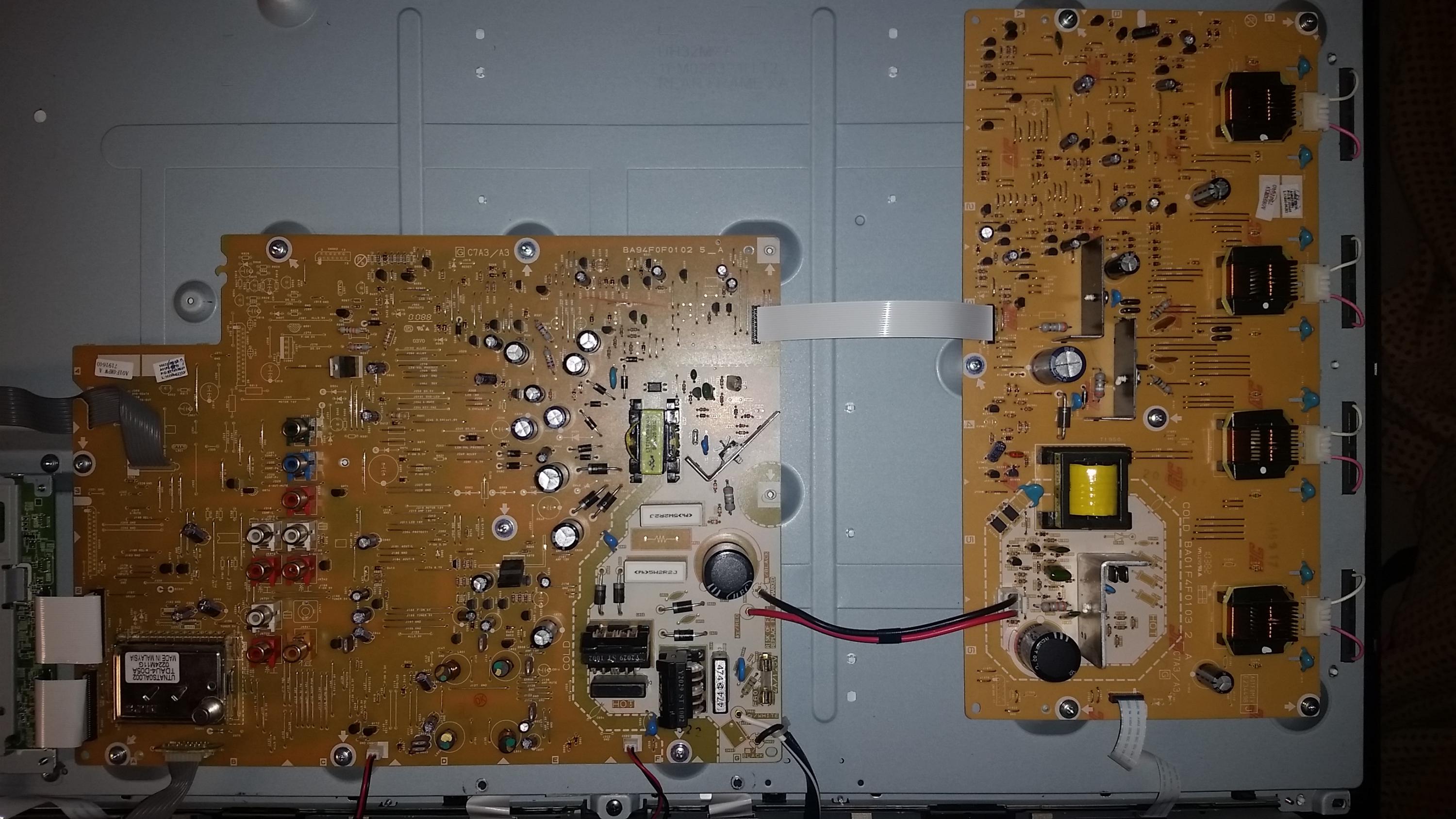

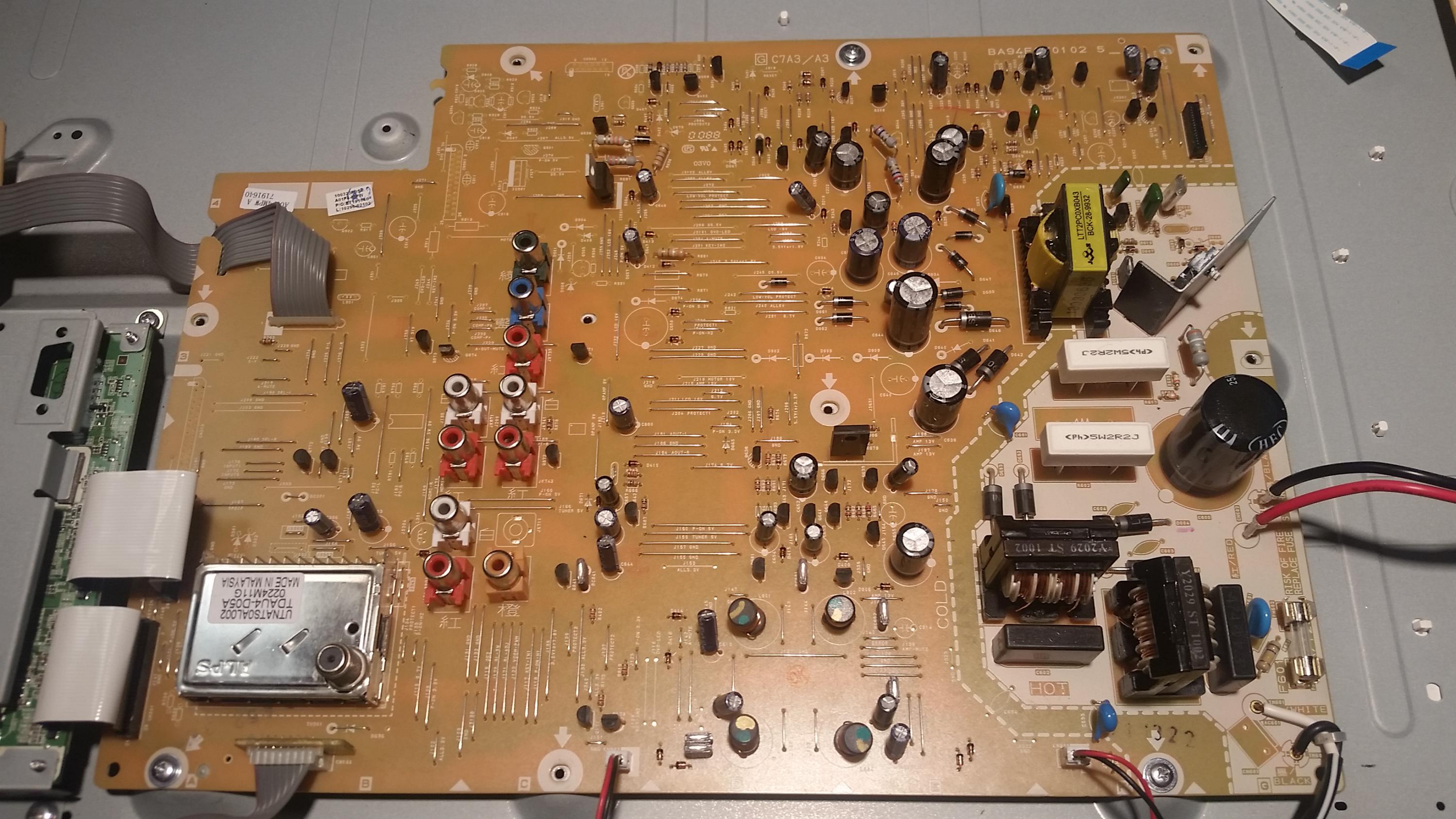

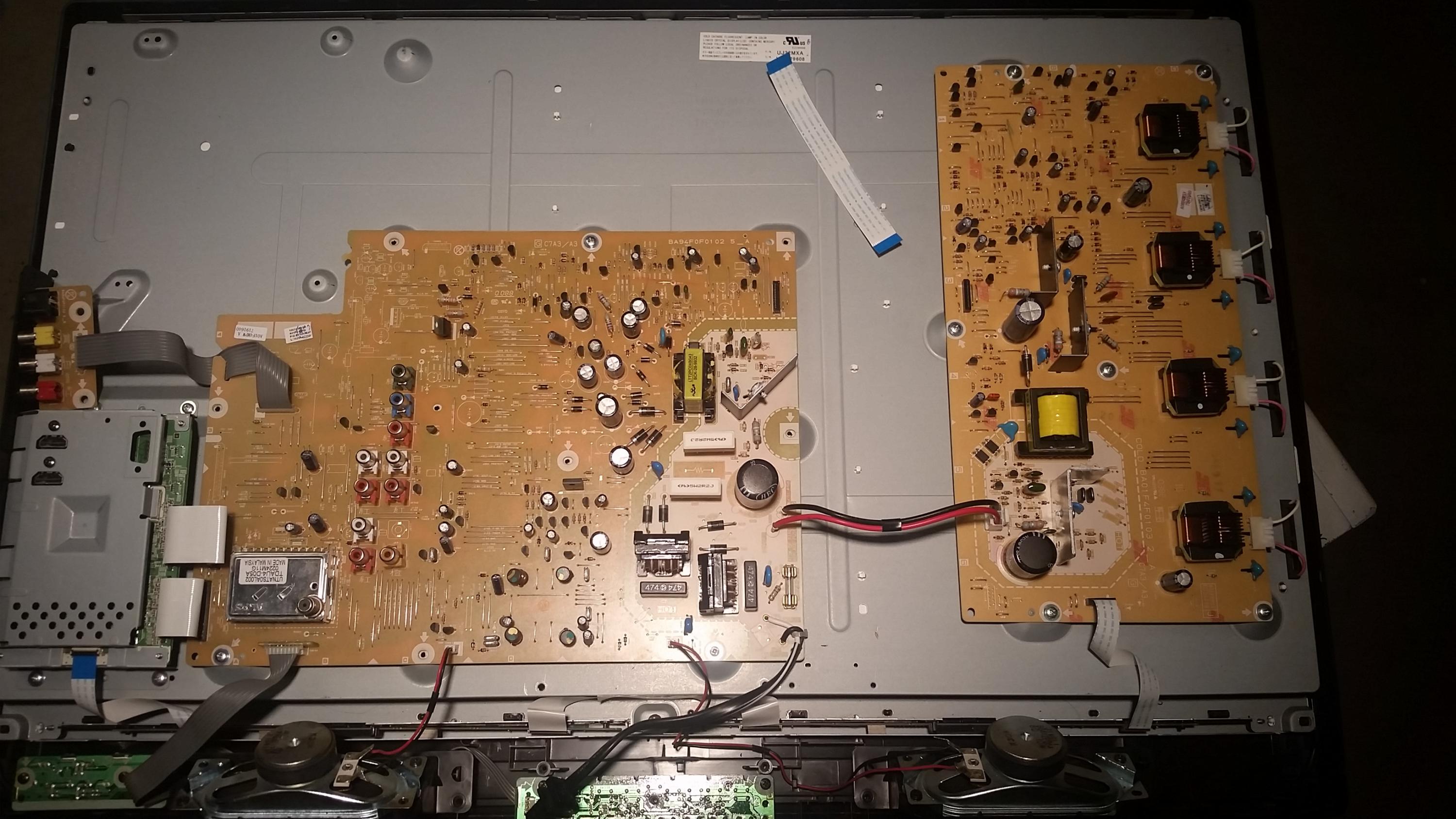

                              Re: emerson 32" lc320em1
                              Here's some pics of the boards
                              • timmypeeps
                                • Jan 2015
                                • 26
                                I have 2 boards from another tv but they aren't an exact match so they don't work. I was hoping to use parts on the new boards to fix the original's

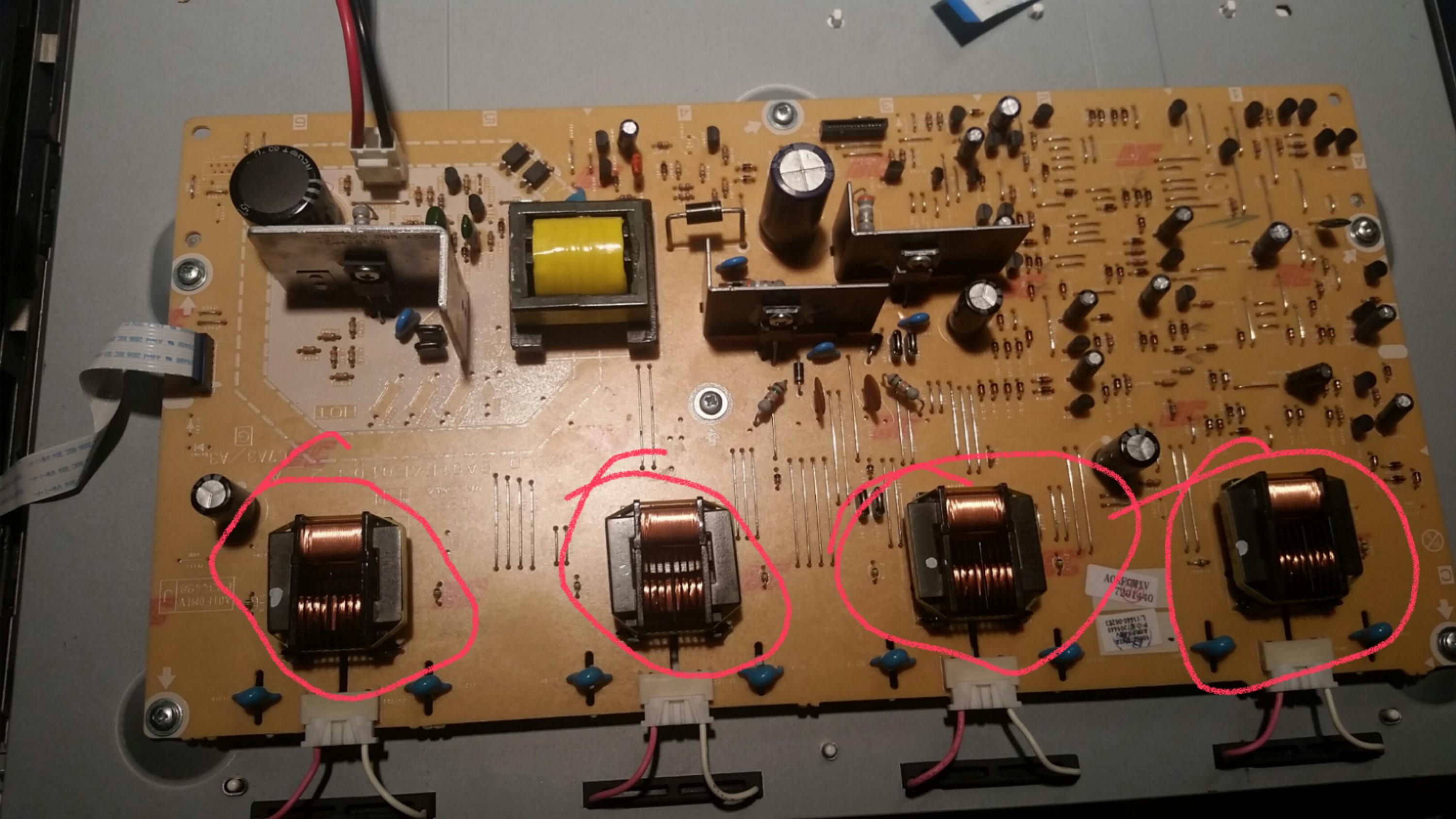

                                  Check the inverter wires for shorts circled in red.
                                  • splitcrete
                                    • Dec 2012
                                    • 387
                                    • usa
                                    Did you ohm out the inverter transformers ? May be a bad one or two...
                                    • timmypeeps
                                      • Jan 2015
                                      • 26
                                      No shorts, tested all one at a time and they all light up individually and all at the same time. I have not done an ohm test on the inverter transformers. Your talking about the black square with copper coils right.
