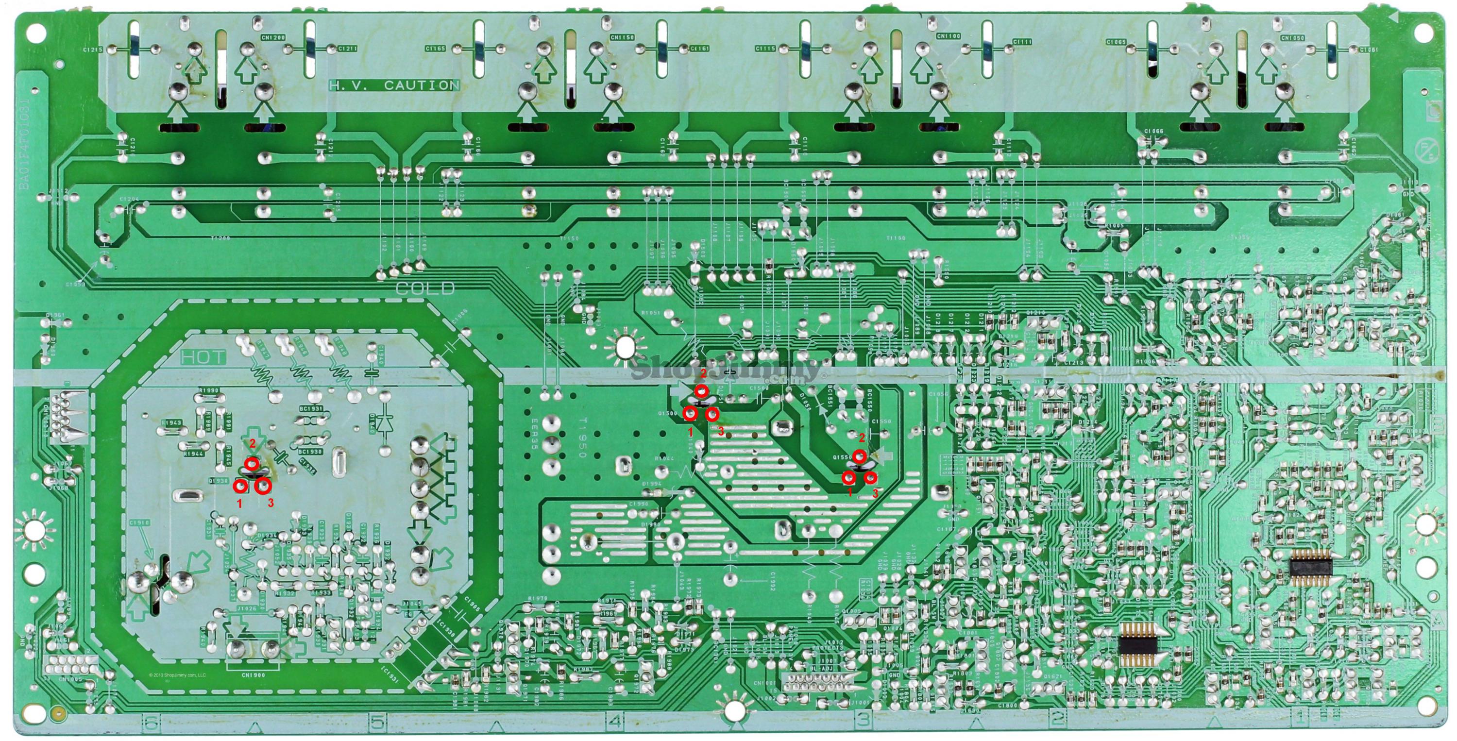

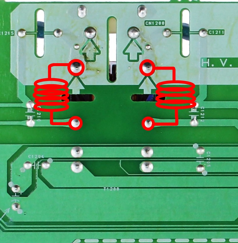

    Yes check those out . unplug them all and put probes in the sockets of the transformers. They should all be I think 10% of each other.

        Inverter transformer HV windings.

              budm posted better test points. Ohm those points.

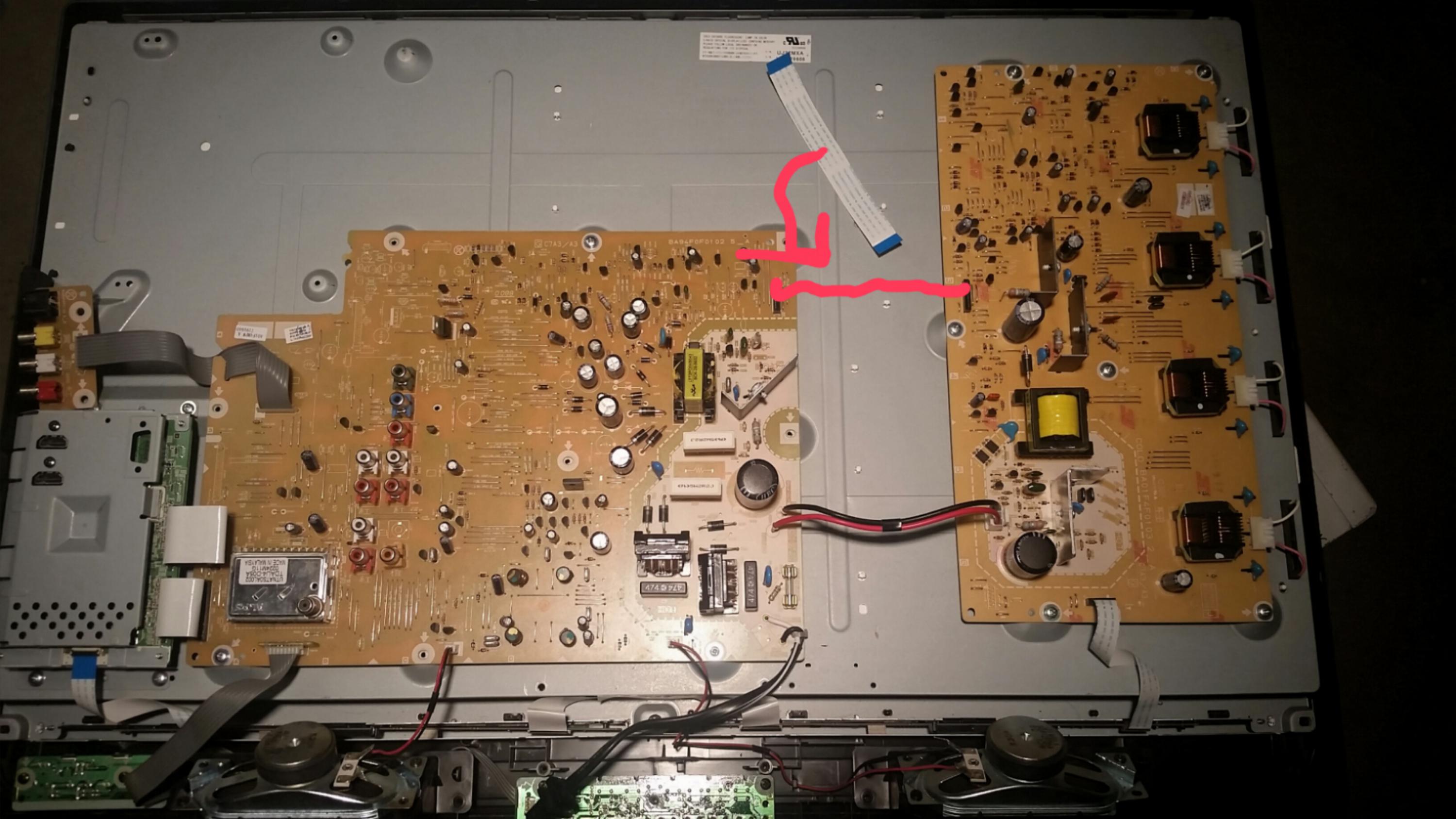

                  Re: emerson 32" lc320em1
                  Tested all the hv windings like in the picture all of them were .3 ohms.
                  • timmypeeps
                    • Jan 2015
                    • 26
                    #29
                    If I remove this cable and this cable only the power will come on and the green light stays on. But without this cable the screen will not come on at all. Soon as I plug it in the tv will shut off and the red standby light comes on.
                    • timmypeeps
                      • Jan 2015
                      • 26
                      #30
                      Sorry forgot the pic

                        #31
                        Are you saying at any point the panel ( the screen not the led) lights up and stays on for more than a few seconds.
                          #32
                          "Tested all the hv windings like in the picture all of them were .3 ohms." That does not look right, 0.3 Ohms or 0.3K Ohms, or 0.3M Ohms?
                          Check the resistance readings of the 3 MOSFET's pin combination:
                          1 & 2,
                          1 & 3
                          2 & 3
                          BTW, board is on;y $20.

                            #33
                            The screen will only come on for about 2 seconds. If I used the remote to turn it on and hold the volume - or + down it stays on about 4 or 5 sec and you can see the volume bar then it will shut off
