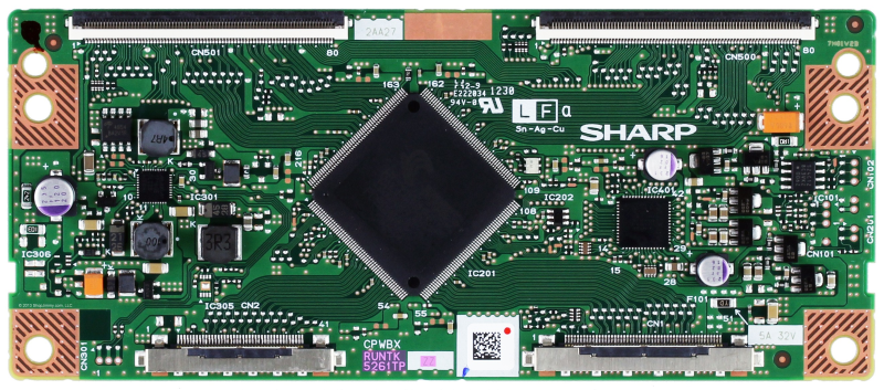

    Vizio E701i-A3 no Picture
    Need some help or assistance please on a Vizio E701i-A3. Working on one where the power comes on using either remote or side panel power button. When power on, the backlight comes on and stays on, just no picture. I suspect it's a bad T-con board model RUNTK5261TP-ZH. When I measured the F101 fuse, label (5A @32V), getting less than 1 V. I suspect it to be bad. So, I order one off of Ebay and put in in. No change, still getting the backlight on, no picture. But with the new tcon board in there. I am getting a 12.32V reading, but not the 32V. Is it supposed to be a full 32V for the picture to come on? Did I buy a bad Tcon board? Can anyone please advised. Thanks in advance.

    Re: Vizio E701i-A3 no Picture
    could use more details, I'd start with making sure all the voltages at the plugs are correct on the power supply board, careful HIGH VOLTAGE on ac side, could be a tcon, voltage at tcon can be checked.
              12V at the SMD fuse of the T-CON is correct, the 32V is the fuse Voltage rating.
                Try disconnecting one of the panel ribbons, just connect one at a time, see if part of the picture comes back. Could be a defective LCD panel.
                  Hi Tom, already try that, still getting the blank (black) screen with just the blacklight on. Wondering what else is causing this.
                      Is there any test points on the Tcon board to measure each voltage drop, don't see it on this particular board.
                      • bjorkson
                        • Apr 2012
                        • 127
                        One other thing I did not include in my original posting is my original T-con board RUNTK5261TP has a ZH prefix. I replaced it with a RUNTK5261TP ZG prefix. All the plugs seen to fix ok. The ZH is for a 70in panel, where your ZG is a 60in panel. Would this cause the picture not to come on? Or they compatiable?
                          That's absolutely the issue and I've experienced this myself. You need the ZH T-con. I'm not sure what the difference is on them but they are not interchangeable.
                            Great, that's really good news. I will try to get a orignal board replacement and see if that will fix it. Will report back when I get one order. Thanks Aaron.
                              No problem. I'm not sure why, but some places list these as interchangeable and they aren't. Please give us an update once you have the correct T-con.
                                When I brought the ZG Tcon board on EBAY, some guy listed for a 70in panel so I assummed that it was interchangeable. I guess this is not the case since I did more research and that ZG board belongs to a 60in panel. Well, at least I know that board is good. Geting a 12.32V reading where my original ZH board was getting less than 1 V.
                                I will definately get a replacement and see if that fixes it up. Will report back once I do.
                                  Just because it has 12V doesn't necessarily mean it's good. Regardless, I'd return the board as it was not as described. The guy probably listed it for the 70" as that one sells for more.
