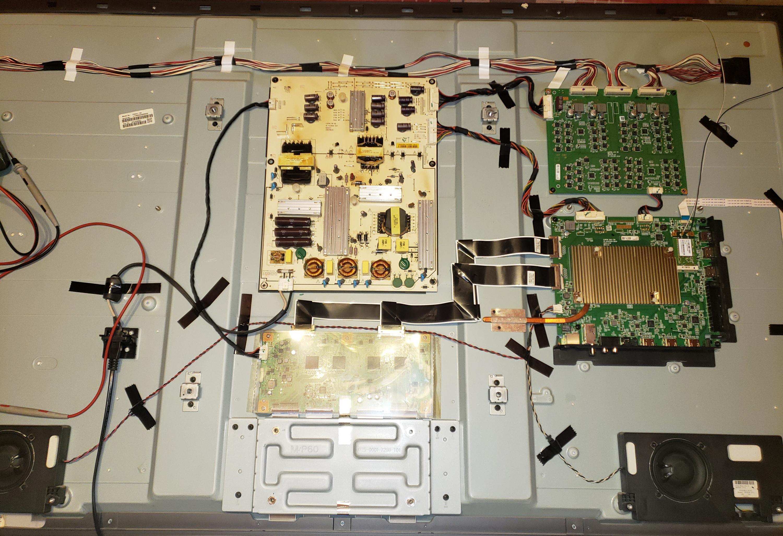

    Help is much appreciated as I don't have any experience with this model TV.

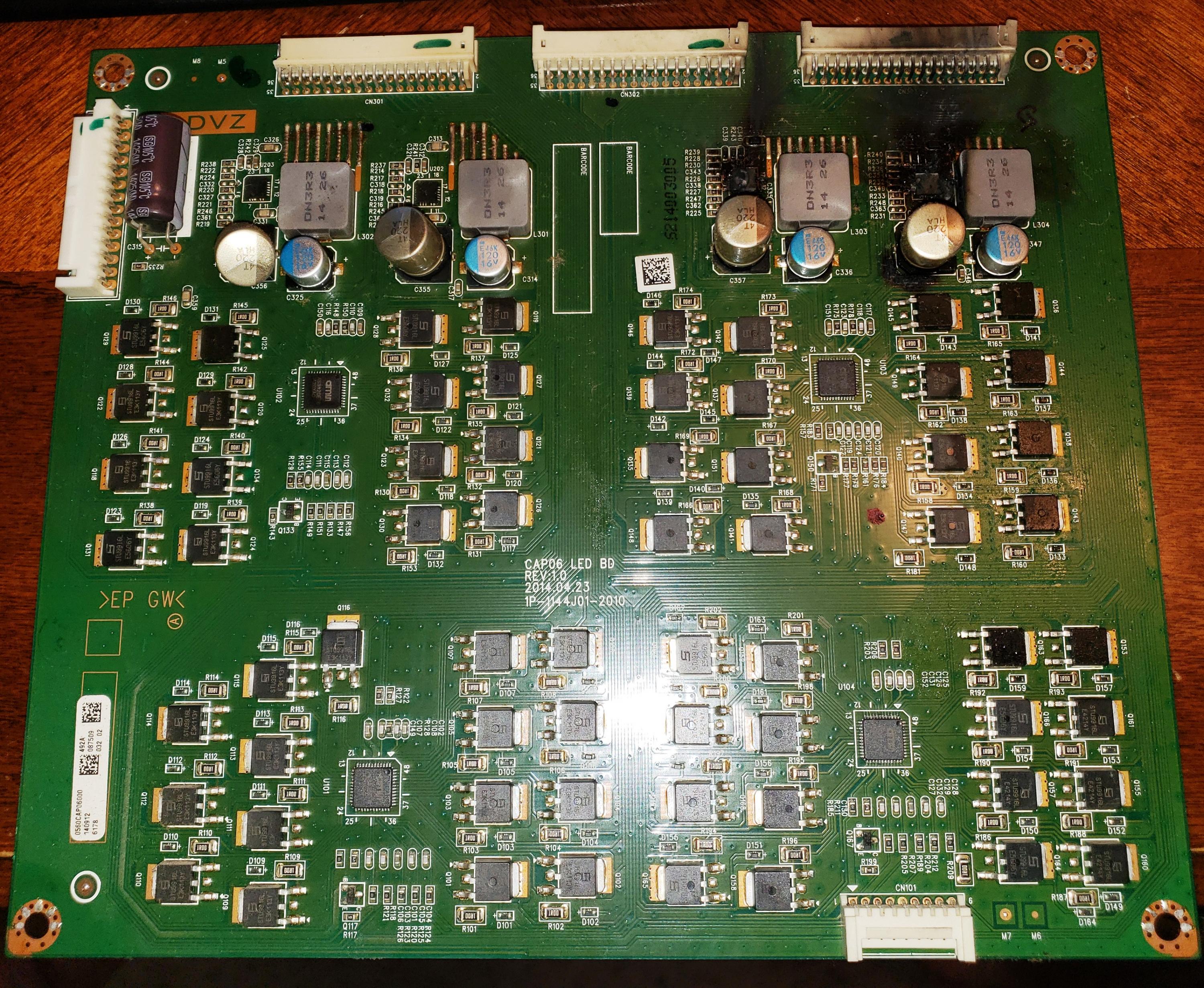

    Picked it up and it was smoking in the back when powered.
    Open opening the LED Driver board was charred (see last photo.)

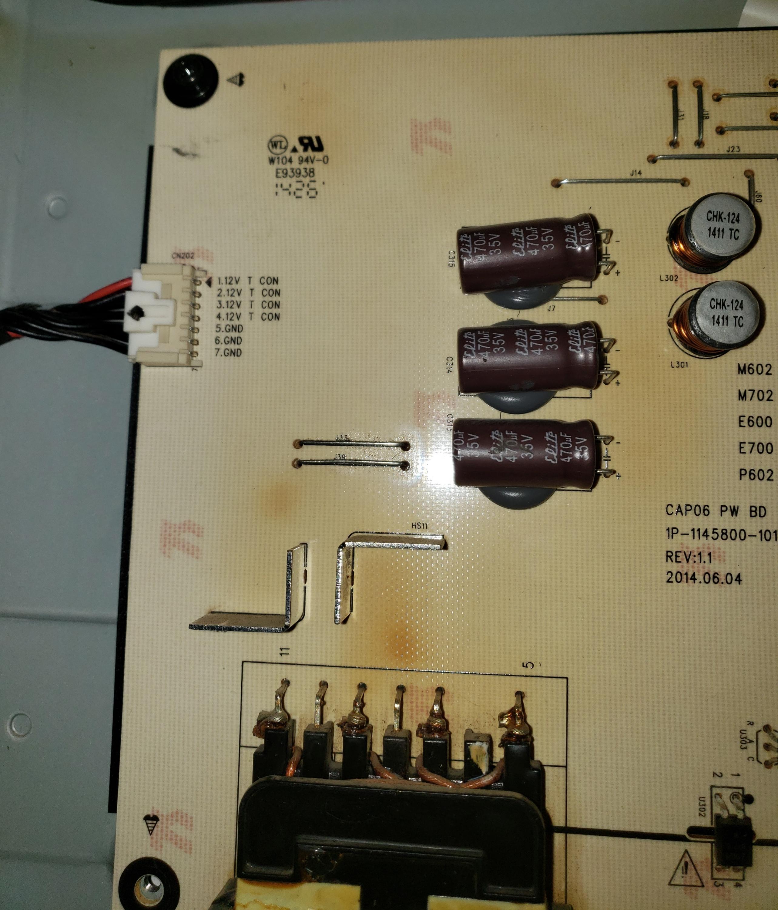

    I noticed some blown caps on the Power board as well.

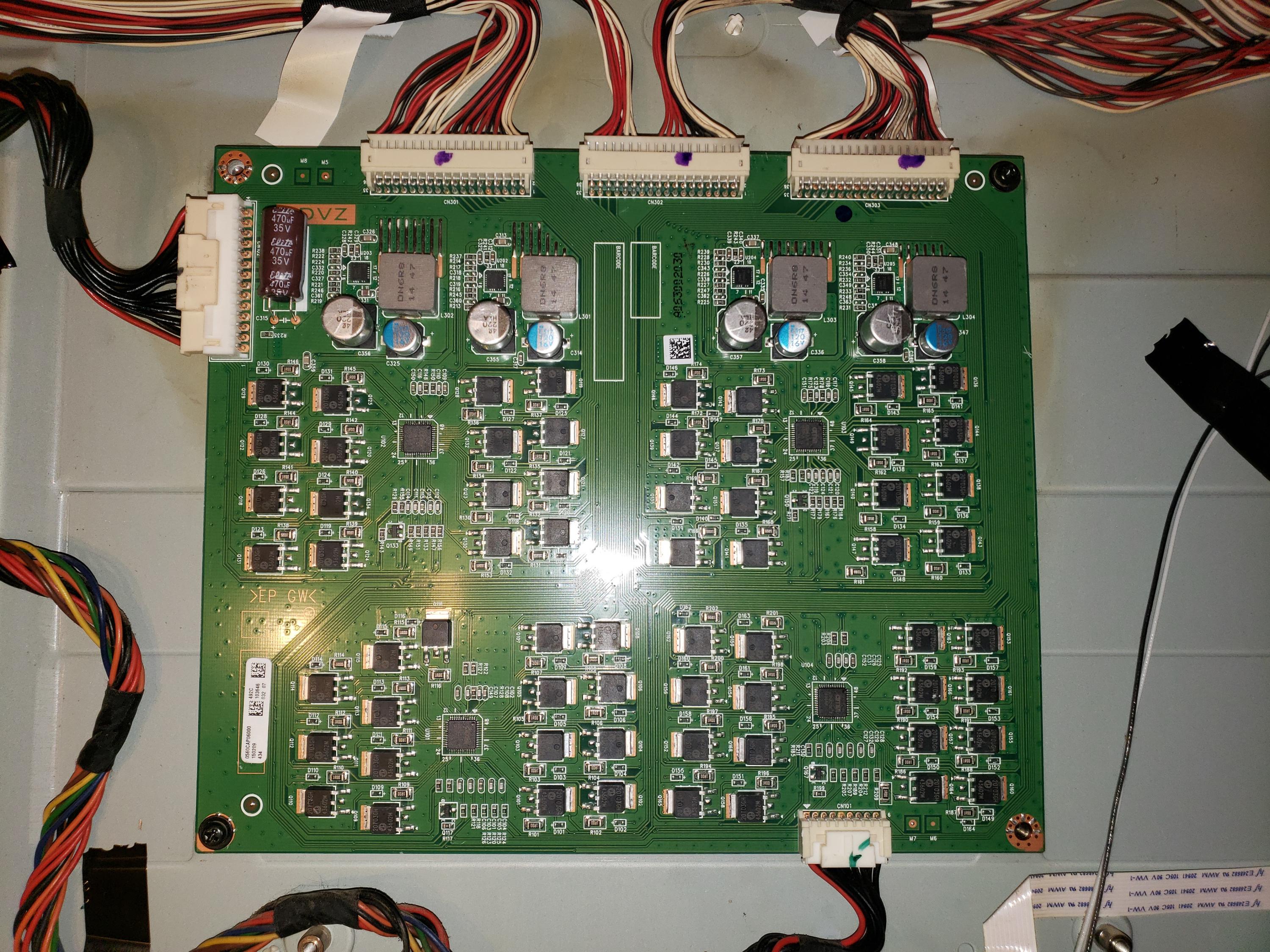

    Replaced the LED driver board, and bad caps on Power supply.
    Voltages on CN301 (upper power supply connector to LED driver board)
    X000017 - All 24.39V
    GND - 0.001
    OD - 0.015
    VSNS - 0.009 (does that imply bad backlight or bad LED Driver?)
    Voltages on CN201 (Lower power supply connector to main board)
    T CON_ON - 0 goes to 0.0019 when powered on
    12V TCON - 0 V
    +12VS - 12.53 V
    GND - 0.001
    12V-AU - 12.51 V
    PS-ON - 5.08 V
    AC-DET 3.8V
    On the Power supply connector (CN202) that goes to the TCON, I don't get any 12V for T CON. Should this be always present, or is turned on by the main board with T CON_ON (Pin 15 of CN201 that is currently almost 0V)?
    Any ideas where I go next? Not sure why TCON is not getting power. Main board is responsive to remote and push button.

    On your last photo you have two major burn ups that are highly likely the issue.
    https://tinyurl.com/y6phzbpz
    • jason123
      • Oct 2015
      • 1083
      Re: Vizio P602UI-B3 No Picture or Sound - No TCON Voltage
      Yes, the last picture is the LED driver card that was inside the TV when I got it.
      That was replaced as you see in the first photo.
