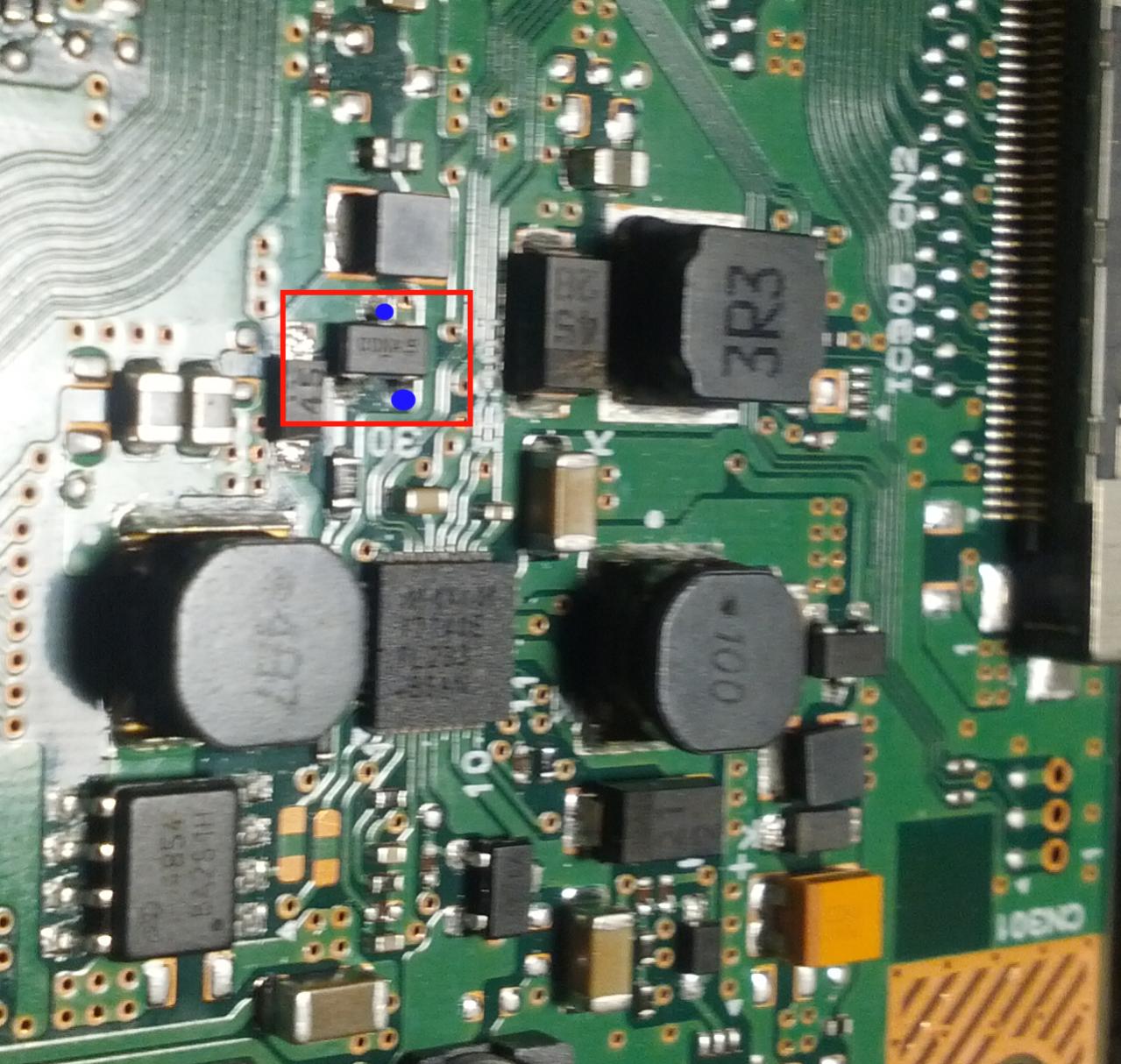

              #46
              Re: Vizio E701i-A3 no Picture
              Can anyone confirm NPN mosfet with the label COXA ? The only thing I have found is a CO5A 60v 5a npn. These short center pin to right pin on these tcons when the problem arises. Also I should note there is no power going to this transistor at all either.
                #47

                  #48
                  Sorry. I meant NPN transistor marking COXA. It's a 3 pin small smd SOT-23 casing

                      #50
                      Found the transistor and found a cross reference. Didn't do anything

                        #51

                          #52
                          Since there is a lot of folks reading this thread, maybe good if you could add a picture so others know what components you are talking about.

                            #53
                            This pic was posted earlier by another user. The one in red is the transistor that shorts. The other two SOT -23 style in the pic seem to go open.
