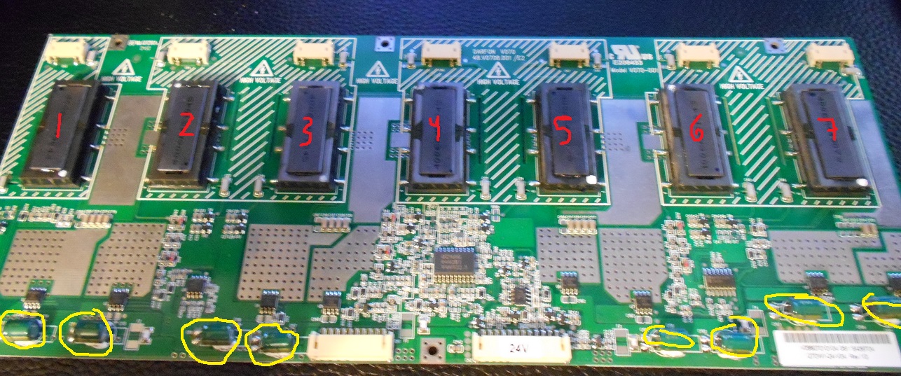

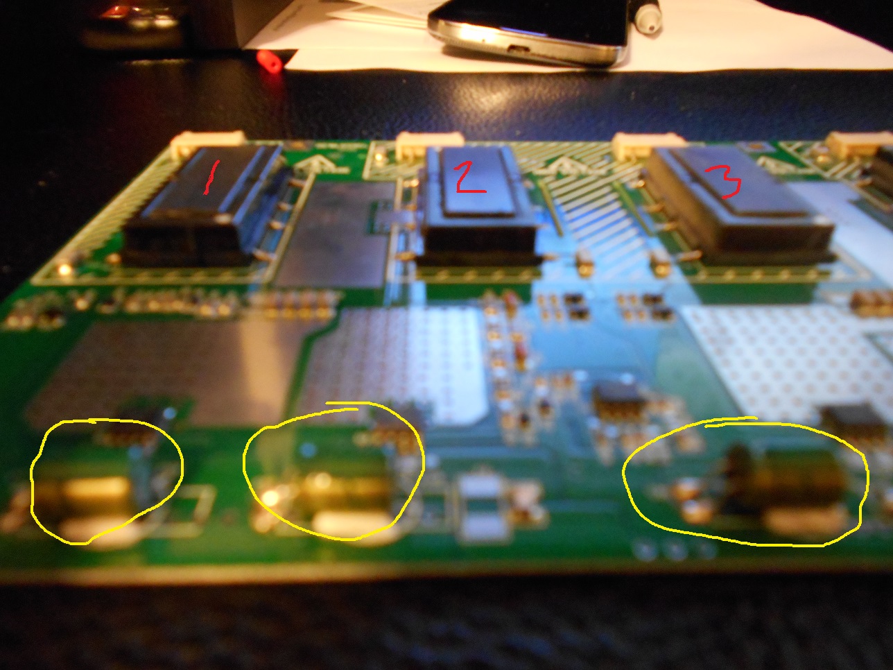

    So far I tested the inverter board's transformers with the below results:
    Trans#---Pins 1-8-----Pins 4-5
    1-----------0.969--------0.966
    2-----------0.959--------0.961
    3-----------0.982--------0.981
    4-----------0.986--------0.986
    5-----------0.975--------0.972
    6-----------0.967--------0.973
    7-----------0.959--------0.961
    Nothing is screaming out "IM BAD" here in relation to the transformers. I don't have a spare CCFL to test or a CCFL tester. The way this TV/Panel is setup makes it extremely hard to test as the inverter board is covered by the panel that the main board and PSU are on.

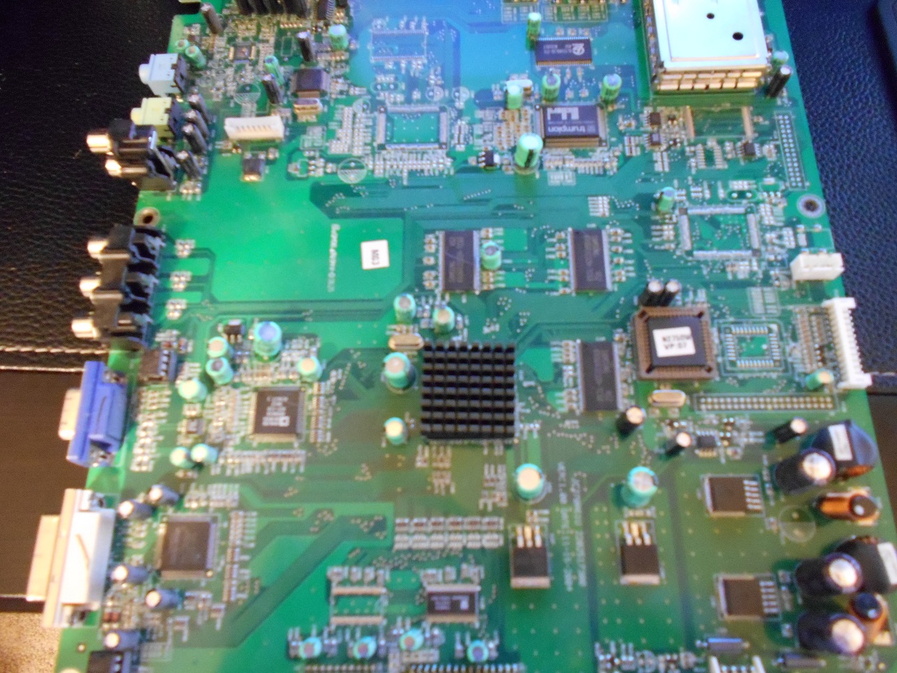

    Any more help on what needs to be tested let me know. Appreciate the help. Pictures are below.

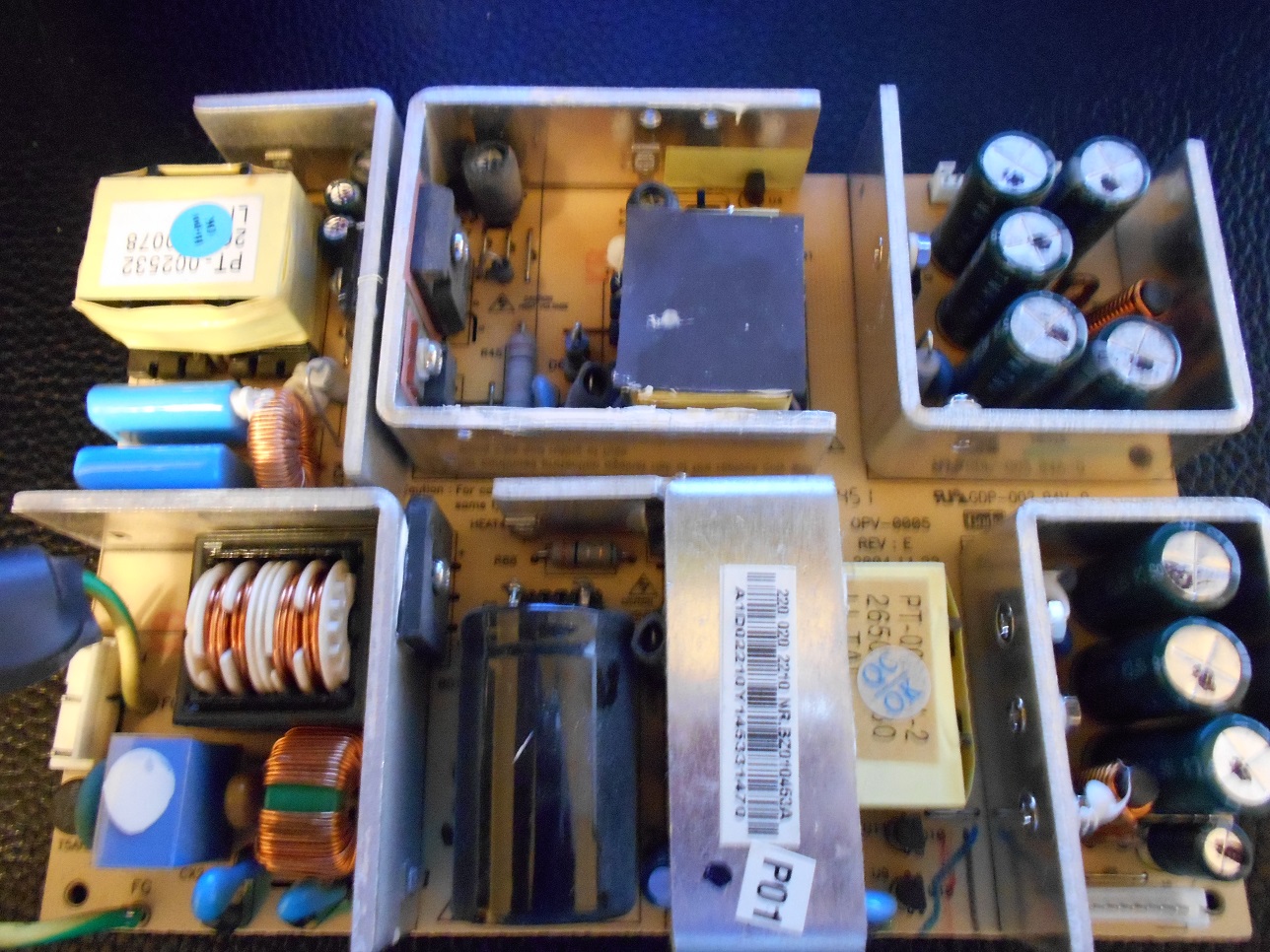

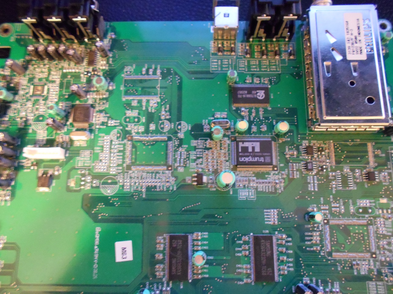

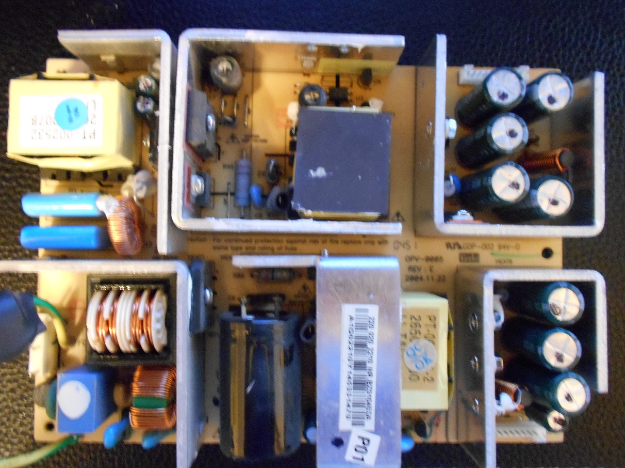

    Pics#1,2 = Inverter Board with transformers numbered in red and caps circled in yellow. Didnt test caps as I think they are in parrellel adn I have not removed.
    Pics#3,4 = Power Unit
    Pics#5,6 = Main Board

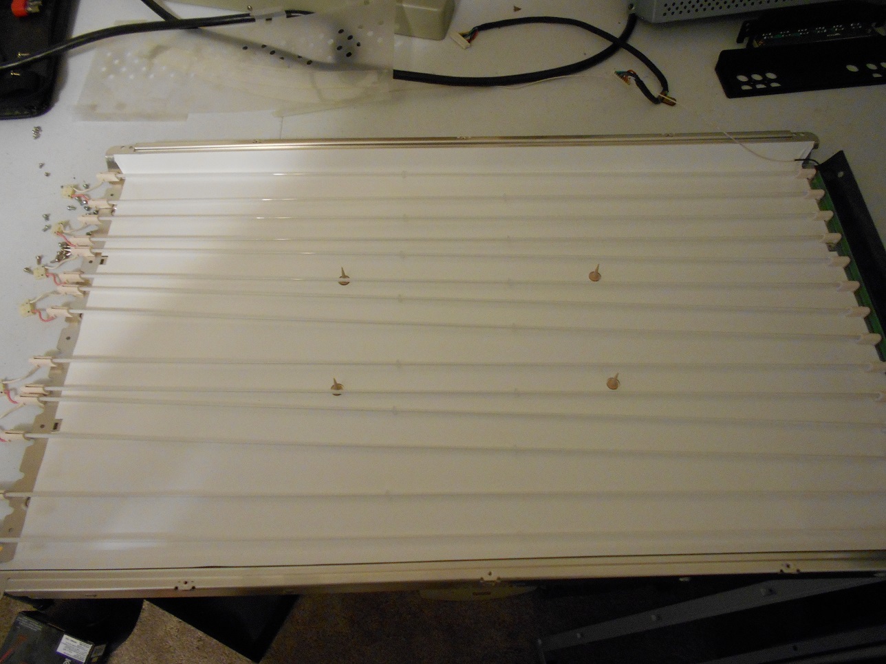

    Pic#7 = CCFLs

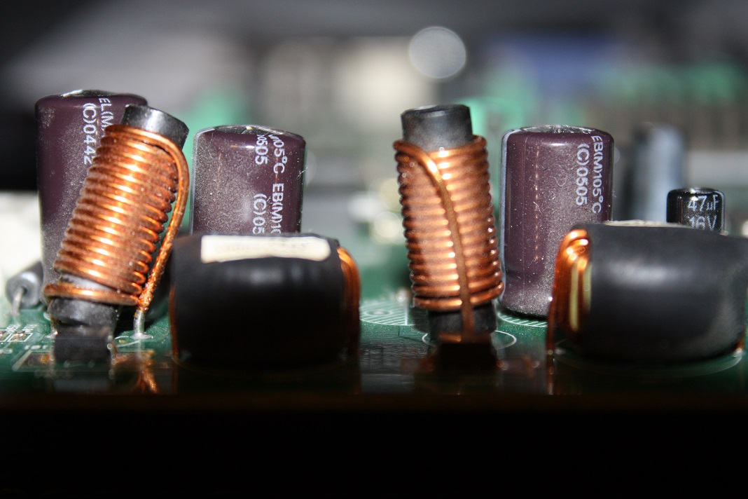

    After looking over the boards some more thinking that it cant be this hard I noticed three caps on the main board looking a little bloated.
    (2) Elite 1500uF 10V 105C
    (1) Elite 1000uF 16V 105C
    Survey says?

      Re: ViewSonic N2750W - 0 secs to black
      You did look at these pictures before uploading right? There should be some fuses on the inverter board, some are easy to spot and there is usually one that is very small and marked with a letter (fuse rating) that supplies the drive ic circuit.
      Yes those caps are bad.

          Pulled the caps out and tested.
          The 1500 uF caps tested around 450-600uF
          The 1000 uF cap tested around 200uF
          I looked on the inverter board for F fuses and the only ones I found are F1-4 but they are empty.

            Unfortunately the cap replacement did not solve the issue. I checked the output from the PSU to the inverter board and it read 23.06V. I'm going to guess it a CCFL or something with inverter board. Anyone have any ideas to check? I don't have any CFLs lying around either or a CCFL tester. I was thinking about buying one of those CCFL tester on eBay for $6 to check and to keep in my tool box for other projects.

              "I looked on the inverter board for F fuses and the only ones I found are F1-4 but they are empty" They are not empty, there two footprints for two sizes of the fuses, next to the empty pads are white fuses, as you can see some of them has '3' printed on top to indicate 3A fuse which is also printed on the board.
              http://www.shopjimmy.com/media/catal...40.027-top.jpg
              http://www.shopjimmy.com/media/catal...j27d000703.jpg

                  Ahh I see what you mean. Whats the best way to check fuses, continuity? Forgive me if my questions are rather simple. Im in no way a electronics person but rather a network/voice engineer, lol.

                    Fuses - No power to board you are testing - set meter on ohms 200
                    one probe to each side of fuse - should be same as touching the probes together.

                      Im going to go ahead and say that 3/4 fuses are shot. Im going to replace all 4 though since I am already in there. What kind of fuse would that be? There are no markings on it except the amperage rating.

                            Are you absolutely sure the fuses are open. You did not actually give the result of the test.
                            It would possibly have a "1" on the left of the meter or "OL" or whatever your meter shows when the probes are apart. (obviously with the meter on)
                            First easy check would be the caps - just to see if they are shorted
                            Perhaps post pictures of the inverter in 3 sections close up for us to inspect better.

                              Meter reads 0 when leads are apart
                              Meter reads .1 Ohms with leads together
                              Meter reads .1 Ohms testing "good" fuse
                              Meter reads 0 or bounces around and eventually ends back at 0 on "bad" fuses
                              Nothing on back.
