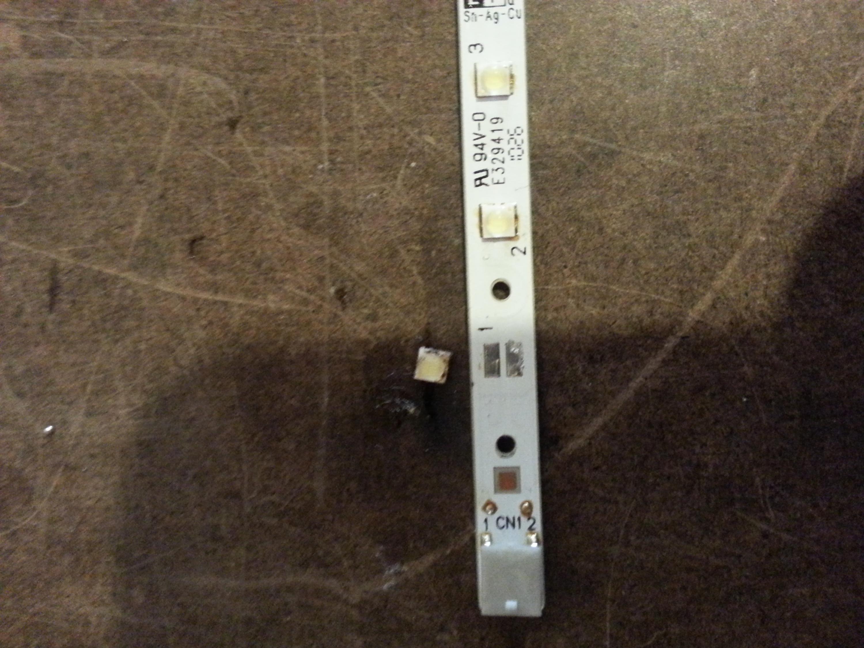

    I was just given this set because it had been reported irreparable. So of course being a DIY'er I want to repair it! I have read a couple of threads dealing with this set, and have already tried the error code reset using the vol- and ch+ while plugging set in, I have also tried input, vol- and ch+ but neither of those techniques work for me. The problem I have is the short blink, long blink error. I am fully prepared to take this set apart to the barebones and attempt to test the led's contained within. But I need help doing this, what do i need to test with? Will this do:

        error code is 1-1 tv doesnt power on. I have taken apart all the way down to the screen and have tested the LED's found the bad one and removed it. Now is there a diode i need to replace it with? or an original led available somewhere?

                  Ok no one answered my question. What should I do to replace the bad led? Do I bridge led location 1 with led location 3 because the polarity is the same? Do I replace led with diode? What do I do at this point? I would like to get the screen back together and out of the way. Lets just assume main and power board are good.

                    If you are unable to get a replacement LED_-then jump it with a 1N4004 or so diode--to take up the drop in the series string. Make SURE of proper polarity--and put the anode of the diode--on the positive side of the string's supply line. If all other LED's work ok after that is is NOT likely--the missing LED will be noticed much--if at all.

                        Also from what I have read here, I calculate that every led takes about 3.??? volts. The diode you suggested is only 1.1v will this be ok? Also does anyone know where I can get one of these from in the states. I found the smd kind on ebay but nowhere in the states. I checked digikey and mats and found nothing.

                          You can't find a LED like that on Digikey?
                            Re: Sharp LC-60LE810UN
                            You will need at least 4 or 5 1N4xxxx connected in series to simulate white LED Vf of about 3~4V range.

                                  Ok I have ordered this led and am waiting for it to come in:
                                  http://www.digikey.com/product-detai...8-1-ND/4814765
                                  Im thinking that this should work because it is 3.8v
                                    It is also rated at 700mA which is good, so let us know how it works out.

                                        thats a generic 3535 mid power at 7500-8000k.
                                        the one you linked may or may not fit the pads.color temp will be pure white on the one you linked.7500+ k will look strongly to the bluish-purplish side.and it may or may not be noticeable for one led being off tint.but if it sits right on the pads it will work.
