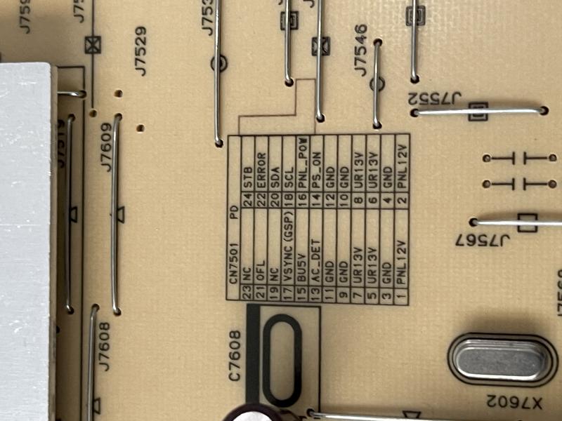

    did some voltage measurement on the power supply out.
    Pin 1 and 2 = 0V --> PNL 12V
    Pin 3 and 4 = 0 V --> GND
    Pin 5 to 8 = 13V --> UR 13V
    Pin 9 to 12 = 0 V --> GND
    PIN 13 = 3.24 V --> AC_DET
    Pin 14 = 3.01V --> PS_ON
    Pin 15 = 5.04V --> BU5V
    Pin 16 = 0V --> PNL_POW
    Pin 17 to 21 = 0V
    Pin 22 = 3.24 = ERROR
    Pin 23 = 0V
    Pin 24 = 0V

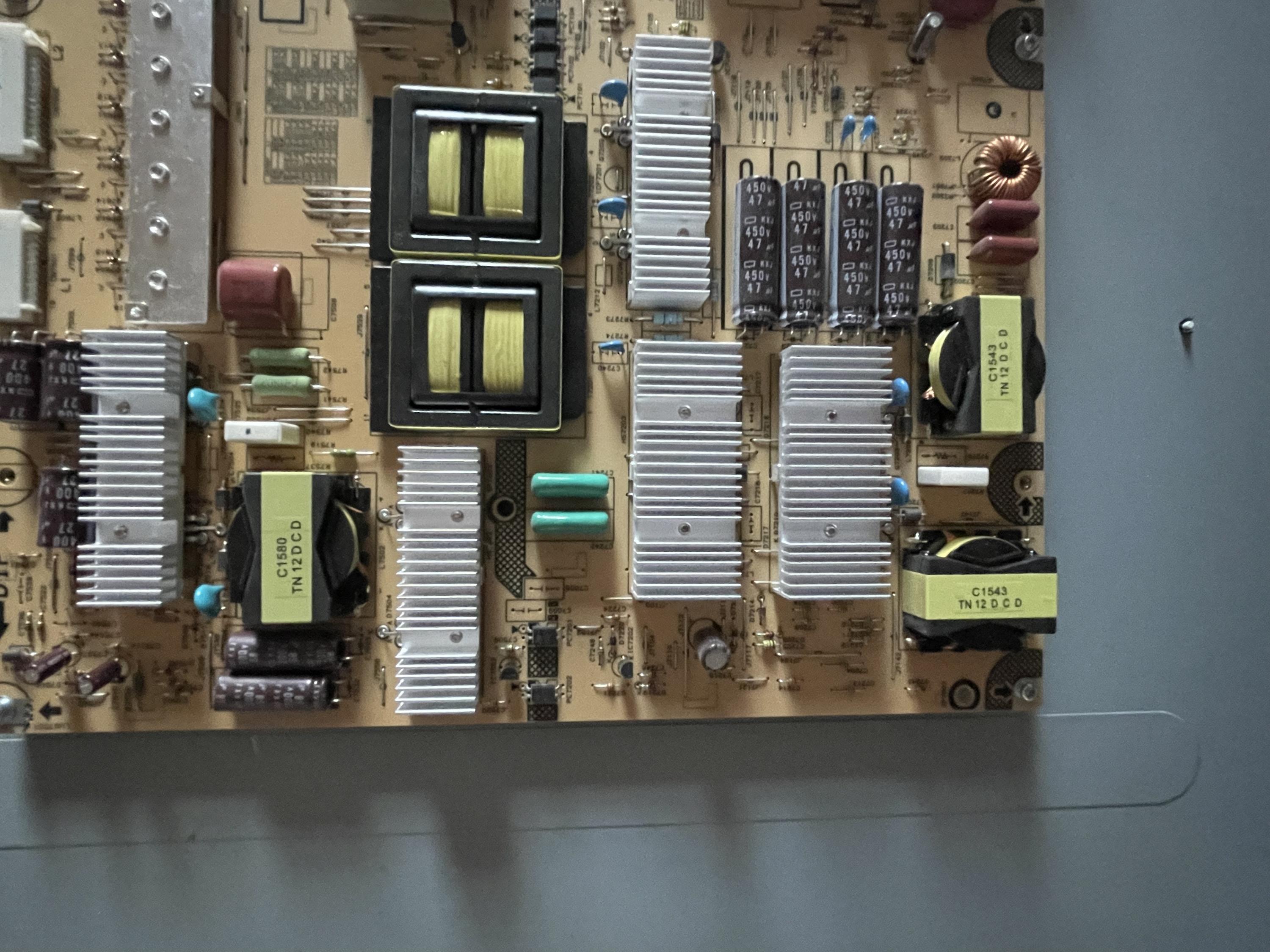

    Attached are some pics of the the power supply
    please and thank you in advance.

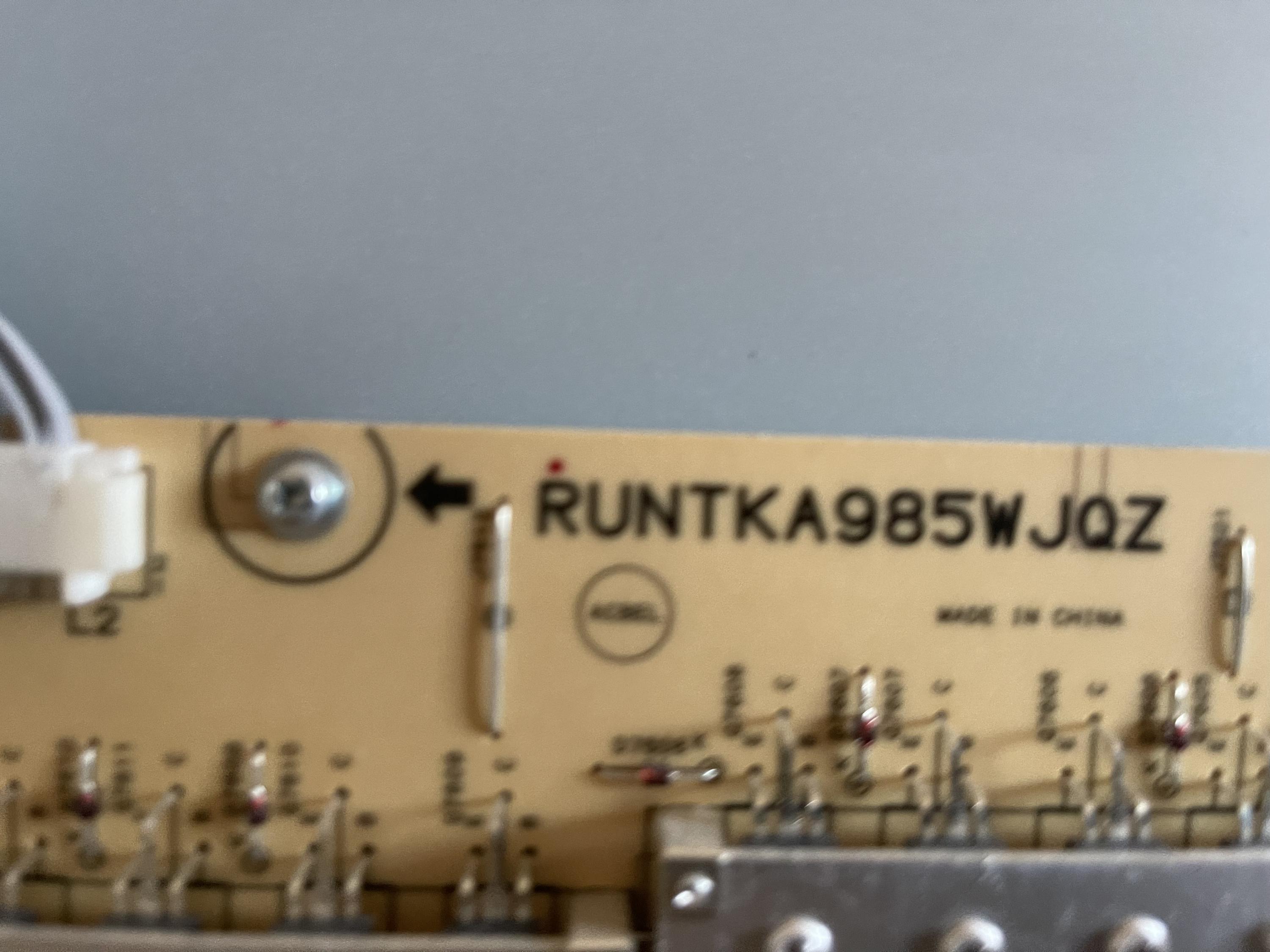

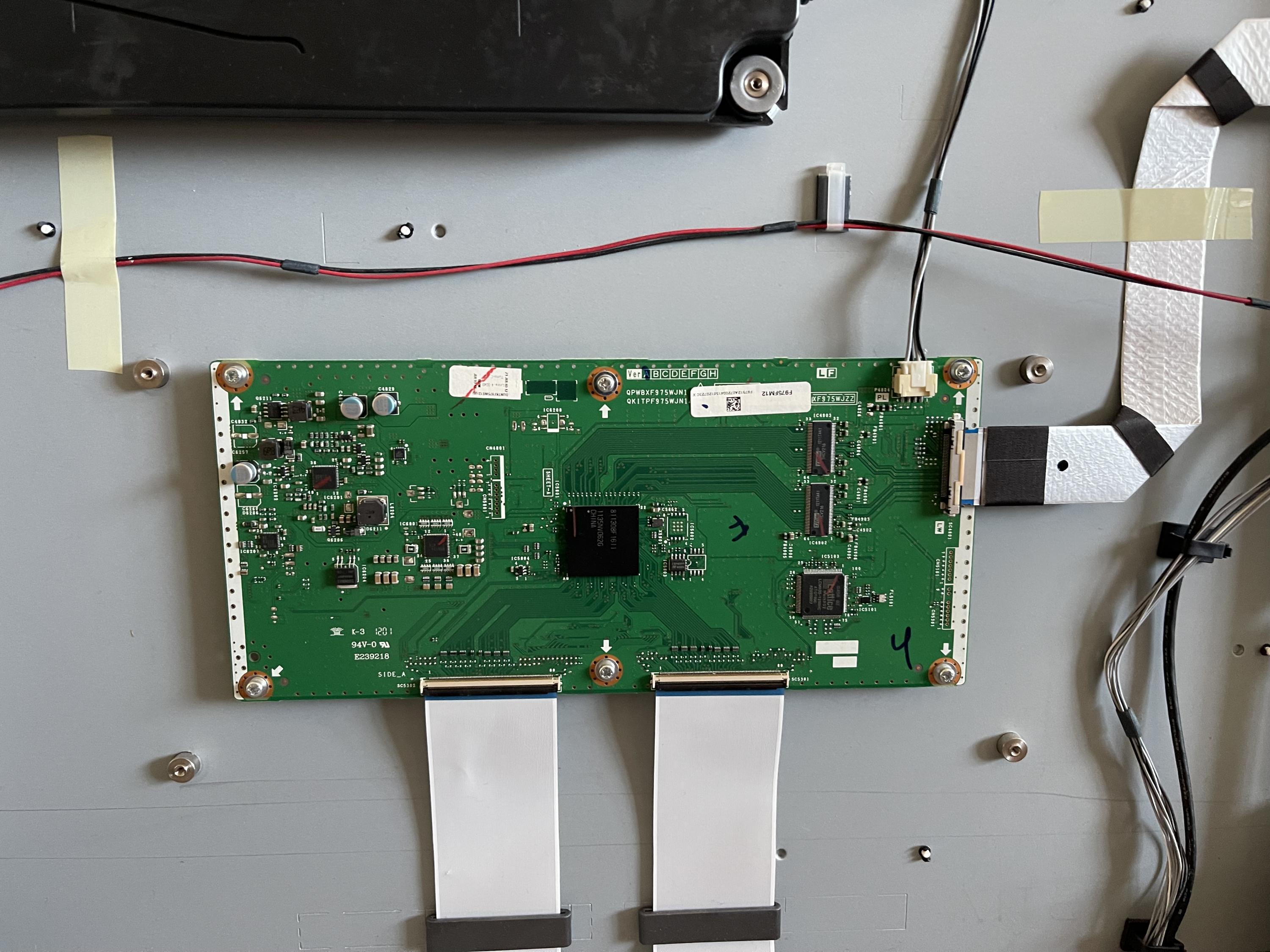

                    Re: Sharp LC-90LE745U 3 slow and 1 fast Blink

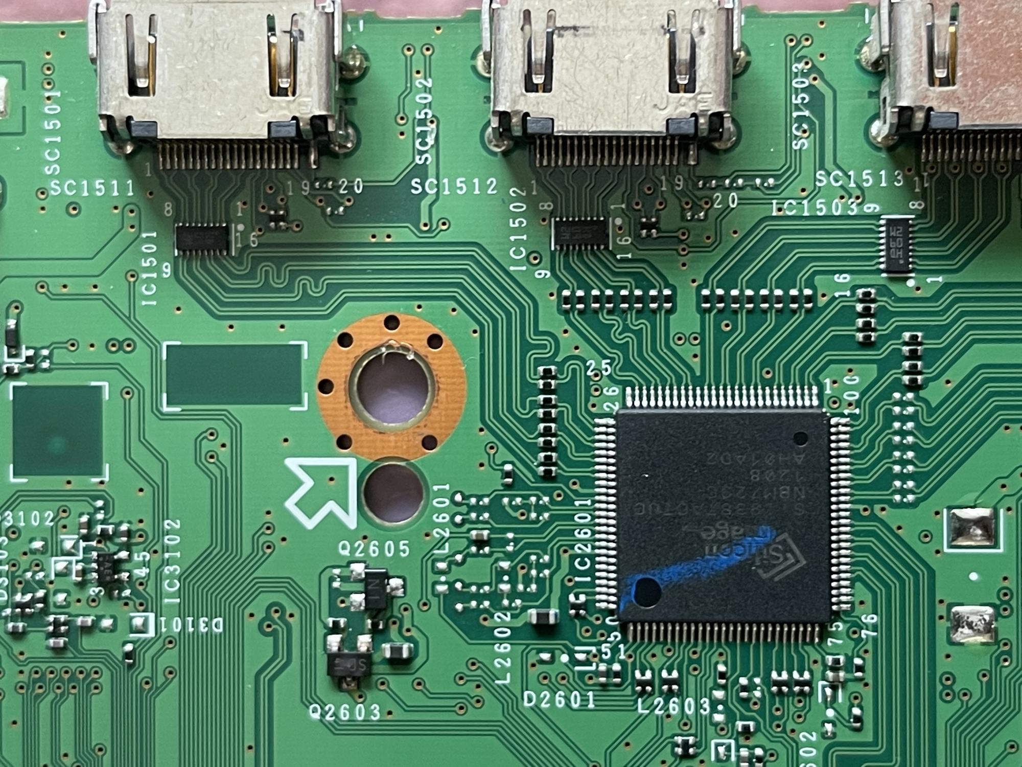

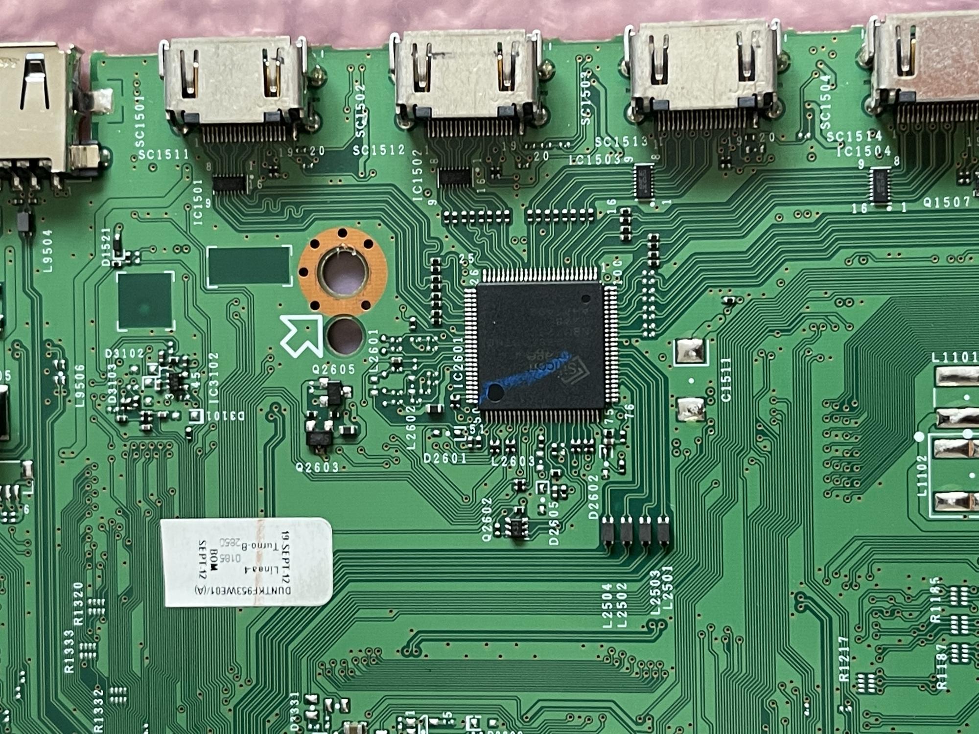

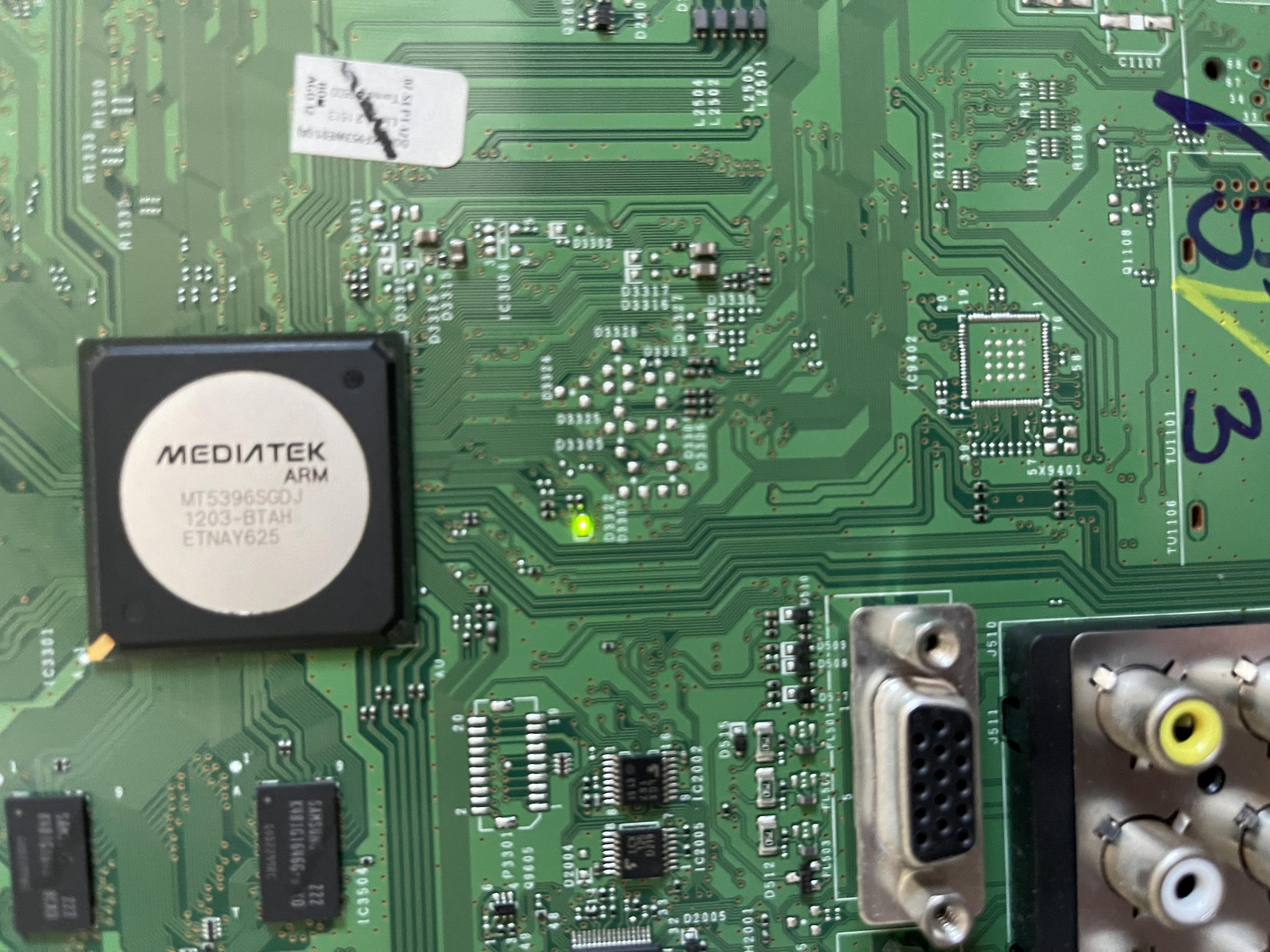

                    Here's the pic of the main board and the area of the component that is getting hot. It seems that area is responsible for the HDMI out area.
                    Will take the pic of the whole setup when I open it up again next week.

                          It looks like Q2603 supplies power to IC 2601. It is labeled to have 3.3V on the emitter and 3.2V on the collector as seen on the schematic on page 14 of the service manual - attached as zip file. Perhaps the HDMI chip is blown loading it and also causing the low ohm readings. The real test would be to check the voltages.
                          Hopefully, this is encouraging and you just got a bad board to replace your bad board, and the new one in the mail might work.

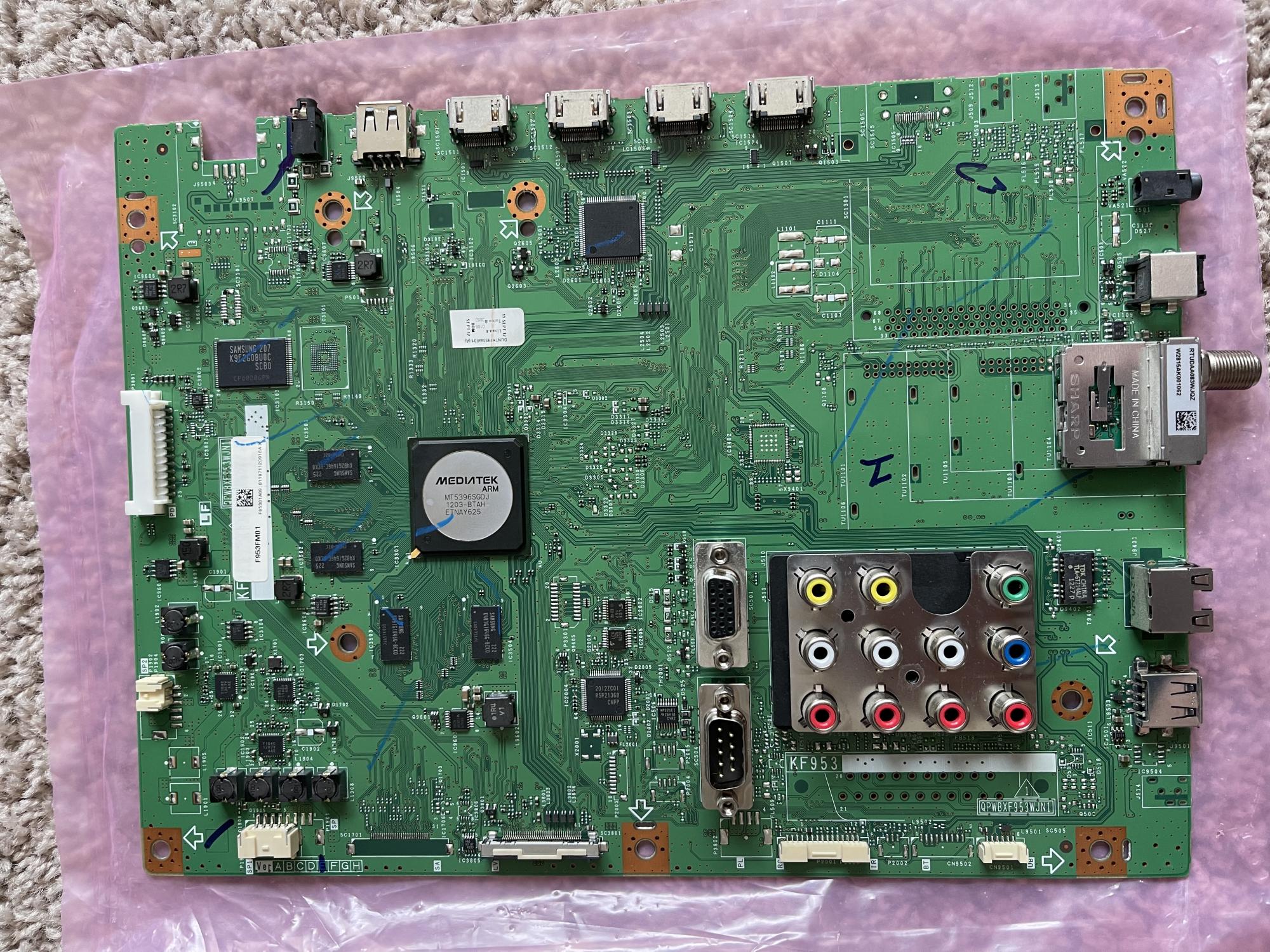

                                    Got the board today. Just got it installed, I saw the main board led blink 1 once. The screen flashed and got a new error code . 1 fast and 1 slow.
                                    I will try to open the whole back and get the voltage measurement as suggested. This TV has lots of screws hahaha

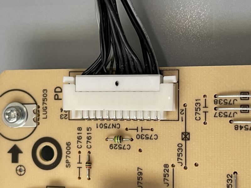

                                      Connector to Main board
                                      1-2 0V
                                      5-8 13.05V
                                      13 - 3.04V
                                      14 - 4V
                                      15 5.04V
                                      rest are 0V

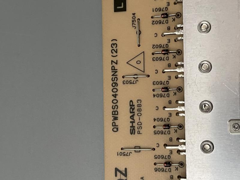

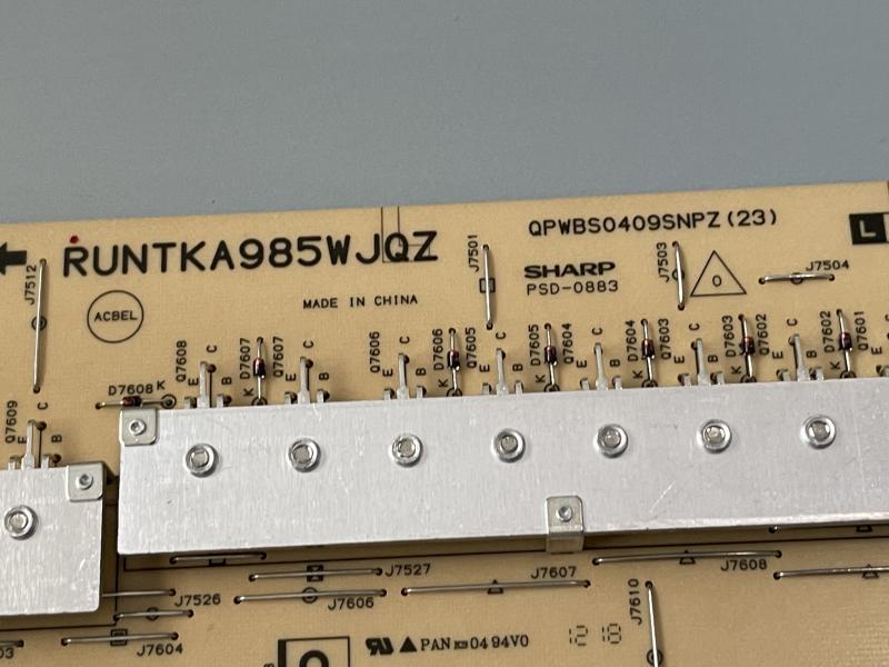

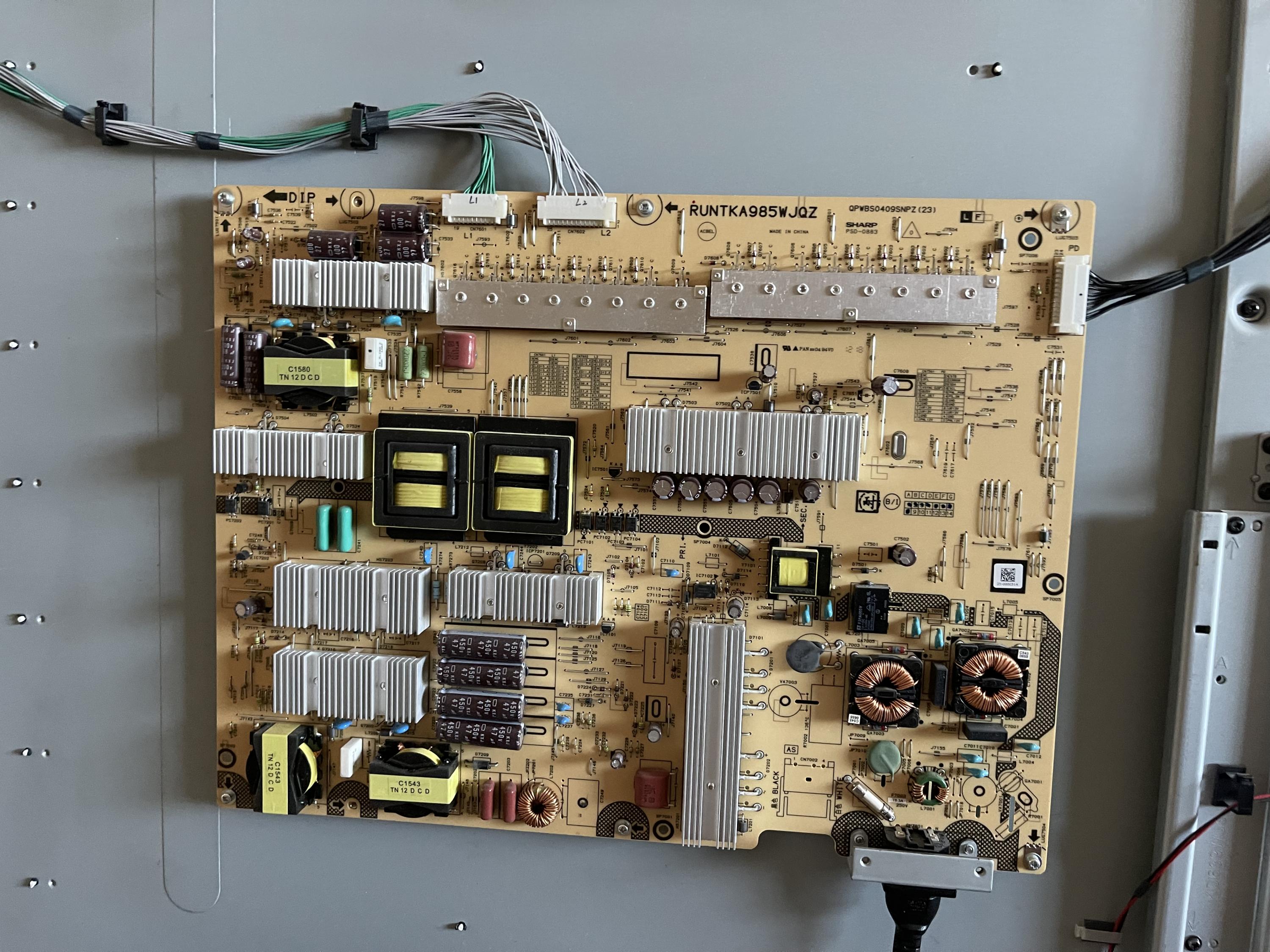

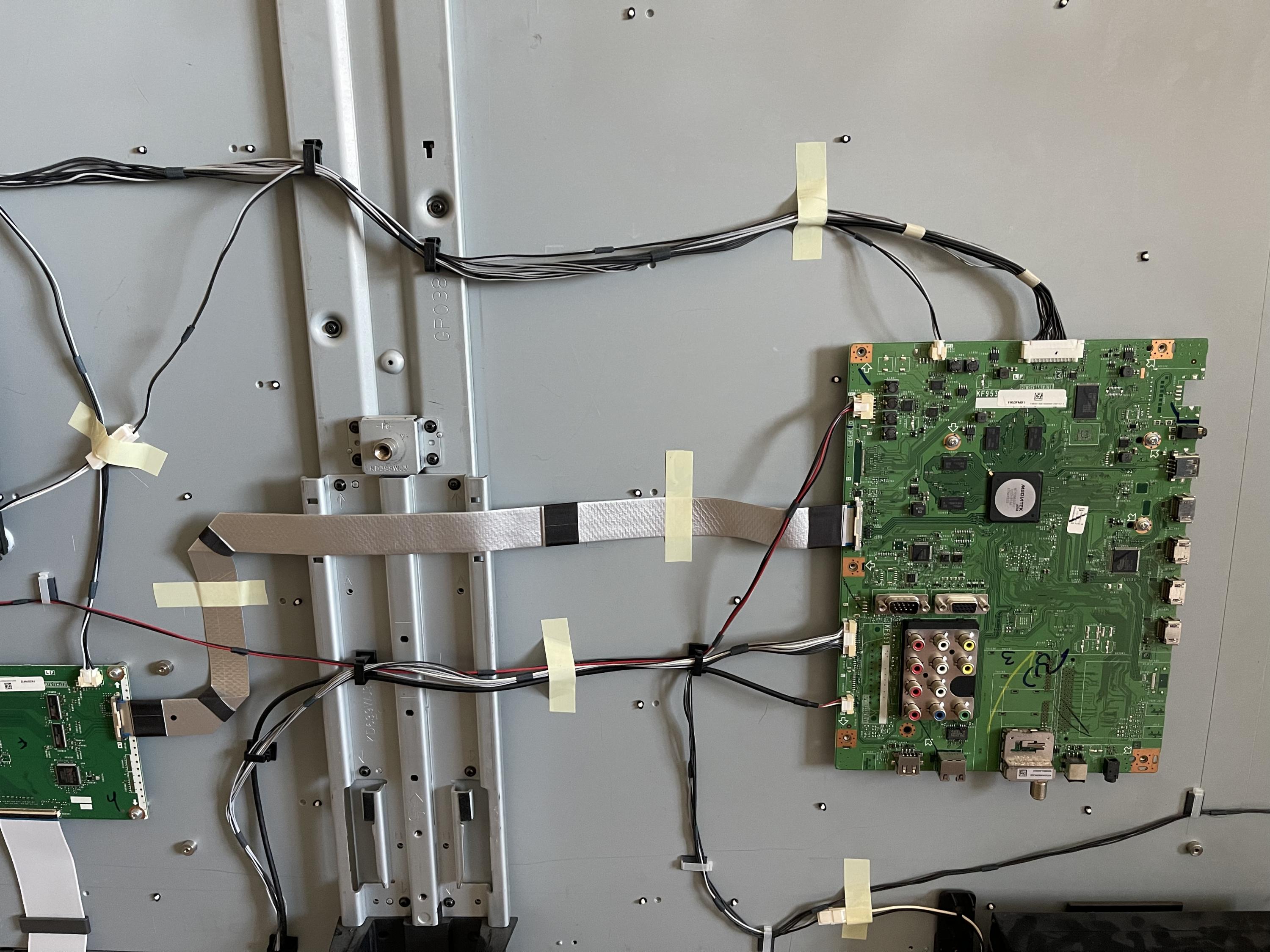

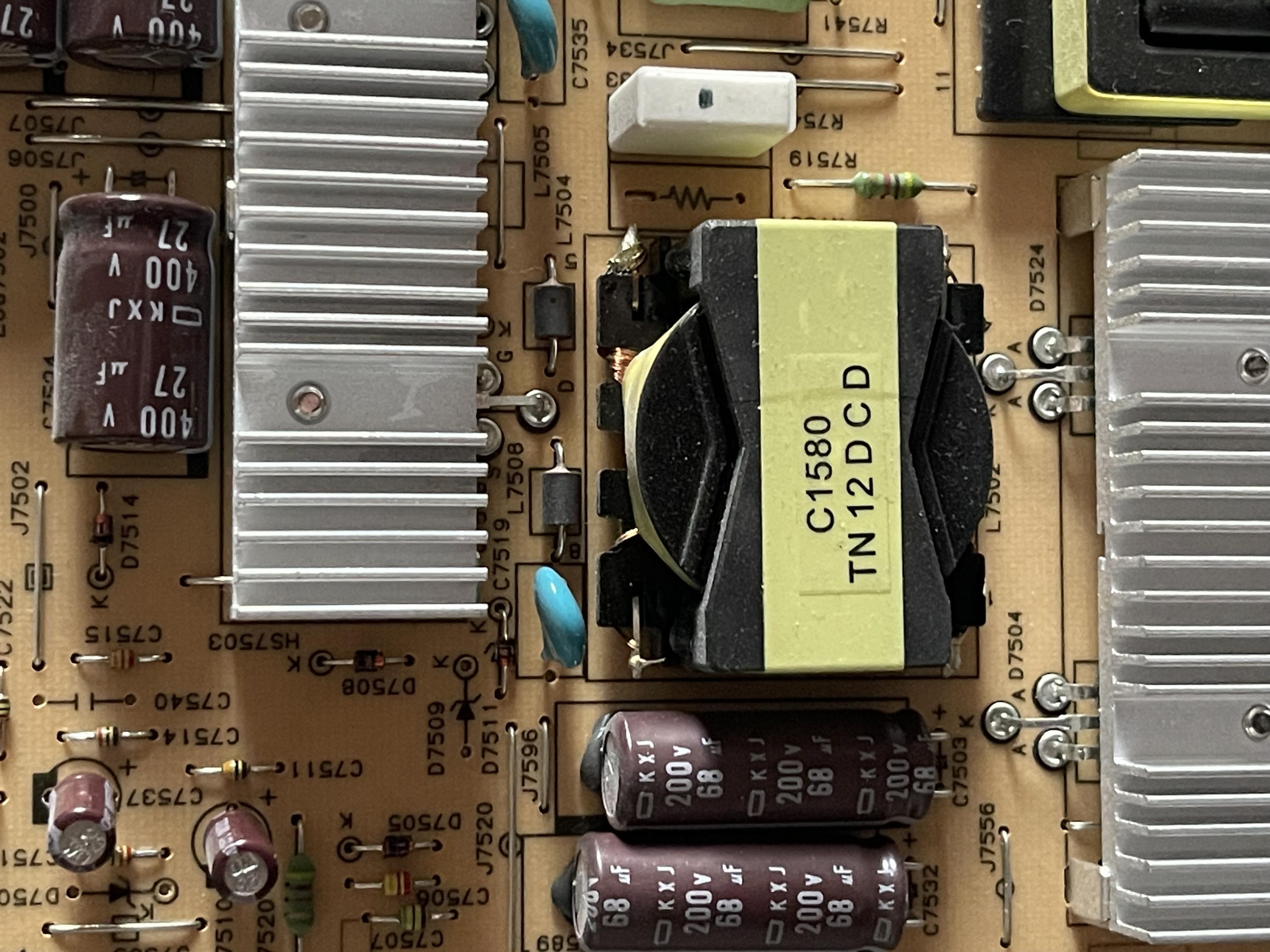

                                        Here are the pics of the board and connection. can't take the whole back as it's standing in the hallway and can't back out more hahaha :P
                                        so it seems if we force it to boot up (Channel down and Volume UP), the TV works, can power off/on, change input, access menu etc. as long as we dont unplug it, it will work.
                                        if we unplug it, then replug, it goes to the 1 slow 1 fast blink. the only way we can make it work is to do the force boot up when plugging in.

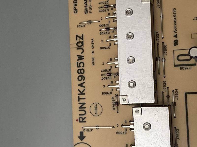

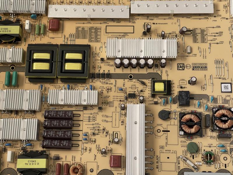

                                        Also anyone has a schematic of the power supply? I'm measuring 0 Ohms on D7511 and D7508 (not sure if there's a coil parallel to it LOL haven't done the soldering removal yet).
                                        for the L7502 (C1580) is that a transformer? I'm assuming it should be 0 ohms since it's a transformer? I compared the measurement on the bottom 2 C1543 and i'm getting 0 Ohms if measured on both ends of the terminal..
                                        only if we have some schematics on this power supply so it's would be a bit easier to follow LOL
                                        let me know
