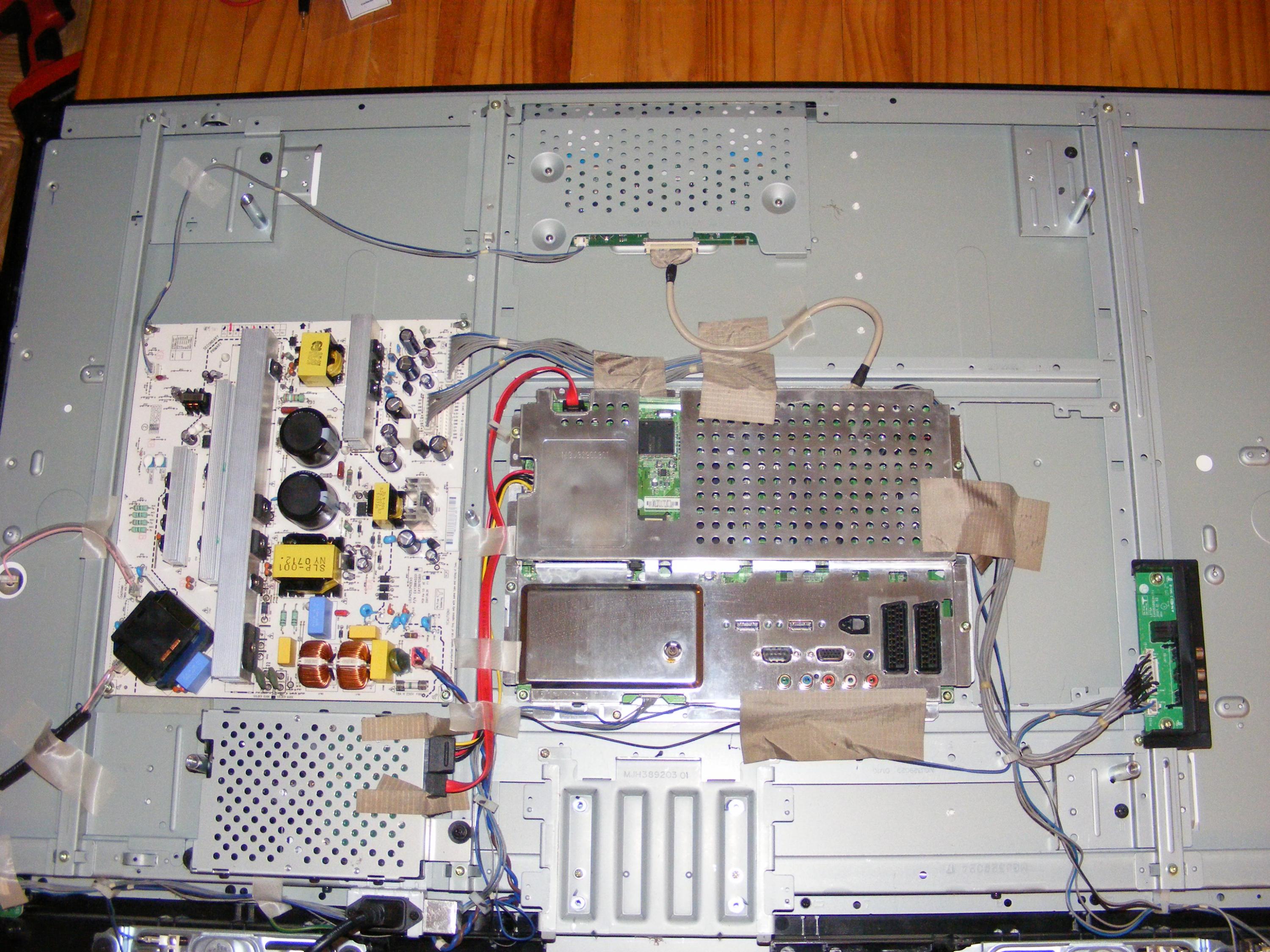

    LG 42LT75 no backlight

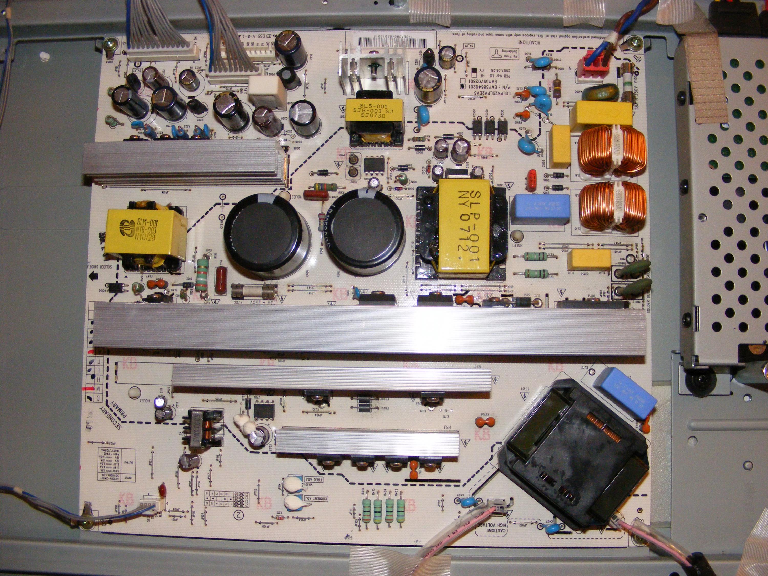

    I have this LG TV open right now. Interesting TV - it has a built-in SATA hard drive for recording and pausing TV.
    It turns on and boots up, but there's no backlights. Not even a flash. The caps all looked and tested fine but I replaced the usual troublesome ones with Panasonics anyway. Voltages all look pretty close to what they should be.
    PSU is LGLP42SLPV2EV3 / EAY38640201
    The inverter is integrated on the PSU with just one inverter transformer. The inverter uses a OZ9925GN controller ic.
    ACD: 5.1V
    PWR: 1V
    ST 5V: 5V
    INV-CTRL: 4.6V
    ERROR: 0V
    BURST-DIM: 0.6V
    A-DIM: 0V
    6.5V: 6.4V
    3.4V ON: 1.4V
    19V: 20.3V
    3.4V: 3.4V
    12V: 12.1V
    I've read a lot of threads on it but I'm still not sure of the best way to test inverter outputs. Can I test this inverter with a CCFL as in this thread: https://www.badcaps.net/forum/showthread.php?t=19987 and if so, do I connect one end to each of the connectors where the pink wires plug in?
    Any other tests I can do? I am planning to break the TV down more to look at the bulbs and connections but would like to rule out the PSU/Inverter before going further.
    Thanks!

            Heres a couple of hints.

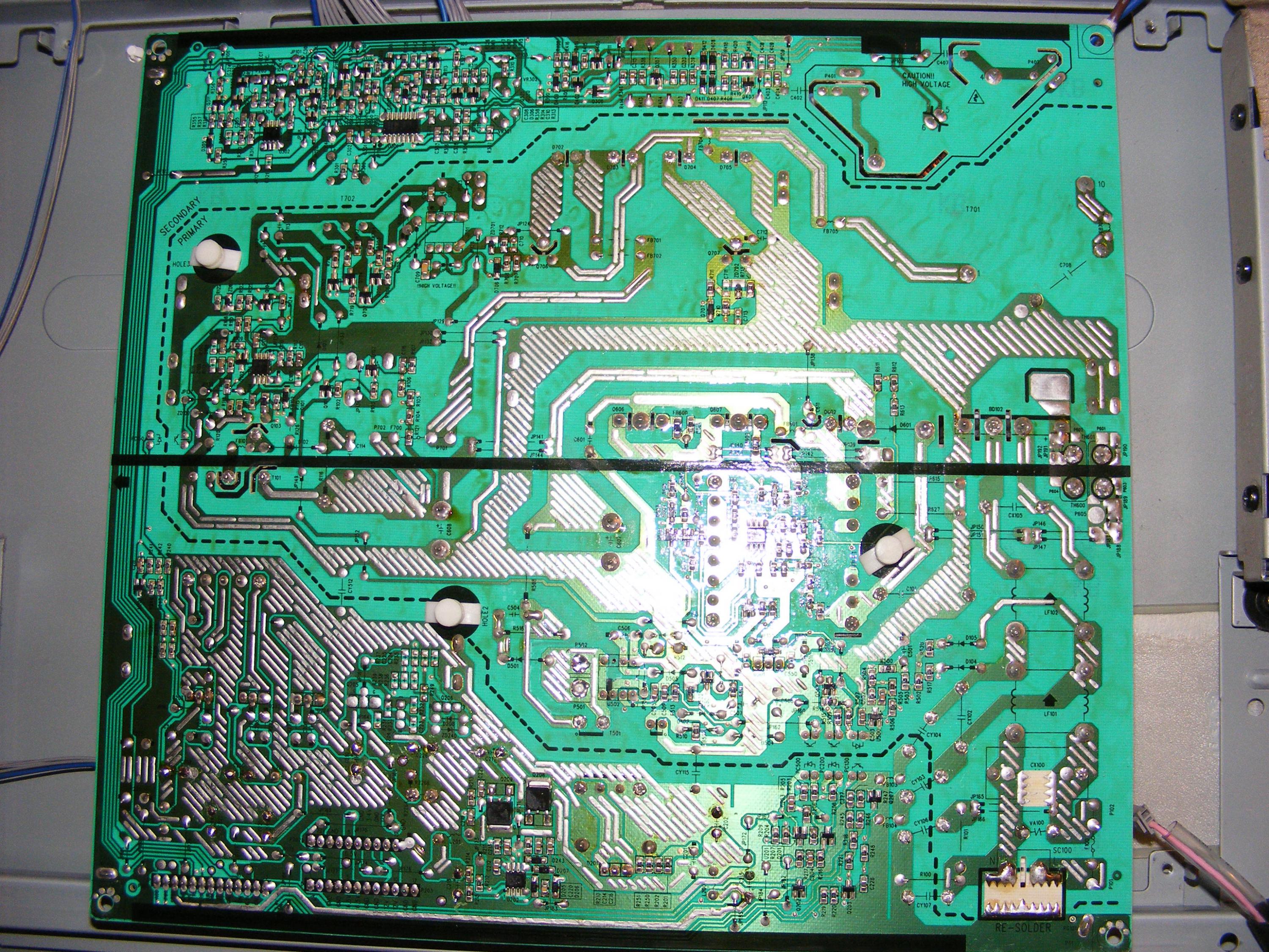

            1Get a domestic cfl (NOT ccfl) 13 watt or less and solder an insulated wire to the centre contact.
            You need a bare bit at the end. With the board on you just touch the bare end of the wire to output pins on the inverter transformer ( which does actually look burnt) and the bulb should glow. You need to take care as it could be 2000vac.
            2 if you look closely at the back of the board there are some solder joints that dont look great down that side. I would re-flow them ( but see 3)
            3 As the inverter transformer doesnt have many pins you could try swapping them or at least the known good one.
            4 You could test the secondary winding resistances or even all of them on the two transformers. Is there a part number on it?

                Thanks selldoor and stj. That does give me something to go on.
                I checked the transformer resistances and I get the same readings on both boards so assumed the transformer was good. I'll look into the other suggestions tomorrow when I get back to it.
                Thanks again!
                  Re: LG 42LT75 no backlight
                  Check the FUSE F700 and the capacitance of that blue rectangular cap C708 by the inverter transformer.

                    budm: F700 is good. C708 is 1012nF on the good board and 980nF on the bad one. Is that enough of a difference to cause a problem?
                    selldoor: The only CFL I have to hand is 20W which did nothing on either board, but.. I swapped the transformers over as you suggested and it made no difference to which board worked and which didn't, so I think the transformer is ok.
                    stj: I didn't have all the capacitor values to hand for those smaller ones but just tested them out of circuit for capacitance and ESR and all test within tolerance.

                      The bulb trick might only work for an instant when the board is switched on but before it goes into protection mode.
                      Did you reflow the other joints - moving the transformer would fix those ones. You could
                      also swap the C708 to see. If they are meant to be 1000nF it depends on the tolerance
                      if it is +-20% then they are well within. Is there anywhere where it suggests there is a
                      blon pin on the connector from the main board?

                        OK, the fuse F700 which is for feeding the B+ from the two large main filter caps to the backlights inverter circuits, now we need to find out if you do have 360~400VDC between the F700 and the negative leg of the main filter cap.
                          selldoor
                          You're right. I got the CFL to light with the working board. Nothing with the non-working one. I reflowed the other joints you suggested and also tried swapping C708 between the boards. No change so far. There is a INV CTRL pin which I have been using to force on the inverter circuits.
                          budm
                          I'm reading 397V between F700 and the negative lead of the main filter cap.

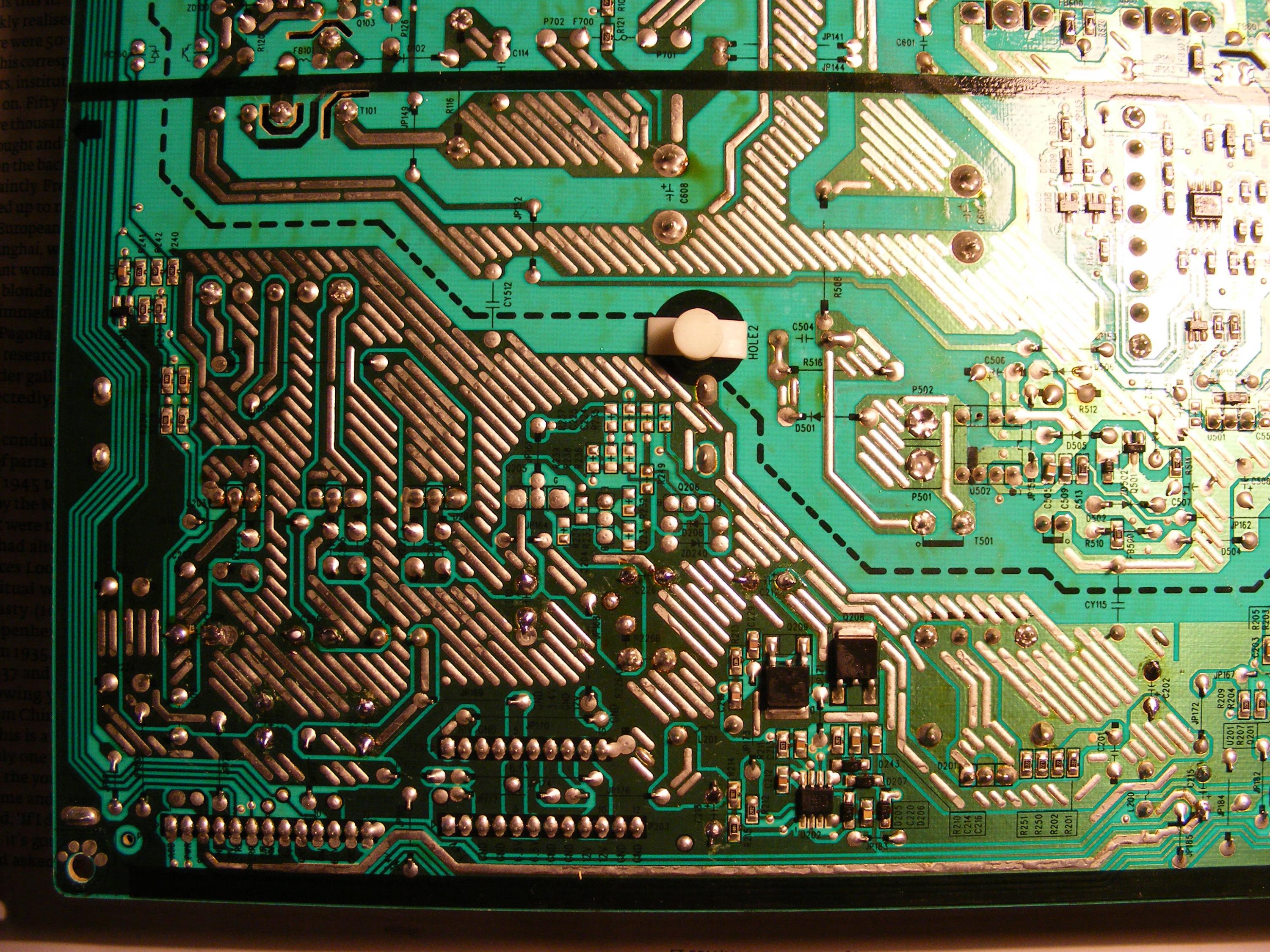

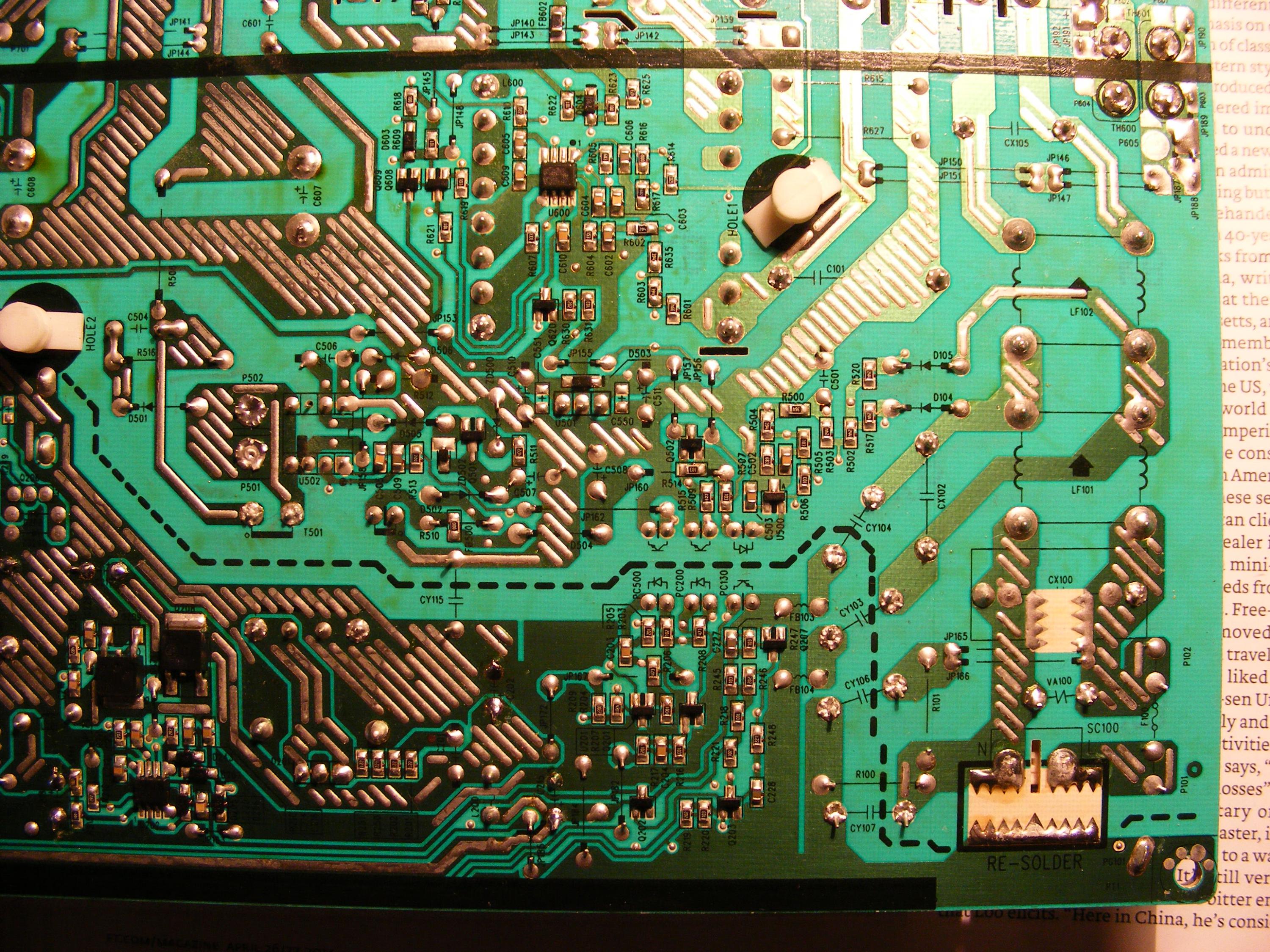

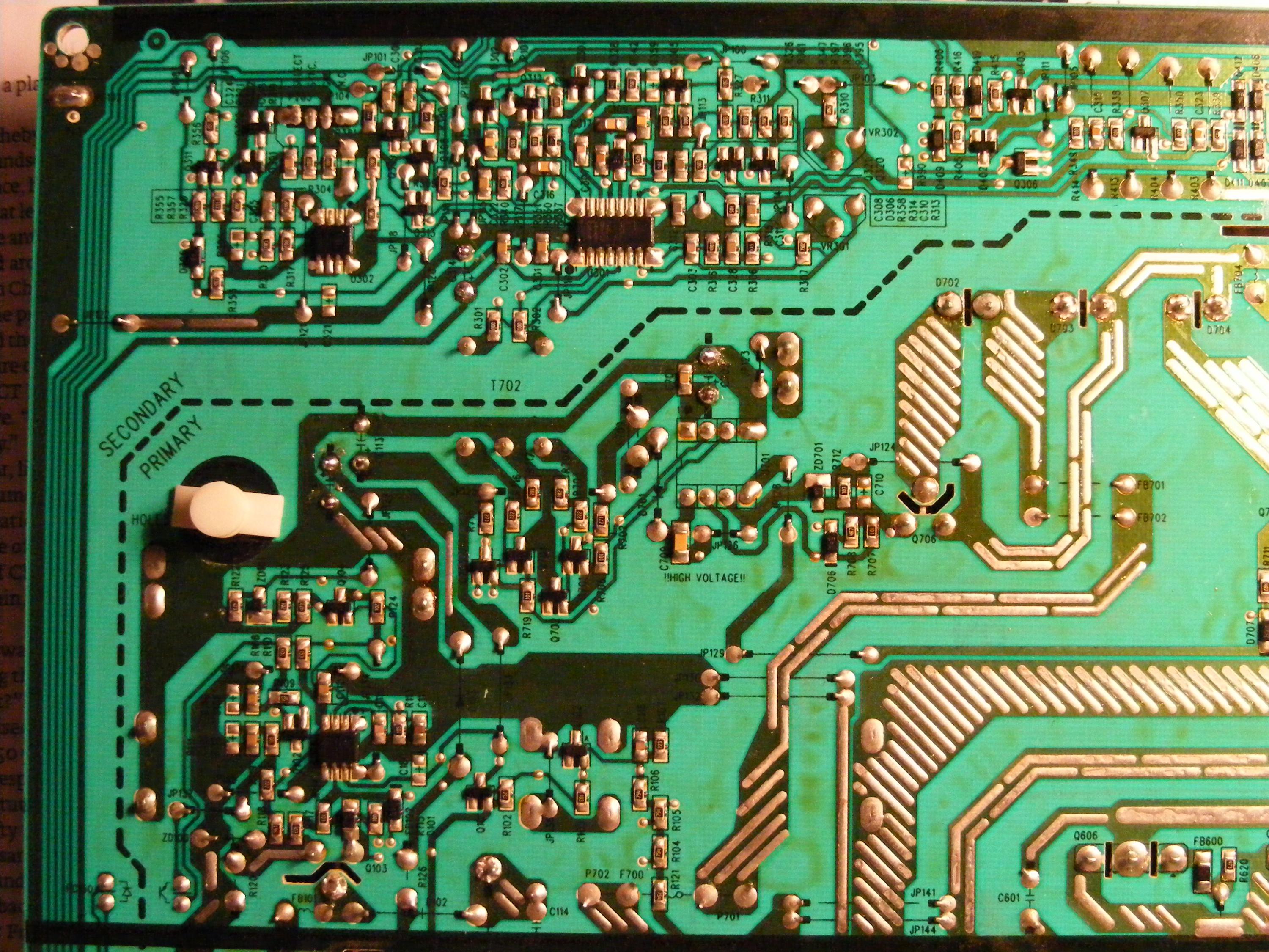

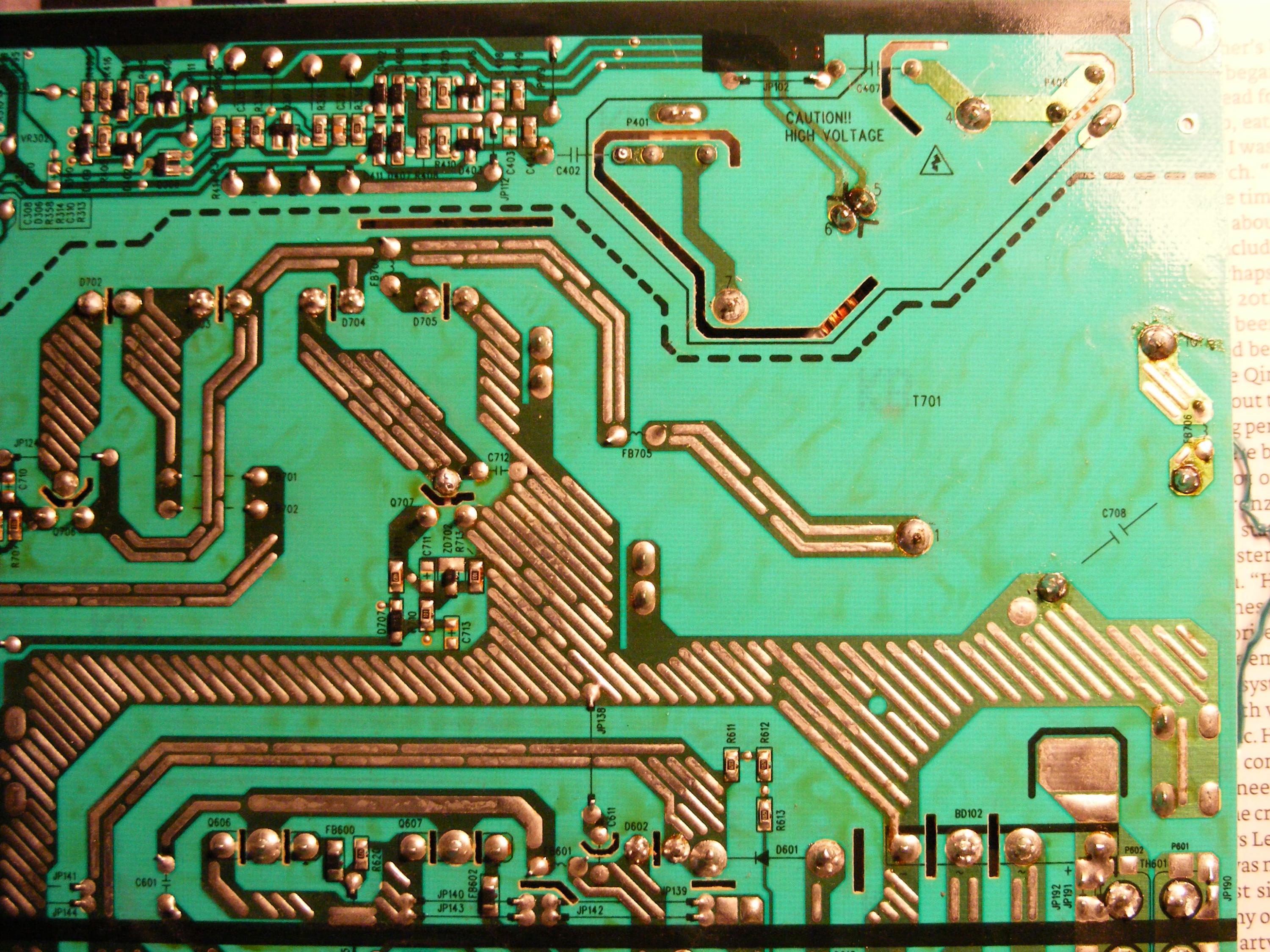

                            That is good, I will need straight shot closed up pictures of the bottom side of the board in 4 sections so I can trace out the connections.
                            I also need the P/N of the IC701 I believe it is the PWM IC for the inverter circuit.
                            You can also try heating up those small 4 caps (C702, 113, 117, and one next to that small transformer) by that IC with hair dryer.
                            • tn245
                              • Oct 2013
                              • 530
                              Are these ok budm?
                                OK, that is pretty good. I will need that IC 701 number so I can see how those two MOSFETS for the Inverter transformer are driven.

                                  U701 is FAN7382
                                    OK, here is the spec sheet for the FAN7382.
                                    Since you have two boards, you can do the resistance testing (board removed from the chassis) on the IC using pin 4 as the ref point (black probe on pin 4) and read the resistance against the other 7 pins. Then put the board back in and take the DC voltage reading on the VCC pin 1 (using pin 4 as the ground ref pin).

                                      Budm here are the measurements. I measured Vcc with the boards out of the chassis, but forced on with resistors.
                                      Code:
                                           Faulty board         Working board
                                      Pin
                                      1     Rises up to 155K      Rises to 164K
                                      2     532K               530K
                                      3     528K               529K
                                      5     10K                10K
                                      6     ~13M              ~12M
                                      7     ~13M              ~12M
                                      8     ~13M              ~16M
                                      Vcc   14.27V             13.15V
                                      The last three pin resistances fluctuated and seemed to change each time I went back to measure, but there was a significant difference between the readings on pin 8 between the boards.

                                        There does seem to be a difference here but I'm not sure what to make of it. ?
