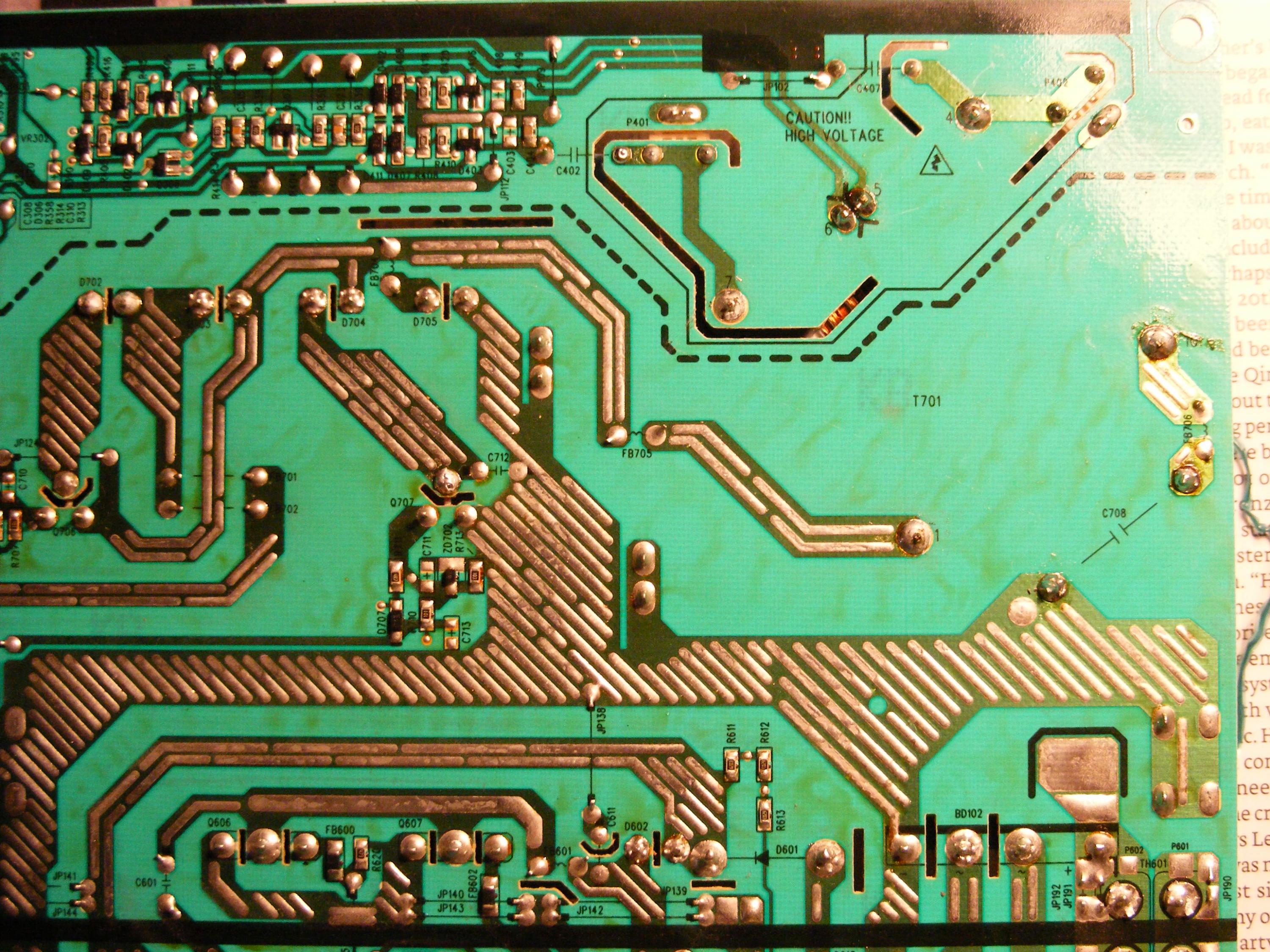

LG 42LT75 no backlight

    Maybe the IC or something attached to Pin 8 is leaky?

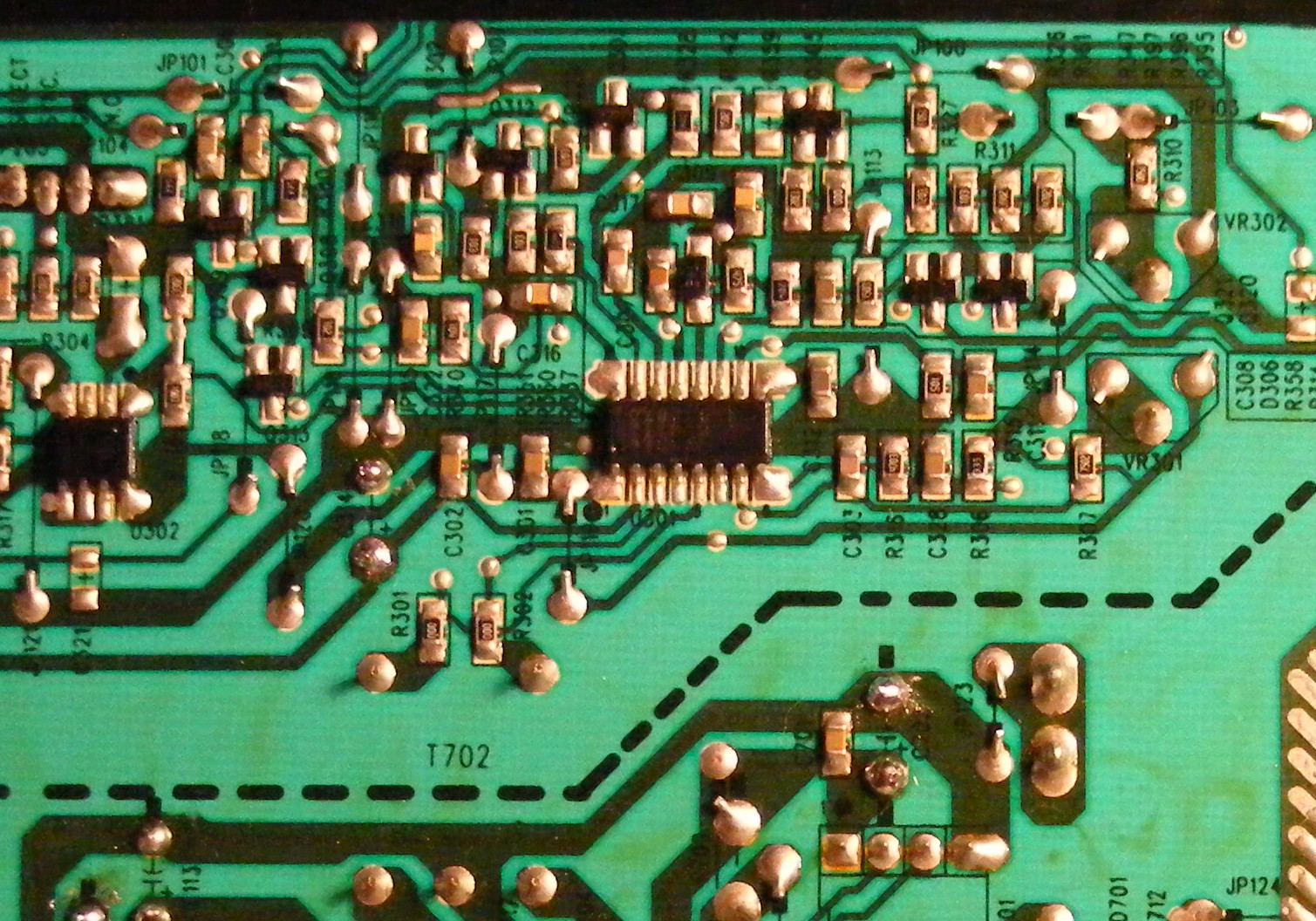

      Check PIN 2 and pin 3 DC voltages to see if there is any activities there. pin 4 is the ground ref point.

        Re: LG 42LT75 no backlight
        Thanks budm. On pins 2 and 3 on the good board I measure a jump to approx 5V on switch on, then it drops to 0V. (this is out of chassis so protection must be kicking in).
        On the faulty board it's only in the mV range.
          OK, so it is not driven, if you look at pin 2 and 3, you will see the traces that go to a bunch of transistors which looks like they are driven by transformer T702. There are 2 ICs one is 8-pin SMD and one is 16-pin SMD which looks like it drive the T702. Can you get the P/N of those 2 ICs, see picture #1 on post 15.
            The 8-pin IC is S393, the 16-pin is OZ9925GN.
              OK, let me look up the spec sheet for those 2 then we can check the VCC Pin to see if it is getting the voltage or not, it is good that we do have good working board to do the comparison test.
                  s393 8pin - sounds like an LM393
                    Yes, I think it's the same type of thing. Datasheet for S393 attached.
                    So I found a chance to take some measurements. S393 is getting 5V VCC on pin 8, and OZ9925 is getting 11.75V on pin 2. This is the same on both boards so looks like the ICs are getting their supply voltages ok.
                      On the OZ9925 pins 3 and 5 (push-pull driver outputs) lead to that transformer T702, and on the working board I measure an initial 5V on both pins. On the faulty board it's only mVs.
                      I went ahead and measured all the OZ9925 pins on both boards. Here are the measurements plus pin assignments from the link. Where it says (then drops), I guess it's because I haven't got lamps connected, and it's going into protection.
                      Code:
                      Pin Working     Faulty
                      1  5        5          VREF	Reference Output +5V
                      2  11.7       11.7         VIN	Power supply +12V
                      3  5 (then drops)  0.4         NDR2	push-pull driver output #2
                      4  0        0          PGND	Power GND
                      5  5 (then drops)  0.2         NDR1	push-pull driver output #1
                      6  0        0          AGND
                      7  1        1          RT_CT	Sawtooth generator R and C
                      8  0.58       0.59         LRT_LCT	(Triangular wave for burst-mode dimming)
                      9  2.3 (then drops) 1.24         DIM	Dimmer control input
                      10  2.3 (then drops) 0          VSEN	Voltage feedback input
                      11  2.8       2.8         OVT	(Over Voltage Threshold?)
                      12  0        0          TIME	Switch-On input/output
                      13  2 (then drops)  0          SST-CMP	seems to be a power-good output, H = lamps are bright
                      14  0        0          ISEN on/off control input, H = ON, L = OFF
                      15  5        5          ENA	Enable
                      16  5 (then drops)  0.74 (then drops)  VLS	Voltage Low Sense
                        So some how there is no drive output to drive the transformer, it should have sent out the drive then goes into shutdown after the error is detected. Do you want to try new IC?
                        This one example of how it is used:
                              I think the ic is not on because of pin 16 being low. On the good board it's 5V at start-up, but on the bad one it's almost nothing.
                              I tried grounding the base of Q312 causing pin 16 to stay at 5V. Now I get the 5V at pins 3 & 5 driver outputs on the ic, and I get those input voltages on the FAN7382 - though there still doesn't seem to be any oscillation happening at the inverter transformer and no light on a CFL.
                              I think pin 16 of the OZ9925 is normally kept high by the feedback circuits coming from the output of the inverter transformer (top of second pic) but there's no feedback coming via C402/407 at all.
                              Any thoughts on what's going on here? What could I check next having ruled out the PWM ic?
                                  I guess you need to find out why Pin 16 (and maybe 9 and 10) aren't getting the same signals as the working one.
                                  Since you have a working one, you can compare voltages in the circuits associated with those signals
                                    From what I can tell, Pin 16 on the working board is kept at 5V by voltages tracing back to C402/407 which are connected to the outputs of the inverter transformer. On the faulty board there's nothing coming out of the outputs so Pin 16's voltage is switched off. As I said I can force the ic on by cutting out that feedback signal, but I still get no output on the transformer which leads me to think the problem is elsewhere.
                                    I don't really get how that works though, it seems to be a paradoxical loop in my mind. If the ic needs the feeback from the inverter to power on, but the inverter needs the ic to drive it, how does it ever get started?
                                      Not at this point, comparison test with working board and SCH will help at this point.
