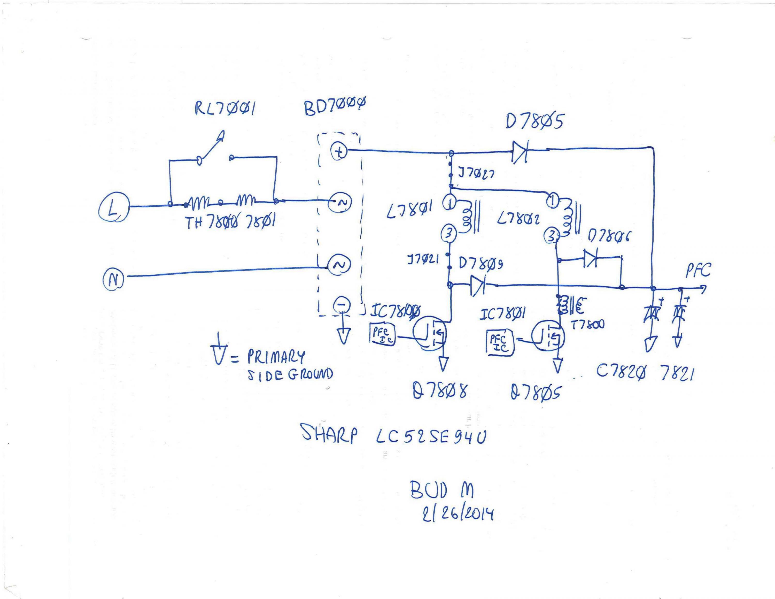

                    Here is the simplified diagram and the how that shorted out MOSFET is connected.
                    From this this schem, are these FETs not N channel
                    I'm getting confused.
                      #70
                      Re: Sharp Aquos LC52SE94U hit by surge
                      They are almost certainly N-MOSFETs.
                        Having difficulty finding anything to match IC7800 that drives the damaged MOSFET Q7808
                        It's an ST brand with designation DAS001/ on the top line and EZ807 below.
                        Incidentally the other MOSFET Q7805 paralleled by source pins is driven by IC7801 which is an ST L6562D ( lower line EZ810) it's easy to find.

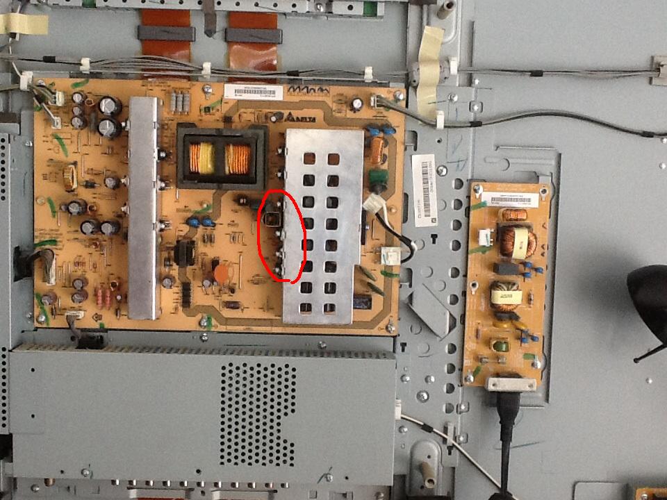

                                      As far as I can tell the Q7808 does not exist in the RDENCA231WJQZ.
                                        #79
                                        I will try and check your part requested as soon as I open the TV again.
                                        Thanks anyway Tom66 I have confirmed it does not exist on that board nor does the second coil l7802 under the cage.
                                        I have ordered a new MOSFET but do not have a scope to check the L6552 (IC7801) oscillator that drives the gate. Any suggestions?

                                          So your board is not the same as the one from Shopjimmy that we were using to troubleshooting your board? it does not have Dual PFC circuits?
                                          I will not taking a chance of installing the new MOSFET without replacing the IC, if the the out put of the IC is stuck on HI (instead of turning the MOSFET ON-OFF), it will cause your new MOSFET to blow, so makes sure to leave the lamp in place of the fuse.
                                          Your picture in post 18 I see two MOSFETs and two PFC diodes though.
