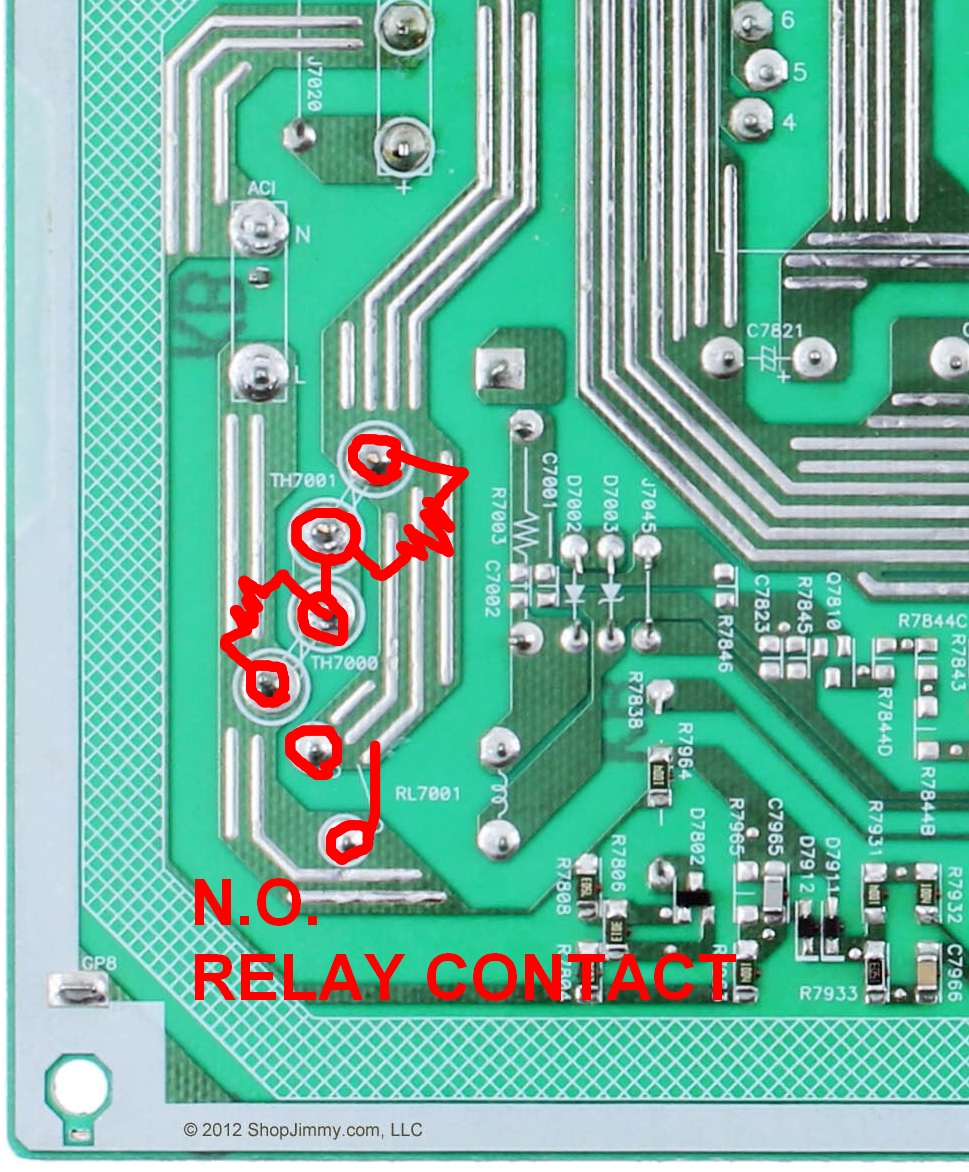

              Just the power supply board and the AC input filter board, the relay (RL7001) is turn on by the main board to by pass the inrush current limiters thermistors (TH7000/7001) otherwise the standby power supply will get the voltage through those two thermistors and it should run if there is no shorts circuit.
              Should that relay be NO or NC ?
                Re: Sharp Aquos LC52SE94U hit by surge
                I know it might seem like an insignificant question but I noticed the relay is NC which to my thinking means initial or inrush current is bypassing the thermistors,
                Am I looking at this all wrong?
                Or does the coil energize as soon as power is applied??
                  The relay is N.O. so the in stand by the current will flow through those two Thermistors (The Thermistor is probably rated at about 3~5 Ohms), when TV is turned on, the Thermistor will be bypass (the relay is turned on by the command from the main board., if not the Thermistors will get hot and can burn out. If you check the resistance between the two contacts of the relay, it should show some kind of the resistance.
                    Thanks Bud, ya I get around 3 ohm which is the same across the thermistors- BECAUSE they are in parallel...
                    Feel kinda silly now but at least I understand...
                    I will go immediately over to general discussions and request an icon for brain fart!
                      They look like in series to me unless the picture is fooling my eyes. May be you mean in parallel with the N.O. relay contacts.
                        Yes that's exactly what I meant Bud, thermistorS meaning both, in parallel with a set of NO contacts not only am I learning to effectively troubleshoot -but also to communicate... The shame continues.....
