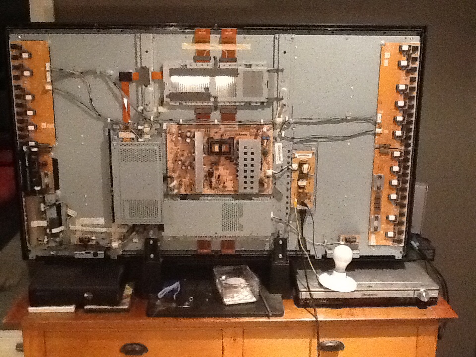

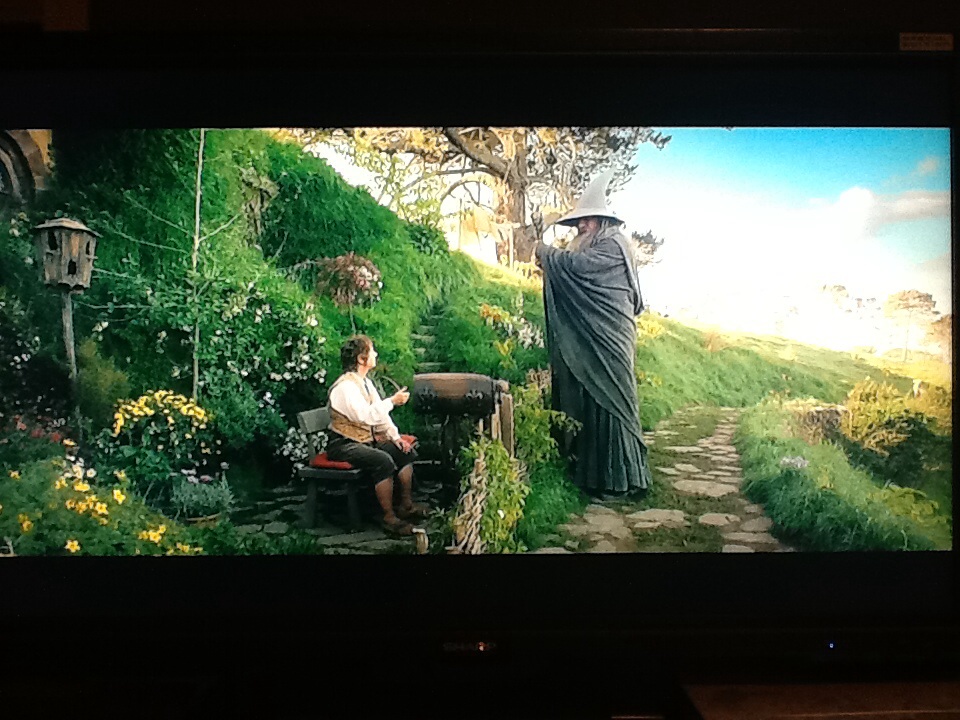

              No more short!
                Re: Sharp Aquos LC52SE94U hit by surge
                ...for now anyway!
                Thank you Budm, Tom66 and everyone who contributed to this thread

                          Use the lamp again for troubleshooting.
