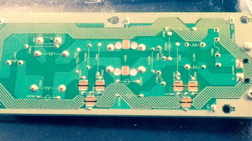

        • Fwrothy
          • Feb 2014
          • 178
          Re: Sharp Aquos LC52SE94U hit by surge
          iPad still getting the hang...making progress I think
          Can only seem to upload one pic for now hope it's somehow helpfu.btw I have thoroughly scanned for damage can't seem any although haven't removed psu board to look at trace side.

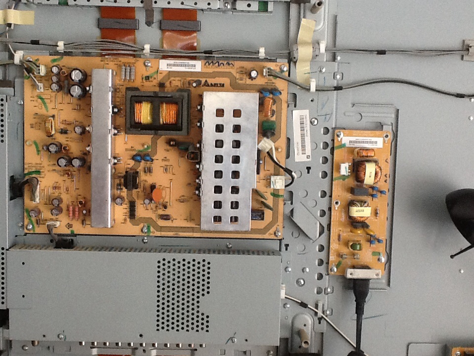

            i would try get pics zoom in more on the psu im new to this aswell but i would remove psu and look at back of it also post close up pic of both sides then test board while out with a meter while your waiting for more info from the other guys

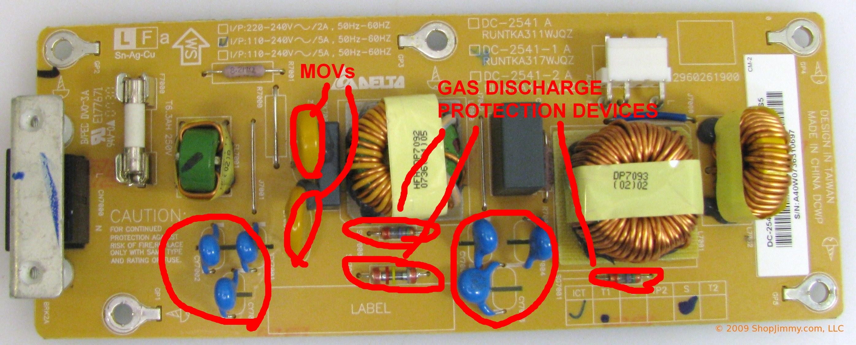

              OK, test the AC FILTER INPUT board by itself, no power to it, nothing connected to it.
              Check the resistance reading at the two legs of each MOV.
              Check the resistance reading at the two legs of each Gas discharge protection devices.
              Check the resistance reading at the two legs of each of those X/Y safety caps.
              Make sure to report the reading if they are in OHM, K OHM, M OHM.

                • Fwrothy
                  • Feb 2014
                  • 178
                  budm-thanks for the reply. The 2 smaller gdpd read .2 ohm everything else is OL.
                  Using a fluke 83...
                  Thanks noobomatic, gonna try and work my way up that tree.
                    Lift one leg of those GDPD off the board and take the resistance readings on their legs again, if they read 0.2 Ohms then that is the problem. The TV will still function without the protection devices in place.
                    If you measure the resistance on the two prong of the AC inlet pin, it should show high resistance.

                          Looks like a similar power board to one I have - let me know if you need comparative measurements.
                          • Fwrothy
                            • Feb 2014
                            • 178
                            @tom66 thanks, the mov with the 1.475M read is a tvr14681, designated as z7000 on the trace side. I have .2-3ohm across the gas discharge tubes labelled SG7000 and 7001 respectively that are in parallel with the toroidal coils.
                            Would appreciate those 3 comparisons.
                            As I understand it, there isn't really a definitive static test for MOVs, so would capacitance be any better? If so that tvr14681 reads .61F
                              So what resistance do you get at the AC input jack reading between L and N? MOV will usually shorted out (scarified itself and caused the main fuse to blow). If it shows very high resistance (in 1000 of Ohms), then you should be able to power up this board by itself without blowing the fuse, or you can use a 75W lamp connected in place of the fuse, the lamp should not come on and stay on bright.

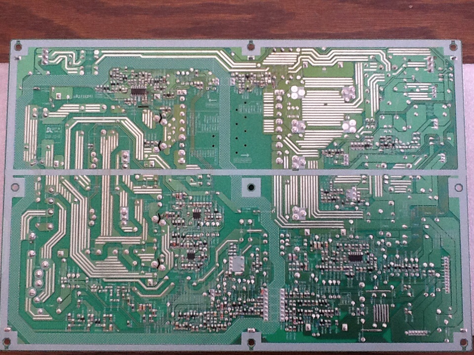

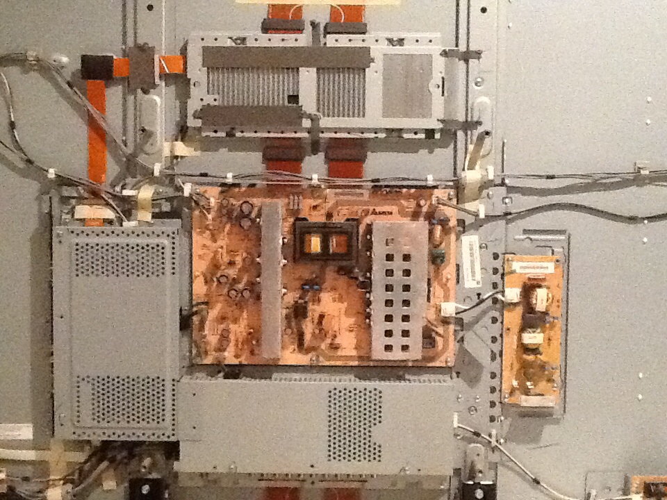

                                        Thanks, that's a great reference but unfortunately it looks like that model has a RDENCA231WJQZ board-my board is an RDENCA235WJQZ- similar but I doubt the same. I will keep looking around, thanks again!
                                        I have the board out inspected trace for any obvious damage- nothing (some large areas show a slight discolouration not sure if the pic shows...)
                                        Since I can't power up not sure on the next step...
