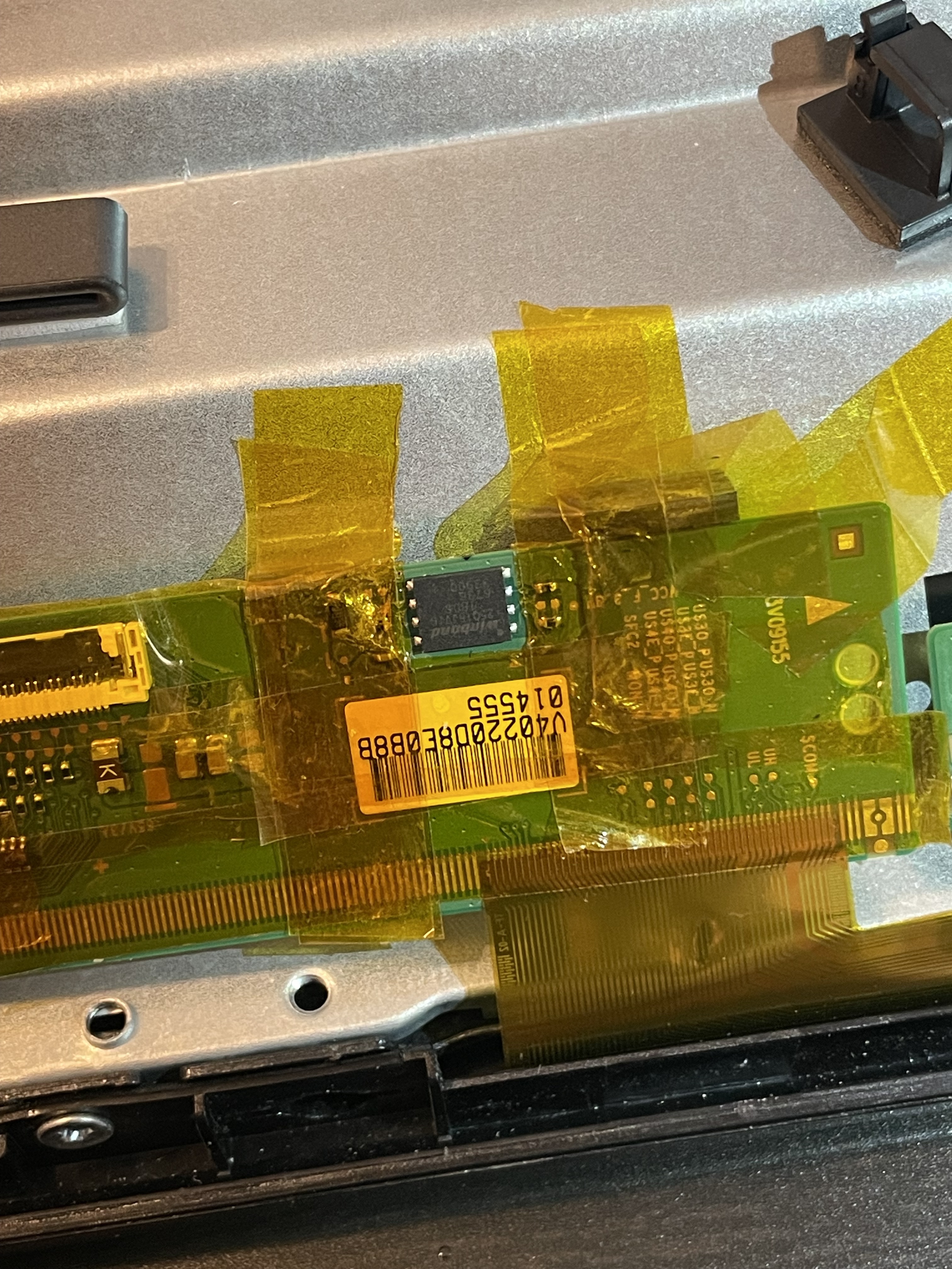

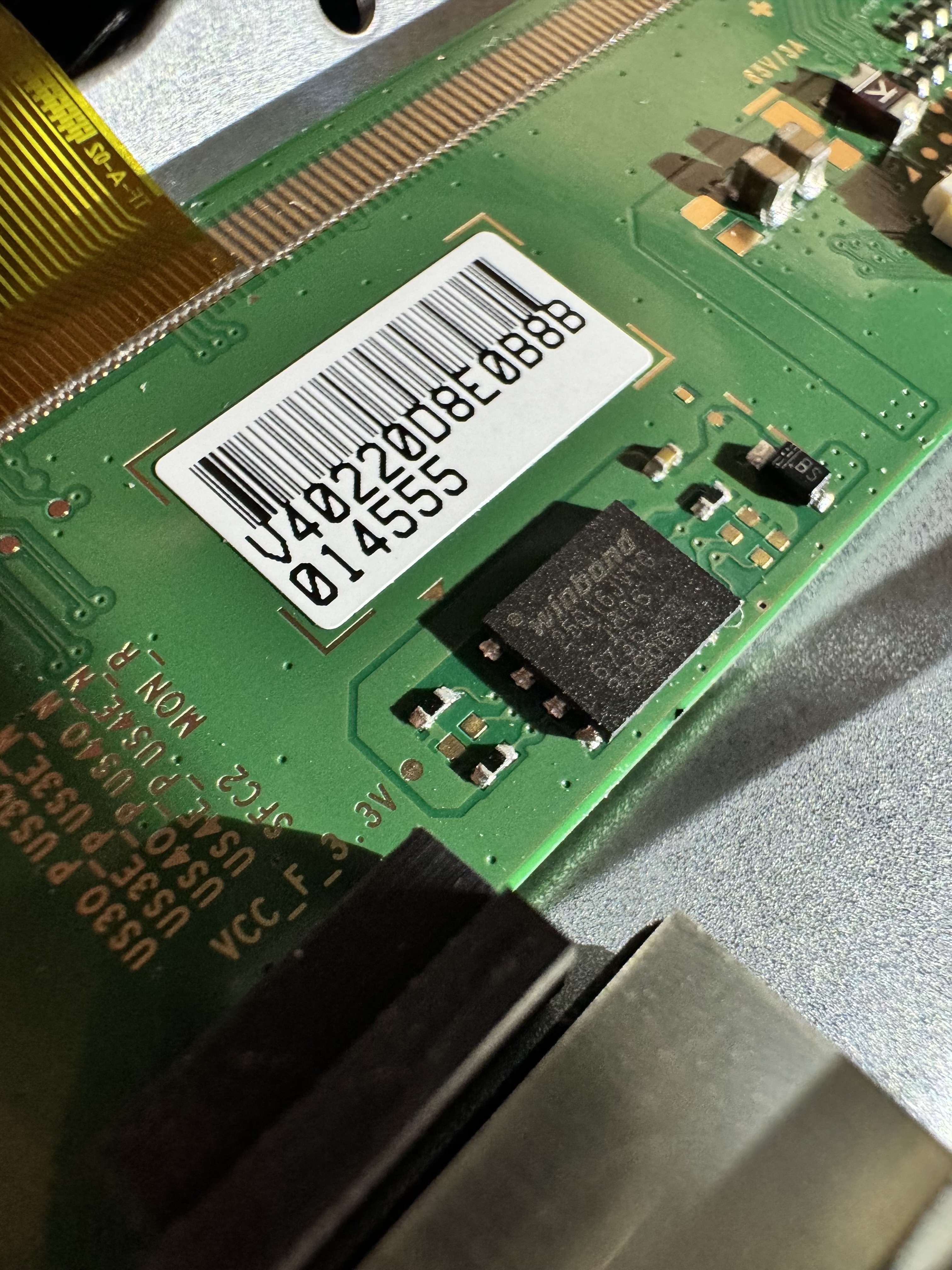

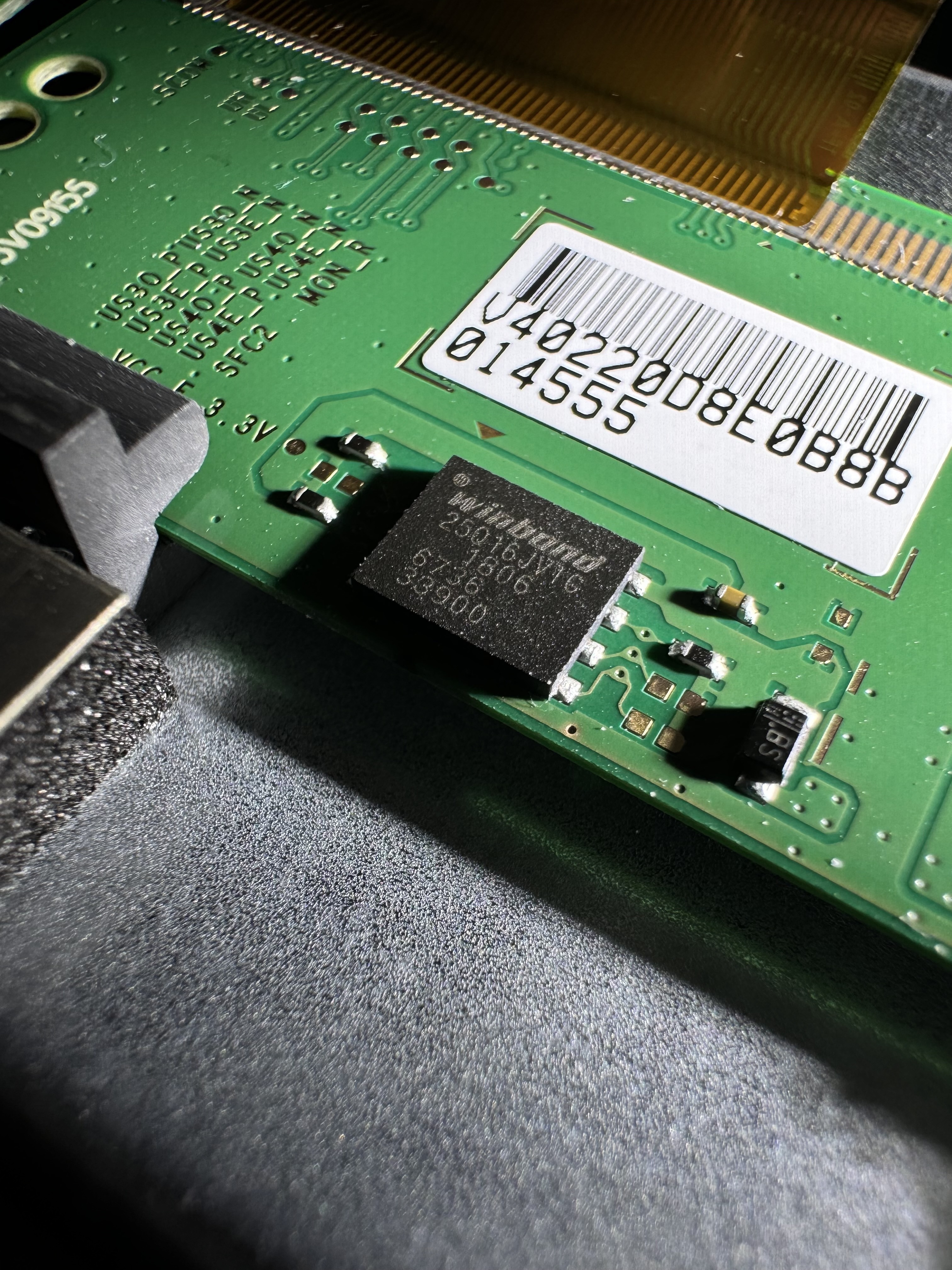

                              locate the tcon flash memory, remove entirely its solder and resolder it.
                              • jonah1024
                                • Jul 2024
                                • 44
                                • Romania

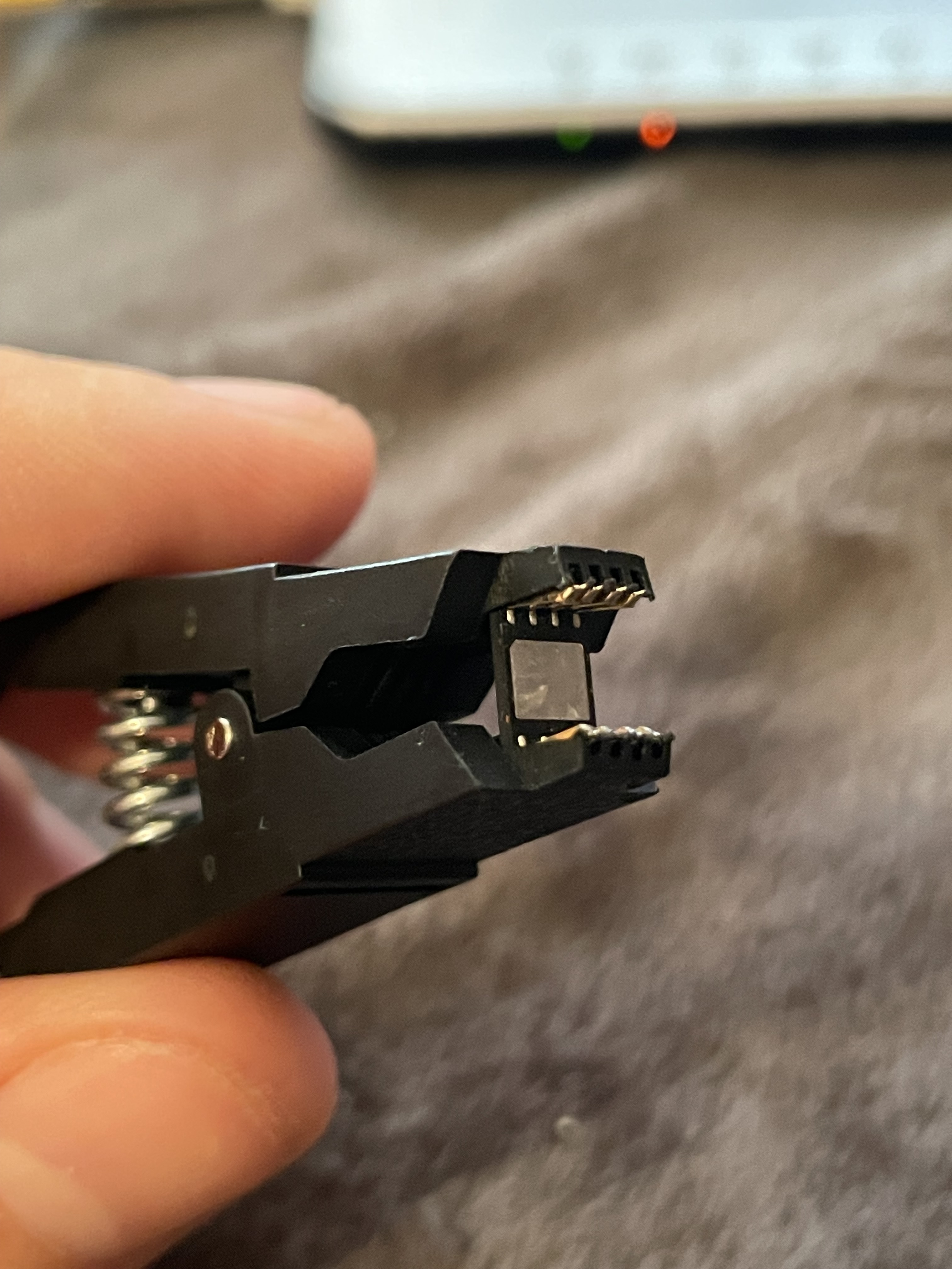

                                The memory chip is a winbond 25Q16JVIG which uses I think a WSON8 socket with a big underneath ground pad and no little feet (I’ve attatched closeup pictures).
                                I don’t see any signs of bad soldering between pads and pins but I will try to reflow the solder as careful as I can to rule that out.
                                I also upgraded the NAND firmware from v4.58 to v4.68 using the usb flash but the problem did not go away. Most likely as you said it did not have to upgrade the T-con memory at all. I can’t find old firmwares unfortunately, I’ve contacted Sharp but still waiting for a reply.
                                Any other ideas?
                                Really appreciate the support!
                                Kind regards,
                                Iona

                                  Be gentle... why you say "reflow" ? my advice is different..
                                  furthermore, i see like a glue around the tcon FPGA chip (main chip), i see well? Are there any other big IC on there? Can you photograph it?

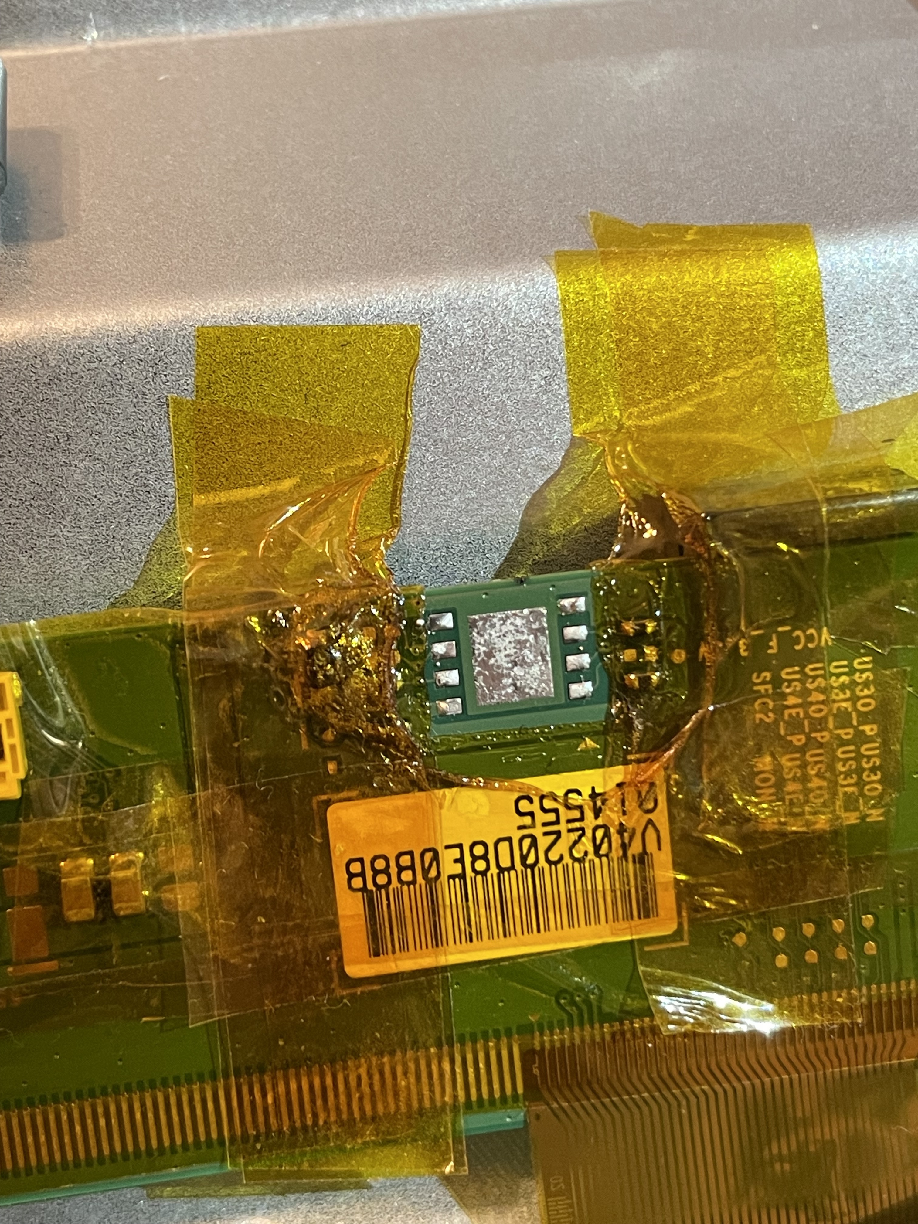

                                    I just feared I might mess things up but will add some kapton tape all around and see what I can do.
                                    • Davi.p
                                      Hobbist Tech
                                      • Sep 2009
                                      • 4516
                                      • Italy - Milan

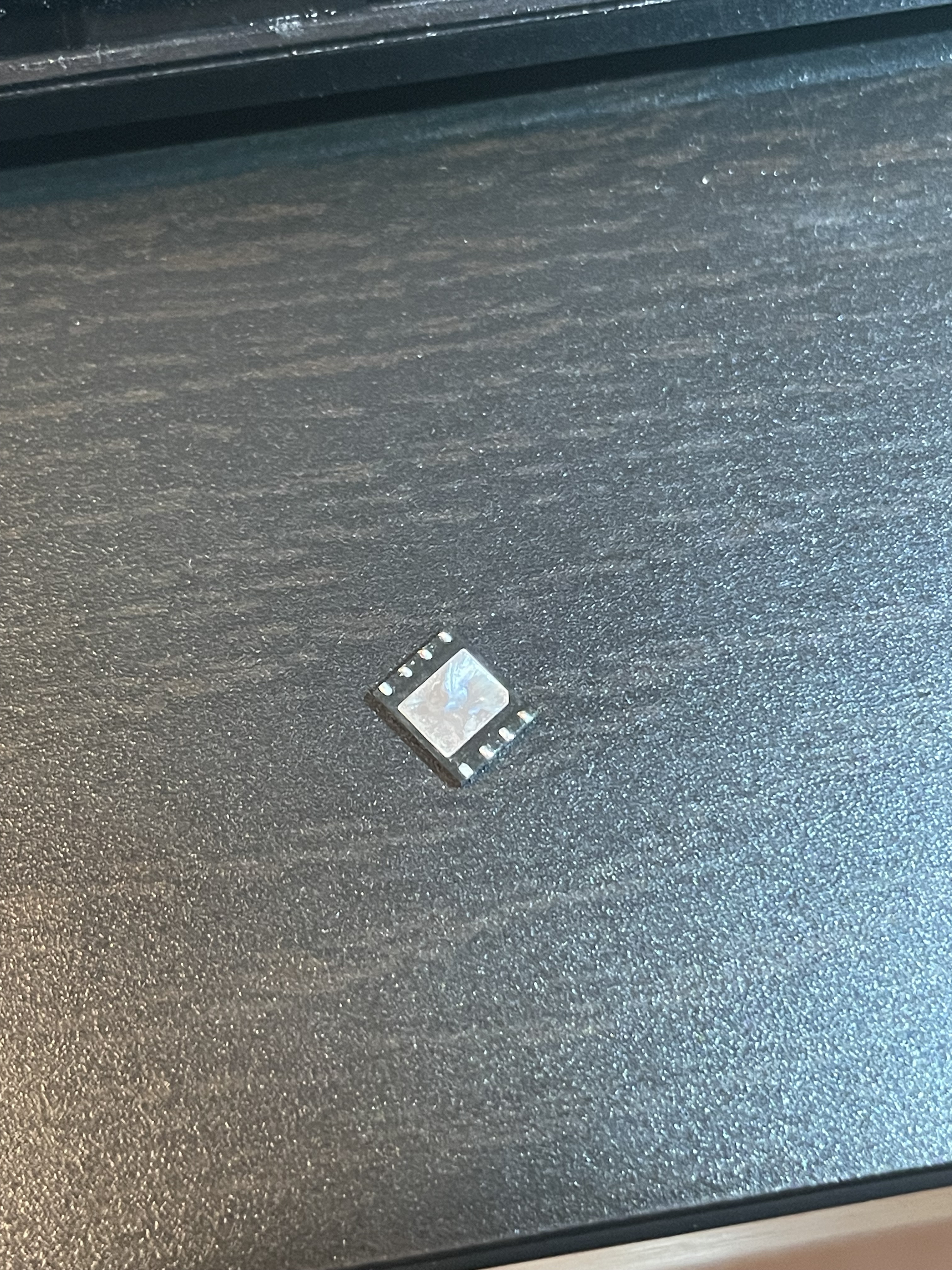

                                      Ok is a difficult task, my advice, start by steps, first one, add new solder, remove it the best U can with copper braid, put new solder..
                                      • jonah1024
                                        • Jul 2024
                                        • 44
                                        • Romania
                                        Hi, I did what you said, desoldered cleaned, resoldered, The problem is still there. I also dumped the spi flash just in case.
