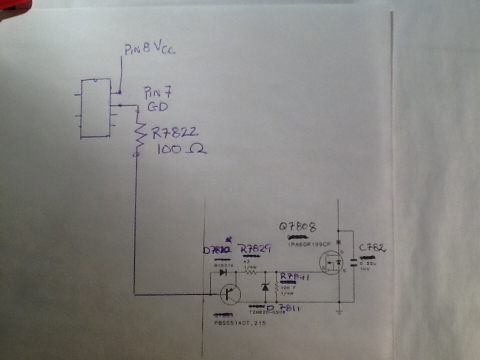

                      I traced pin 7 and it feeds both gates of the individual MOSFETs through a 100ohm resistor.
                      Both gates have a diode and a 43ohm resistor in series with a 10kohm resistor-diode pair grounded on the gate side of the 43ohm resistor.

                                Sorry, I kinda carelessly omitted the transistors in post #90. The transistors Q7804 & Q7807 are actually driving the MOSFET gates, correct?
                                Here's my schem for Q7808, I forgot to identify the IC-7800(L6562D), the other MOSFET(Q7805) is identical to this...

                                  Just a question....in order for the driver to be damaged- wouldn't the diode or transistor or both need to be shorted?

                                    Re: Sharp Aquos LC52SE94U hit by surge
                                    Not necessarily - diode and transistor for semiconductors are quite big (on the die scale, process size of say 50um isn't unusual) - this means they can handle a brief overload fine - but the IC usually has a much smaller process so is a lot more vulnerable to damage.
                                      That transistor is connected as a clamping circuit to limit the drive to the GATE, the transistor will be bias on when enough current flow through the diode to bias on the E-B junction which in turn turns on the transistor and divert the drive signal from IC to ground. Since you have G-D low resistance, I am surprise that the Zener, transistor, etc in the path back to the drive output pin of the IC are not damaged since those components will not be able to handle the high voltage dump from Drain pin.
