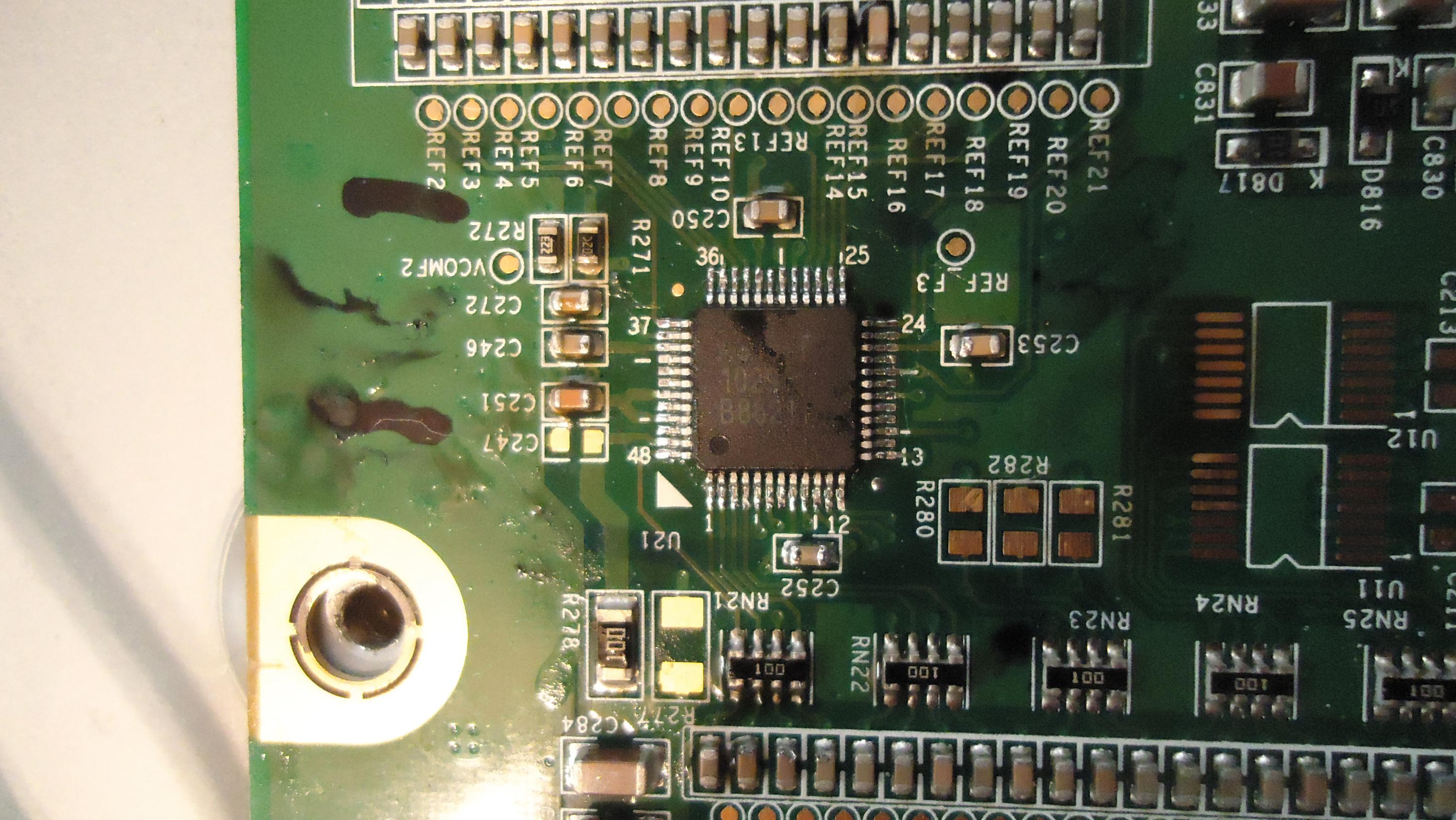

    I have one IC left you think I should pop it in ?

      Originally posted by tom66
      The full readings would help.
      Soldering looks OK.
      Tibimaki replaced IC, and found new IC to be bad. So do not rule out chance you got a bad IC.
      ESD issues?,havent replaced one of these yet,hmmm,might use ground-wrist strap for these if it is an issue
      fixed so far...376 lg lcd tv's,24 onn tv;s,24 panasonic lcd,16 jvc lcd,12 marshall jcm800 amps,refurb of various disco equipment lighting,old style disco decks ,and a flymo!
      please let us know if everything works ok if your tv gets fixed, as it will be and aid for anyone else having the same problem and wishing to fix it.it would save people clogging up this site with topics that are duplicated,and can be found easily using the search function.,and taking up valuable space.enjoy your fixed tv!,hopefully!

        Re: Samsung LN37A550P3F with bad Gamma AS15 AUOPTO T-CON
        Pin 1 -22
        1--15.39
        2--14.11
        3--14.11
        4--14.08
        5--13.69
        6--13.25
        7--13.03
        8--12.93
        9--12.92
        10--12.92
        11--11.89
        12--05.04
        13--2.336
        14--2.334
        15--2.320
        16--2.313
        17--2.291
        18--2.187
        19--2.184
        20--1.384
        21--1.344
        22--255.8 mv
          definitely bad.
            I changed the same IC on a Sony KDL-40SL140 T-con, and that TV is great now. It had a solarized picture as well.
              Could the chip have been shorted by the person that packed it. I use a ground strap...
              Here I go again I will let you know how I make out. Thank You
                Changed the IC again, and still the same volts ,and picture. I must have gotten two bad chips . Going to order new chip from a different supplier.

                        Its not to hard to change that IC watch some youtube videos then practice on an old board. Do not try to force the chip off if it starts to lift wait till the whole chip is loose. If you don't you will lift and maybe destroy the pads the chip solders to. Don't over heat the board that will lift the pad also. Take Your Time no awards will be given to the fastest chip change. Good Luck

                            If you can get the chip off without damaging the board (all the solder pads silver, be very careful not to tear them as you can't connect the chip without them) then you can put it on. Getting it back on is easy enough. Can you borrow someone's good soldering iron? I wouldn't recommend a $10 radioshack iron, for example. You need something that has temperature regulation. Then a bit of (ideally leaded; lead-free is hard enough to work with as an experienced solderer...!) solder and a bit of solder wick.

                                My Sammy was fixed by capkid doing the AS-15f chip transplant.
                                Working great now!
