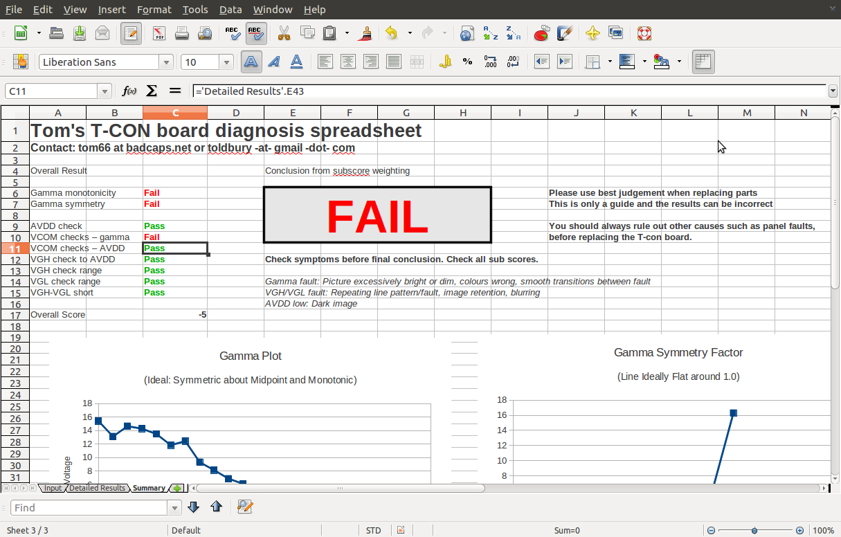

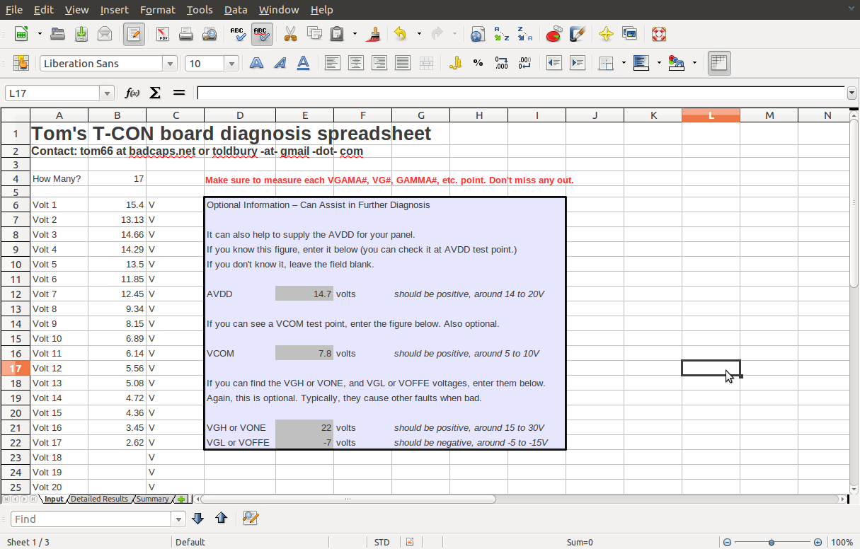

    Attached is a little utility spreadsheet for inputting gamma voltages, VCOM, AVDD, VGH and VGL to see if your T-CON board is working for LCDs.
    Beta v0.01 may have bugs but please feel free to evaluate for testing purposes.
    Tested only in OO.org and Google Spreadsheet. Not fully tested in Excel -- appreciate any feedback on that.
    Enjoy

        Have had a play on it in Excel not that I understand what its about but anything that helps test a tcon has to be good instead of test/clean the cables check voltage at fuse> look for a new board!!
        Just one query - I was just playing at random numbers and it seems that to get a pass the voltage has to decrease on each step - right?
        So if I enter 19v 18v then7v6v5v4v3v2v1v on a 9 sequence it would record
        a pass but would the massive jump actually be a fail. (Does the test need more parameters like y must be less than x but not by more than 3(arbitrary number}

            Excel isn't hard, it's just equations and overly-complicated IF-equations (just click any cell to view the formula!) I did it in openoffice because I don't have a copy of Excel.
            The voltage has to increase OR decrease, in other words, differential voltage from point to point, the sign of the number needs to stay the same. Also, the symmetry test mirrors the voltages around VCOM (AVDD/2 or mid point average of gamma voltages) and sees if they match up. The symmetry test is an additional test, both should be done. It's a lot harder to do in your head. If either of these fail, the result is a guaranteed fail.
            Note -- the Detailed Results tab is more of an internal debug tab -- you should look at Summary for overall conclusion.
            New version coming soon with improvements and bug fixes.

                      I am new to this forum, it's very interesting and it did help me already a lot to understand things about LCD televisions. Thanks to this forum I suspect T-con board, before I also thought of mainboard..
                      I am troubleshooting a Sony KDL-37V4000 and it has all the symptoms decribed here in this forum of a faulty T-con board (the AS15 issue). The screen has a white wash and the colors look inverted. All the AV inputs show the same thing and also the menu.
                      The T-Con board is from AUOpto and it has the AS15. The code is: T370XW02 VC CTRL BD.
                      I measured the Reference points and entered the values in the Excel from Tom66 and the outcome was "failure". The reference points don't show a monolitic line, actually it goes up and down...
                      These are the measured values:
                      VGL >> -6,01V
                      VGHC >> +26,53V
                      VCOM2 >> +6,53V
                      AVDD >> +15,60V
                      VGMA_REF >> +15,33V
                      REF_1 >> 15,33V
                      REF_2 >> 15,32V
                      REF_6 >> 13,39V
                      REF_7 >> 13,05V
                      REF_8 >> 12,94V
                      REF_10 >> 12,21V
                      REF_11 >> 7,33V
                      REF_12 >> 6,84V
                      REF_13 >> 14,21V
                      REF_15 >> 10,48V
                      REF_16 >> 9,85V
                      REF_17 >> 8,65V
                      REF_21 >> 0,933V
                      REF_F22 >> 0,310V
                      The namings and numberings of the testpoints are like I wrote them down, so some numbers seem to be skipped (they are not present on the PCB). In the Excel sheet I filled them in on row 1 till 14 (left VGMA_REF out). There was no video input connected, so I had the white wash screen with only the channel number some OSD info.
                      Can one (or more) of the more experienced forum members concerning this subject confirm to me that the readings of the testpoints are indicating a faulty AS15?
                      Thanks and looking forward to your reply..

                        i would certainly say there bad

                          Ok, thanks. Then I will order the AS15 and then try to fix this Tcon board. SMD desoldering and soldering however is totally new for me, so I'll watch youtube videos and try on old computer PCB's first...

                                Just to let you know that changing the AS15 fixed the issue and the Sony KDL-37V4000 is working fine again. I measured the voltages of the reference points of the AUOpto T370XW02 VC CTRL BD again after replacing the AS15 for your information, indeed very different values now (see my earlier post for the wrong values):
                                VGL >> -6,01V
                                VGHC >> +26,52V
                                VCOM2 >> +6,53V
                                AVDD >> +15,61V
                                VGMA_REF >> +15,33V
                                REF_1 >> 15,33V
                                REF_2 >> 14,95V
                                REF_6 >> 10,48V
                                REF_7 >> 9,75V
                                REF_8 >> 9,50V
                                REF_10 >> 7,85V
                                REF_11 >> 7,33V
                                REF_12 >> 6,84V
                                REF_13 >> 6,32V
                                REF_15 >> 4,64V
                                REF_16 >> 4,36V
                                REF_17 >> 3,82V
                                REF_21 >> 0,380V
                                REF_F22 >> 0,309V
