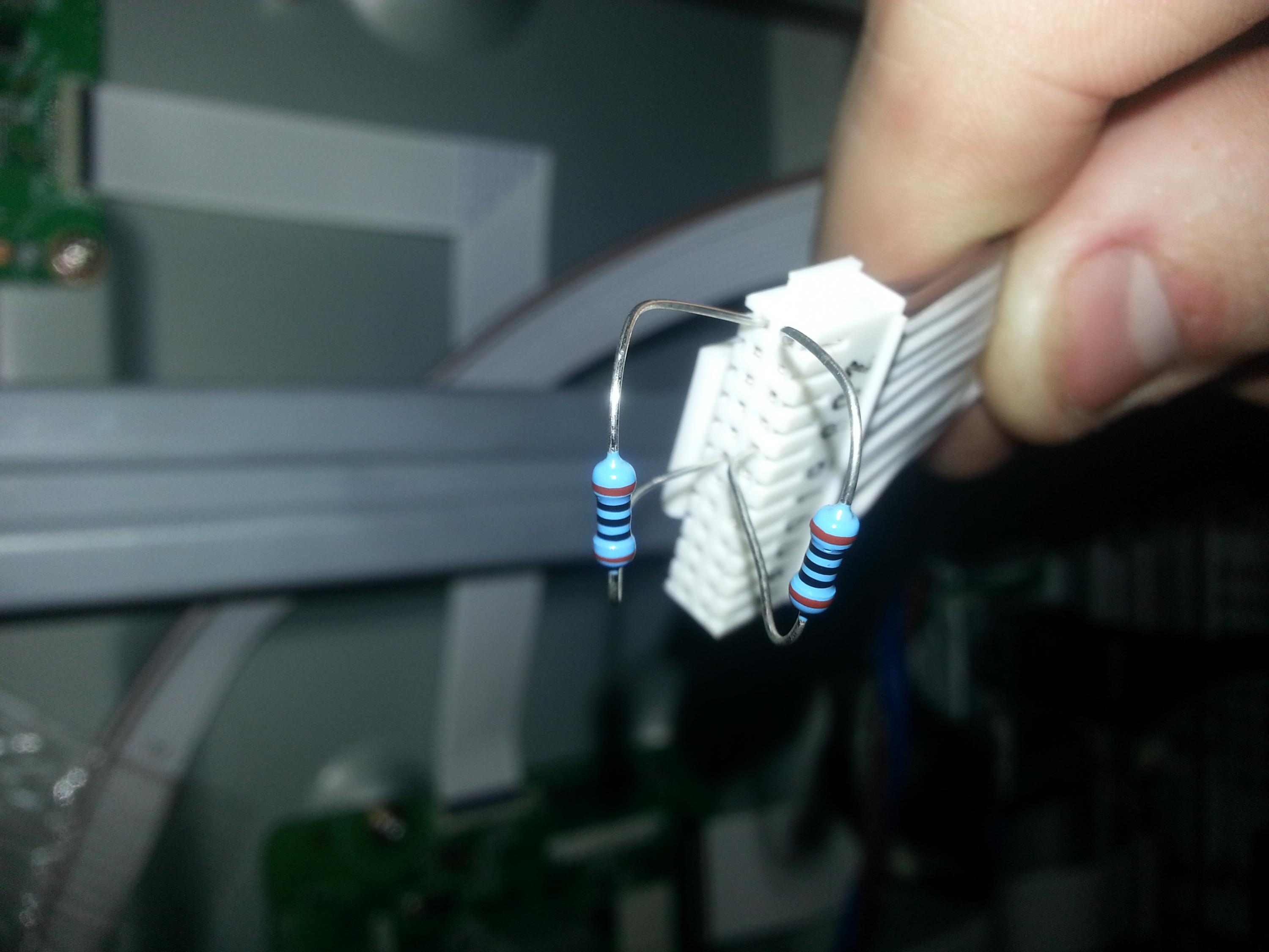

                            #53
                            Re: samsung 58 inch plasma
                            Got My resistors like this ?
                            • adamp91gvm
                              • Jan 2014
                              • 706
                              • uk

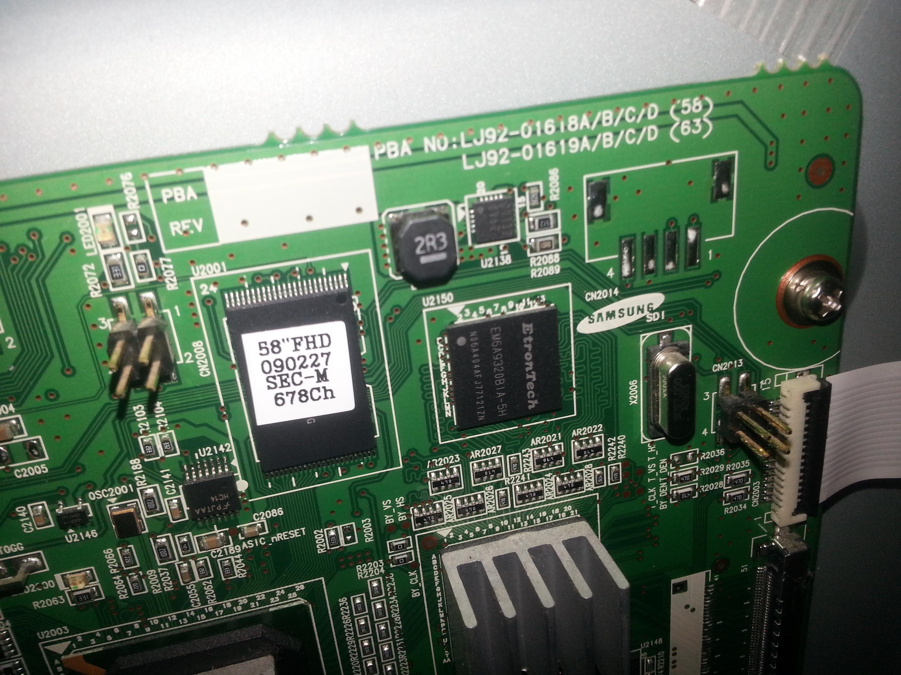

                              #54
                              But I have 2 sets of 4 pins ?
                                #55
                                1st pic looks OK, so do you have Vs/Va and glow from panel?
                                As for the two sets of pins... that's a good one. Never had that before. I think it's CN2008.
