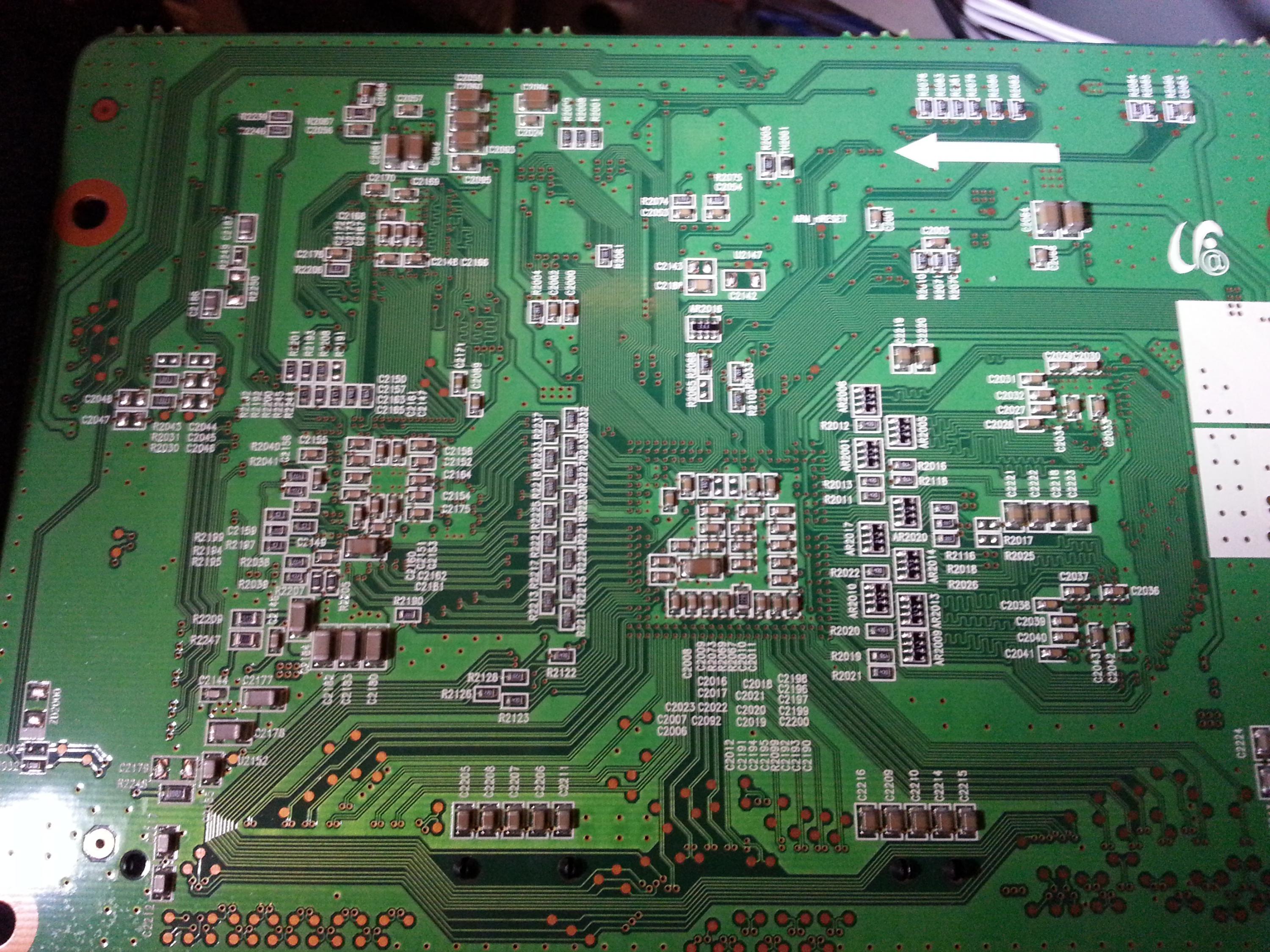

        #163
        Re: samsung 58 inch plasma
        Any places to check on the back ?

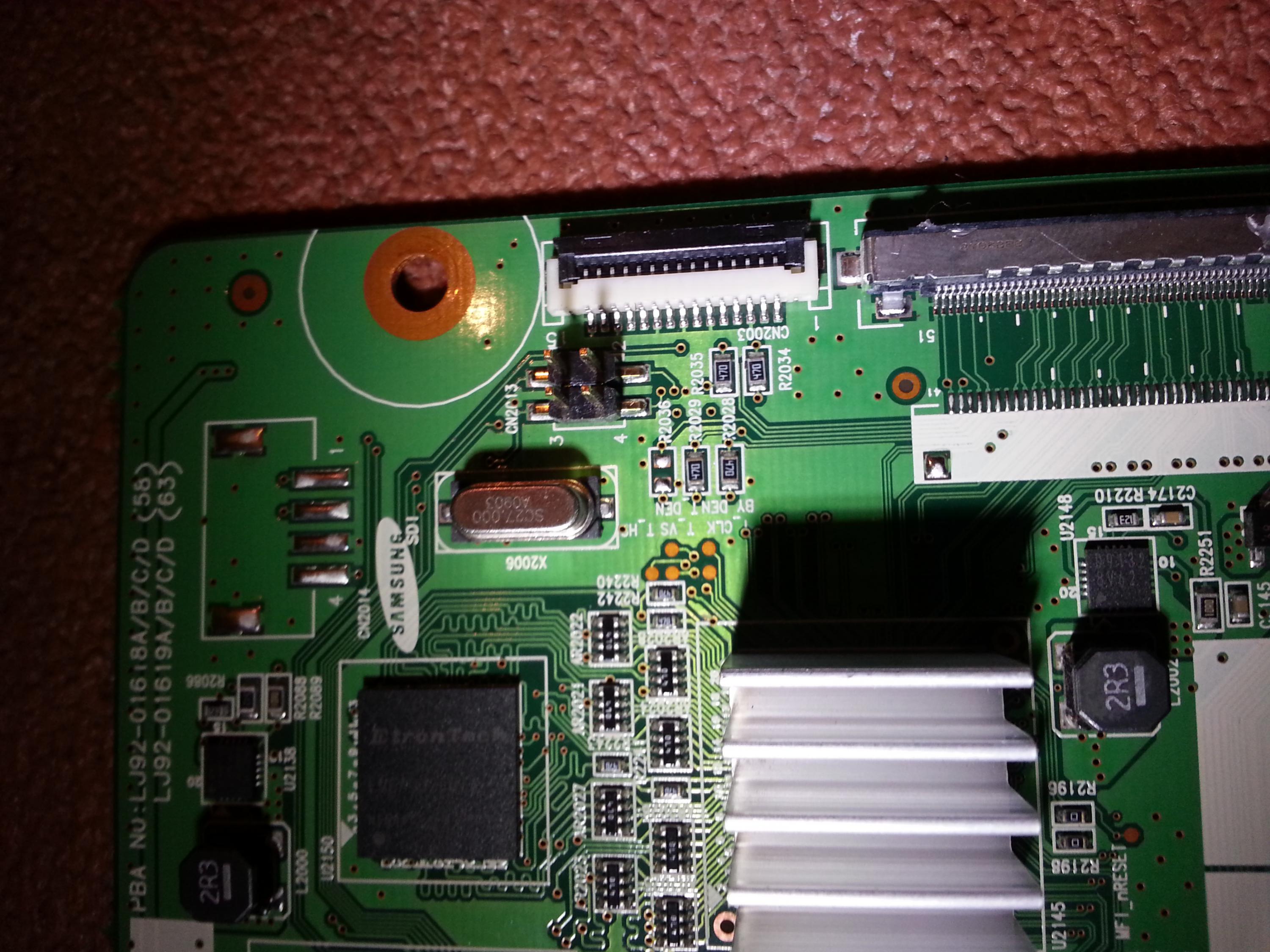

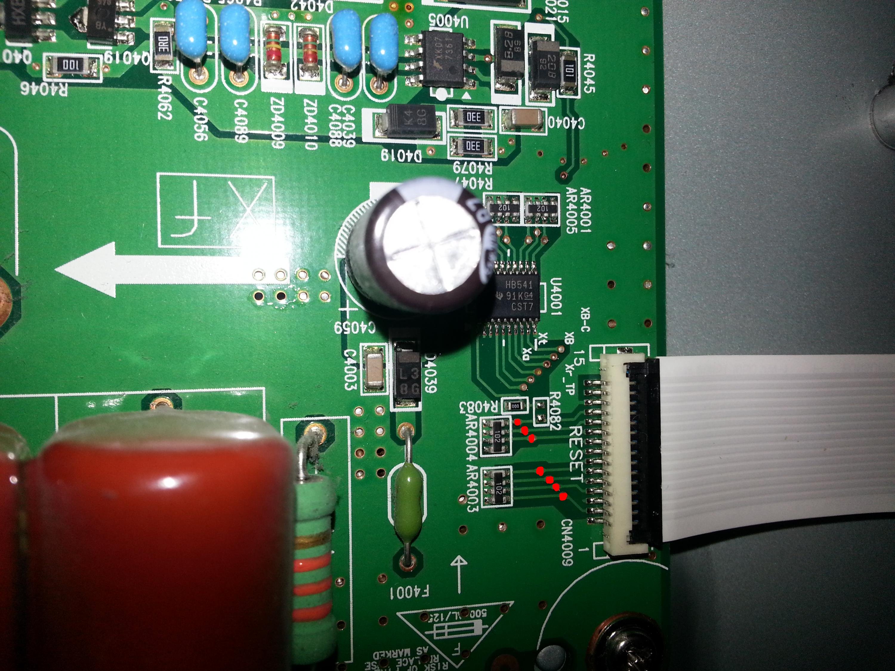

          Nothing stands out, but I do have one other thing to check. Can you get a picture of the connection area around the white ribbon cable going into the X-main board? It runs from the control board.

            #165
            Just here ?
              #166
              I'm interested primarily on the X-main side but that ribbon yes. The X-main side could have some test points.

                #167
                Here?

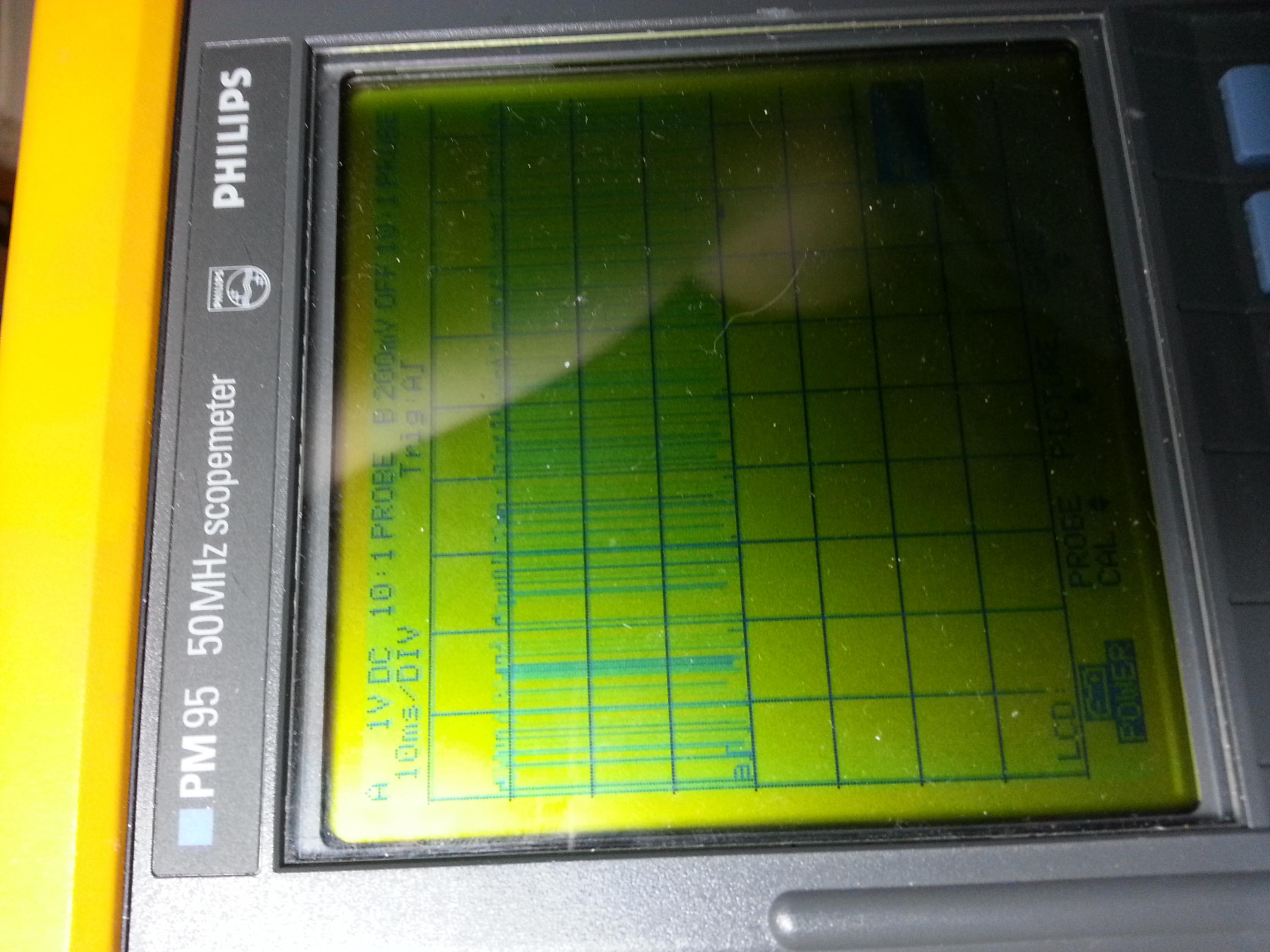

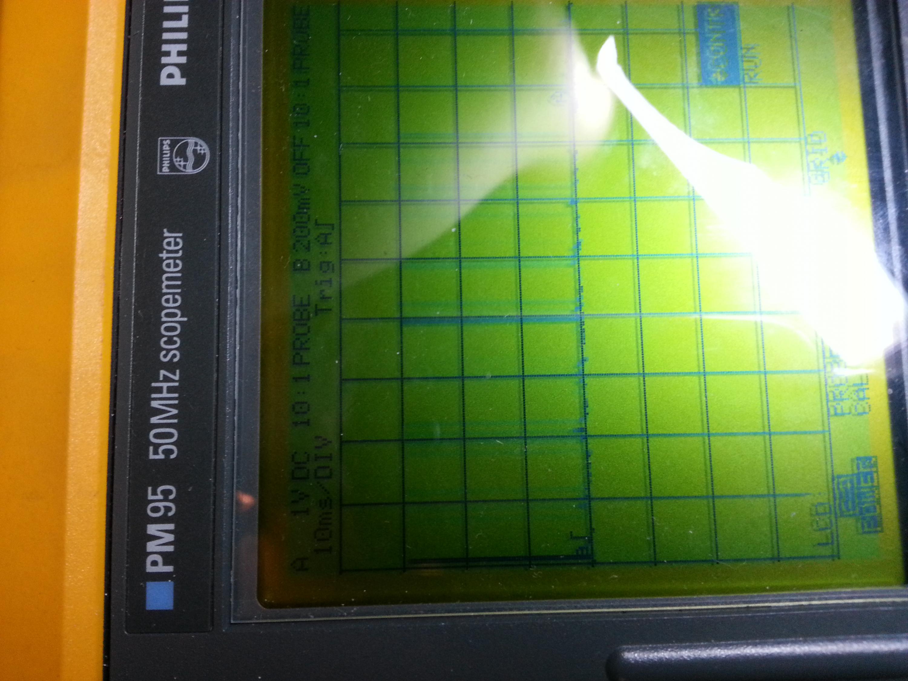

                                #175
                                OK, leave it at 10ms/div but set it to 1V/div.
                                Take a picture of the waveform you see on each point.

                                    #177
                                    Tom just testing the points now ill start left to right with pics
                                    • adamp91gvm
                                      • Jan 2014
                                      • 706
                                      • uk
                                      #178
                                      Here goes

                                        #179
                                        No 2
                                        • adamp91gvm
                                          • Jan 2014
                                          • 706
                                          • uk
                                          #180
                                          Nothing from pin 3
