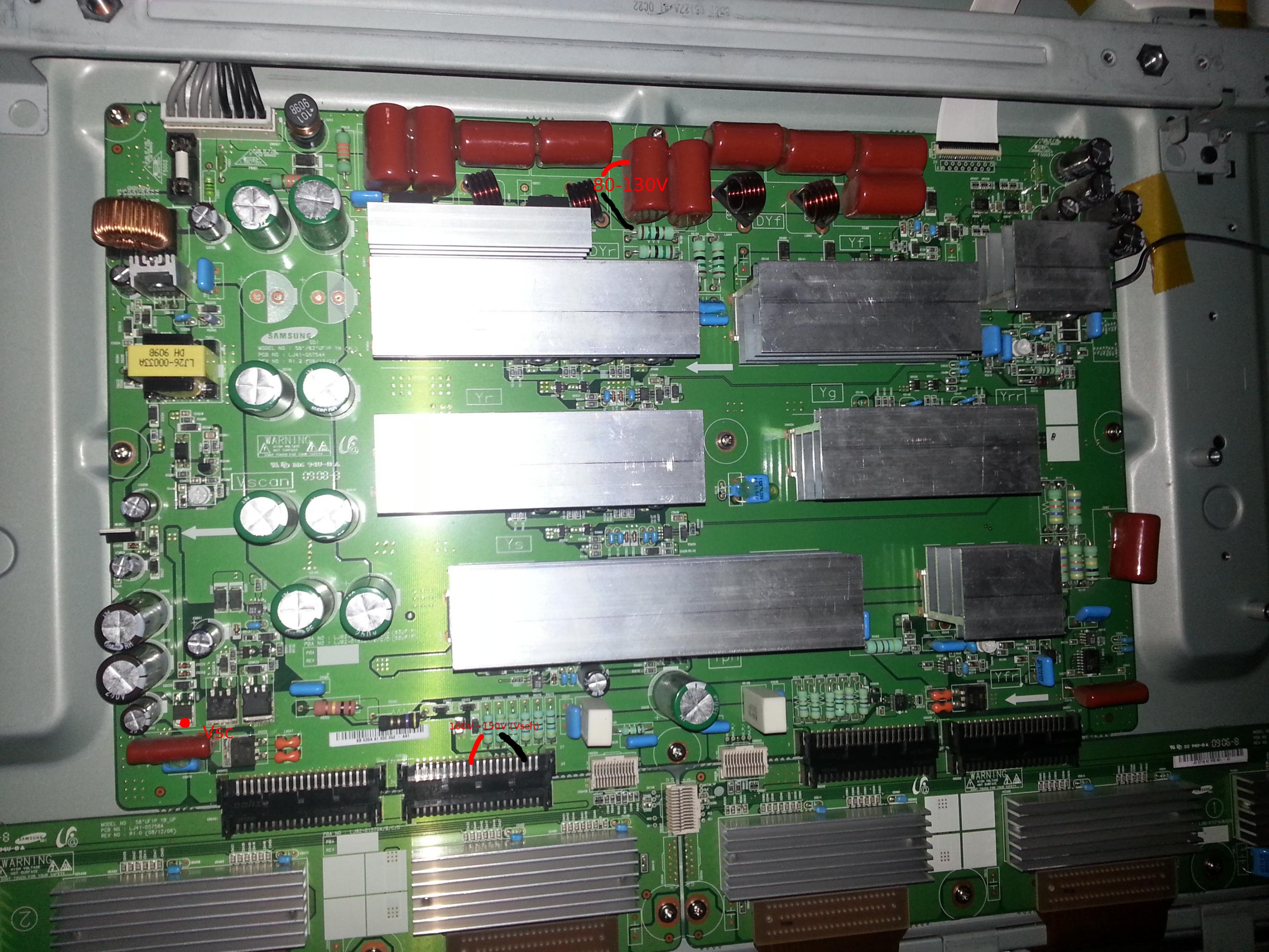

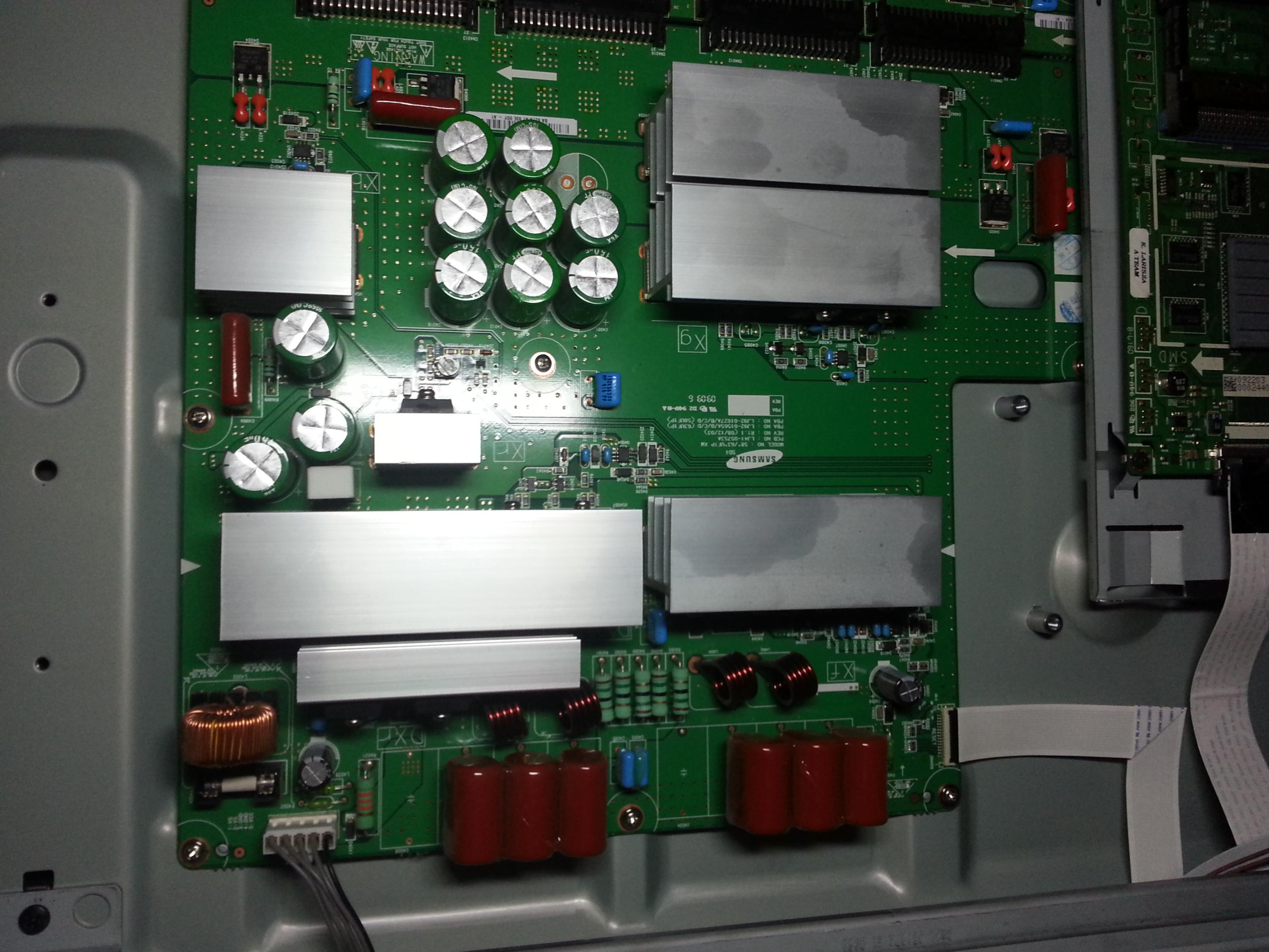

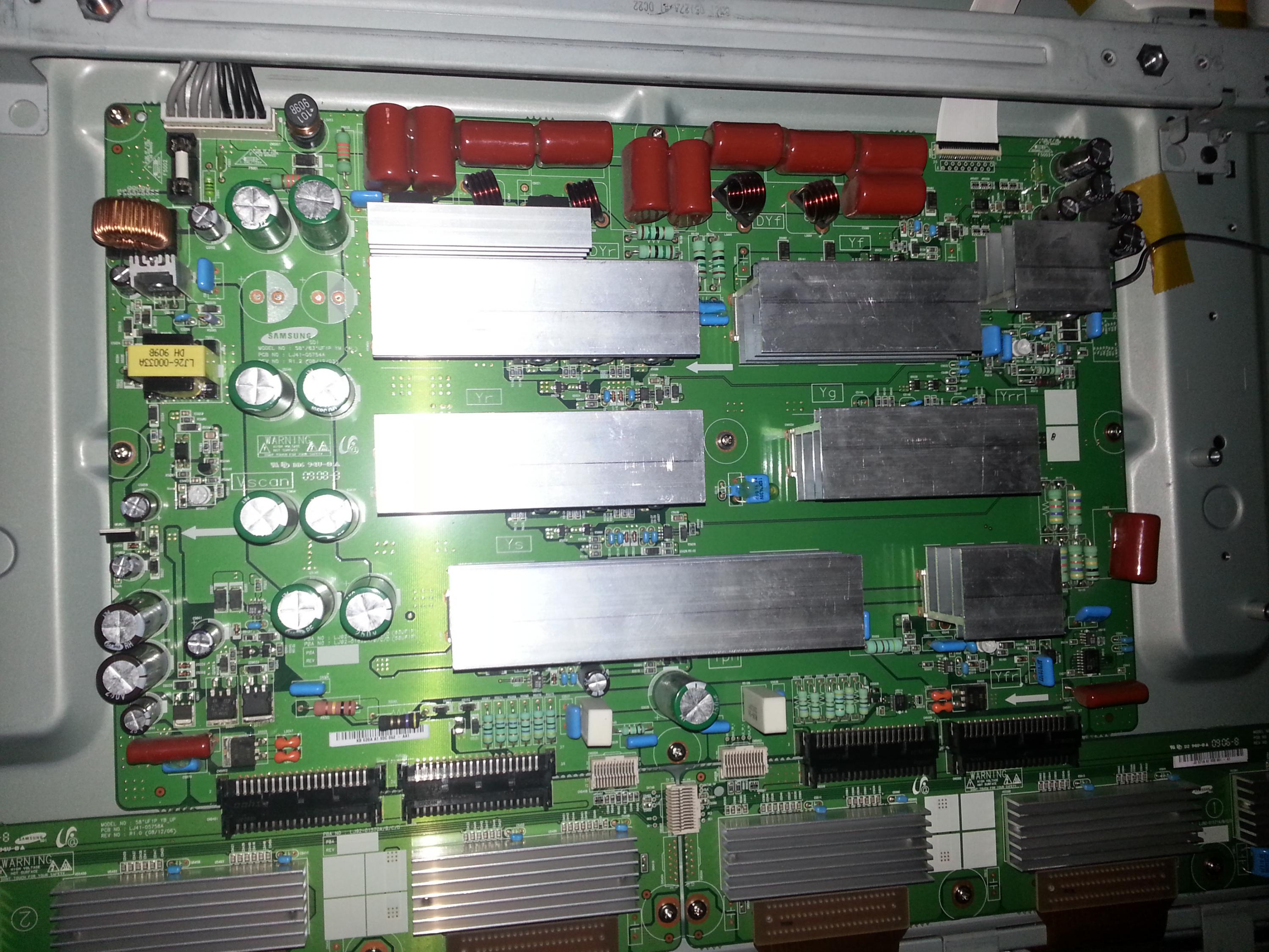

      It may be very dark. In a pitch black room, no glow whatsoever?
      If so, need a pic of Y-main and X-main to check -Vsc, Ve.

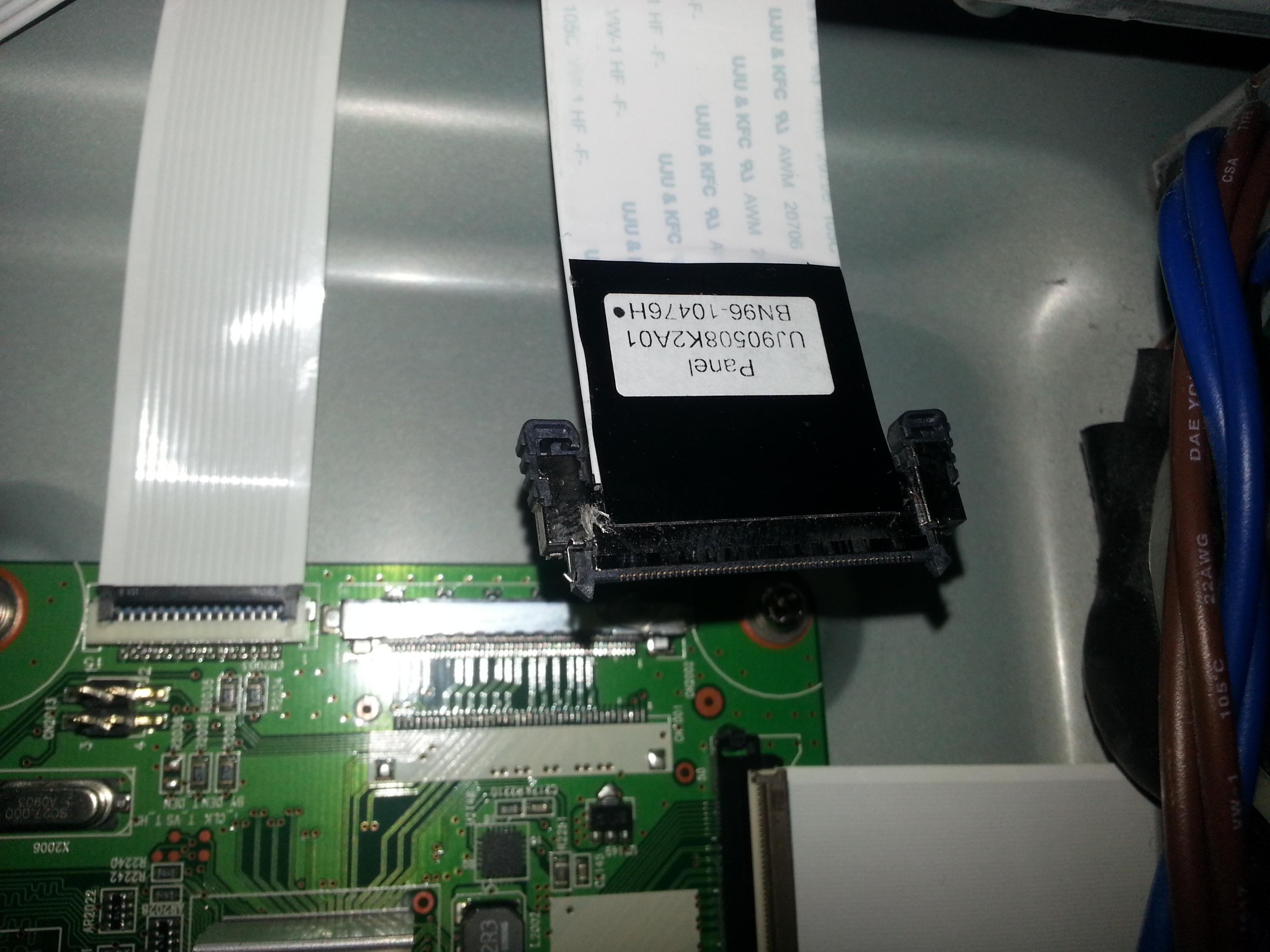

          #64
          Re: samsung 58 inch plasma
          Does the LED blink approx once a second? Did you remove the LVDS cable?
          • adamp91gvm
            • Jan 2014
            • 706
            • uk
            #65
            Yes it blinks once a second and this cable ?
              #66
              Yes. That's the cable. X-main and Y-main both plugged in? How did you get screen to glow before? Really odd...

                      Some check points....
                      No schematic, so -Vsc is a guess.

                        #71
                        i have a vsch check point at the top of the board also the vsc is on the back of the screen -190

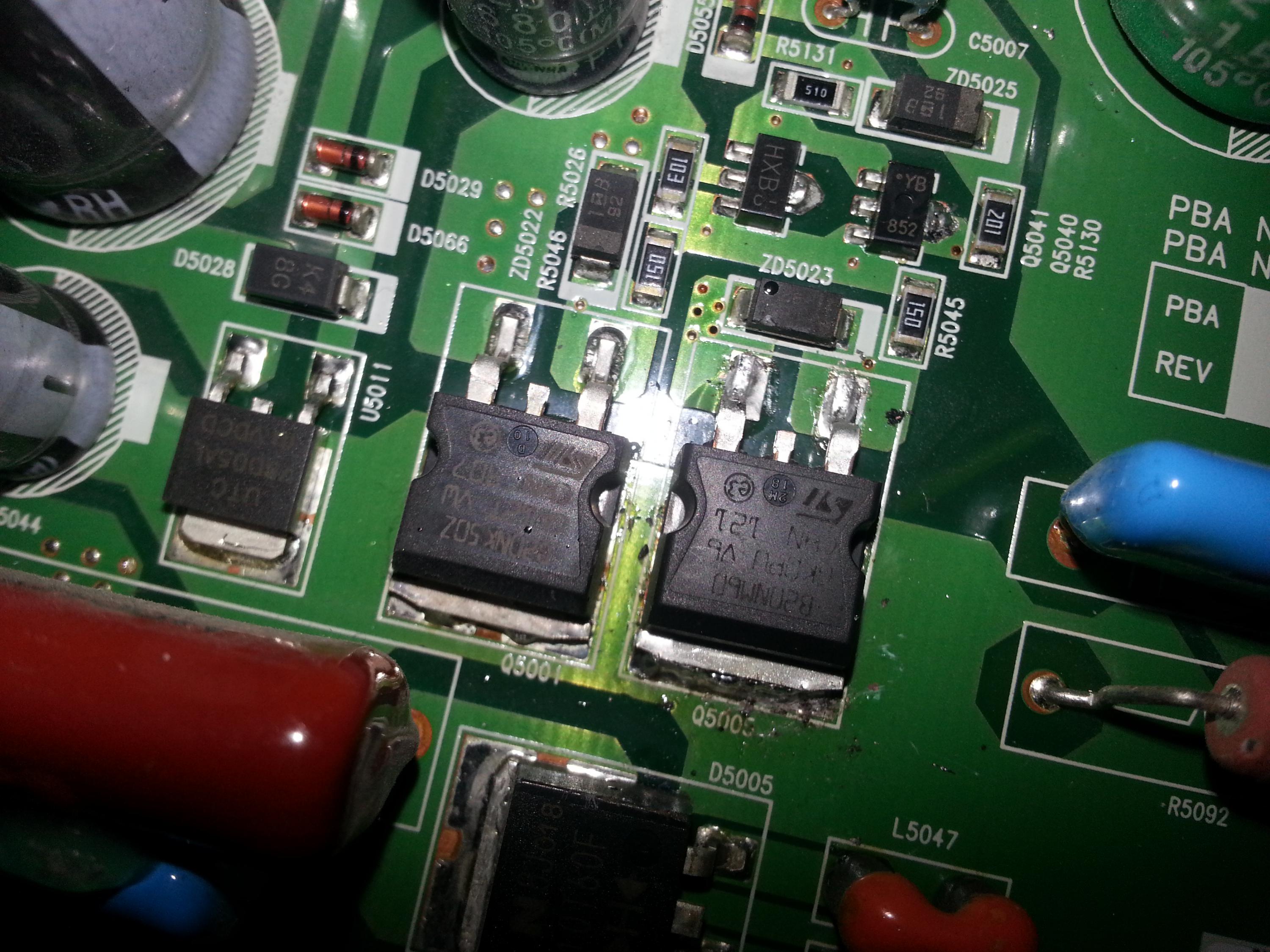

                              #74
                              just been on the phone to the lady who had it she said there has been a transistor changed on the left board as shown in pic
                                #75
                                Try removing buffers and checking VSCH again. Without schematics, repair of Y-Main board may be difficult, so replacement might be only option.

                                      #78
                                      right with everything off ribbons bottom small lead to the lower board (not sure of name ) and the ribbon from the the control board i get -100v from the red thingy lol and -22.2 from the black connector
                                        #79
                                        For the black connector, I want you to test BETWEEN the two highlighted pins with buffers both installed and removed, expecting about 130V.
