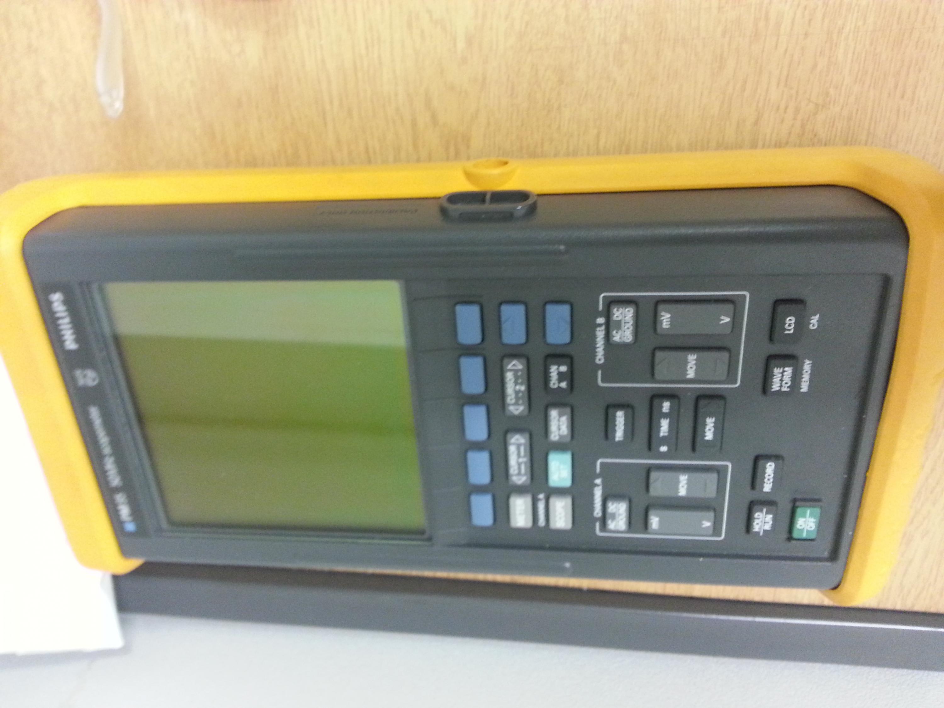

    One scope will try when I get in what I need to do
      #102
      Re: samsung 58 inch plasma
      As long as that's capable of measuring up to 400V, it should just about be usable. Though, if they have an analog unit like this:

        #103
        This is what it can do
          #104
          Yep - looks OK - just make sure to get a probe with 10X capability (ideally, 10X probe.)
          The 10X divides the 400V by 10 times giving 40V which won't damage the instrument.

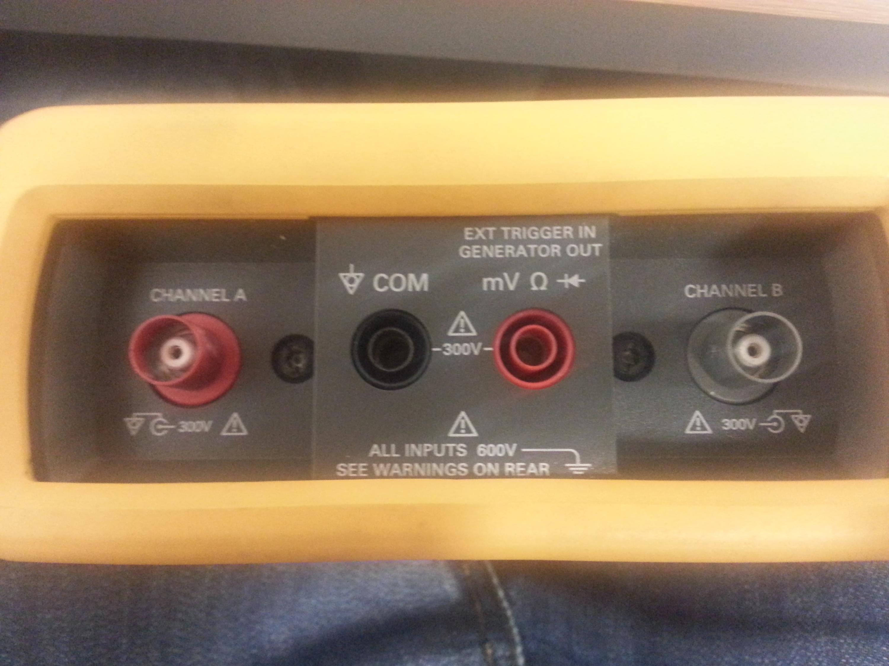

            #105
            right how do i work this probe ?
              #106
              Picture of it?

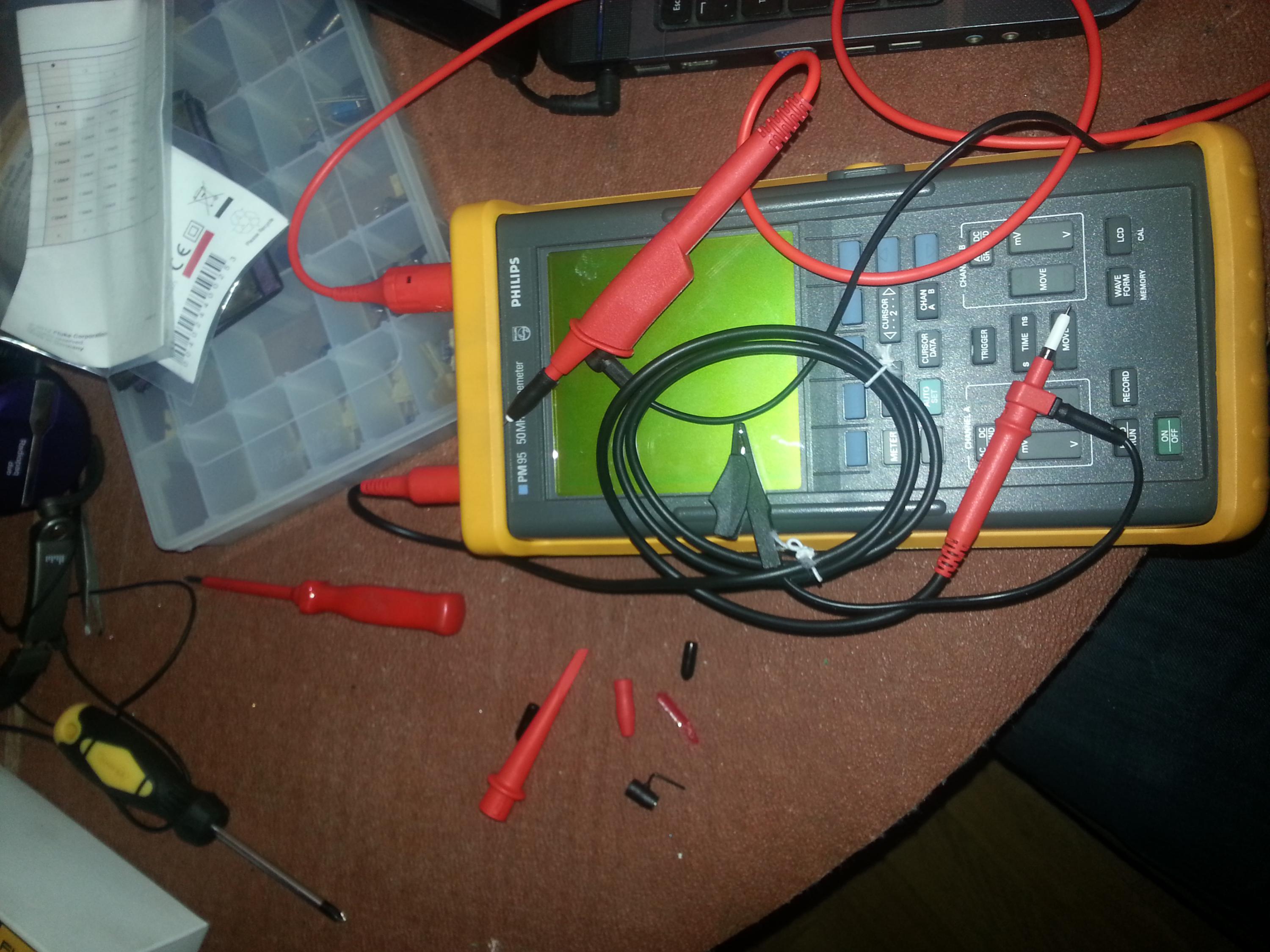

                #107
                This Is what I have
                  #108
                  Is 1X or 10X printed on that probe?
                  If you use 1X probe, the instrument might be damaged.

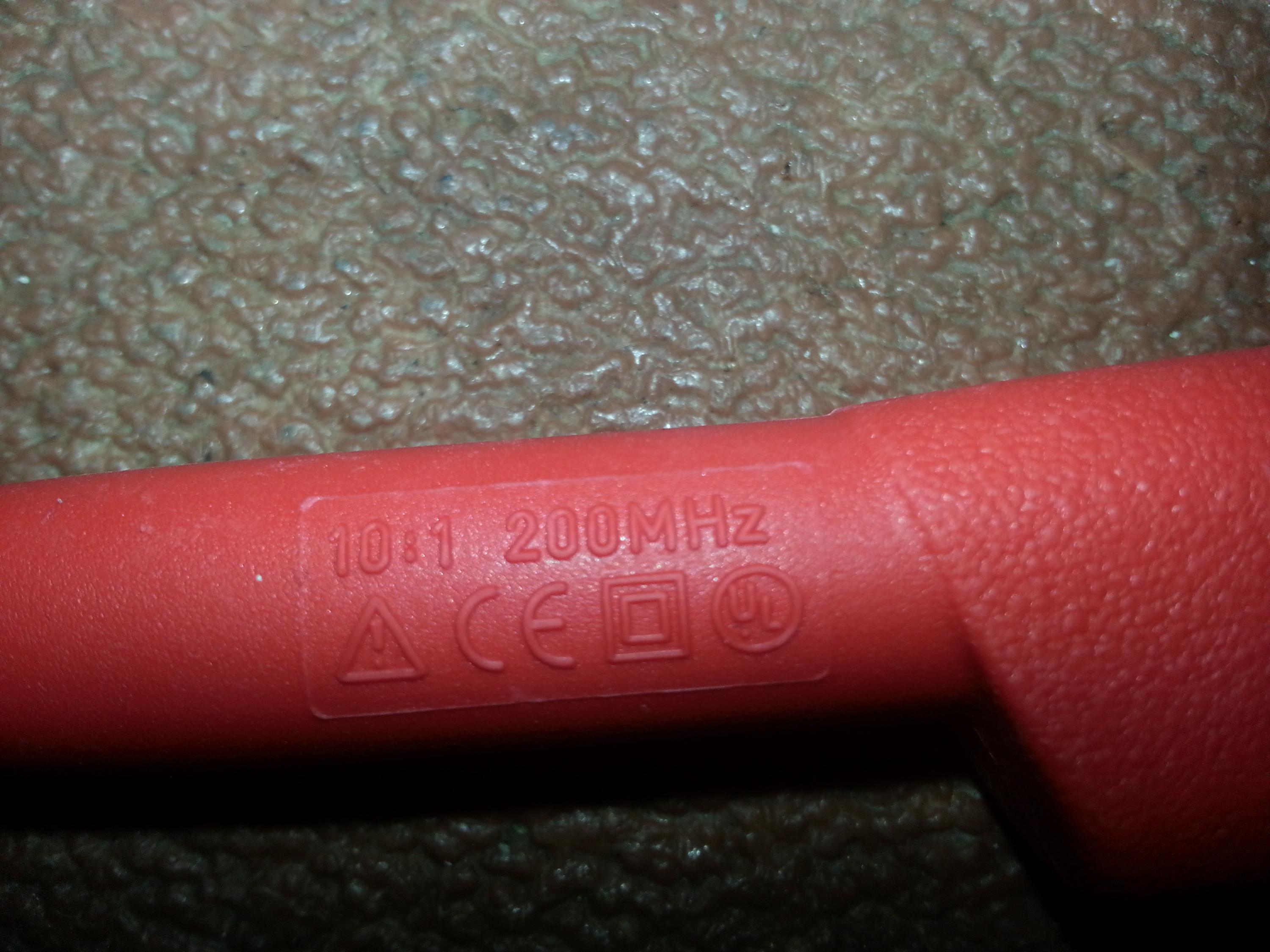

                    #109
                    it says vp510 on one and 10:1 200mhz on the other also says 1000v on the black part of the red stick

                      #110
                      then says 500v in the red stick that was not connected
                        #111
                        10:1 is what you want. Same as 10X. Closer pic of that one?

                          #112
                          Yer it says

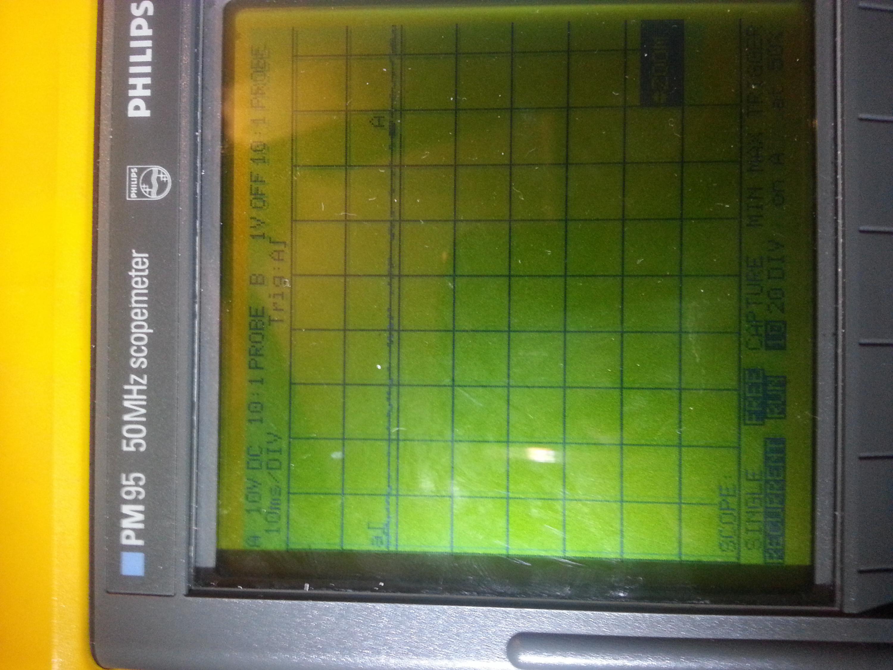

                                #115
                                Like that ?
                                  #116
                                  You should press V/mV until the display at top shows 10V DC for CHANNEL A. Then press "NS S" to select 10ms (do not mix up with 10ns or 10us.)

                                    #117
                                    Like that
                                      #118
                                      Yes, then press vertical MOVE until line centred in middle of display.
