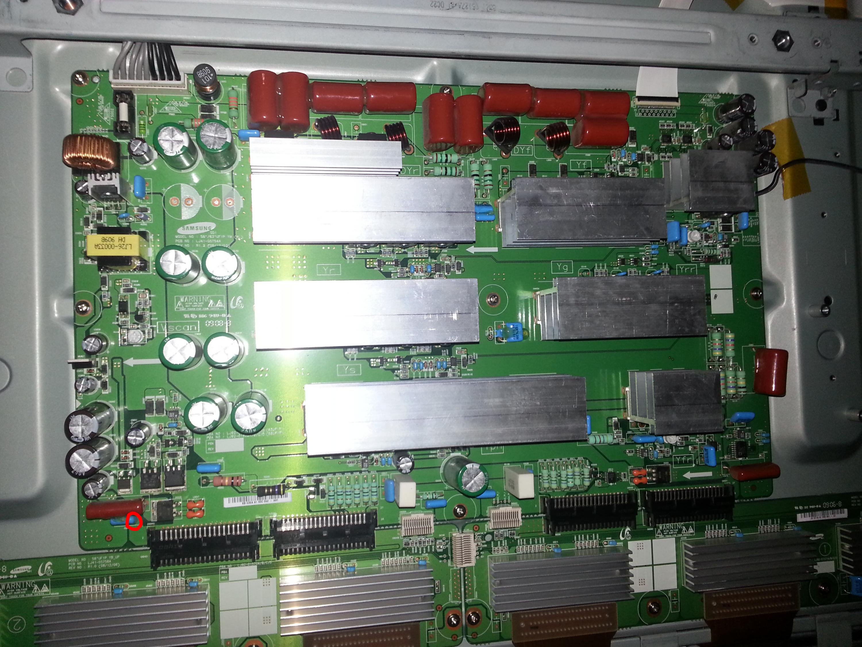

    See here. This is the point to attach probe hook, attach the black ground lead to a screw hole or metal frame work.

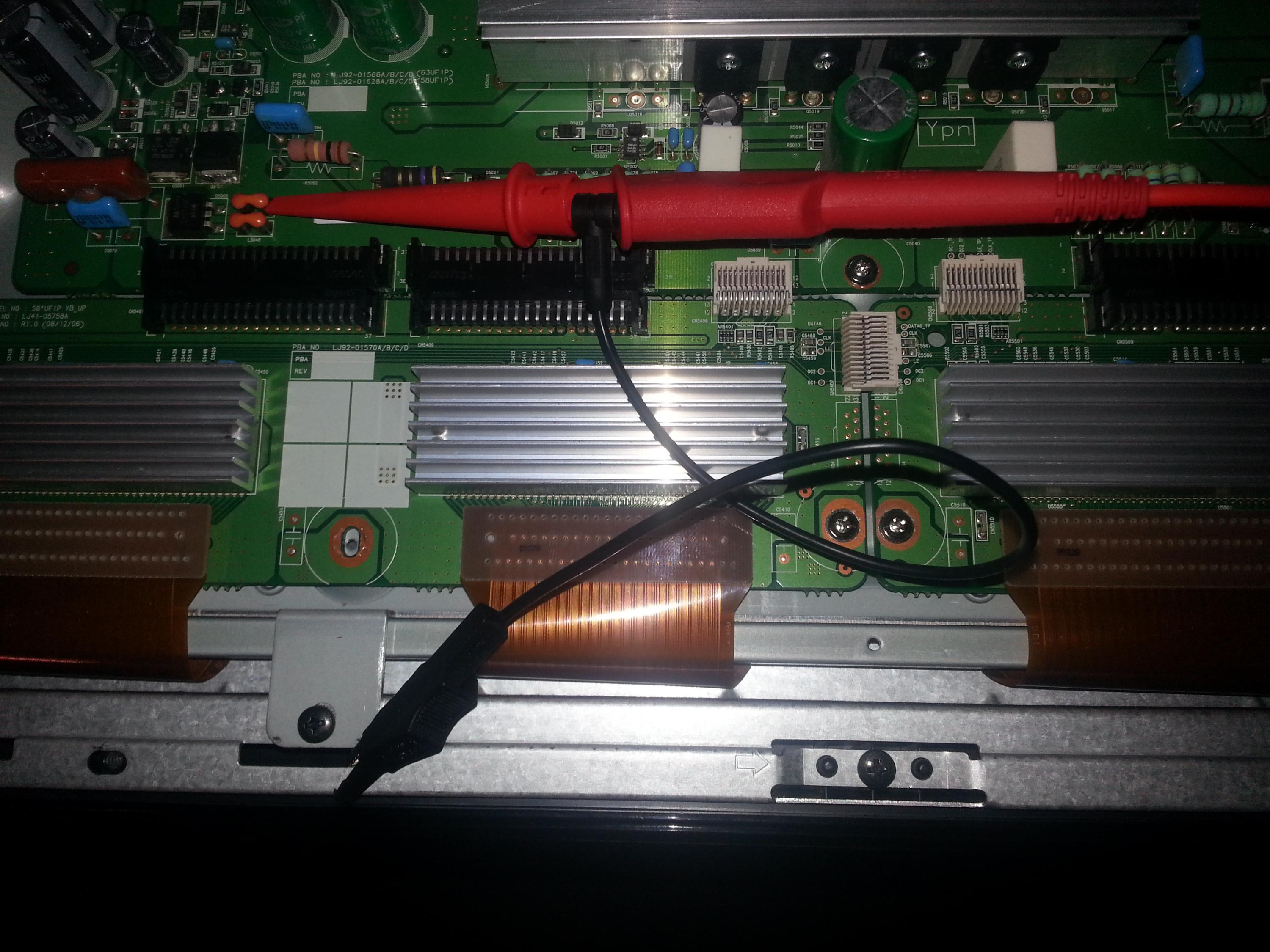

      Re: samsung 58 inch plasma
      so the one cable put the red on the orange bit and the black wire that comes off the red probe put to an earth

        #123
        Like this
          #124
          Yes, exactly. Now, plug TV in, LVDS still out, and everything jumpered as before when voltages were being tested.

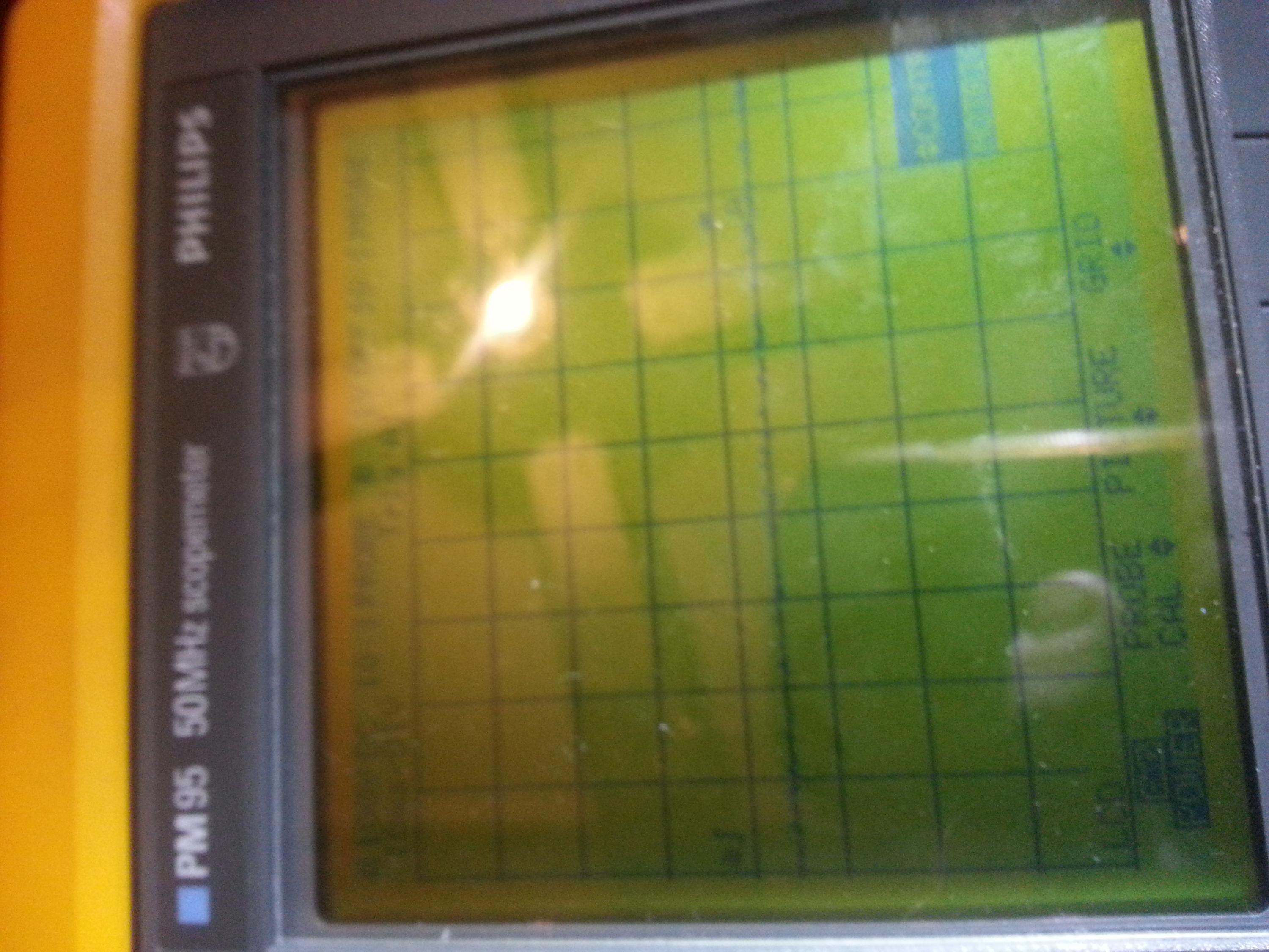

            #125
            not much is happening its only very slightly moving off the line ?

              #126
              should it be on free run ?
                #127
                That will do for now. Will have to look up trigger settings later.

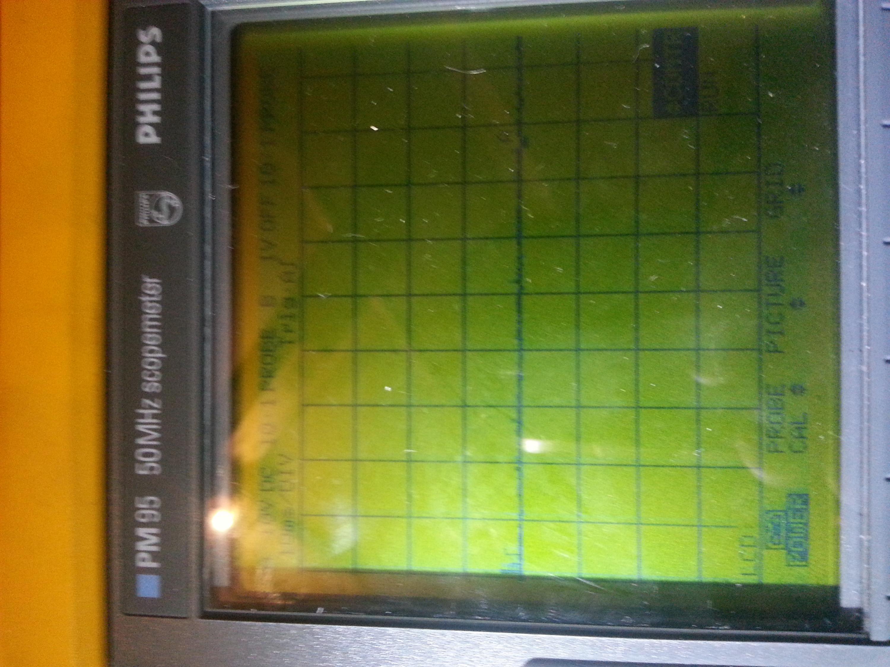

                          #132
                          so it should say on top of the screen 100v dc 10:1 probe
                          10ms/div
                            #133
                            Yes.

                              #134
                              I get this
                                #135
                                So, hardly anything?
                                What's it look like when the TV is turned off, then on again? Maybe take a video showing what the waveform does.
                                I need to triple check that is the right place to probe, but it seems like the Y-main isn't working, at all.
